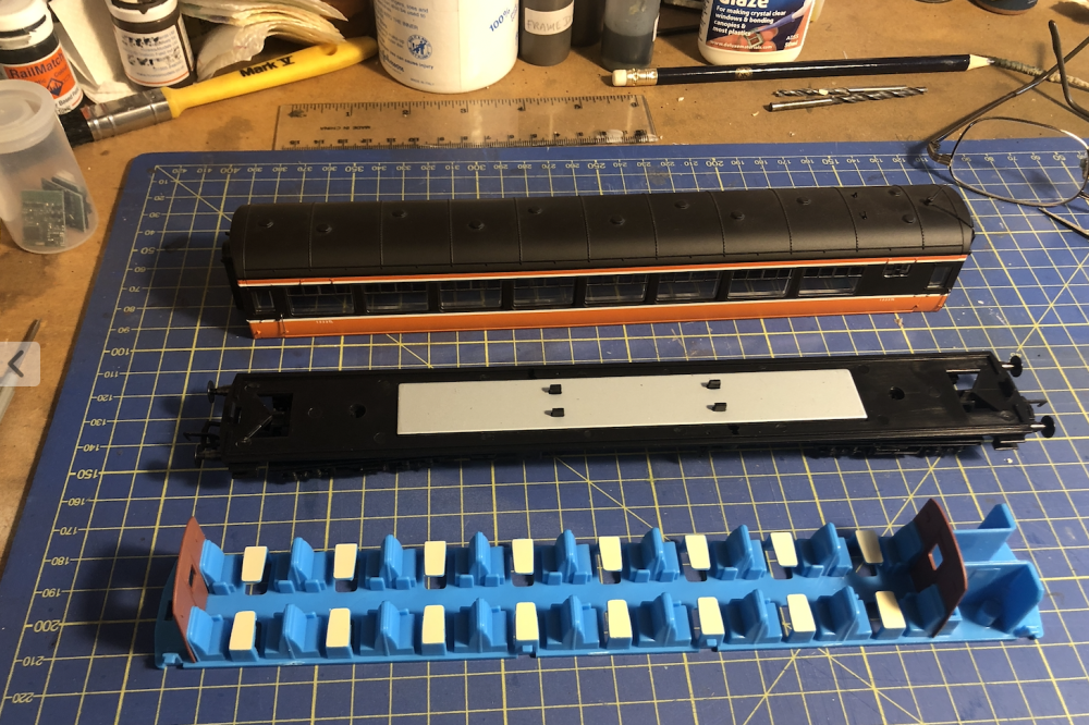

Noel Posted March 13, 2023 Author Posted March 13, 2023 Craven upgrade mini-project. I have long hated the fisher price bright blue toy like colour seating inside the Craven models. So today finally got around to starting the project to correct this and upgrade the interiors by: Seating colour - Repainting the seating a less garish colour. Might not be exact prototypical, a darker blue, or grey with a pink hew (ie simulating checked pattern), or even a mid green colour as used in the laminate era. Install passengers. Install lighting (might be rail-tec motion sensing lights powered by CR16 battery, or my own DCC pcb with bogie track pickups, bridge rectifier, resistor, and capacitor for flicker free, with resistor pot under chassis so brightness can be adjusted externally. Replace tension lock couplings with Kadee knuckle couplings using adaptor for incorrectly positioned NEM pocket. Weathering Will post progress from time to time. The painting of the interior seating by hand is fiddley. Some trial and error iterations might occur with different colours, it won't make much difference looking at them through the model glazing as long as that garish blue us not visible. Don't think I'll need to paint the floor as its impossible to see through the windows, but I'll know that awful fisher price blue is still hiding in there. How to open up a MM Craven coach. 4 friction lugs. Wooden ice cream sticks and wiggling with a few wooden cocktail sticks did the job with a thin flat jewellers screw driver. The seating easily clips away from the chassis once the upper body is prised away from the chassis. 5 Quote
Noel Posted March 13, 2023 Author Posted March 13, 2023 Seating Test colour no 1 When the seating is installed back in the coach it won't be possible to see the remaining blue on the sides of the tables. Next sample I might try a darker matt blue/grey mix. 4 Quote
jhb171achill Posted March 13, 2023 Posted March 13, 2023 I just cannot understand why those otherwise excellent vehicles ended up with those blue seats. They never had anything of the sort. For most of their lives, particularly in the earlier livery, the seats are best painted a dark grey, almost black - top bits and all. 3 Quote
