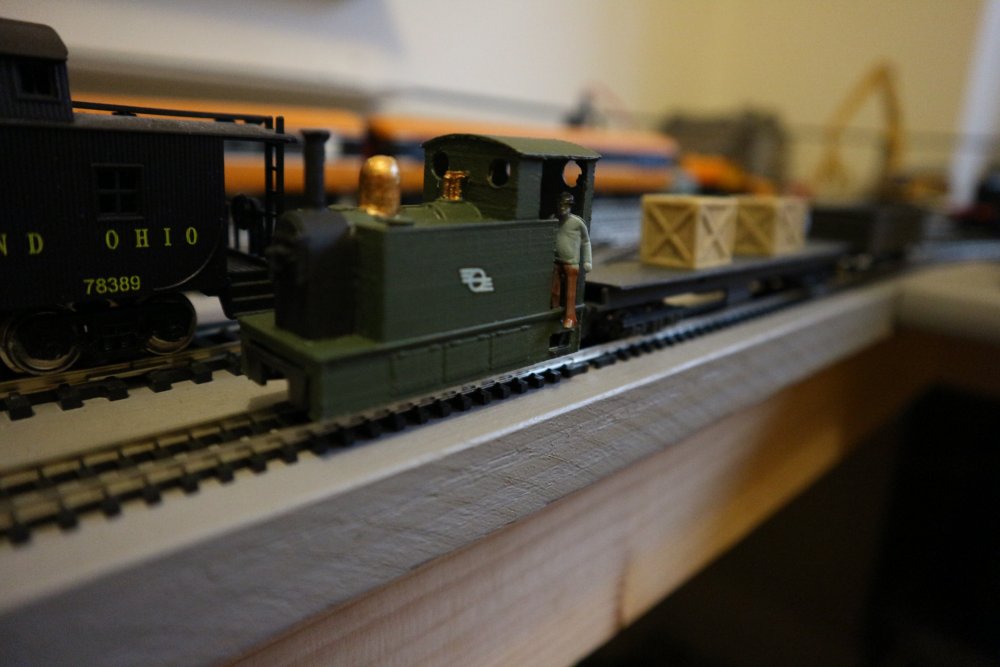

Cobbled together an 009 loop for the layout. Cheap body shell and old N gauge stuff repurposed. Faux Irish livery. Anyone dabble with this scale?
Could be used to mimic/outline old West Clare Railway?

I thought of using 009 track, which of course is scale 2ft gauge-ish, to accommodate British and mainland Europe interests, but building to a scale of 3mm, but eventually compromised. I got several Irish kits but for their scale they looked better on 00n3 track.
4mm SCALE Irish stuff on 009 track just looks totally wrong (hardly surprisingly; it is!)
So I switched to German / Austrian narrow gauge, with the advantages of good quality Peco 009 track and high quality RTR stuff from the likes of Roco, Liliput and Bachman. This survived two house moves and just as I was about to set it all up here, along come Messrs Worsley, Provincial, SSM, JM Design and others. Thus, the last of it is being taken in a padded box to the post office in about half an hour, while meantime Messrs ECM Trains and Baseboard Dave are in communication!
Here, of course, is the real advantage of 009. With Austrian, I can fit a continuous circuit with a sizeable terminus and junction station. With 00, which I'm returning to after an absence of about forty years, I can have a small fiddle yard to shunting terminus.
Edited by jhb171achill
I suppose it depends, Roxy, on what end result you want. Austrian, German or some other mainland European theme, or Welsh narrow gauge (with or without slate mines) is easy - there's loads of RTR stuff.
If you want to go Irish, unless you want to scratchbuild everything to a scale of 3mm to the foot, you're better off with 00n3 (12mm gauge) track. It's a bit bigger, but not much, so almost as versatile in confined spaces. As I said, 4mm Irish on 009 track looks plain ridiculous. Recent debates on this forum have examined the HO / OO / 21mm gauges for Irish models, and there's a clear advantage in 21mm from an appearance perspective, but practicalities and most people's skills, time and budgets heavily favour 00, even though it's not technically accurate.
Using 009 to represent anything Irish (or Manx) in 4mm scale is way, way worse! It's like putting the Flying Scotsman on scale 3ft gauge track, proportionately.
There are many Irish kits available - a very good selection in fact. They are all 4mm, thus making 00n3 track as good as obligatory. And now you can get Peco Streamline in 00n3, which you couldn't when I started narrow-gauging, years ago. Had it been available I'd have gone for it, and my dream of a complex Donegal or West Clare system in the attic would have come to pass....

As an 00n3-doing person may I say the availability of kits varies all the time. The worst thing is that the Backwoods range is gone (though may re-appear), still the Dundas T&D vans are back, and we still have Worsley and Branchlines.
Re the other comparison - 4mm Irish on 9mm track is 3mm wrong , while 5' 3" on 16.5 is 4.5mm wrong, a bigger error but possibly a little better in percentage terms I suspect.

I'm no expert on any of this.  Given the lack of Irish RTR in the scale and the issues mentioned I'll probably buy some Roco European stuff and run that, I like the look of it.
My layout is just a big train set, not a faithful reproduction of anything. Also installing the line means I can run some n gauge stuff that's been gathering dust.
All that being said, I love the old wild west look of this.
Edited by roxyguy

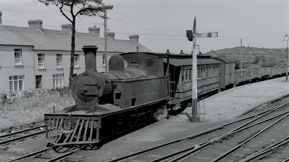

2 hours ago, DiveController said:
Where/when is that photo from? Sorry, N gauge isn;t my forte
Ballinamore hub of the C&L narrow gauge lines in CIE days. A very busy place when the coal trains from the Arigna mines were running.

Ballinamore as siad above, but nothing to do with N or 009 of course being 3ft gauge.
