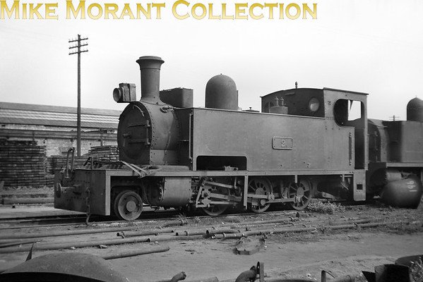

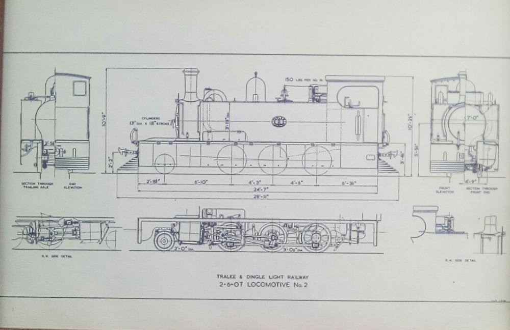

I may have done a terrible thing here... I was kindly sent a basic diagram of one of the Hunslett Tralee and Dingle locos, now the drawing was curiously in 6mm to the foot, I was experementin' in my crude way to try and scale it up, to 7mm with the help of the Mrs and her wee printer..
The thing is, this was elusive.. but I ended up with a nice drawing in 10mm to the foot !...looking at this turned me head a bit to thinking, hmmm that locomotive would be a monster !...and seeing as I was going to scratch build it anyway, what about trying it in 10mm scale..?

In fact having just shown the drawing to a steel rule, compared to the alleged dimensions, it's a tad oversize anyway so the loco and the track might kind of meet half way !

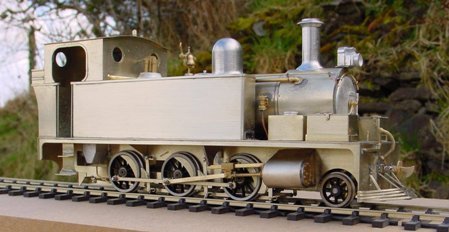

Studio Scale Models produce a 10mm scale kit of a Tralee & Dingle Kerr Stewart 2-6-0T most likely to run on O Gauge track. The kit was originally designed and produced by Adrian Rowland.
Worsley Worksmight blow-up some of their T&D scratchbuilder parts to 10mm if you ask.

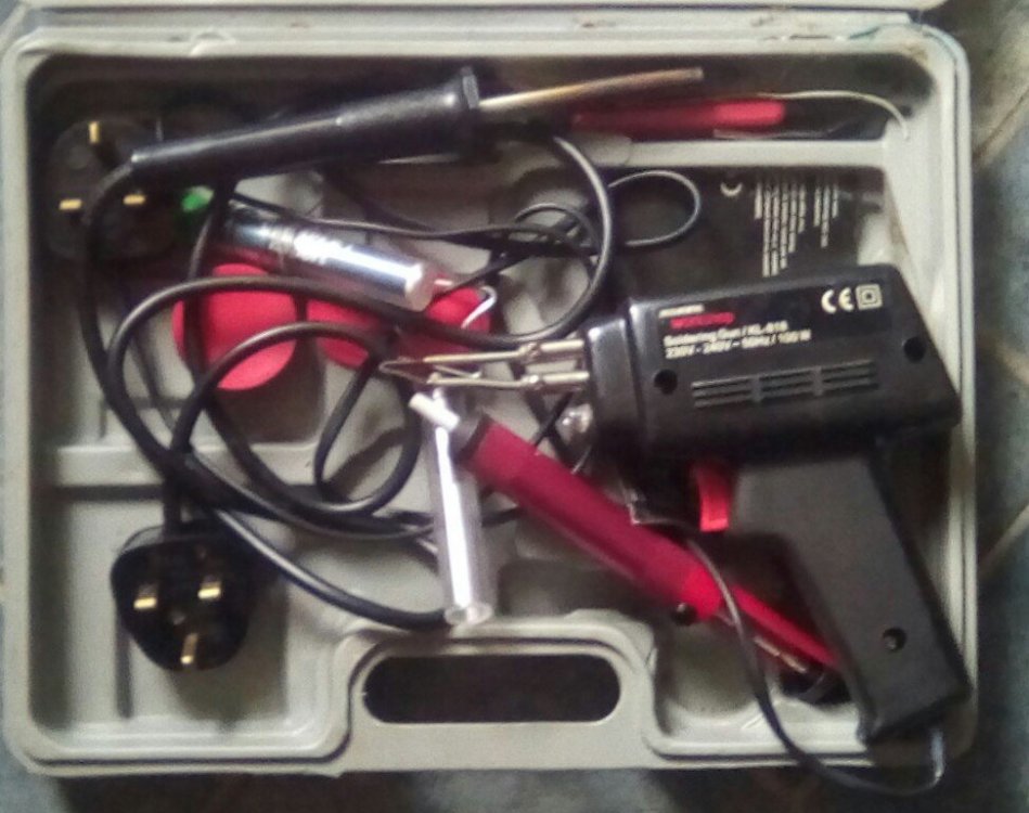

Hi PP
A soldering gun is not ideal, their heavy and the way the tip is designed its hard to manipulate inside a chassis, also the contact surface area of the tip is not big enough to get the heat into the parts- fine for electrical work in my experience.
Eileens do a Antex 100w for about £20.00 with a grand big flat tip excellent for this work- I use one of these59eb803ff3802_FSO-96IMAG2484.jpg.3b5bea317c5eef5006869b7e99b15e0f.jpg

So @PorkyP I've scaled this to 10mm to the foot, or 1:30.48. I've amended the wheels to the sizes published on wikipedia, but as you can see with the cab and body measurements, there's something amiss. I'd suggest trying to get a hold of some more accurate drawings, if that's possible.

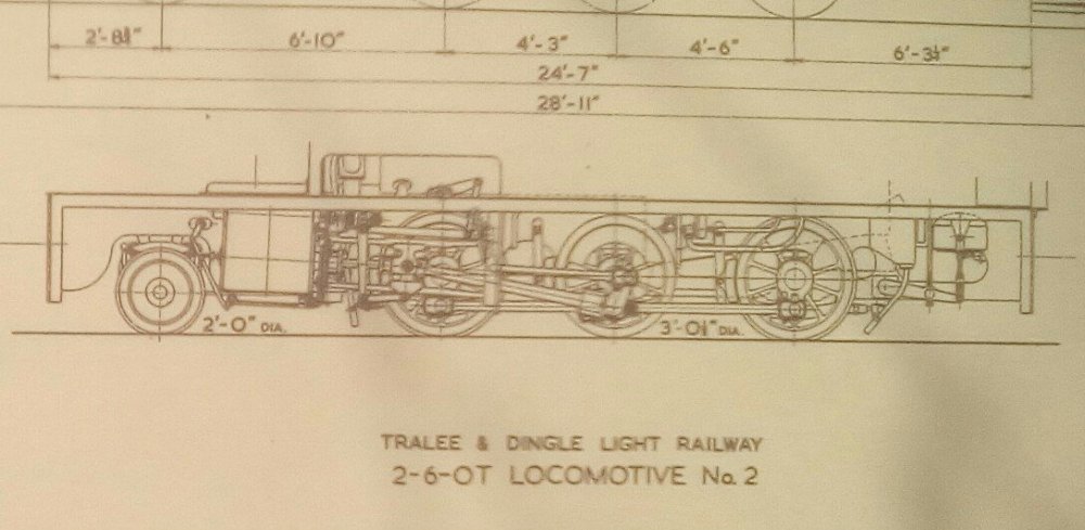

On the wheel front, I reckon you could turn the ponies at the front, and drill the 3 hole discs with a bench drill.

Richie, that's brilliant ! ...I had a bit of a measure of the alleged dimensions and as you rightly say the drawing has to be a bit off..the only other diagram of this seems to be a tiny one in the very old Whitehouse Tralee & Dingle book, I'll try and photograph it but I never have much luck getting em in focus !...there doesn't seem to be another drawing of these locos I can find, the bigger 2-6-2 loco has a drawing that looks by the same hand as the 2-6-0 so likely the same issues. Anyway thanks again for taking the trouble to help and advise , and encourage me mad scheme!

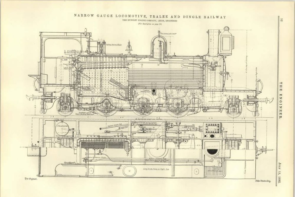

On a bit of a tangent I just purchased the 1890s original of this, it's the arrangement drawing of the 2-6-2 loco, its apparently 11" x 14" so a nice big piece, maybe this one will be the next build after the 2-6-0 !
For 8 GBP for a nice drawing of a classic Irish loco I thought it'd be rude not to grab it, will be goin straight on me wall !

You'll have to print this on A3, should be enough to start making a mock-up in cardboard etc.
The previous drawing, compared with the above, had a shorter chimney, dome was in the wrong location, and the cab was iffy.
