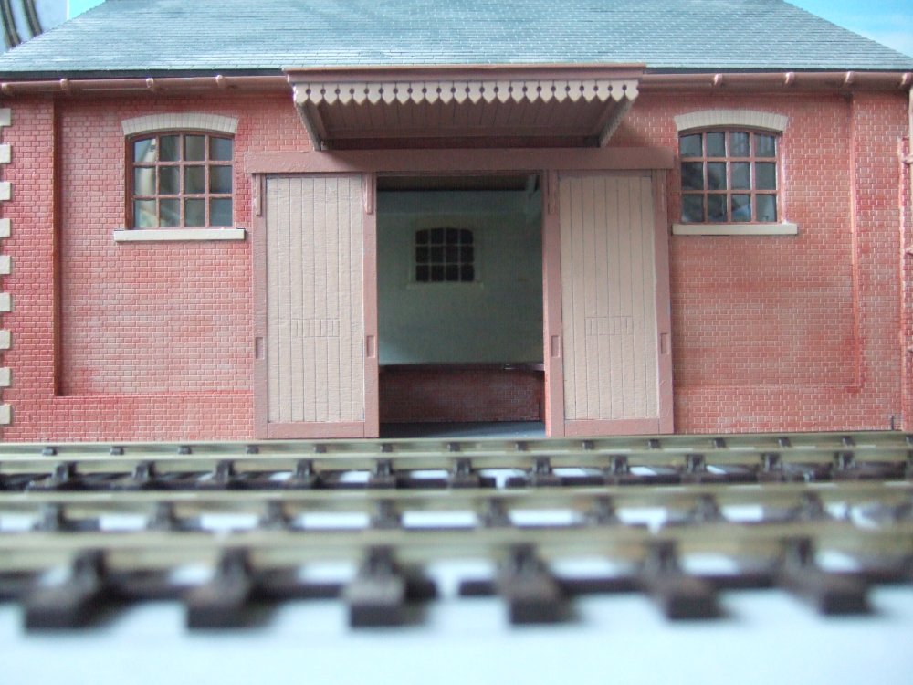

jhb171achill Posted May 9, 2021 Posted May 9, 2021 Absolutely superb stuff all round. Love your realistic brickwork texture. 1 Quote

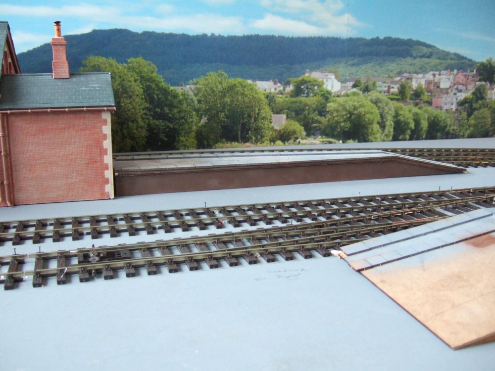

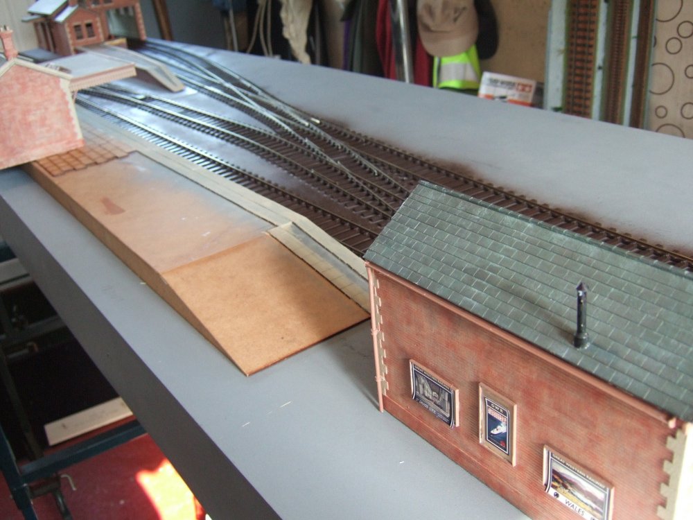

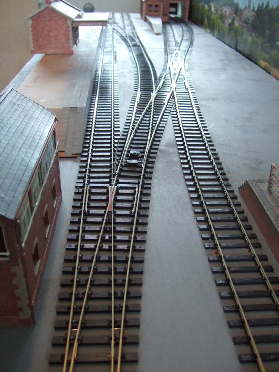

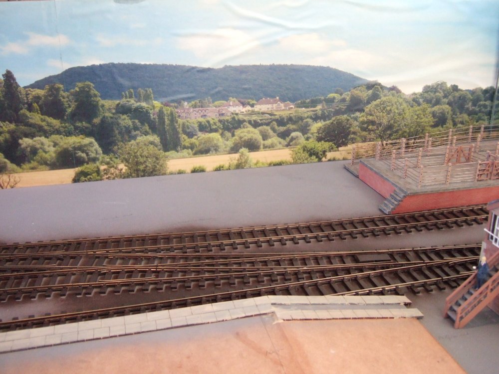

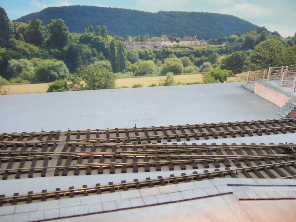

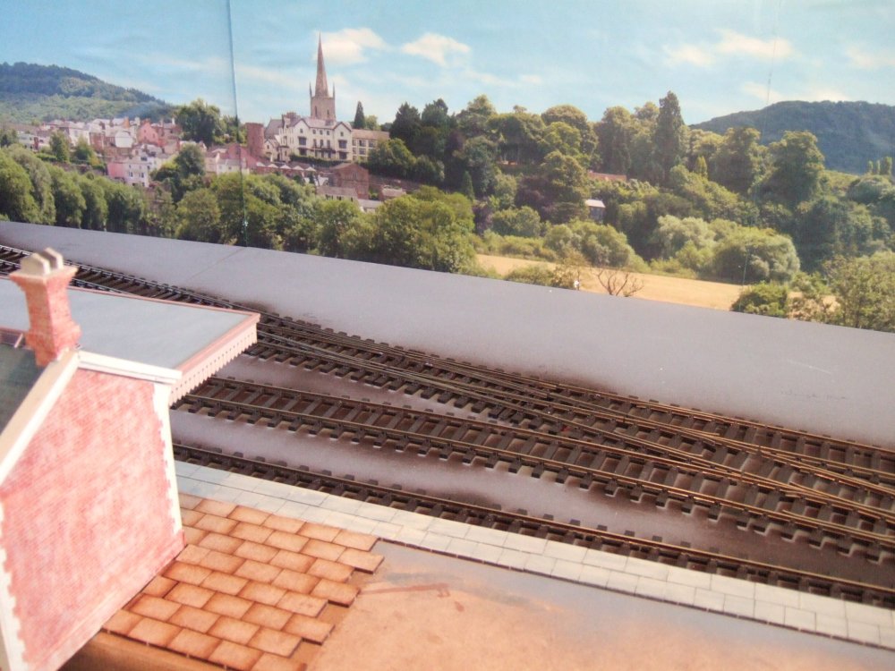

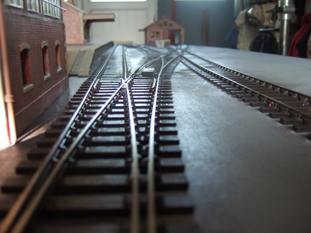

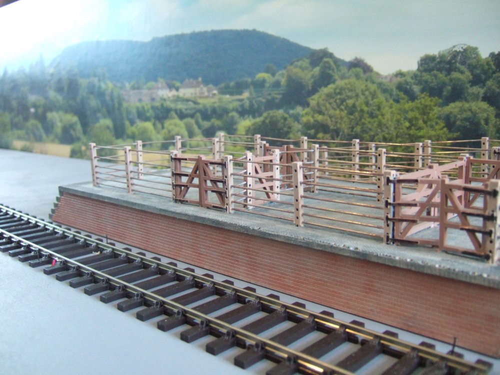

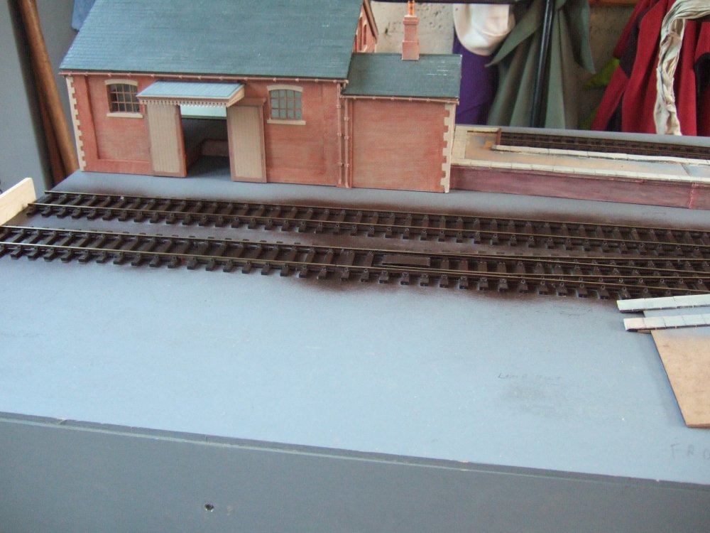

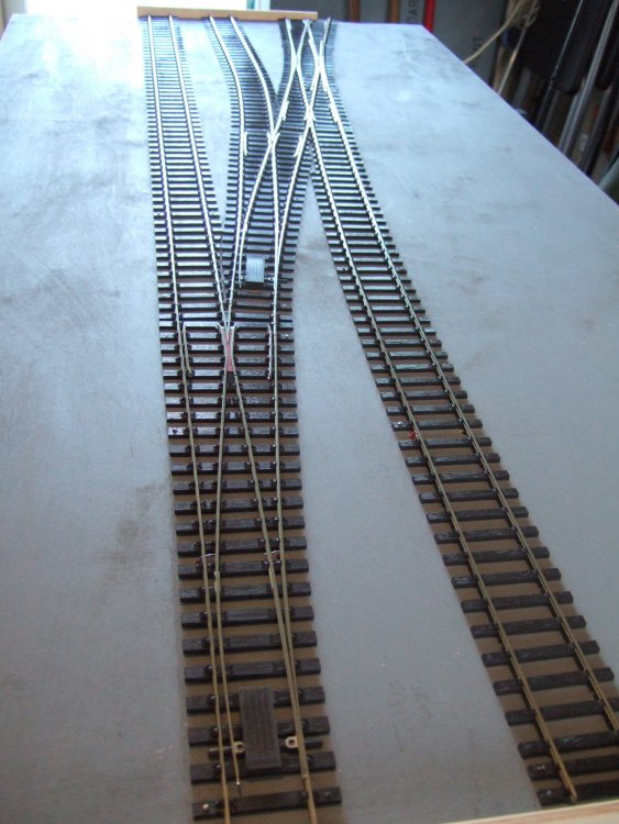

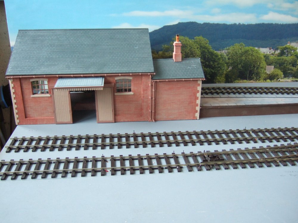

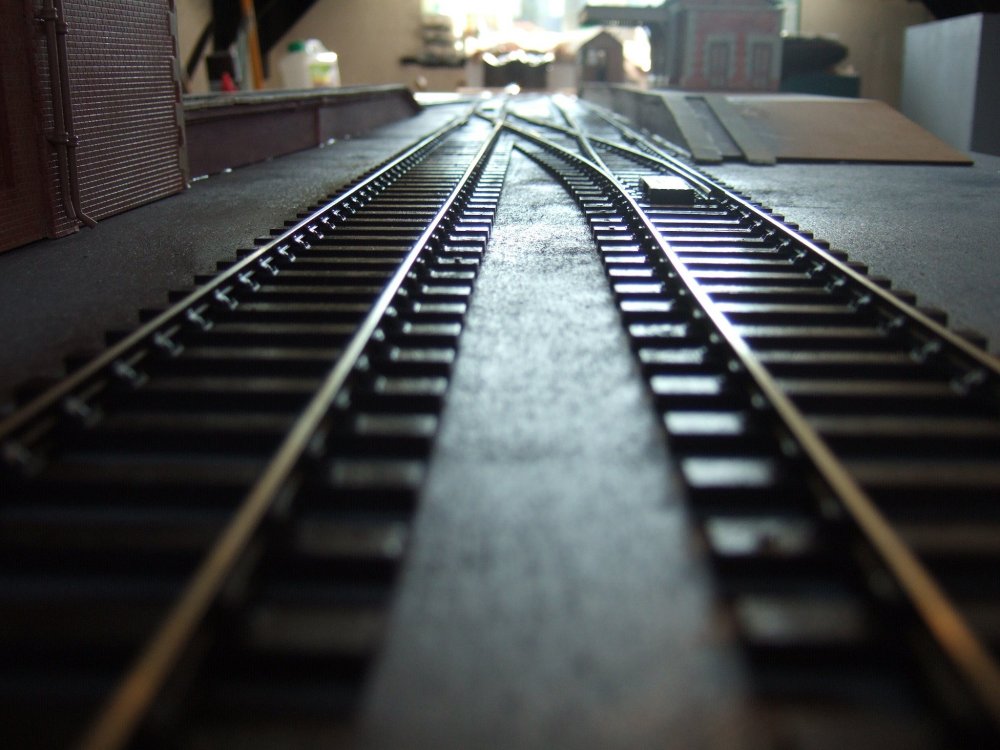

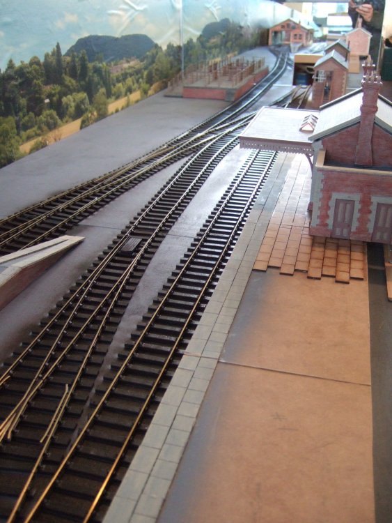

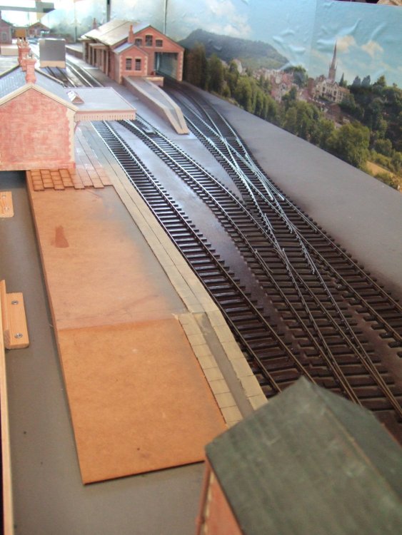

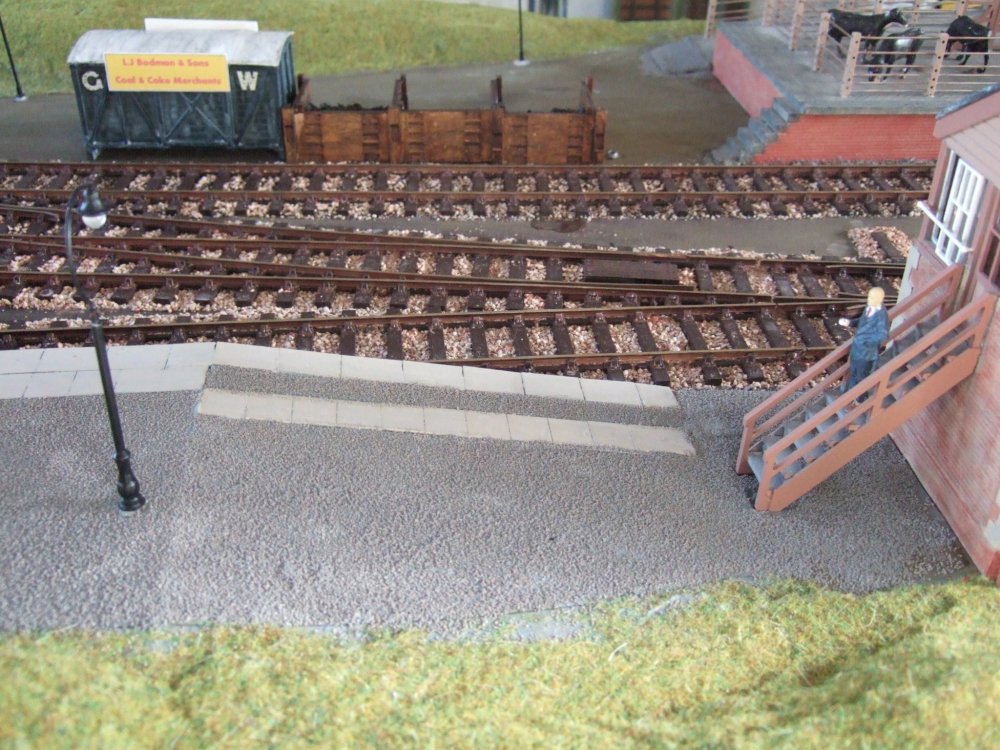

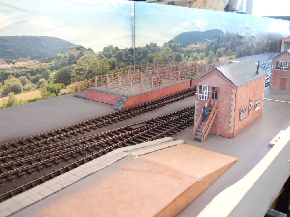

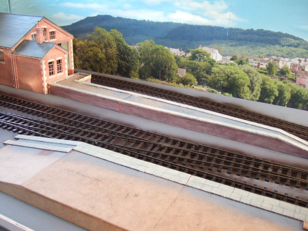

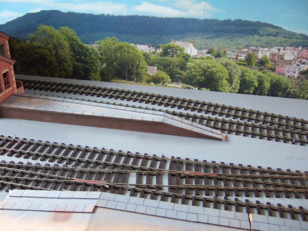

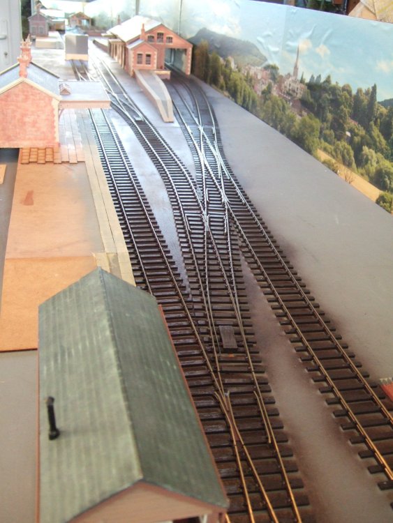

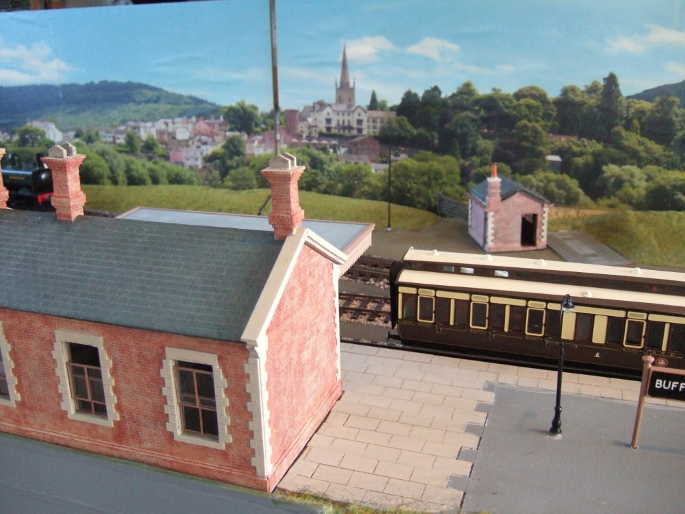

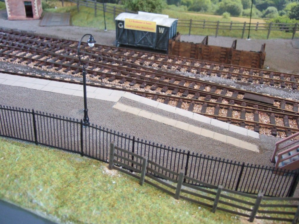

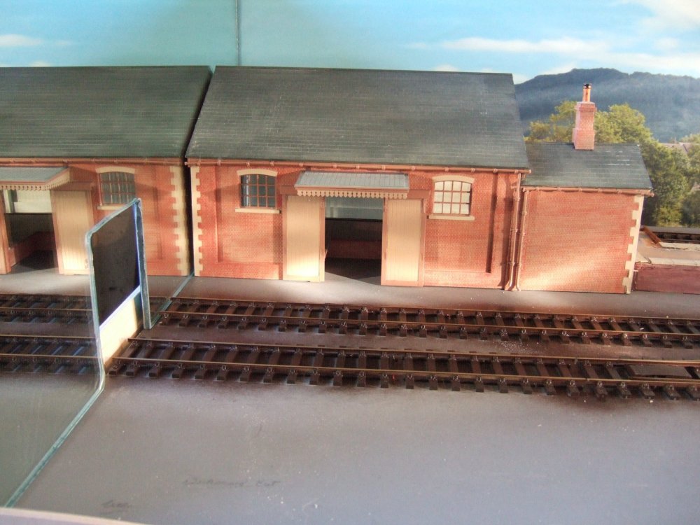

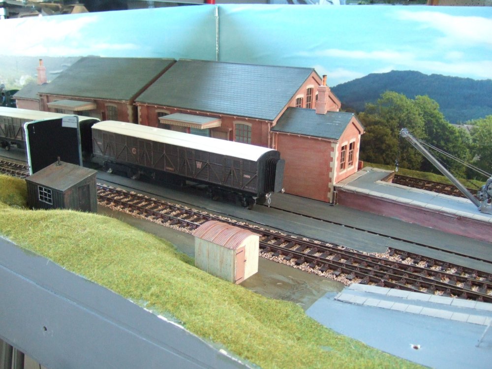

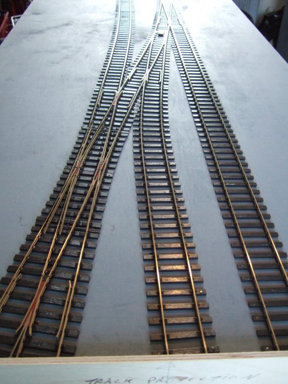

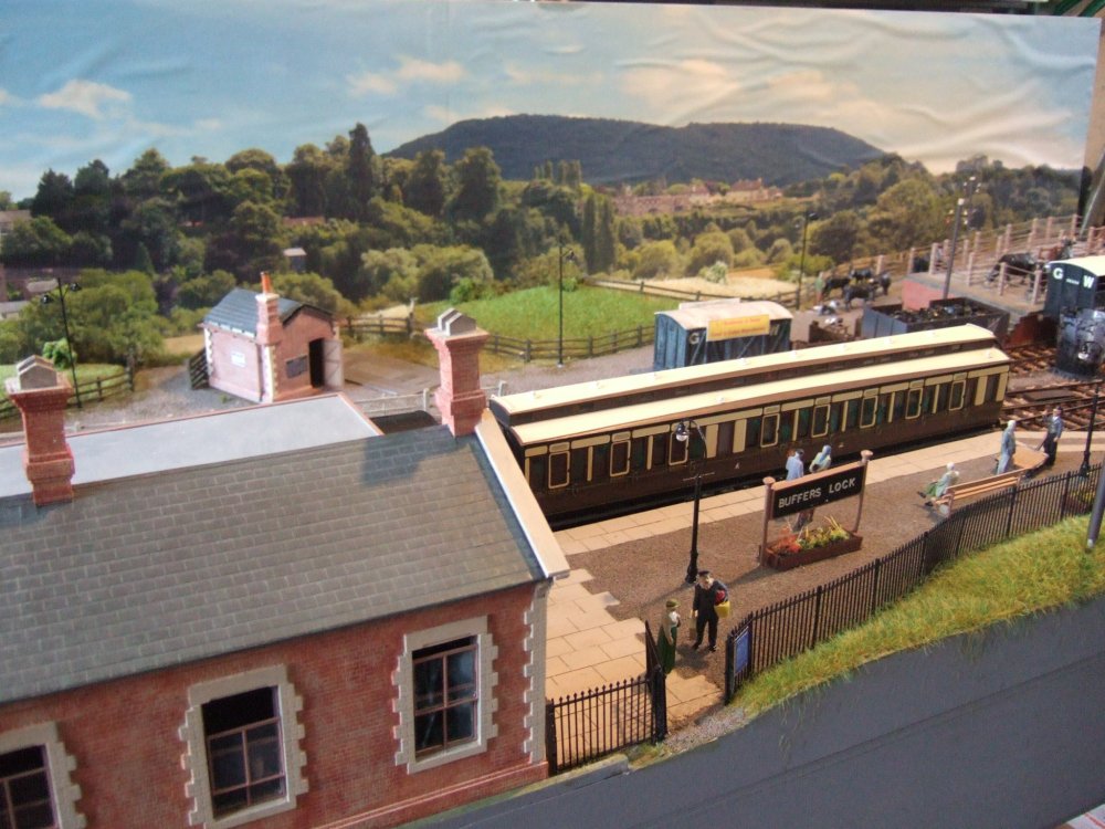

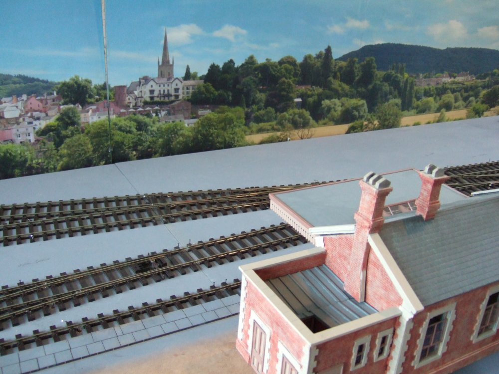

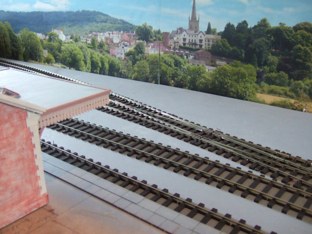

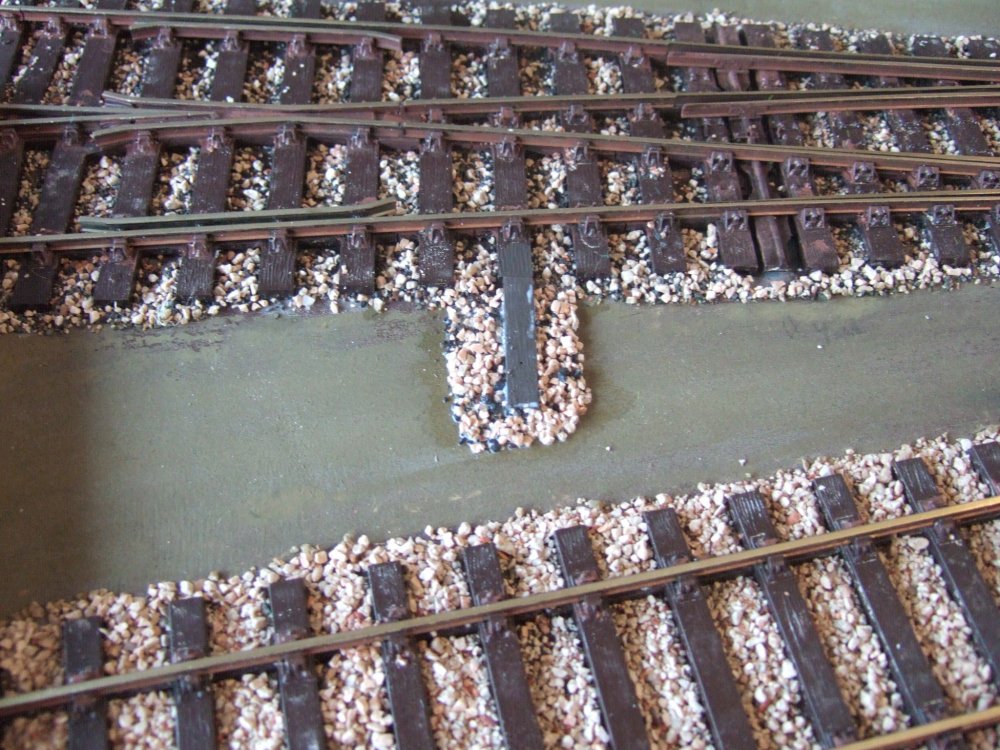

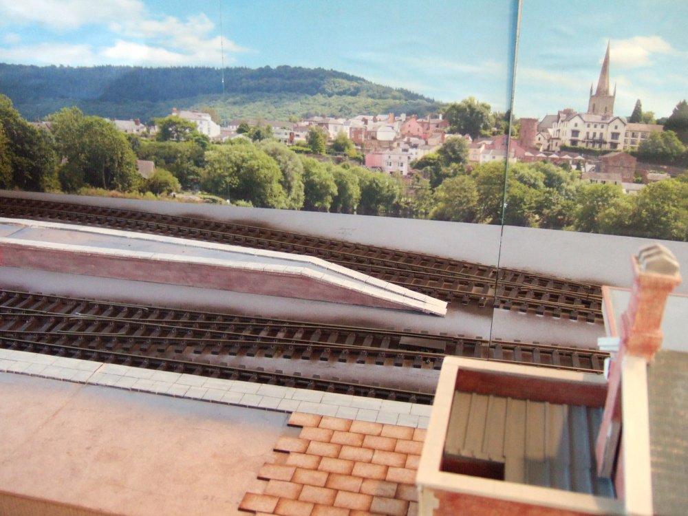

Irishrailwayman Posted June 19, 2021 Author Posted June 19, 2021 The Big Reveal! The two baseboards have been constructed and track has been pinned down. This series of photos outlines the track-work and approximate position of the buildings assembled previously. Also see the photographic back-scene atmospheric of high Summer in GWR days of steam... The track design has a run-around loop at the station with a head-shunt, a siding across a double-slip (great space-saver) which enters two lines to the Goods Shed as well as a trailing head-shunt to the Cattle-dock. Plenty of scope for passenger and goods stock movements. The design allows for a fiddle-yard at each end of the layout: one is a Traverser and the other a Train Turntable (more of these anon). 12 Quote
Noel Posted June 19, 2021 Posted June 19, 2021 Looks fabulous Gerry. How do you find working with O gauge track? Your GWR pannier will look great shunting this layout. Quote
Irishrailwayman Posted June 19, 2021 Author Posted June 19, 2021 2 minutes ago, Noel said: Looks fabulous Gerry. How do you find working with O gauge track? Your GWR pannier will look great shunting this layout. Thanks Noel. The Peco track is easy to work with. Looking forward to running trains on this layout! 1 Quote

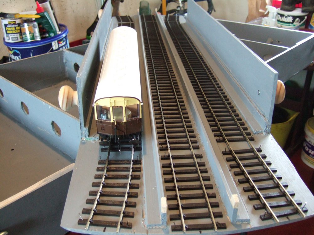

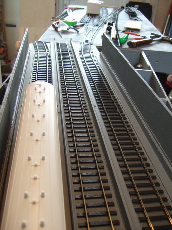

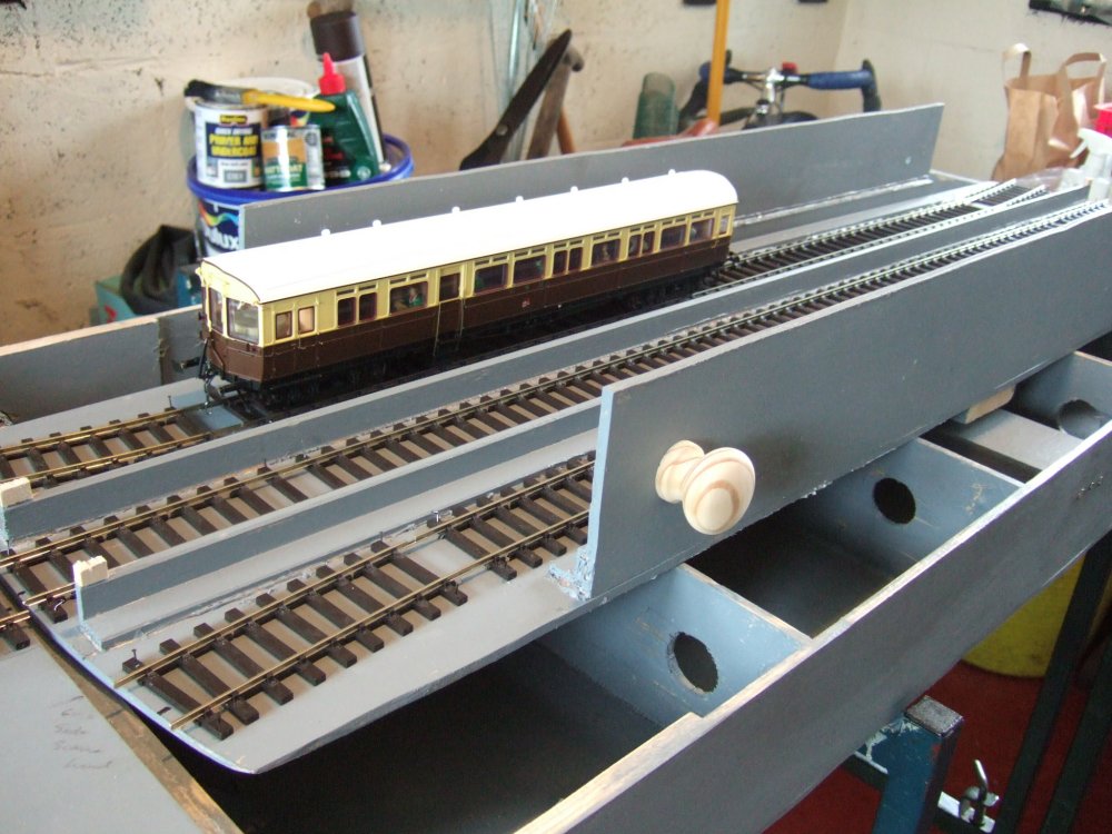

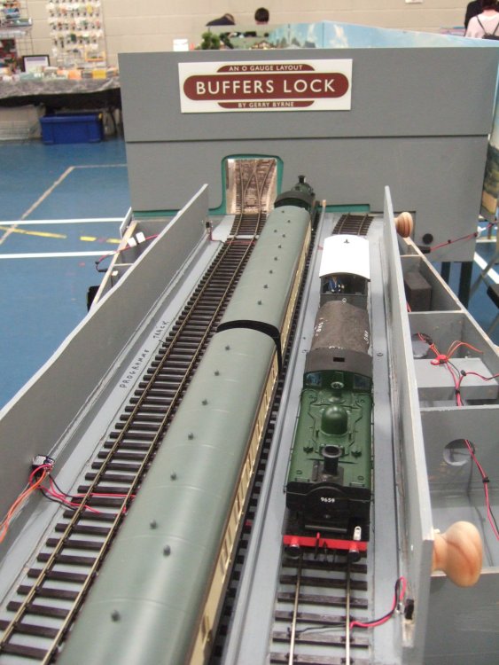

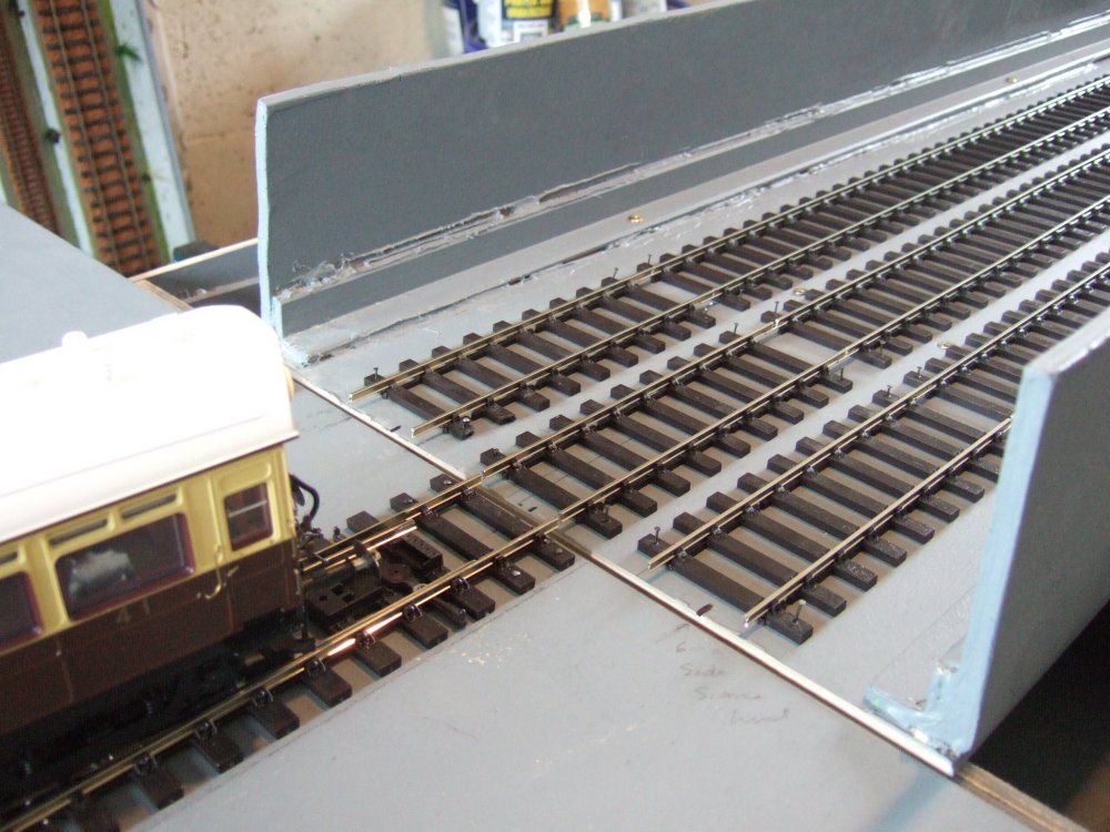

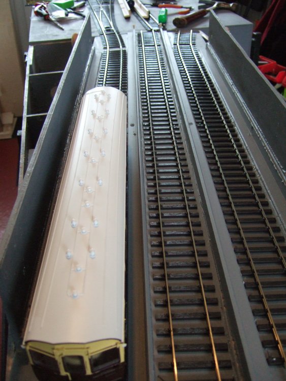

Irishrailwayman Posted June 20, 2021 Author Posted June 20, 2021 I am developing two three-way 4 foot fiddle-yards: one is a Traverser and the other a Train Turntable. They can each be fitted either end of the layout. Attached a few photos of the Turntable the first one prior to assembly: 5 Quote

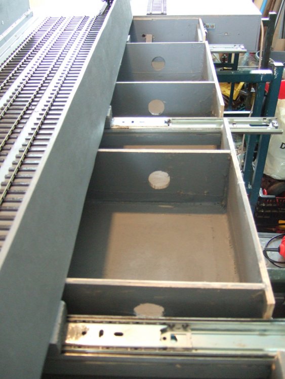

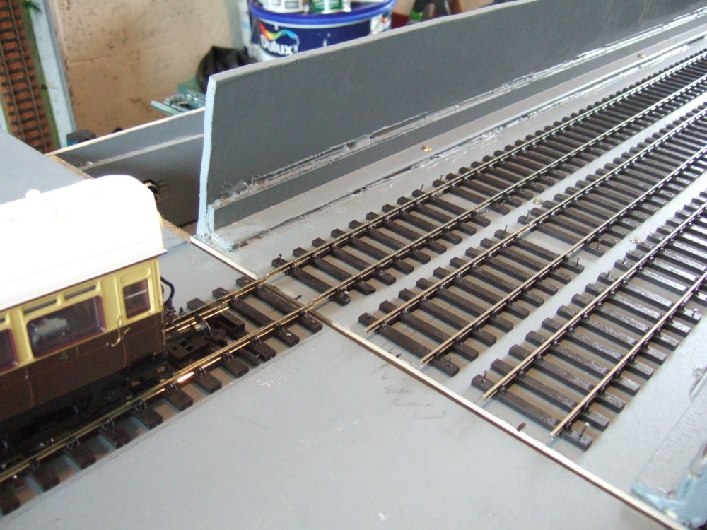

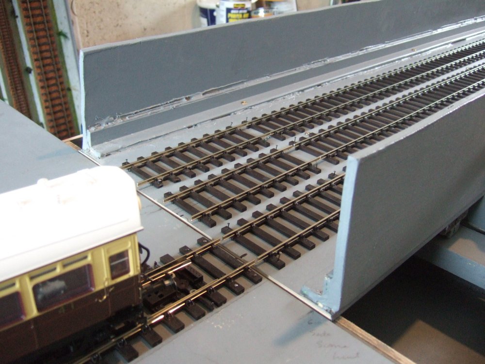

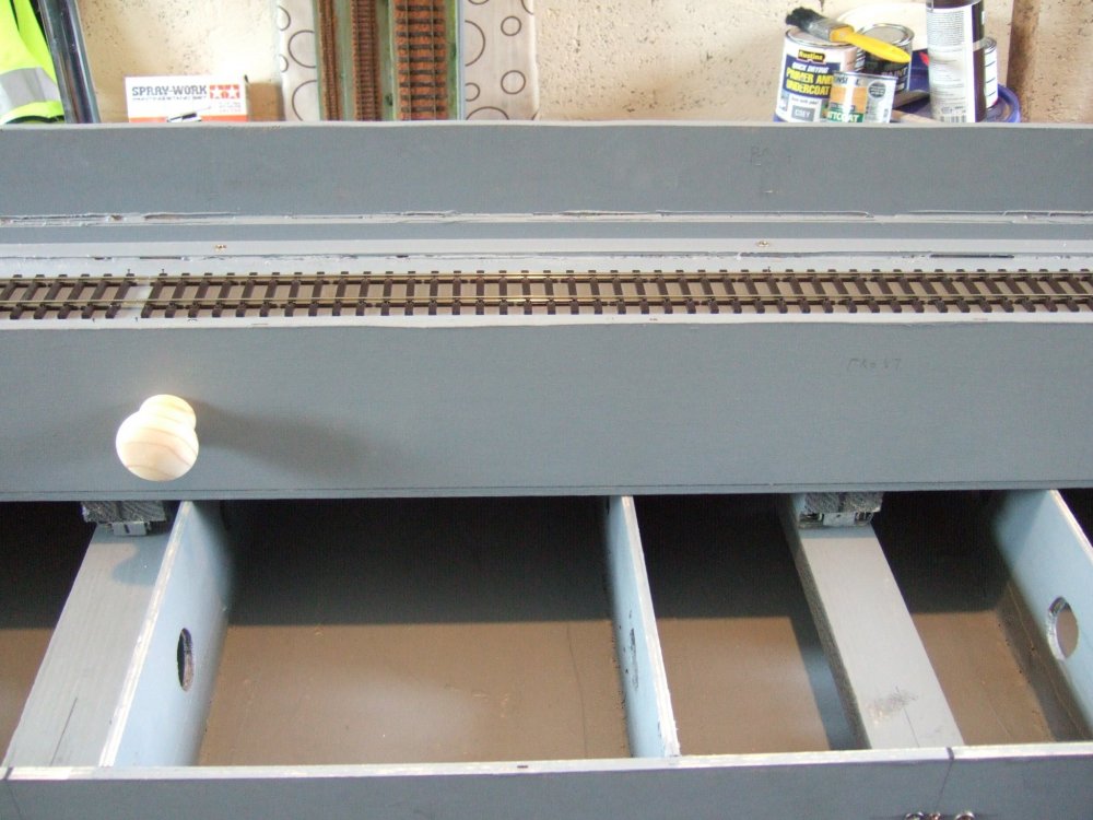

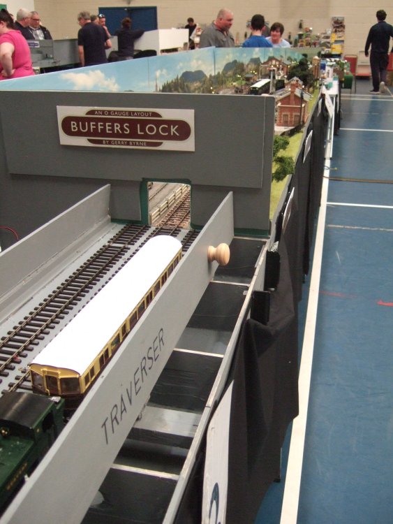

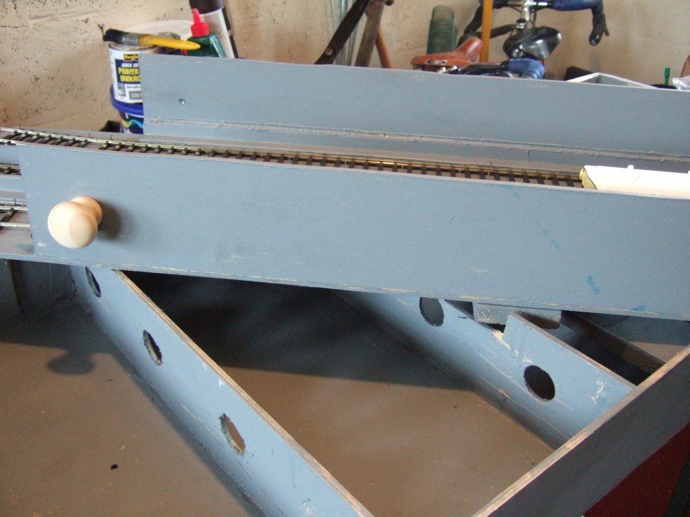

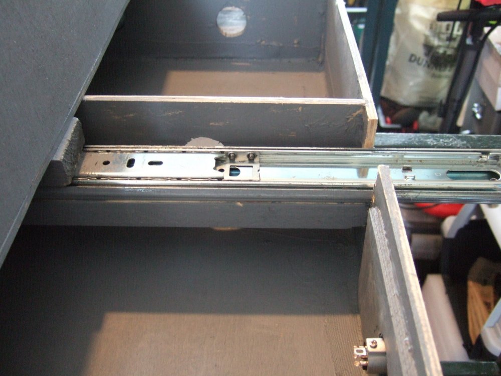

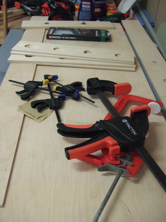

Irishrailwayman Posted June 24, 2021 Author Posted June 24, 2021 A couple of photos of the Traverser fiddle-yard which can fit at either end of the scenic section of the layout. Construction used the same techniques as the main boards except the board was inverted to provide a frame for the moving track board which is supported by three drawer sliders. 5 Quote

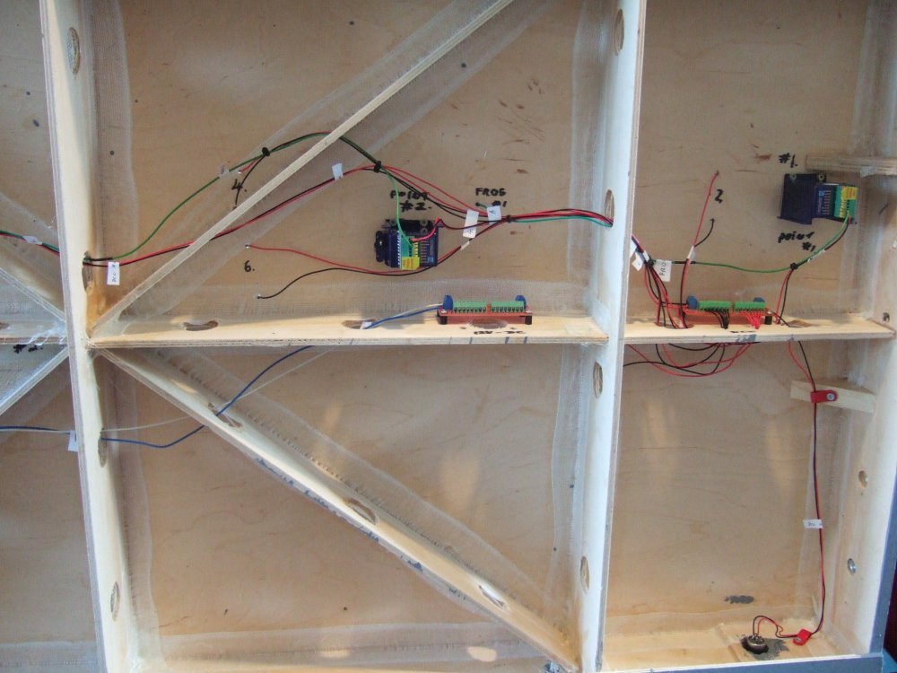

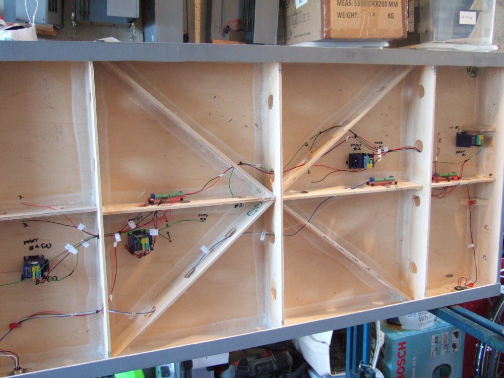

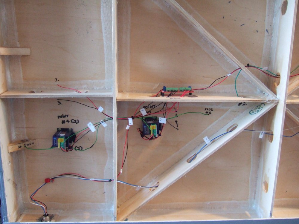

Irishrailwayman Posted July 21, 2021 Author Posted July 21, 2021 With both the Traverser and Turntable fiddle-yard wiring complete, attention turned to wiring the first of two scenic boards for DCC including 4 point motors. All tested and working perfectly now. Lamps and building lighting are provided for by separate DC connectors. 8 1 Quote

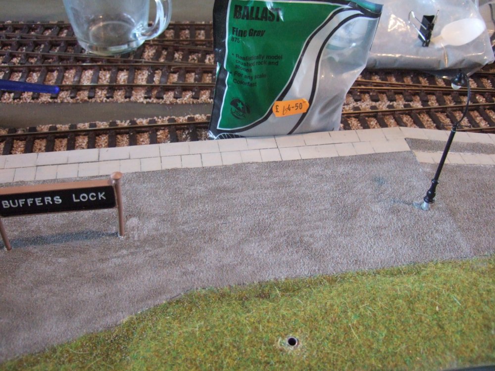

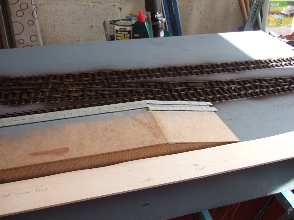

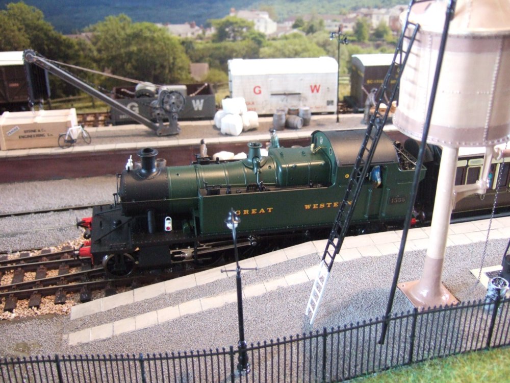

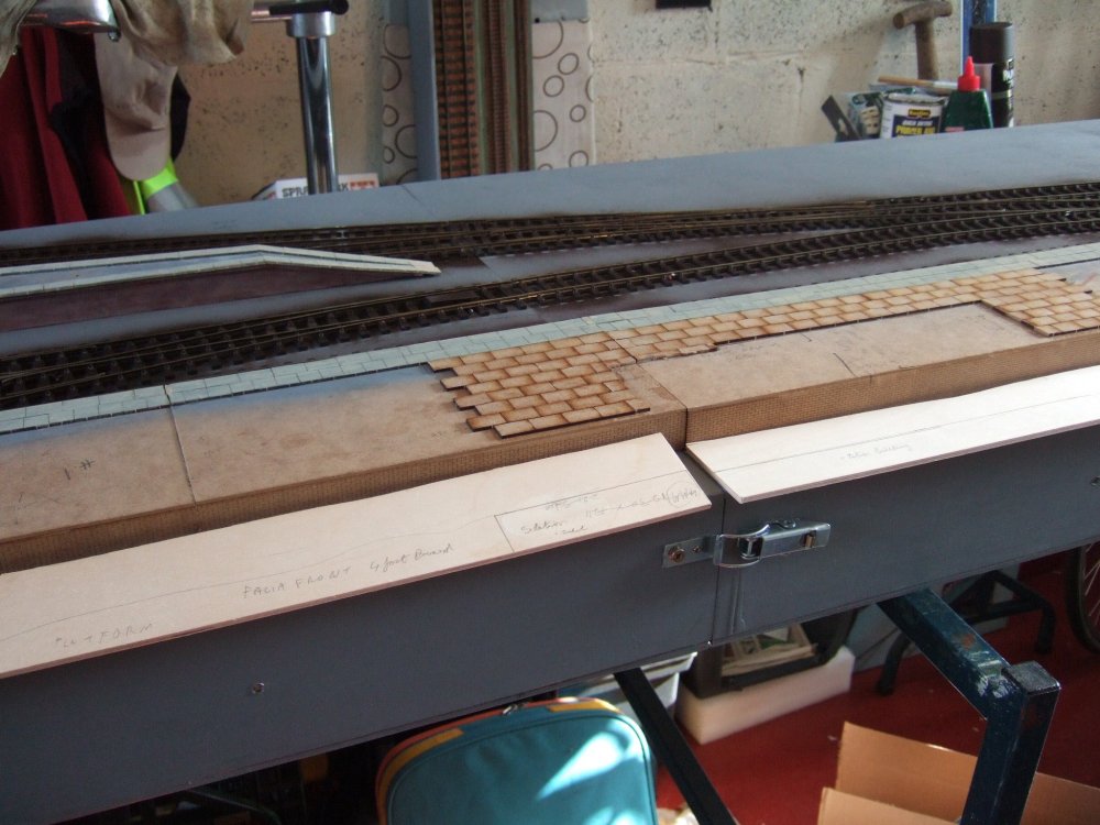

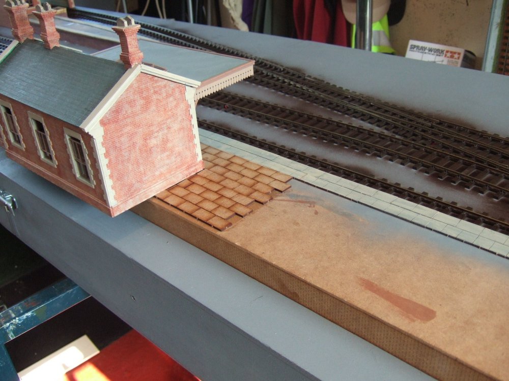

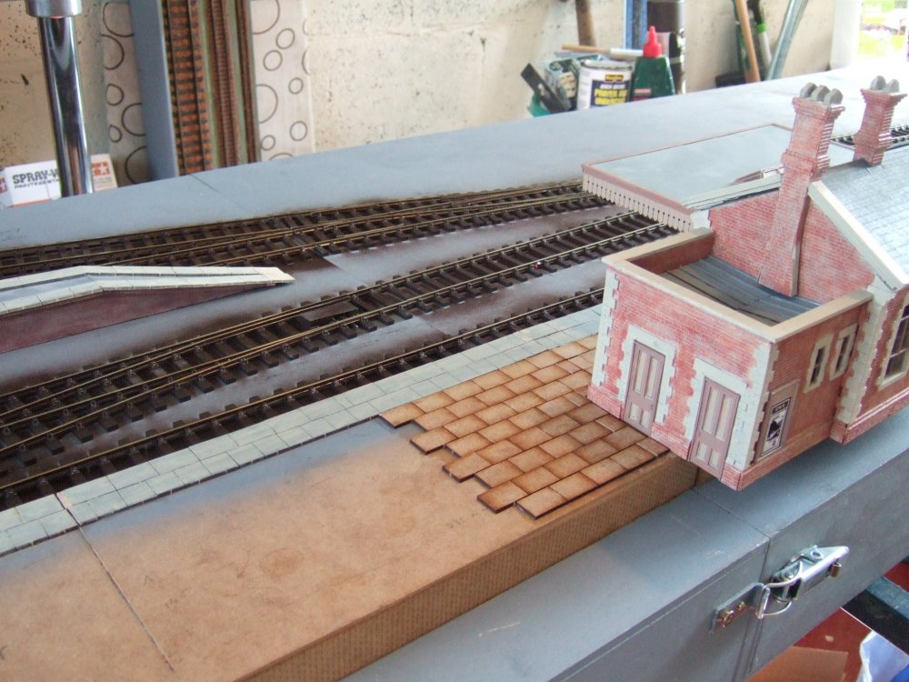

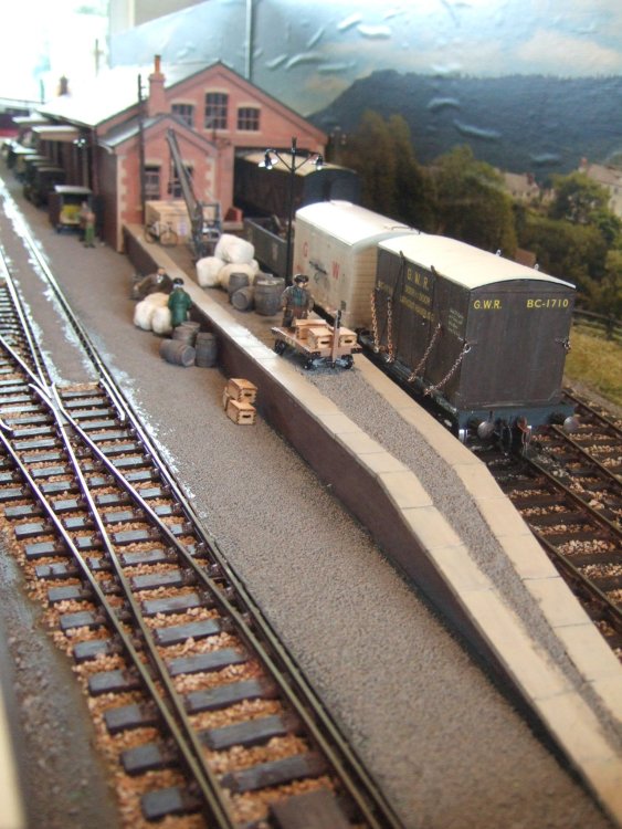

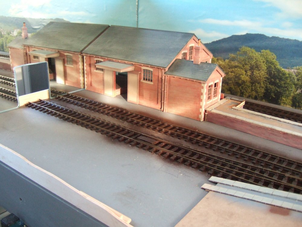

Irishrailwayman Posted August 8, 2021 Author Posted August 8, 2021 Platforms rescued from disposal adapted for use on "Buffers Lock". The main platform straddles two boards and a goods platform is fitted next to the Goods Shed. Buildings shown roughly where they will be on completion although they will be removable for transport purposes. 8 Quote

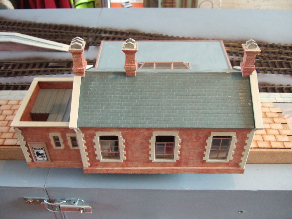

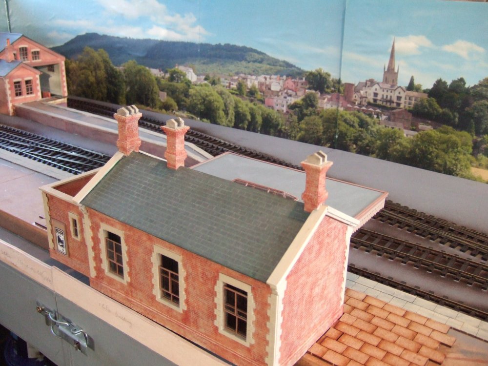

Irishrailwayman Posted October 4, 2021 Author Posted October 4, 2021 7 minutes ago, TimO said: Good to see the progress on this layout. The buildings are looking at home here. As Noel says I see the DMC school of wiring but are you using DCC controlled point motors or have you control modules to install. I’m also interested to know what length of train can use the platform? Is it designed for a GWR ‘B’ set? Hi Tim. I built the buildings from kits to look like a "family" using the same paint scheme and adding quoins which differs from the original instructions. I have used Cobalt digital point motors to be controlled by DCC Roco/Fleischmann Z21 system. The platform will indeed take a pannier and a two coach GWR "B" set. Progress has slowed for now as I prepare for Wexford MRC's Open Day. 1 1 Quote

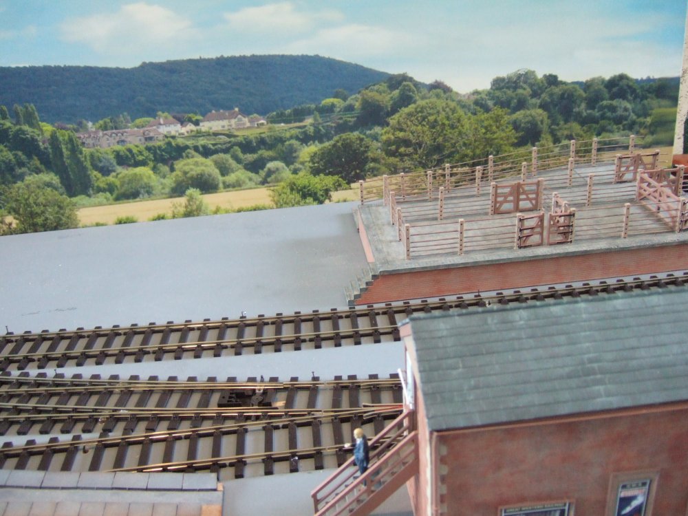

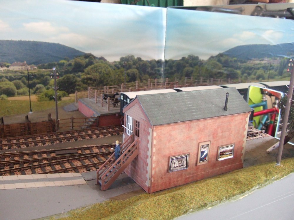

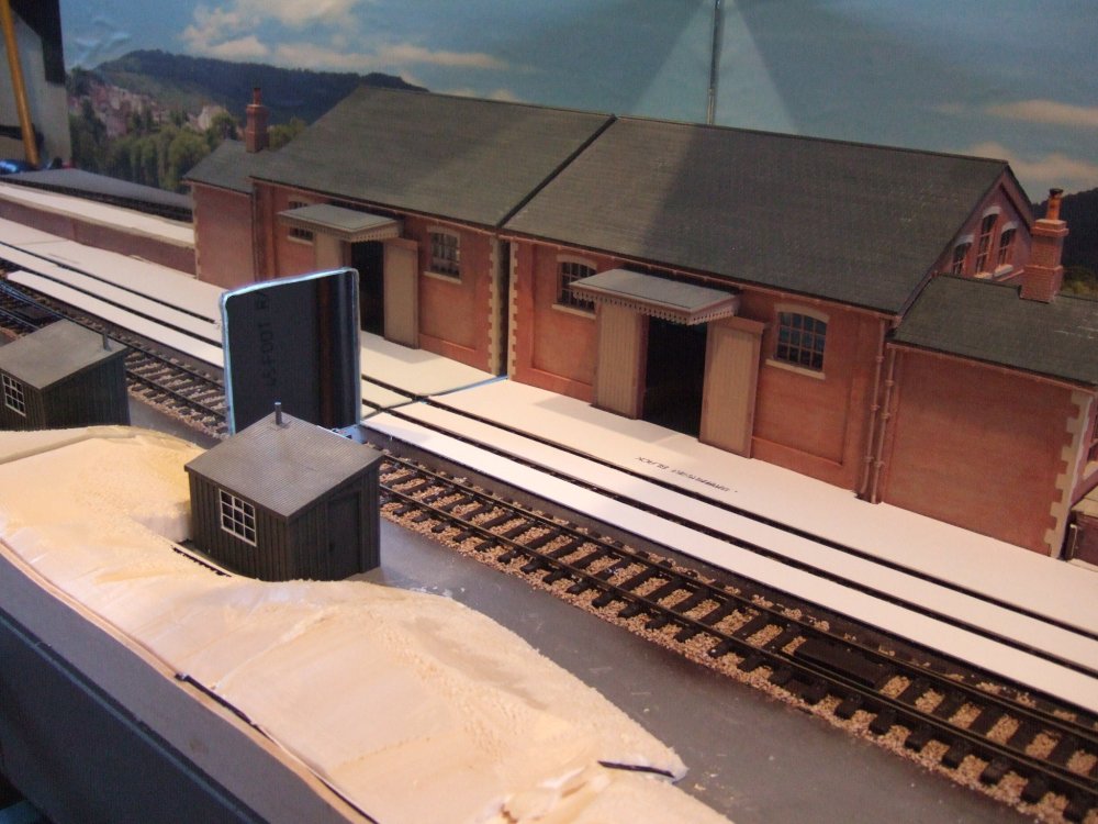

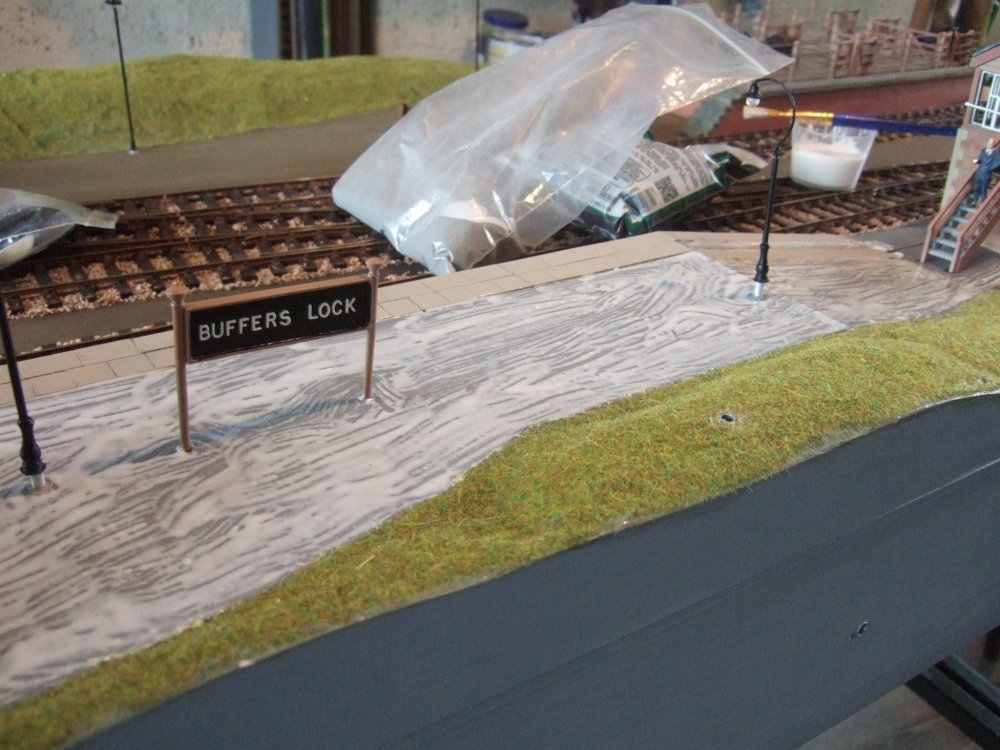

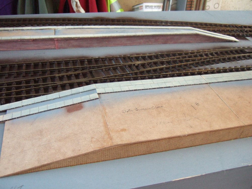

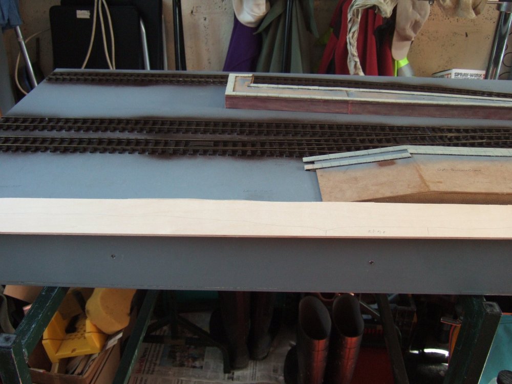

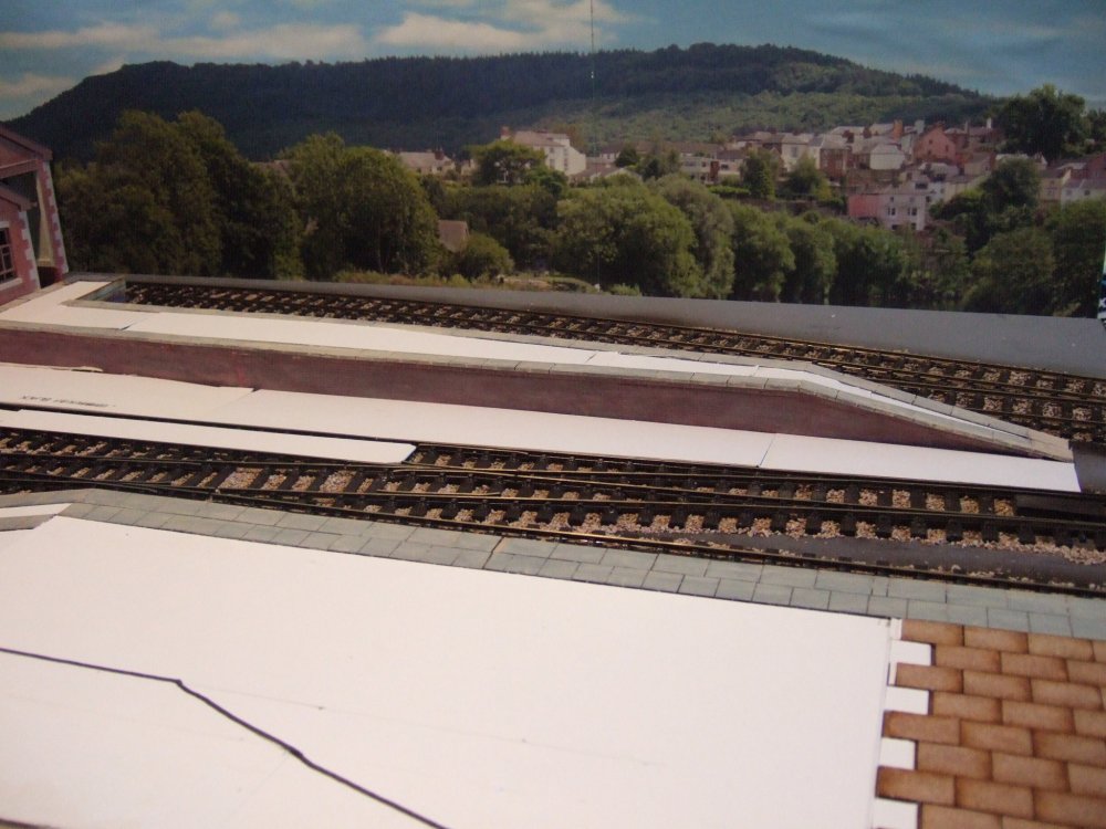

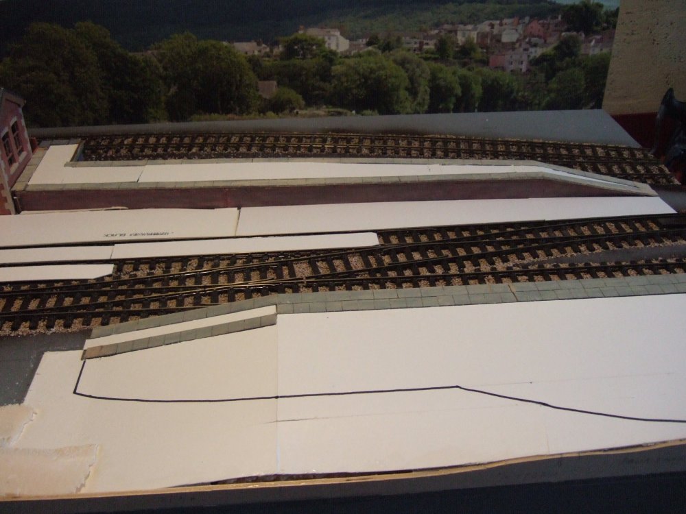

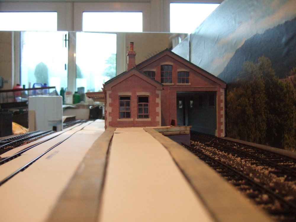

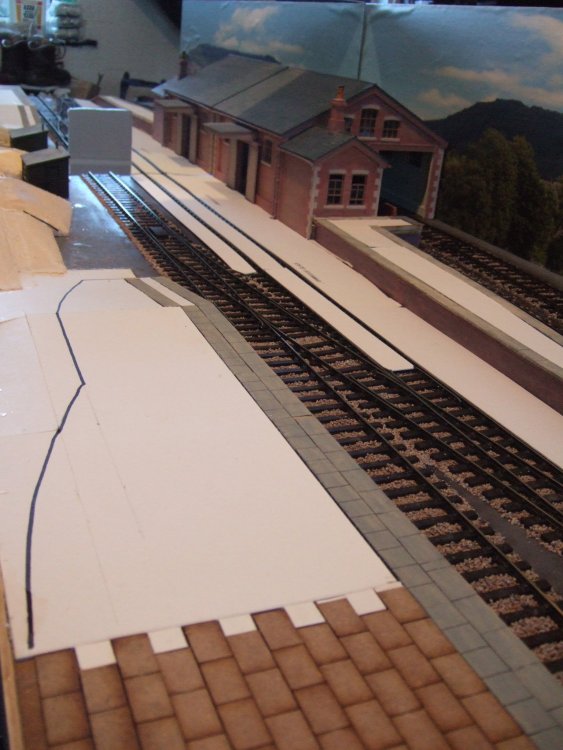

Irishrailwayman Posted December 7, 2021 Author Posted December 7, 2021 More progress on the layout with the (removable) side-scene mirrors and back-scene fitted allowing the buildings to be set out to plan the next stages of ballasting and scenic base preparation: 5 Quote

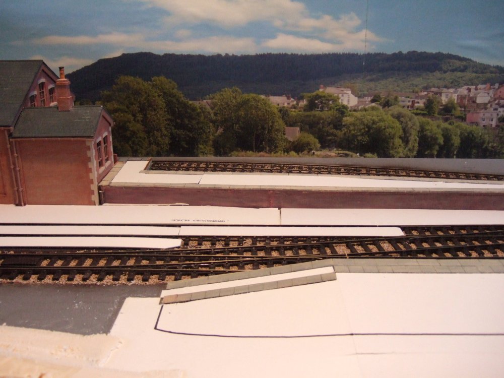

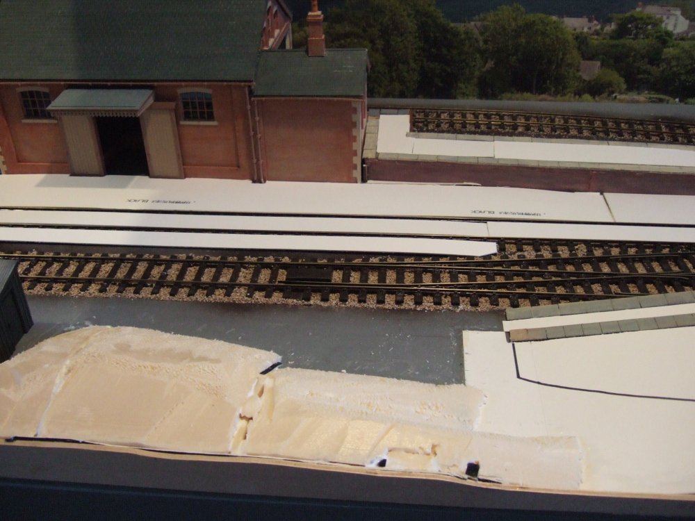

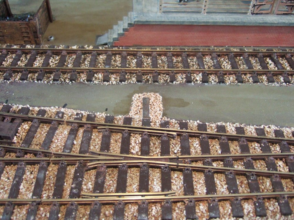

Irishrailwayman Posted December 9, 2021 Author Posted December 9, 2021 Ballasting completed and scenic base work in development on the shorter 4 foot board of the layout: 5 Quote

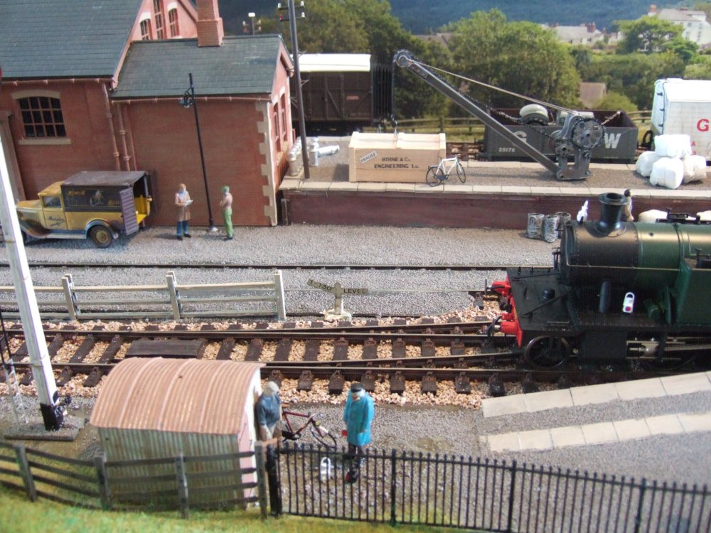

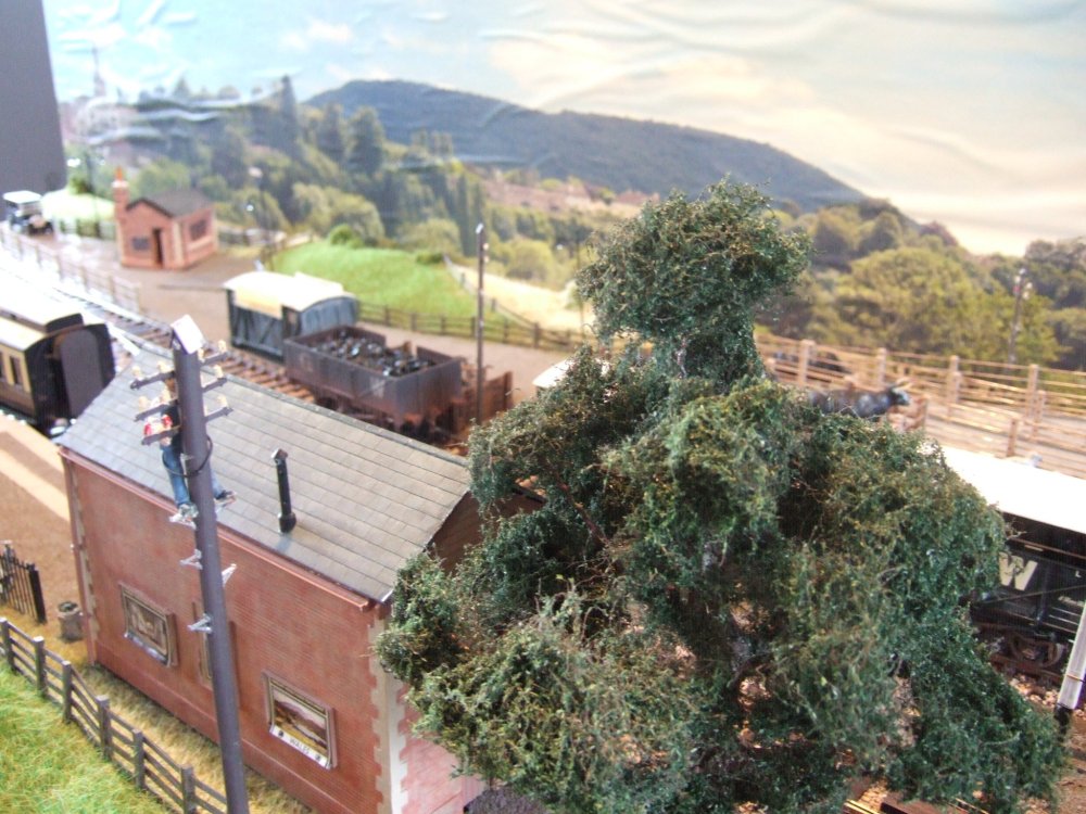

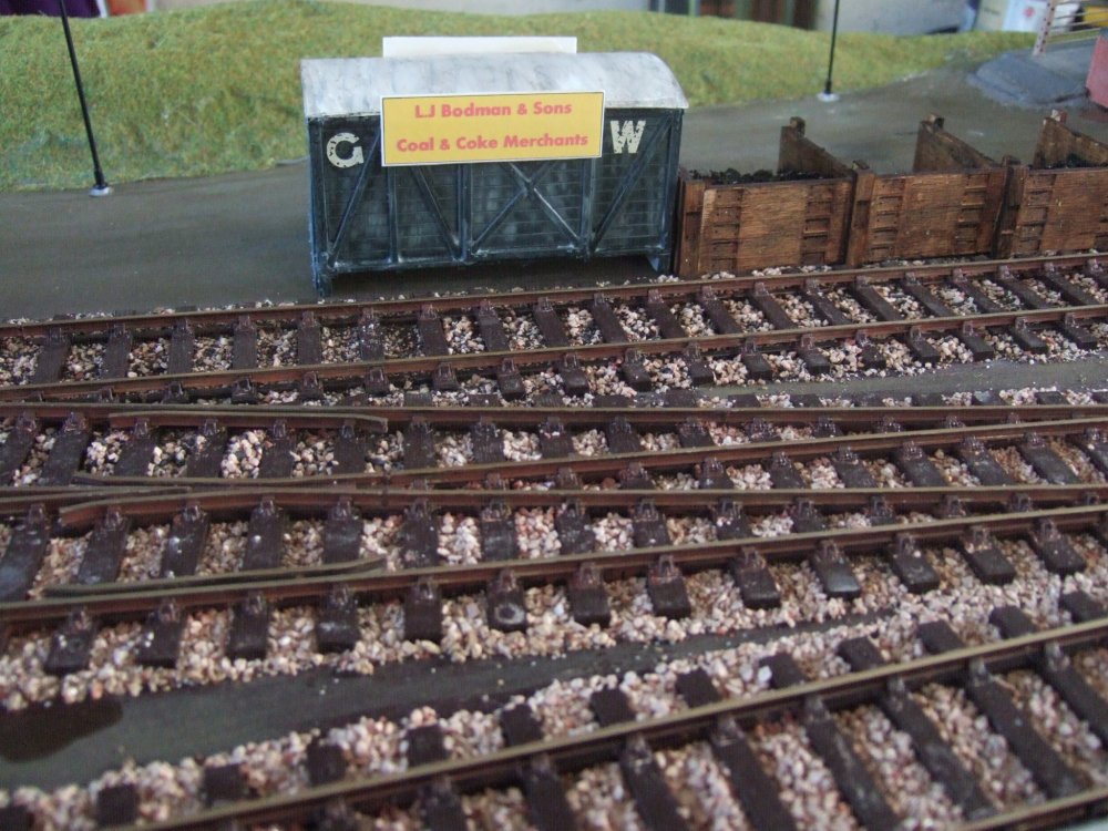

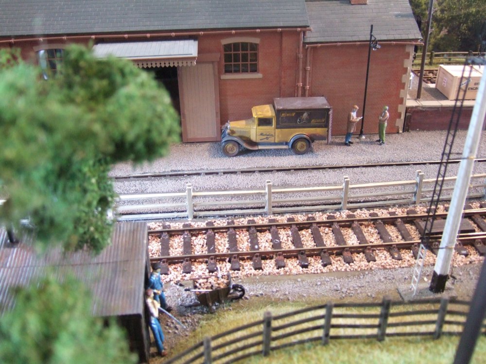

Irishrailwayman Posted February 25, 2022 Author Posted February 25, 2022 Development of "Buffers Lock" is progressing: 3 Quote

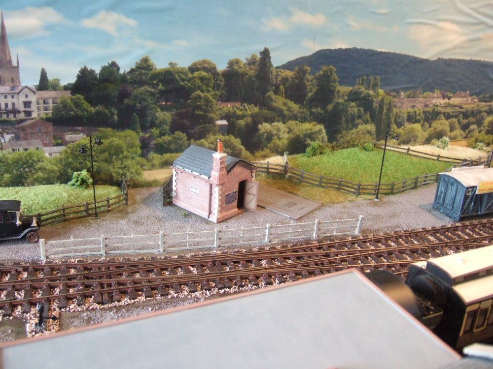

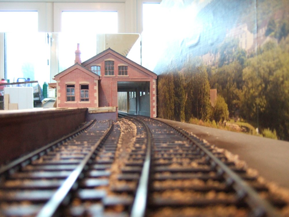

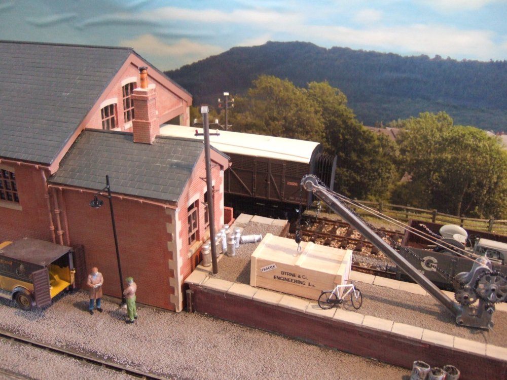

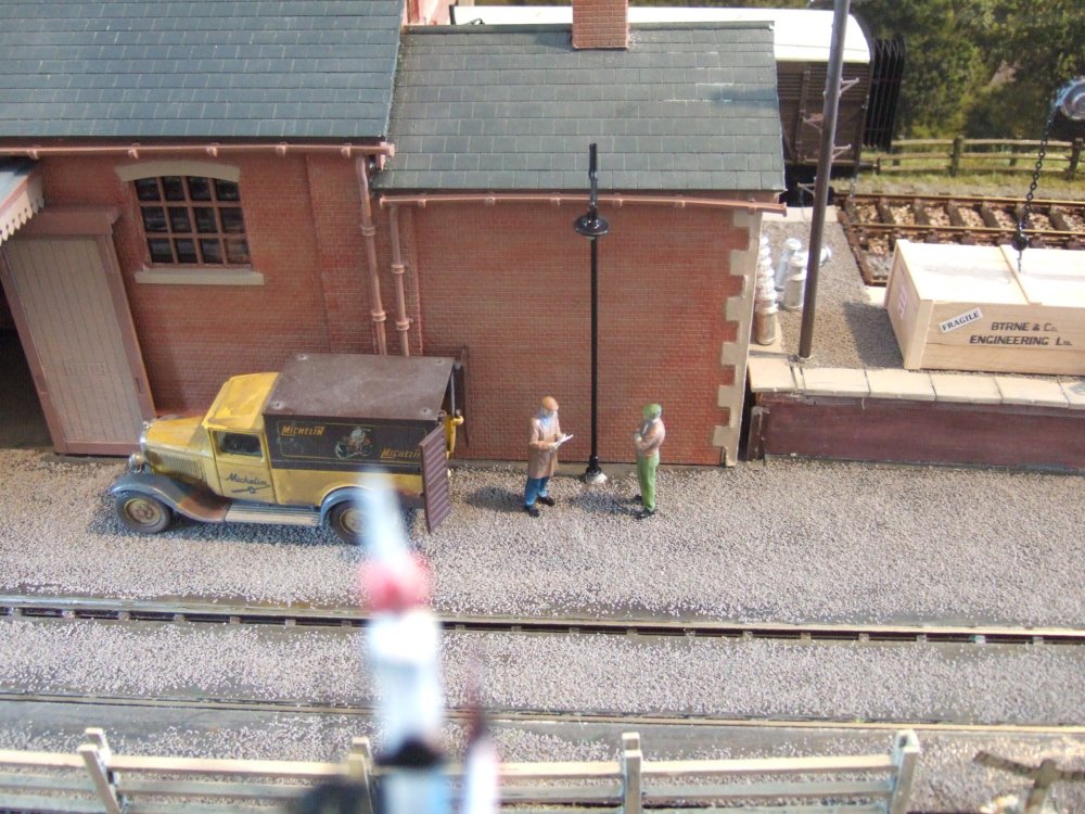

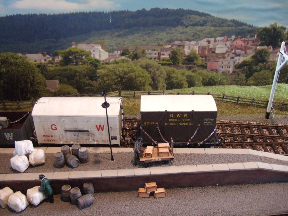

Irishrailwayman Posted March 12, 2023 Author Posted March 12, 2023 Buffers Lock is nearing completion ready for its debut exhibition at Wexford on 30th April/1st May 2023! 6 Quote

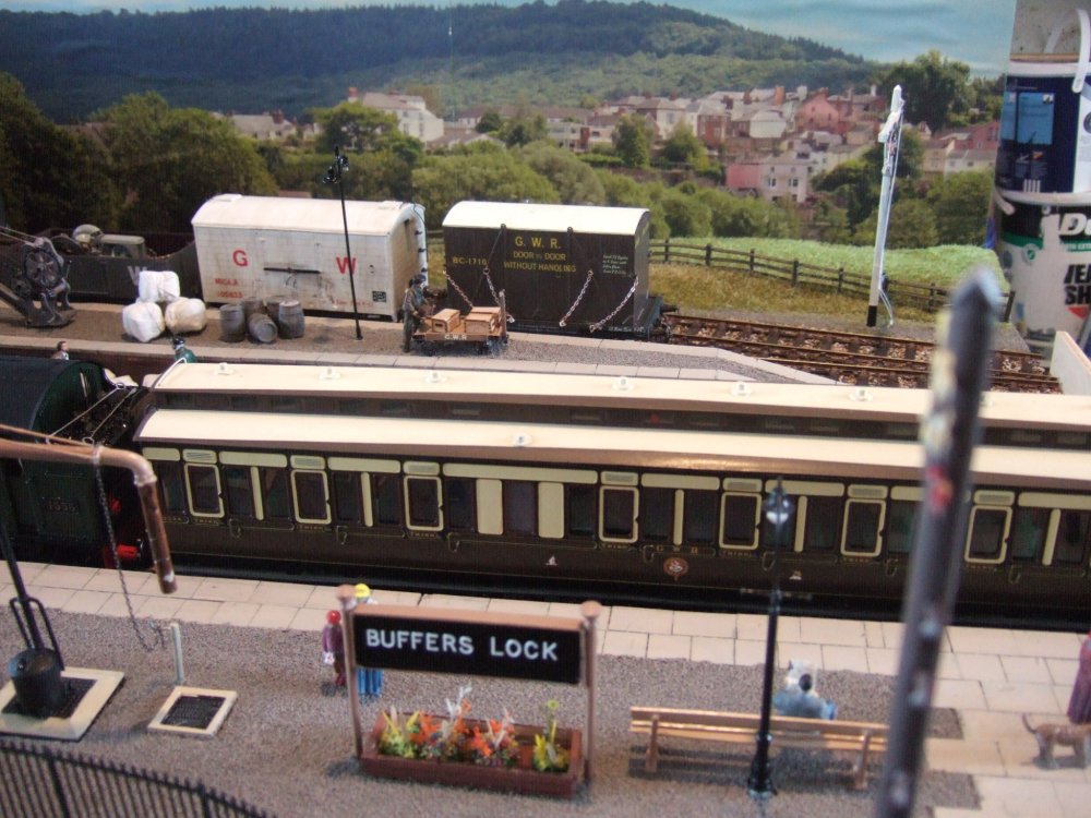

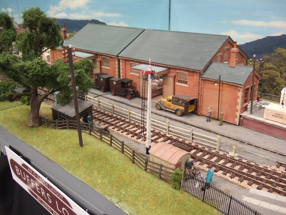

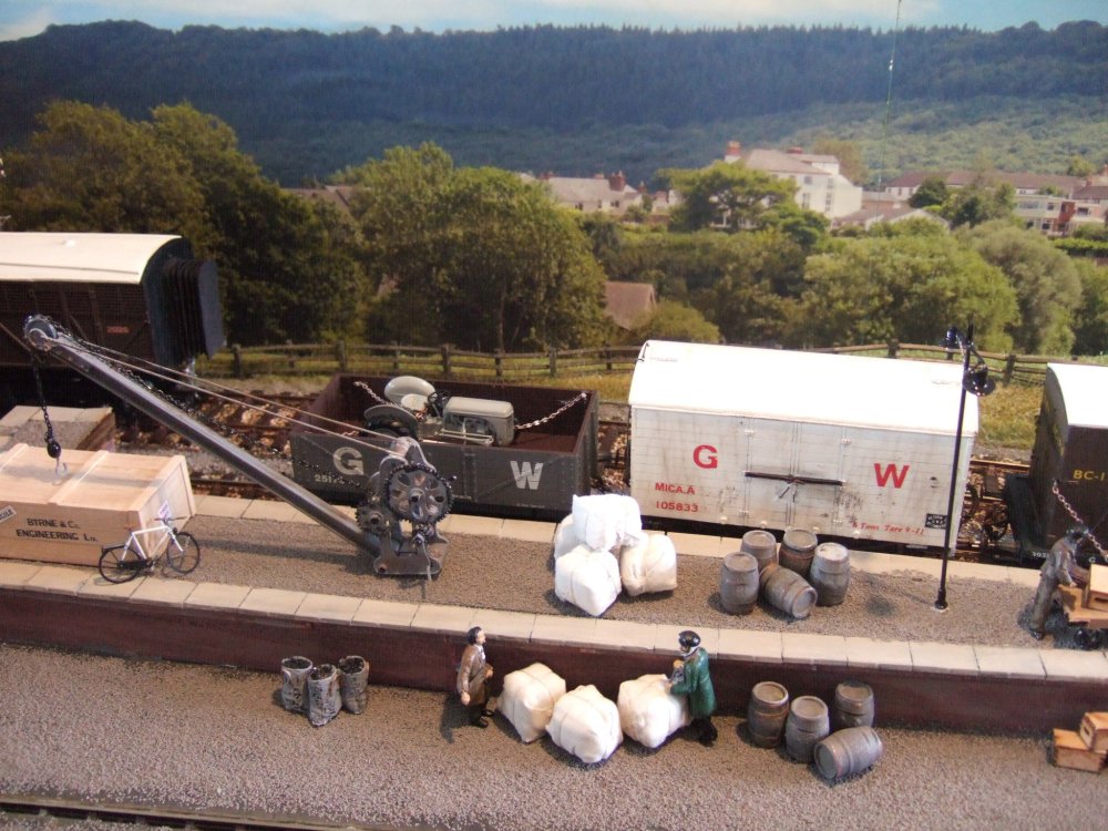

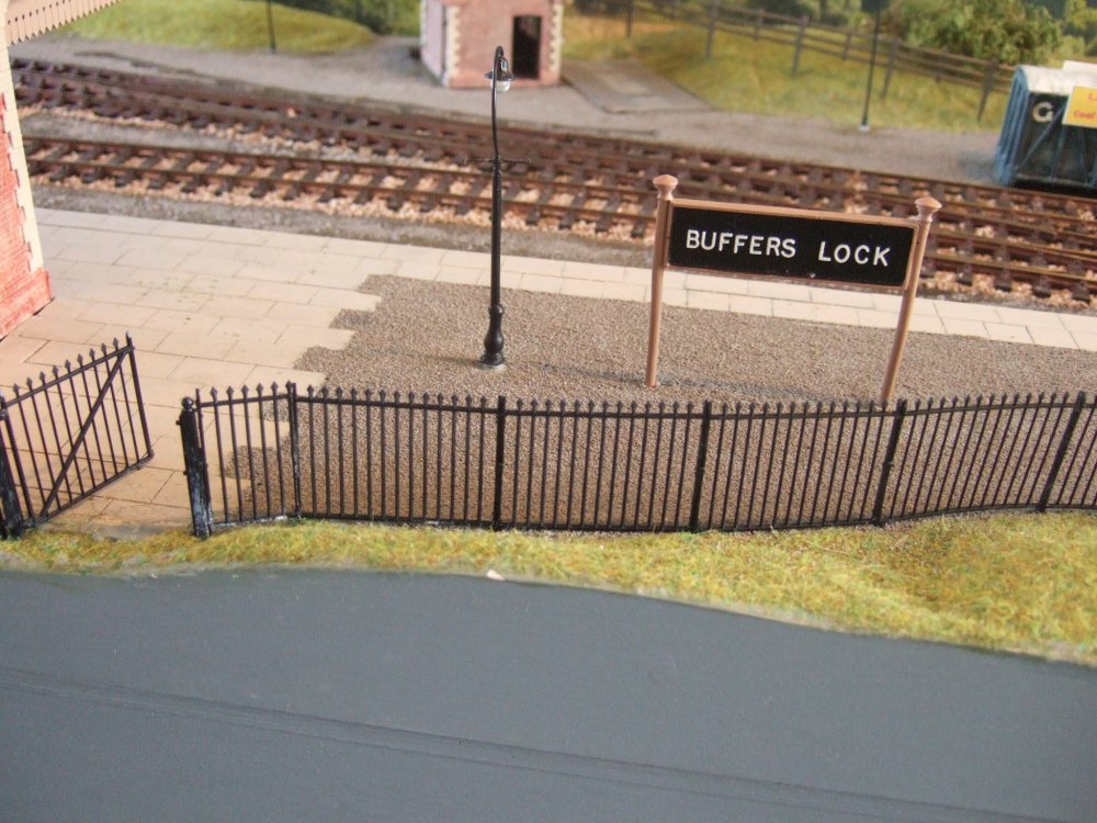

Irishrailwayman Posted March 17, 2023 Author Posted March 17, 2023 "Buffers Lock" is pretty much good to go for its debut exhibition at Wexford on April 30th/May 1st: 8 1 Quote

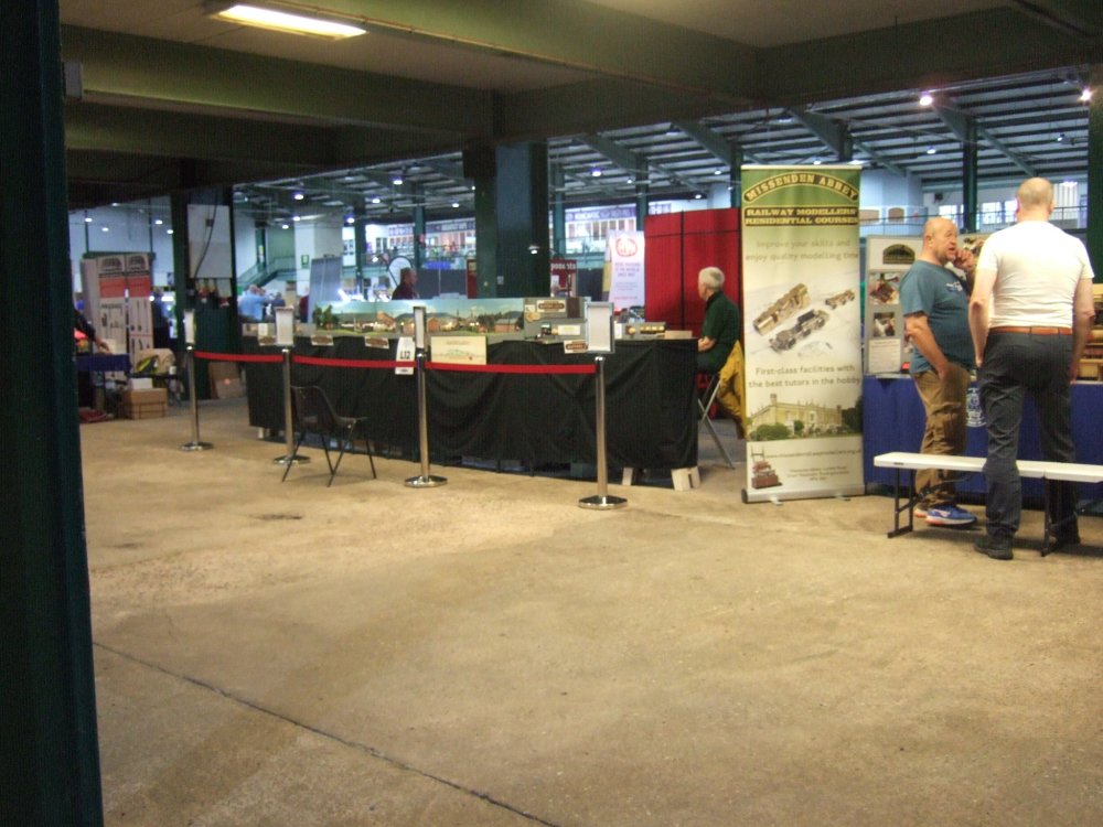

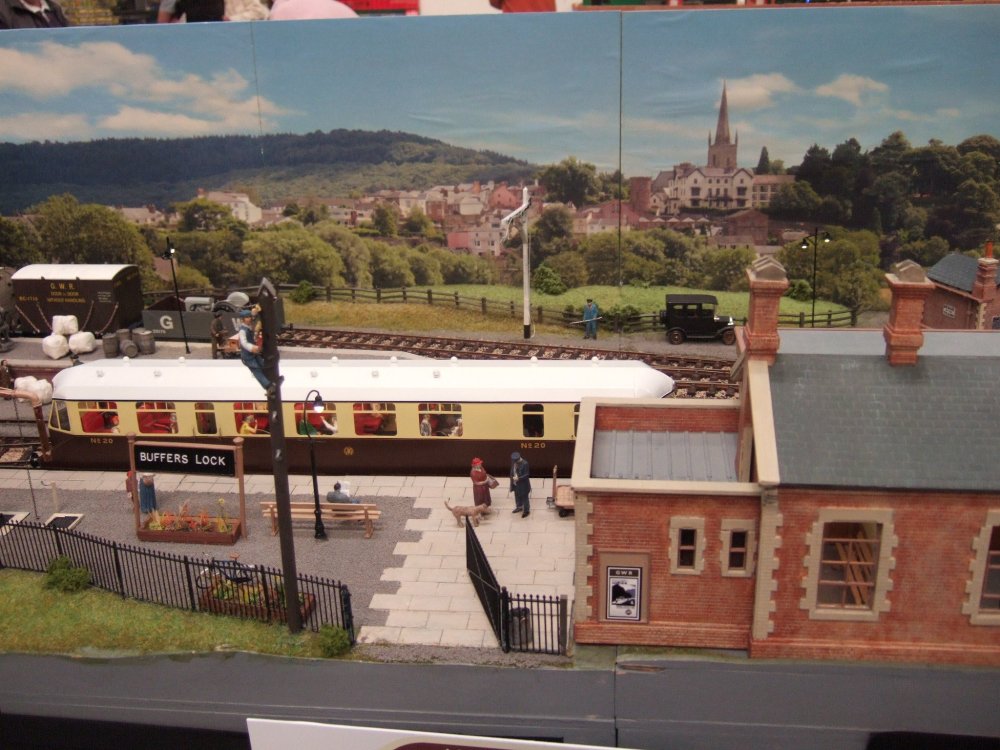

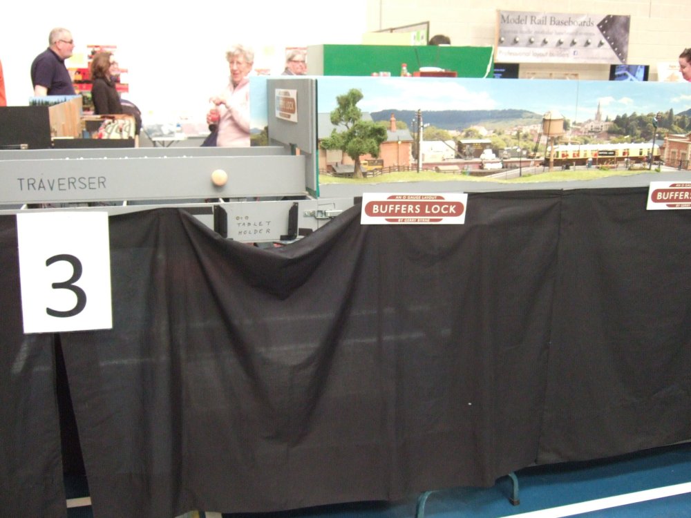

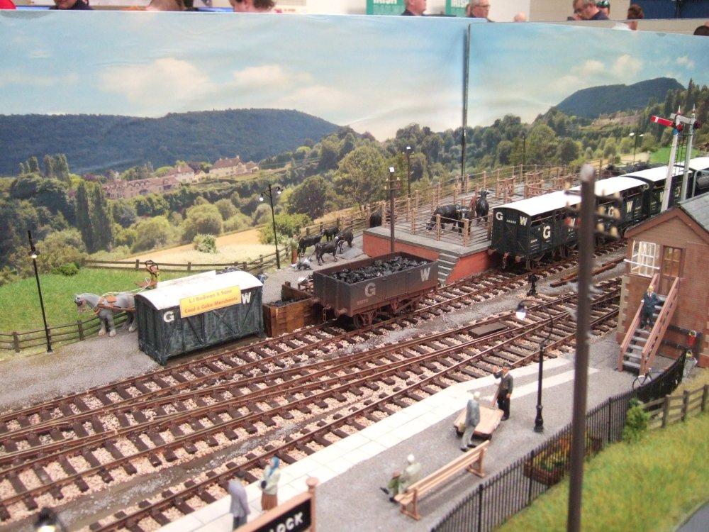

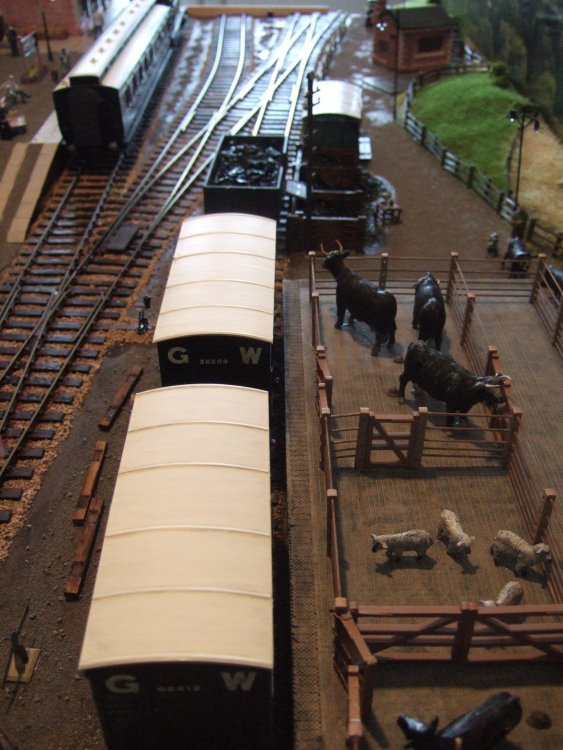

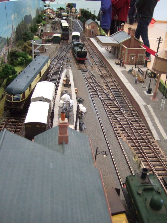

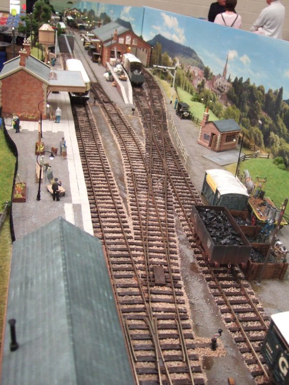

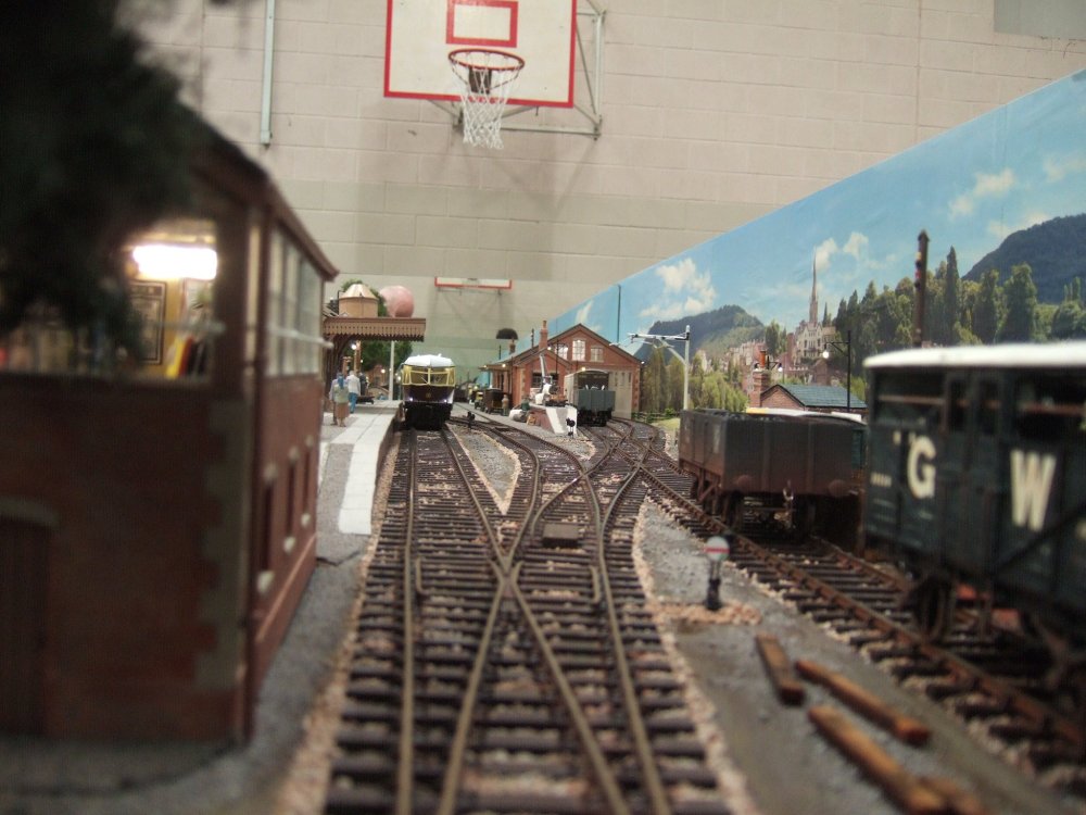

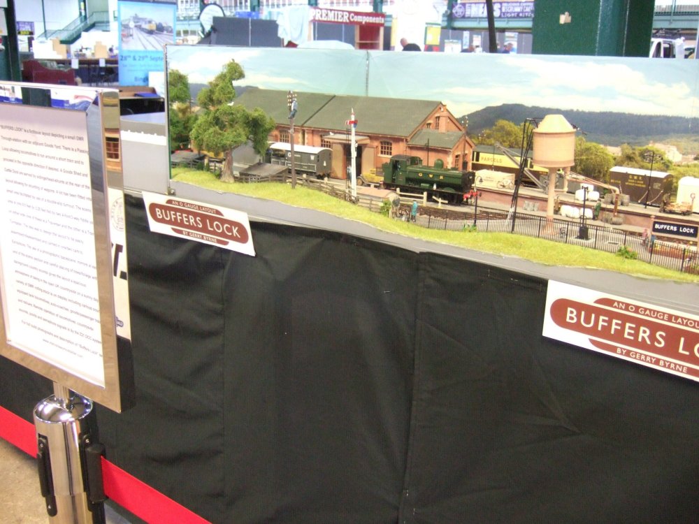

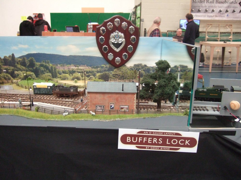

Irishrailwayman Posted April 30, 2023 Author Posted April 30, 2023 A few views of the debutante at the Wexford MRC Exhibition 2023: This is the first time all four boards were up together (insufficient room at home) but it provided a learning curve for mimicking prototypical operations. BTW great turnout for the show and everyone seemed to be enjoying themselves. 4 2 Quote

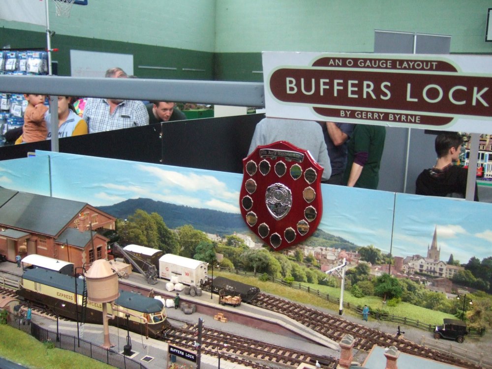

Irishrailwayman Posted May 1, 2023 Author Posted May 1, 2023 I am honoured that "Buffers Lock" was awarded Best Layout - the Jim Kearns Memorial Award - at its debut exhibition in Wexford! 12 Quote

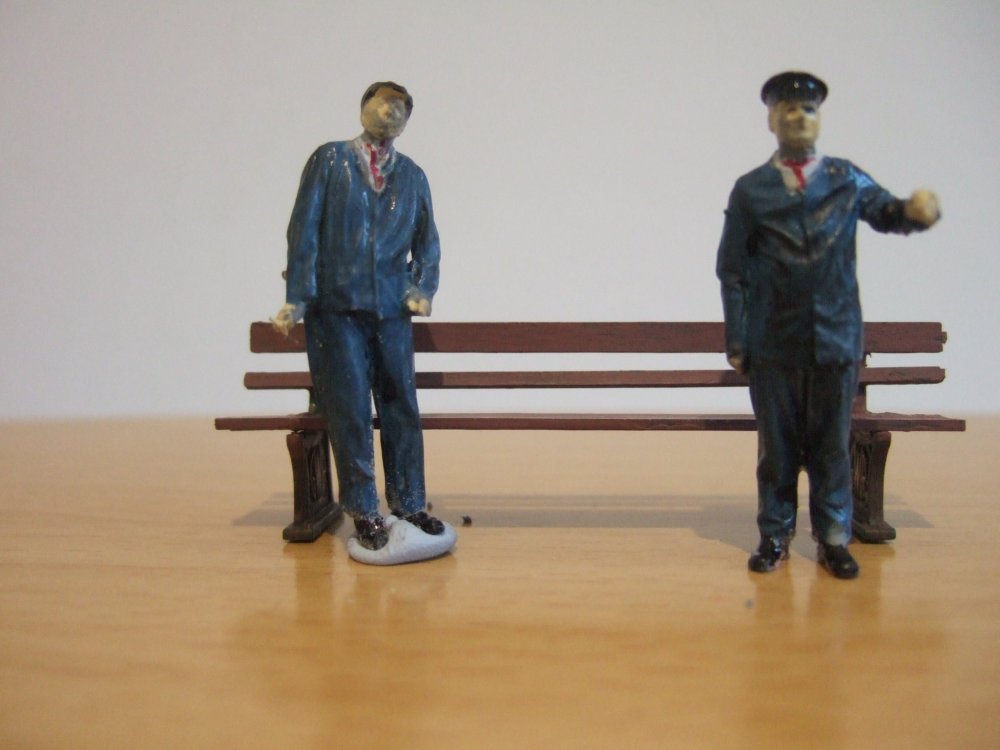

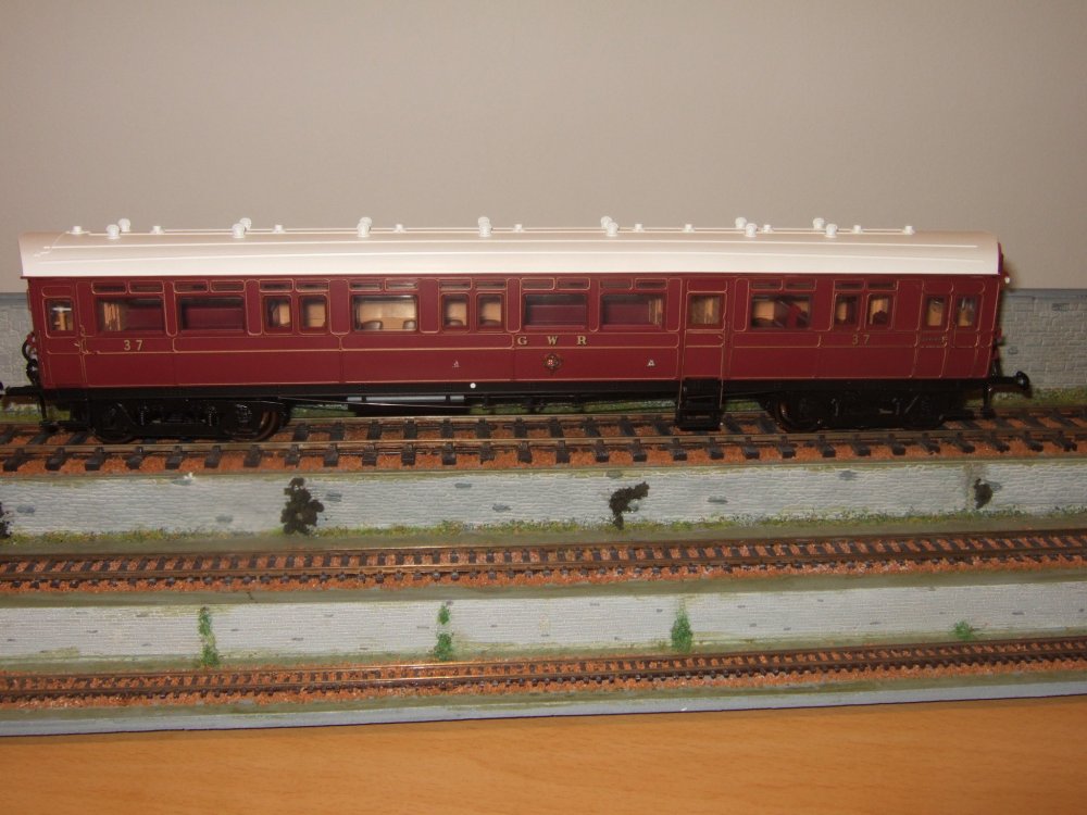

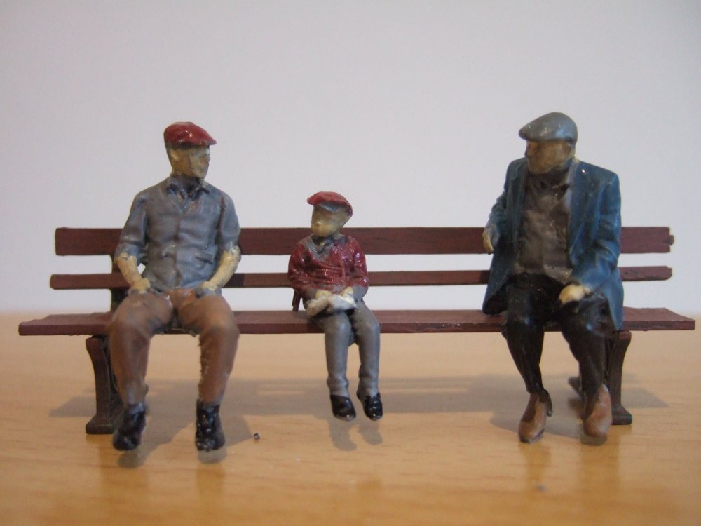

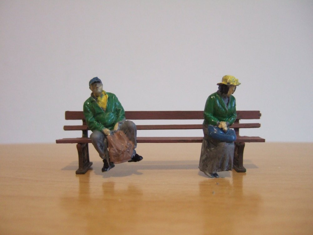

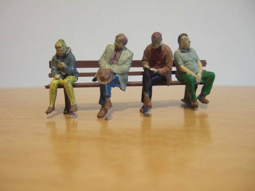

Irishrailwayman Posted December 27, 2023 Author Posted December 27, 2023 Over the holidays I have been painting some ModelU3d figures for a new GWR autocoach featuring a Crimson Lake/gold lined livery: 4 Quote
Gabhal Luimnigh Posted December 27, 2023 Posted December 27, 2023 Nicely done lad, a steady hand and a tiny bit of patience no doubt. 1 Quote

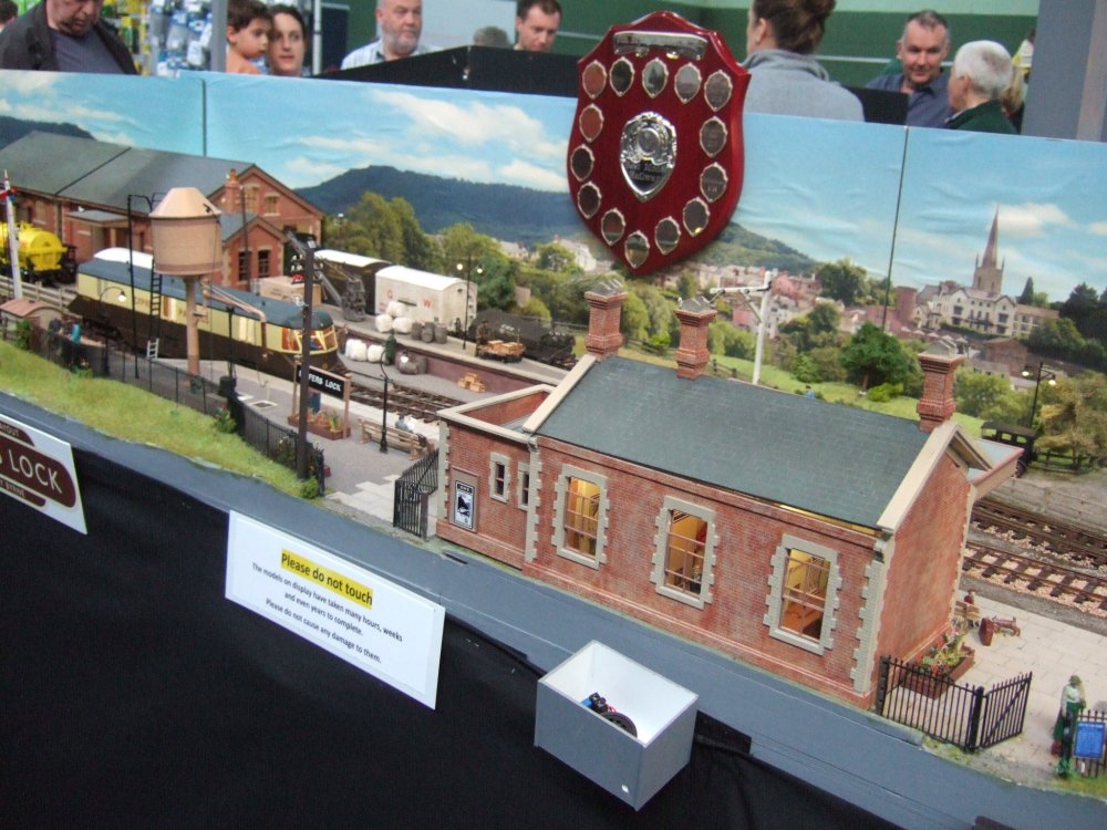

Irishrailwayman Posted April 4, 2024 Author Posted April 4, 2024 We had a ball showing "Buffers Lock" at the Bangor, N.I. Exhibition in March 2024. Delighted to have been conferred with the Best Large Scale Layout Award. 10 2 Quote

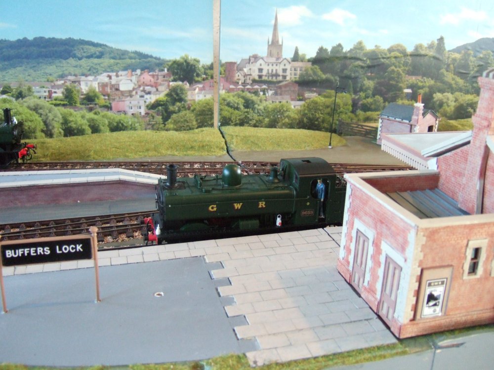

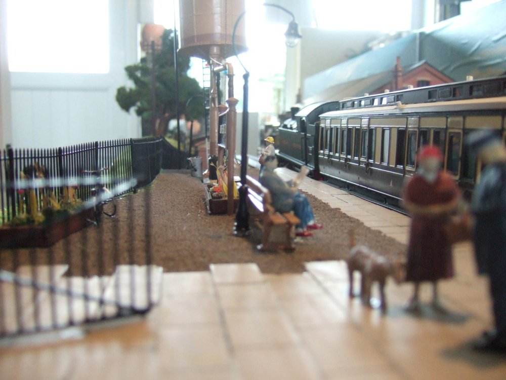

Irishrailwayman Posted September 11, 2024 Author Posted September 11, 2024 (edited) "Buffers Lock" featured at Gauge O Guild's Guildex 2024 exhibition at Stafford last weekend as reported elsewhere on the Forum. I'm including a few extra views here for the record. Edited September 11, 2024 by Irishrailwayman 5 Quote
Irishrailwayman Posted October 28, 2024 Author Posted October 28, 2024 "Buffers Lock" has won the judges' Best in Show Award at the MRSI Dublin Exhibition 2024! This was the layouts fifth public outing and third award. I am honoured and delighted needless to say. Thanks to all who assisted me over the weekend especially my wife Jenna. 16 Quote
