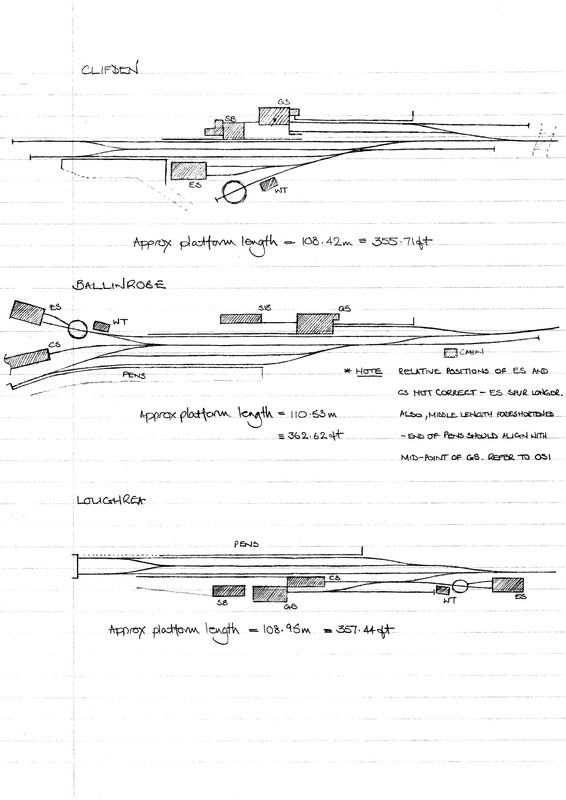

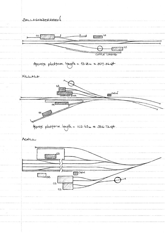

2996 Victor Posted April 4, 2022 Author Posted April 4, 2022 (edited) A bit of rummaging today turned up the sketched plans of the MGWR's branch line termini I made a couple of years ago from the OSI archive plans. Not to scale of course, and the platform lengths are only very approximate, but here they are if anyone's interested: And here's my first go at a track plan for my project: Very much a first draft and most definitely not to scale!!! I'm imagining a platform a scale 250 feet long, about 3'3" in model terms - a train of four 6-wheelers comes in at about 120 feet long, or about 18", as far as I can ascertain, so there may be scope for a tiny bit more compression. I reckon I've undersized the turntable by quite a bit, in which case the carriage/nag dock won't fit as I've sketched it, but as I say its just a first stab! I'd be very grateful for any thoughts or suggestions on how to improve it and make it more realistic. In other news, my Alphagraphix order is confirmed, I've ordered a copy of Rails through Connemara, and the aforementioned rummaging also turned up three-point and roller track gauges and a back-to-back gauge that I'd completely forgotten about. Happy days! Question time! What was the usual distance between running lines? 6 feet? Was there a "standard" platform width on the MGWR? What was a the usual turntable diameter? I'm guessing at around 50 feet as that would accommodate smaller tender locomotives. Many thanks and all the best, Mark Edited April 4, 2022 by 2996 Victor 3 3
David Holman Posted April 4, 2022 Posted April 4, 2022 Some great examples there, Mark, but I like yours better! The problems with all those termini is the amount of space they need, so yours is a nice compromise, while still incorporating all the key features. Think you are right about the TT and track spacing. Being built while still ruled from London, suspect the platform widths would be the same, so a minimum of six feet for a single platform and twelve for a double faced one. In practice they were wider on all but the most basic stations, so am sure you will have enough space. 1 1
2996 Victor Posted April 4, 2022 Author Posted April 4, 2022 1 hour ago, David Holman said: Some great examples there, Mark, but I like yours better! The problems with all those termini is the amount of space they need, so yours is a nice compromise, while still incorporating all the key features. Think you are right about the TT and track spacing. Being built while still ruled from London, suspect the platform widths would be the same, so a minimum of six feet for a single platform and twelve for a double faced one. In practice they were wider on all but the most basic stations, so am sure you will have enough space. That's brilliant, David, thank you! And thank you for your very complementary words about my layout plan - greatly appreciated! I'm always conscious of trying to cram in too much, and Irish stations are pretty spacious, aren't they? Incidentally, I really wanted to include a carriage dock like yours on Belmullet. By the way, I'm just re-reading the RM article on Fintonagh: fab stuff! Going to look for the Arigna articles now! Cheers, Mark 1 1
jhb171achill Posted April 4, 2022 Posted April 4, 2022 3 hours ago, 2996 Victor said: A bit of rummaging today turned up the sketched plans of the MGWR's branch line termini I made a couple of years ago from the OSI archive plans. Not to scale of course, and the platform lengths are only very approximate, but here they are if anyone's interested: And here's my first go at a track plan for my project: Very much a first draft and most definitely not to scale!!! I'm imagining a platform a scale 250 feet long, about 3'3" in model terms - a train of four 6-wheelers comes in at about 120 feet long, or about 18", as far as I can ascertain, so there may be scope for a tiny bit more compression. I reckon I've undersized the turntable by quite a bit, in which case the carriage/nag dock won't fit as I've sketched it, but as I say its just a first stab! I'd be very grateful for any thoughts or suggestions on how to improve it and make it more realistic. In other news, my Alphagraphix order is confirmed, I've ordered a copy of Rails through Connemara, and the aforementioned rummaging also turned up three-point and roller track gauges and a back-to-back gauge that I'd completely forgotten about. Happy days! Question time! What was the usual distance between running lines? 6 feet? Was there a "standard" platform width on the MGWR? What was a the usual turntable diameter? I'm guessing at around 50 feet as that would accommodate smaller tender locomotives. Many thanks and all the best, Mark Superb plan, Mark - very well thought out and very realistic. To your questions: (1) Yes, 6ft typically, not less. Sometimes more within stations. (2) No! At termini, most were quite wide - up to double track width is a reasonable rule of thumb, though Kingscourt, Achill, Clifden, Kingscourt & Edenderry less so. (3) It varied. From perusal of MGWR boardroom minute books, which I have consulted quite a few times over the last 30 years, 40-45ft was normal. On a branch, 50ft would be a bit of an overkill. Might be relevant here to mention that "Rails To Achill", currently sold out, is going to go to a 3rd edition, according to the publisher. 1
David Holman Posted April 4, 2022 Posted April 4, 2022 Interesting, JB. My 7mm TTs have all been around 42', being mostly adapted 00 ones. My G2 fits, just, but Wolf Dog barely, so that extra 3' would make all the difference! 2
2996 Victor Posted April 5, 2022 Author Posted April 5, 2022 12 hours ago, jhb171achill said: Superb plan, Mark - very well thought out and very realistic. To your questions: (1) Yes, 6ft typically, not less. Sometimes more within stations. (2) No! At termini, most were quite wide - up to double track width is a reasonable rule of thumb, though Kingscourt, Achill, Clifden, Kingscourt & Edenderry less so. (3) It varied. From perusal of MGWR boardroom minute books, which I have consulted quite a few times over the last 30 years, 40-45ft was normal. On a branch, 50ft would be a bit of an overkill. Might be relevant here to mention that "Rails To Achill", currently sold out, is going to go to a 3rd edition, according to the publisher. Many thanks Jonathan, that's very kind of you - it can be difficult to come up with a plausible plan that echoes prototype practise while not being too sprawling or contrived, so your and David's affirmations are extremely welcome. Thanks also for your answers to my latest round of questions: also hugely appreciated. I'm working up a scale plan so its good to know I can reduce the size of the TT slightly. I've allowed for a 20-foot-wide platform, which seems to look okay, although its difficult to be sure! I've actually got a copy of Rails to Achill, but like most of my references, I'm busy re-learning where everything is! Kind regards, Mark 1
