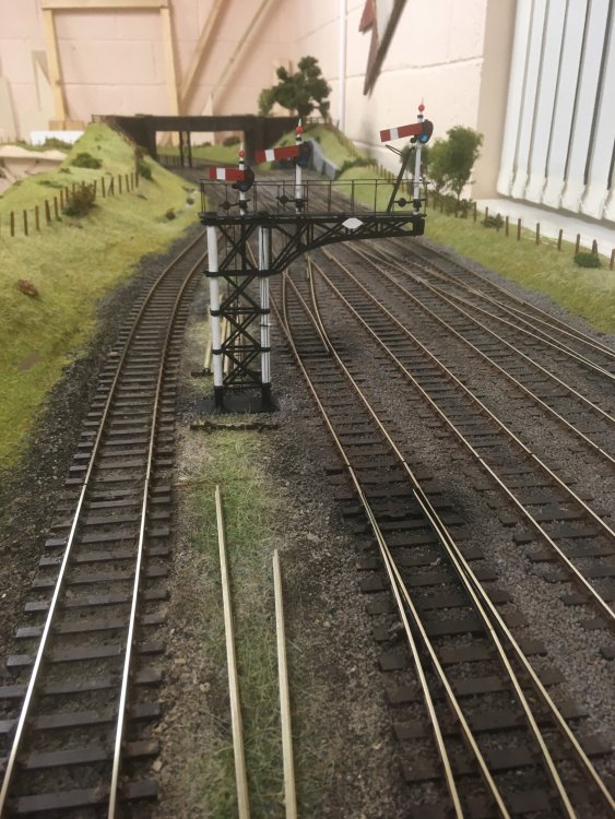

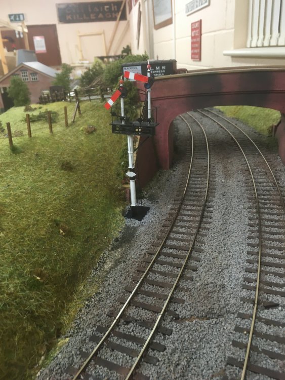

0 Noel Posted April 28, 2020 Posted April 28, 2020 5 hours ago, scahalane said: I'm looking at buying a 3d printer anybody on here have any experience or advise. It needs to be able to handle a fairly large print area (300mm X 300 X 300) or there abouts. I'm thinking FDM rather than Resin but still open to suggestions. Here are some servo operated ground signals printed by @Junctionmad on his 3D printer which he build himself from a kit. Signal gantry and servo operated signals 3D printed by @Junctionmad (Dave) Junction Signals 1 2 Quote

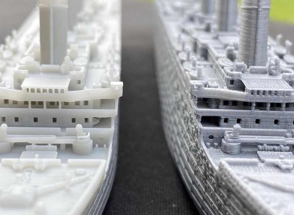

0 GSR 800 Posted April 29, 2020 Posted April 29, 2020 (edited) 23 hours ago, Glenderg said: The resin isn't brittle at all, I'm just ham fisted at times ! The one thing with Prusa is that Josef Prusa always makes upgrades available, so if anything interesting develops, he'll make it available for users of older models. ultimately it boils down to what you want to get out of it - If you want to make fiddly parts or prototypes then resin is the way. If you want big and can handle visible layer lines and sanding and all that jazz, FDM. Have to ask, what are you trying to print ? Buildings? Seconded re resin here. There's a company currently trying to make a game for Titanic, Titanic Honour & Glory with a completely accurate interior and exterior 3D model for said game. I've followed with much interest, and they've released model 3D printed liners in 1/1000. They are currently using the more conventional version, but are now experimenting with resin printing, and well the results speak for themselves. Edited April 30, 2020 by GSR 800 4 Quote
