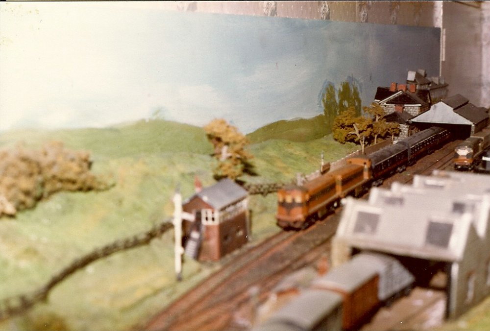

I moved from OO to N gauge during the late 1970s mainly because I did not have space for a layout  and mistaken belief that I would be less tempted to attempt scratchbuilding/kitbashing locos and rolling stock in N gauge, which was soon proved completely un-true.
I ended up building an end-to end shelf layout based on current CIE practice using re-painted and modified Lima, Graham-Farish, Minitrix and Peco stock which passed the 2' rule.
I originally re-painted the Lima BR Class 31 as an A Class and the Lima German center cab diesel as the GN Mak, but eventually ended up re-building Atlas American SW 1500 switcher locos into 121 & 141 Class diesels which became the mainstay of operations. The 141 and 001 had scratchbuilt plasticard bodies, while I fitted scratchbuilt plasticard cabs to the 121s and extended the bonnets with plasticard.
my "Craven" coaches were simply re-painted Minitrix MK1s, though my "BR Vans" were kitbashed from Lima Mk1 coaches which had a narrower profile than the Minitrix coaches. Wagons were originally re-paints but some were later fitted with .010" plasticard overlays to look like the plywood bodied H Vans.
The N gauge was abandoned following a house move during the early 80s and have mainly focused on kit and scratchbuilding in 4mm, but still have a soft spot for N scale particularly American .
N gauge really come into it own when you don't try and fit too much into a relatively small space, basically the same amount of track as a similar sized OO or HO gauge layout.

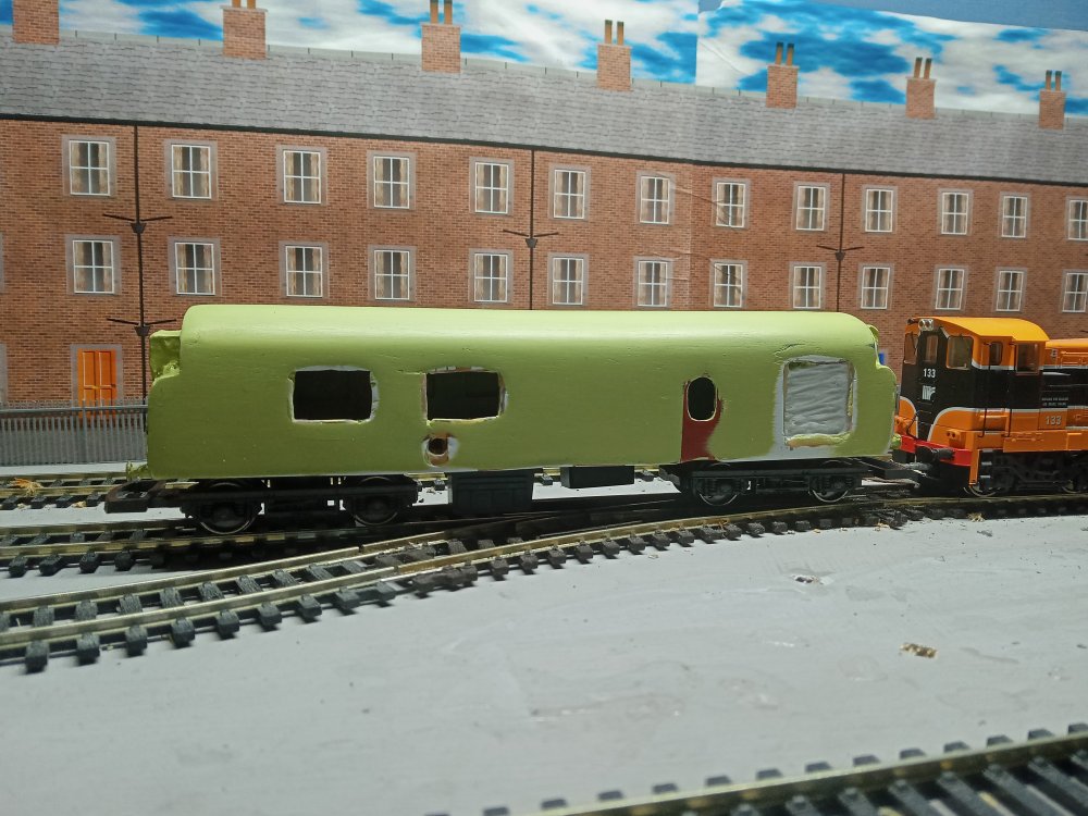

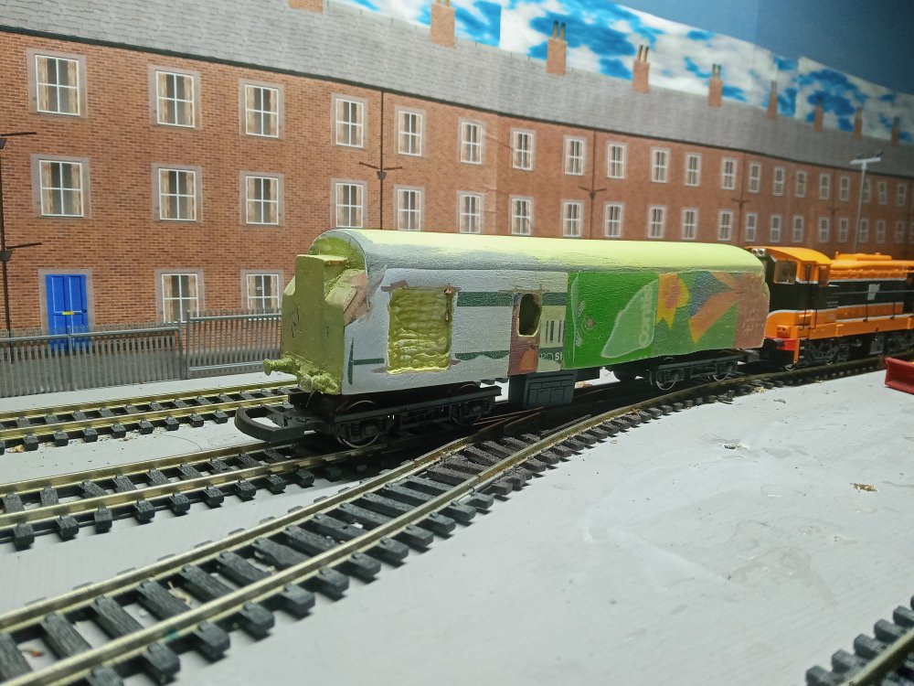

spent today cutting up an old triang mark 1 and adding sides to give me a rebuilt dutch van shell,  very primative looking right now but im confident i can turn it into something nice looking.
wasnt sure i had the proportions right but the more i am looking at it the more it seems like they are
adding the windows and doors seems like its going to be the hard part.
the bogies are off a lima mark 2 but its all sitting on a damaged project 42 chassis i had lying about
  • Like 6
  • WOW! 2
Pretty delighted with how its shaping up. going to need a mountain of filler though as i overdid it on the windows. (eye it up cut it and then measure twice🤣)
Went back to the lima mk2 and cut out the toilet windows to fill in my oopsie, also cut out the battery boxes and put them underneath and took the metal weight and fit it inside of the shell.
Pretty much considering this side done, besides the aforementioned fillering, and a fuel cap and the weird indent thing beside it. on the other side I just have to add the doors in and source egv grilles from somewhere.
its sitting a little high at the moment but the bogies are running on what seem to be quite oversized oldschool wheels, Gonna borrow some wheels from a dapol kit to see how it sits before i do anything further to address this as the ride height will change when i fit those. Will also look at replacing the D link with a magnetic coupling for overall fleet compatibility.
im not too bothered about getting the roof detail correct as this is just intended to be a quick and dirty build to fill a gap in my mk2 rake until somthing better is released and it will also give me a chance to practice my painting a little more.
  • Like 6

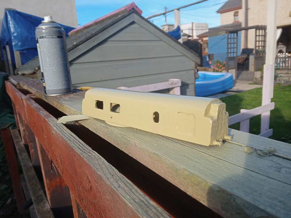

Dj sent me pics of his dutch van the other night so ive kinda just been obsessively adjusting this side trying to get everything to roughly where i would like it to be.
Having spent far too much time on the windows its a good relief to know the ends and the other side should take far much less fettling to get everything as i would like them to be.
high build primer is great for highlighting and filling any imperfections, should feel lovely once it dries and i get to wetsand it.
still on the lookout for some nice egv grilles, looking like 3d print is gonna be my best option.
Edited by Sean
IMG20230708014741_01.thumb.jpg.81c45492df82b962afd6faa8dd8b75cc.jpgIMG20230708014732_01.thumb.jpg.99a8d04ef5875f1cfddbd9a269470f34.jpg

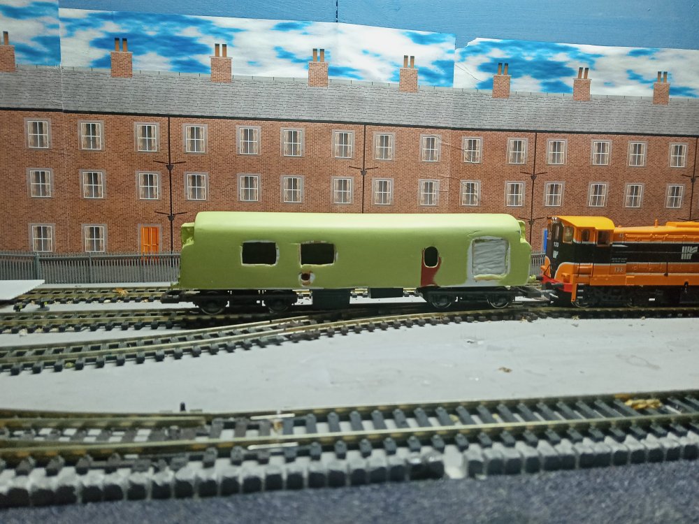

quite pleased with how shes looking after the wet sand and im finally finding myself happy with the window proportions although they are gonnna need another spot of filler into the corners for one last tidy up, that means im happy to move onto the other 3 sides of the thing now which im anticipating wont take as long, the shoulder shape isnt final yet as i think its better to leave them and the 2 ends until last, the gangway into the luggage compartment also needs to be cut down a bit so ill tackle all this together as my last few jobs but im doing the other side first as i need to match up the doors when the door is still fresh in my mind.
found an engraver in the shed that apparently the mother bought from aldi at some stage, gonna try and engrave the EGV grilles, could be either delightful or a complete disaster.
Edited by Sean
  • Like 6

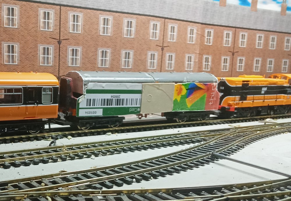

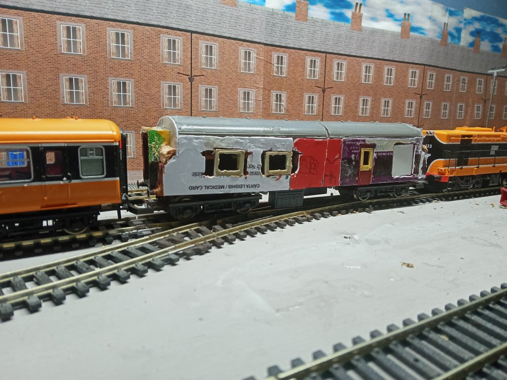

Not my favourite thing but sometimes ya gotta do what ya gotta do, and these are nice and simple so what better place to start.
went a bit overboard on the window so it will need a fill and profiling again lol
the shoulders are looking SHARP though :D
probabaly just a cd case or some shite, half considering a plastic chinese tub for slightly opaque/shaded windows since theres no real interior to speak of.
more worried about how ill get thing masked up for black and the best way to go about adding the lining stripes.

experimenting with the masking yesterday an today, this may not work out but so far is actually looking straight so i have some faith in the idea,I guess ill know in a few more hours haha.
Parking a coach at either end I am starting the mask on one of the coaches until i have the tape lined up perfectly with the livery stripes and then i am going and doing the exact same thing on the other coach but ignoring the van until i have either side perfectly leaving a little bit of slack in the tape.
when im happy with the alignment on the coaches i wheel them apart and let the tape naturally tighten up until all slack is gone and then I am gently pressing the tape into place, never seems to be straight the first time but its usually quiet close and at this stage if i need to adjust it im lifting the tape off the coach and reapplying it along the livery line which seems to begin to iron out all of the kinks.

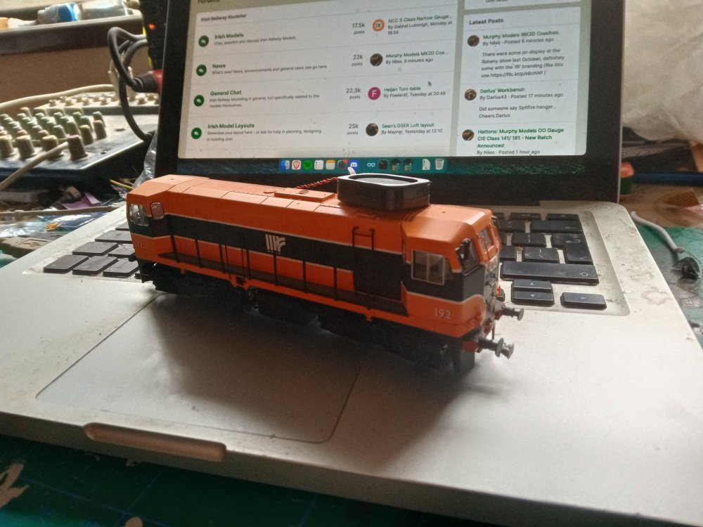

kinda feeling bad for my 192 which does not see enough time on the layout so shes in for the works tonight before being transferred to east wall tomorrow in anticipation for a new project.
mag couplings
iphone 5 speaker
645 loksound
should take me about an hour or so,
15 minutes later.
Methinks it was very generous to allot an hour to this task 😅
Edited by Sean

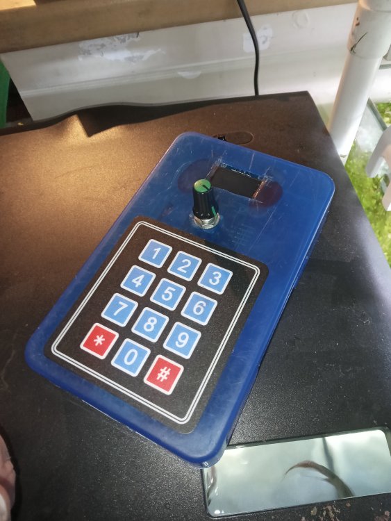

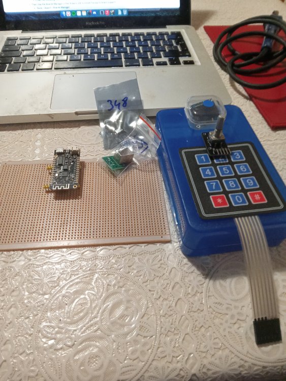

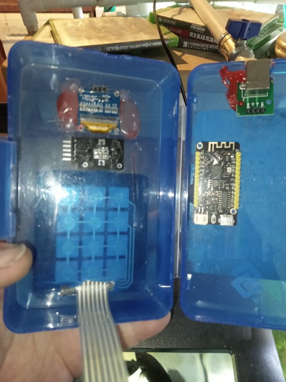

This is an open source wireless throttle for DCC++
it has a 1 inch OLED display

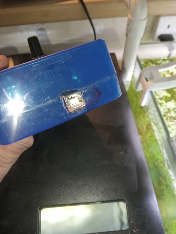

and onboard charging via this full sized usb-b connector, I could have used micro usb here but I did not because i hate that particular connector.
Overall it is a very simple build consisting of 4 components(plus the extra usb port and battery) works with or without JMRI.
https://github.com/flash62au/WiTcontroller/
Now its time to wire it and hopefully flash the software and away I go.
