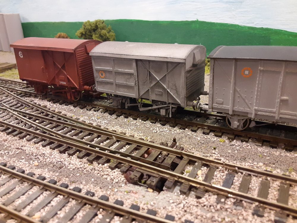

Does anybody know if the Irish palvans were larger than the BR version? With a bit of work the Parkside kit can be converted into a reasonable representation of the CIE version but to my eyes they look under size when seen alongside the provincial wagons H van. In prototype photos the palvans seem larger.

I don't have the dimensions, Patrick, but I am just adding that I have a Parkside palvan myself, and I have to say that it is so undersized that I don't run it - yes, there's a significant difference - the British one just doesn't look right on an Irish layout to me.

The apparent difference in size between the Irish and BR Palvans appears to be mainly due to to a difference in roof profile arising from the use of pressed steel ends on the CIE 26000 series wagons in a similar manner to the apparent difference in height between the ex-GNR  Bagged Cement Wagons and the 'standard' GSWR/GSR/CIE covered wagon.
The actual body height and width of the 3 wagons are very close the Irish Covered Wagon and Parkside model appear to have similar roof profiles
The Parkside model appears to be based on the early BR Palvans with plywood ends introduced in the early 1950s

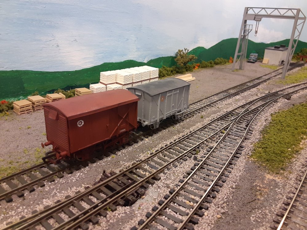

I agree with John's comments about the roof profile. On this model I added a layer of plasticard to the roof to raise the height somewhat. I think it improves the model overall even at the cost of the over scale roof thickness being apparent on the ends.
I did sonething similar by adding a 1mmx1mm piece under the roof to have the same effect .

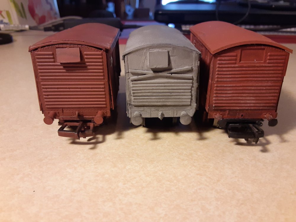

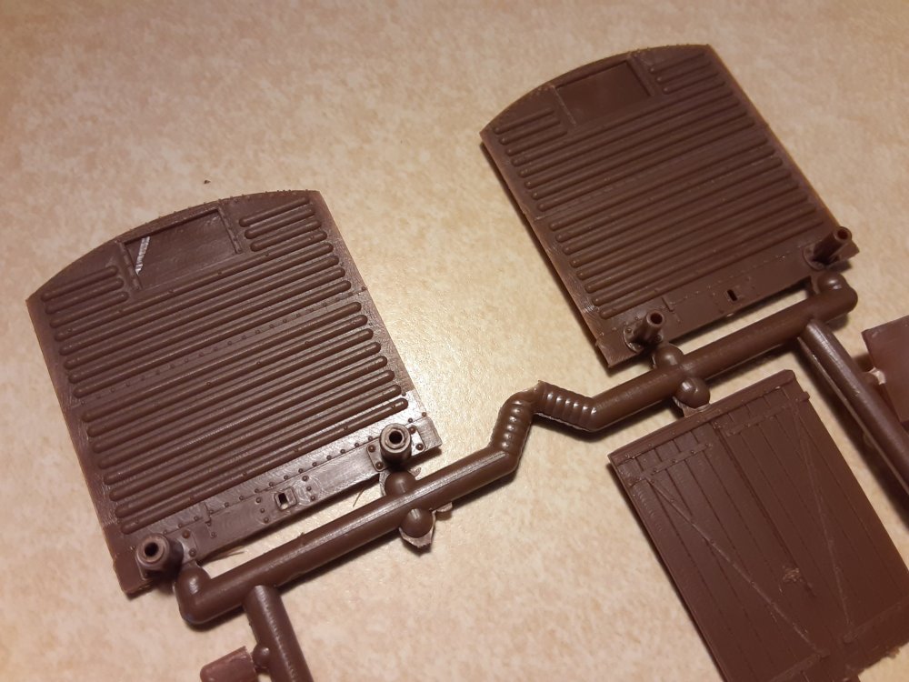

For comparison,  left to right, palvan with 12 ton van end, with altered end as supplied with the kit and the Parkside 12 ton van. The 12 ton van comes with two different ends. The ends with the lighter buffers are correct for the 12 ton van the heavier ones best resemble the pal van ones.
Edited by patrick
