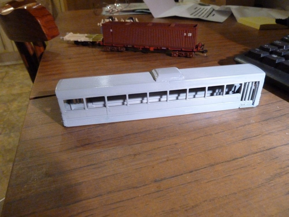

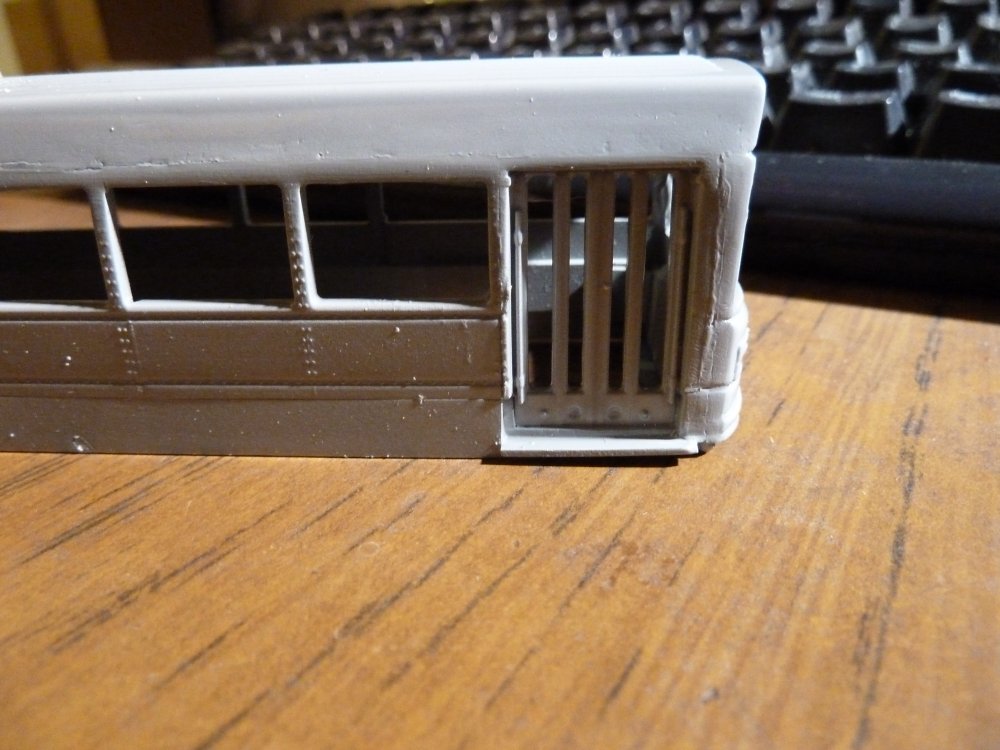

Well a bit of progress. After umpteen fill and sand cycles now painted in a gloss light grey. I could perhaps add some archer rivets along the top of windows but most pictures they can be barely seen. The join between cab end and door looks better in flesh and will have had rails over. Quite a bit more to do but to me seemed a good leap / stumble forward.

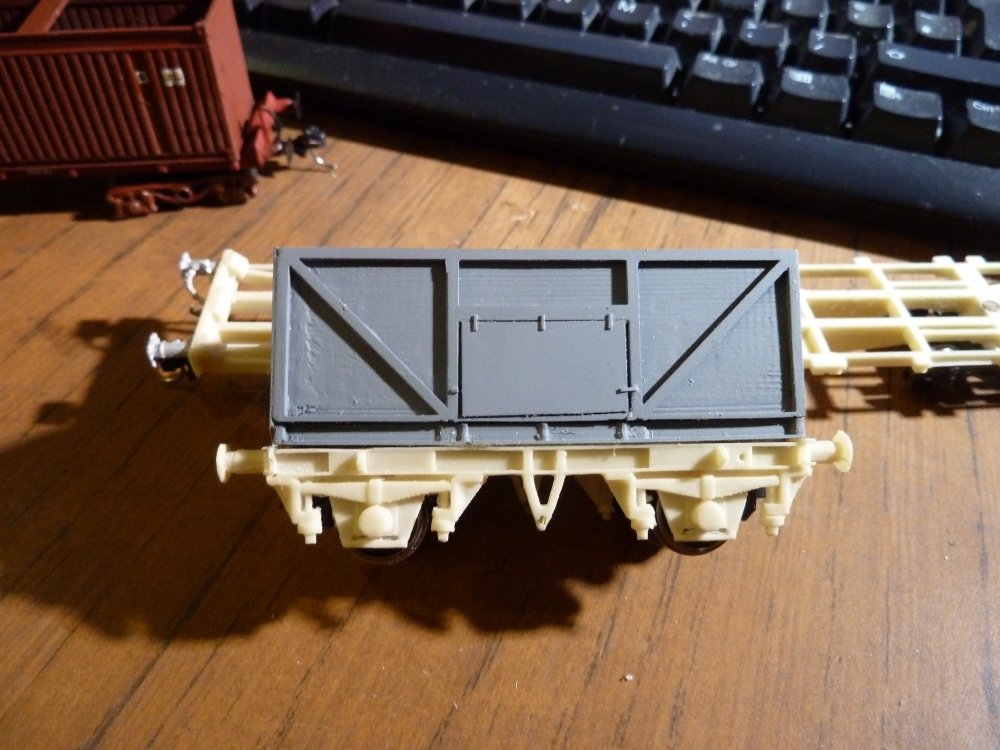

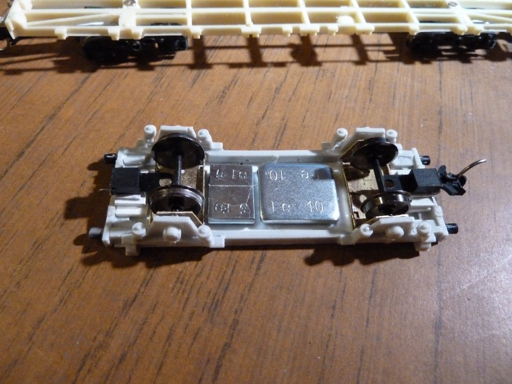

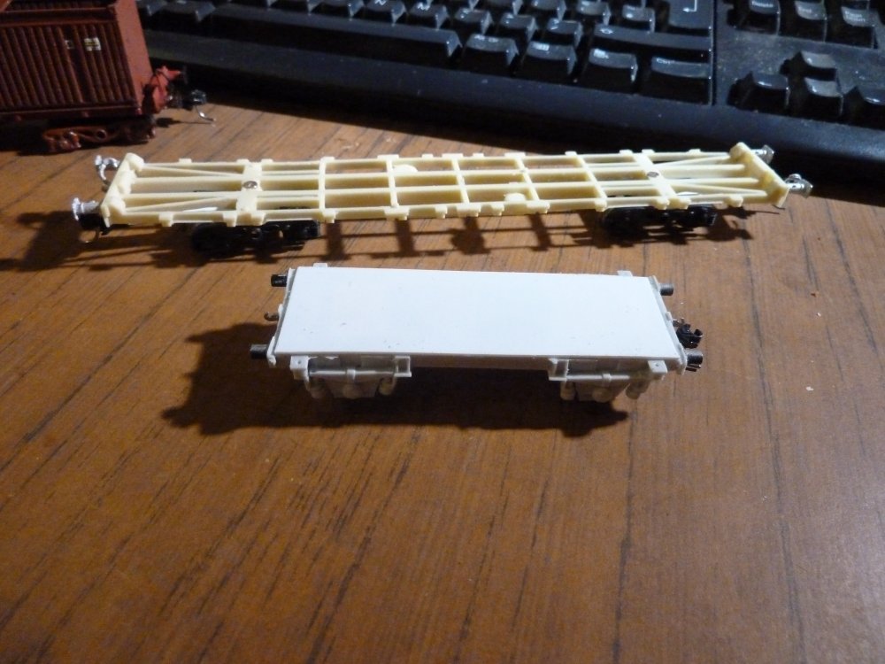

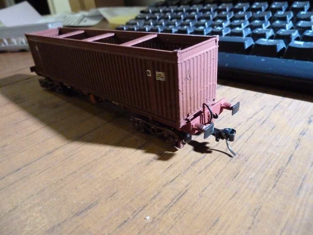

Spoils continue but no pics, jumping back a bit to the Beet wagons I was able from MIR get some bits and pieces last week, along with a restock on kadees. Today as day off between extra shifts has seen a bit of progress: Robert Roche created 3D print of the 4 wheel rebody beet wagon. Resin 45 foot and a 20 foot container chassis - resin NQPs from Ian, boiling water to soften and fix twists and bends. Bogie flat on a pair of Bachmann bogies and kadees fitted. Will need to sort handbrakes and vacc cross shafts as middle is a bit bare, cast buffers and vac pipe from SSM . All in all about 4 hours work over last two days to this stage. The 20 foot took more work as twist and axle box bearing supports all a mess. I ended up with a 1mm plastic floor having cut out and thinned resin to take MJT W iron frets - this has 3 point suspension so should road hold well. Plasticard mounts and kadee fitted. Derailment shot ! showing weights, MJTs and coupling mounts. Buffer housings recylced from the Tank wagons, need to sort heads, brake gear - on both 4 wheelers. But a fun couple of hours. This will get one of the Oil containers shown a while back. Finally, Thanks again to Robert Roche, Mayer and SSM on here, plus Kadee and Peters spares for couplings and wheels . The first of 4 beet bogies now done - others on bench to have Kadees added. I think this is the first completed wagon of 2021.

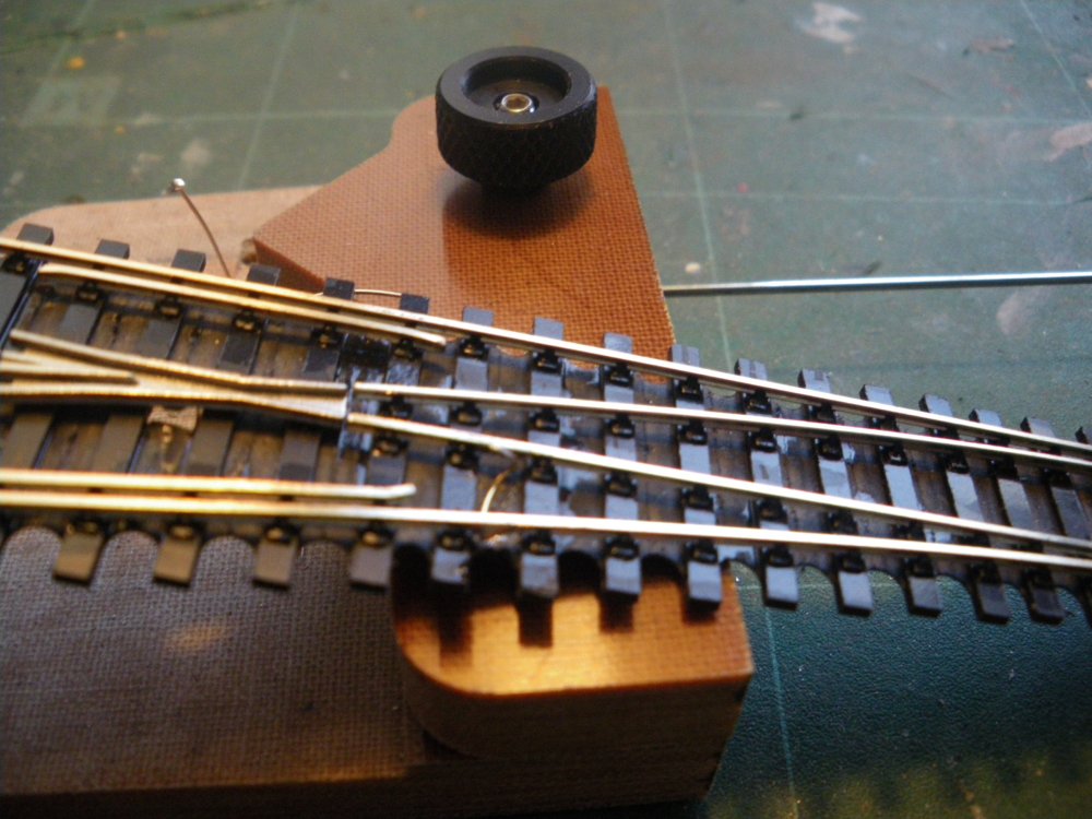

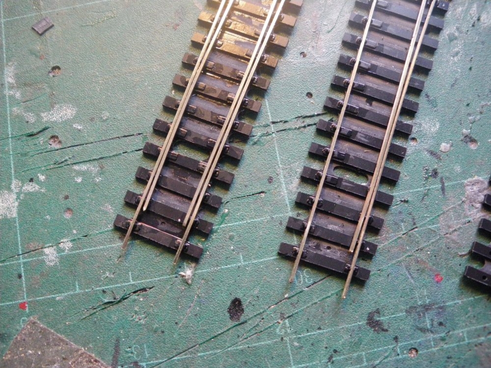

FWIW I have asked Paul martin at Edm trains for a 21mm gauge back to back set - 19.3 mm to see what he can make - current guess was aruond £15 mark.. just now on Rm web asked Wayne Kinney about 21mm gauge point bases for code 75 BH rail. His new and almost ready to go to market is based on a 3d printed flexible resin base with chairs printed - user has to put in rails but as in his N gauge models almost shake the box technology and worth watching. Using with C&L parts to make on plain track 21mm is much nearer. Wayne could perhaps produce trackbases in 21mm by same take and so the user just has to thread rail - an as long as not building all of Mayos lines or a scale length Belfast - Dublin line not three onerous . two pics of N points from a few years ago before blades filed to shape The N version has a cast frog/ crossing nose for ease of building. It is sat on a natty paxolin jig for filing and cutting blades and joining on to a tiebar. The OO / 4mm version looks to have a moulded tiebar. Lets hope Wayne will be able to bring to market 21mm turnouts and perhaps more complex arrangements later. Robert

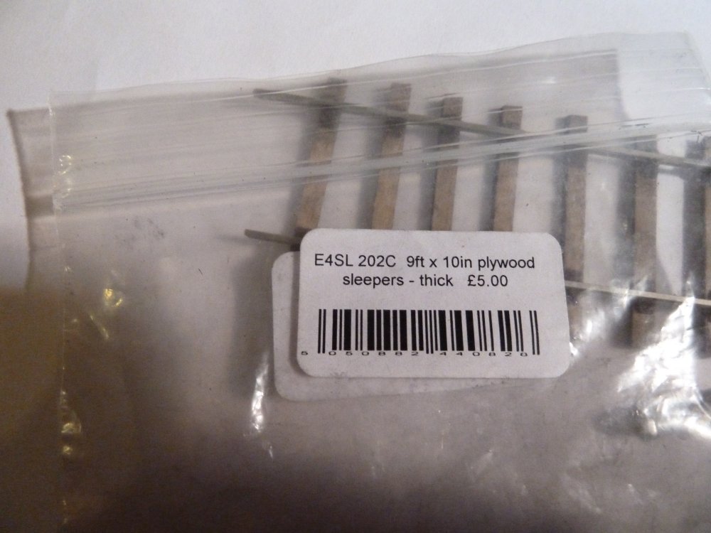

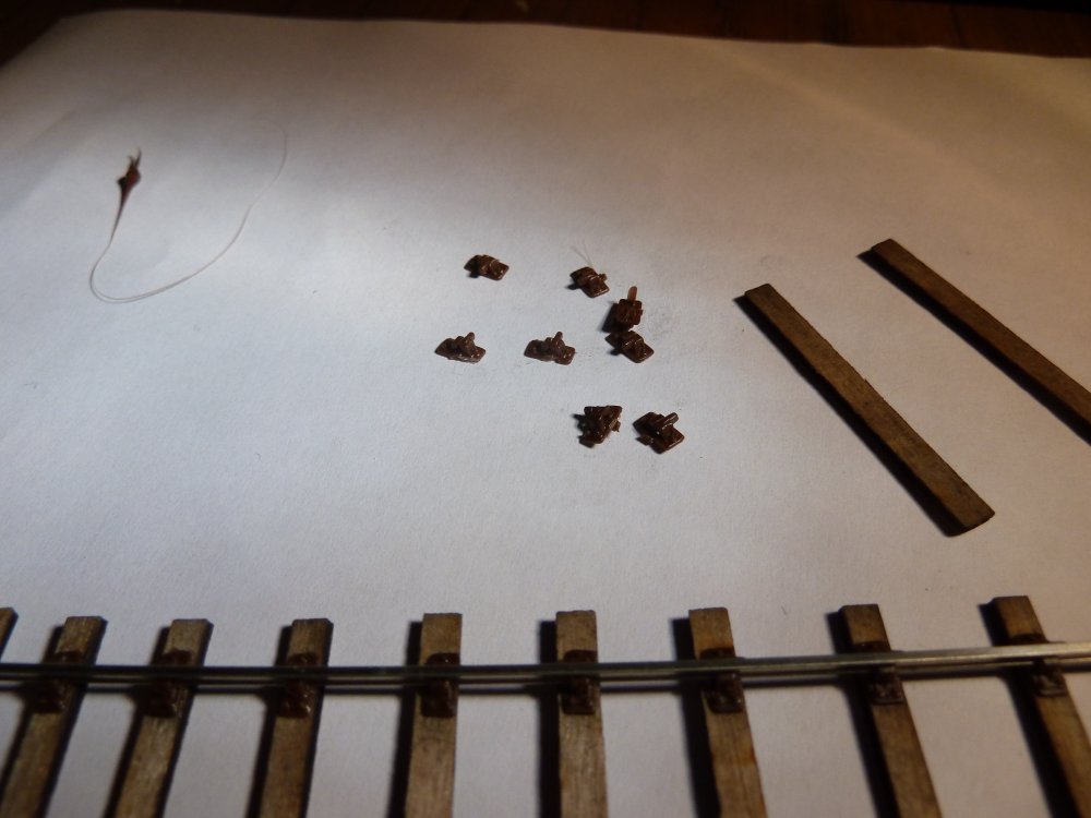

two more pics , chairs were 4CH101A coded - 3 bolt chairs and I got a pack of 250. I would have thought a point kit https://www.clfinescale.co.uk/online-store/4PK-POINT-KITS-ALL-SIZES-4-MM-SELECT-FROM-OO-EM-P4-p128200474, would be suitable for adaption but certainly worth correspondence with C&L - I think a lot of folk buy a kit to try and then just the crossing nose as a made up section and do all the rest themselves. and the tiddly small chairs and a couple of ply sleepers in close up

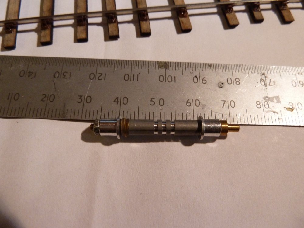

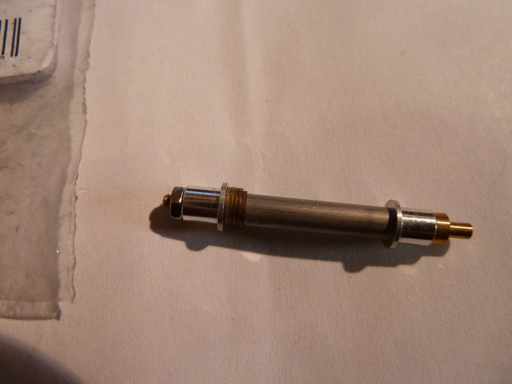

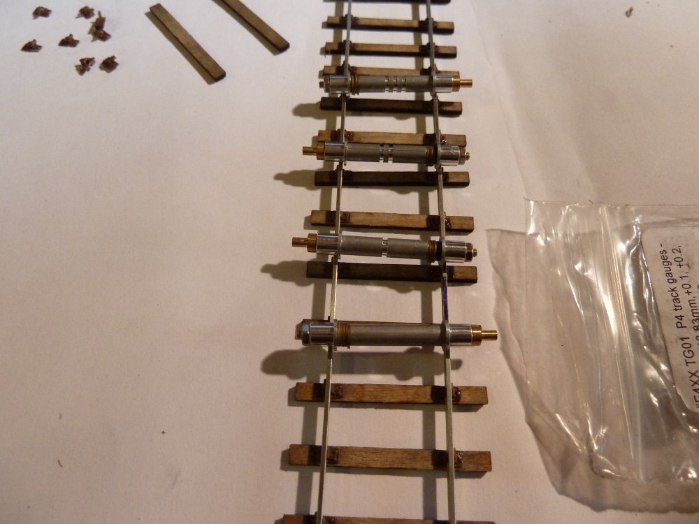

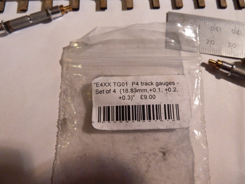

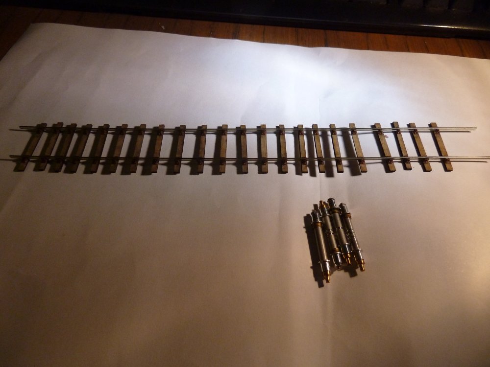

Hi Just dug out my efforts on a trial bit of 21mm At a Derby Roundhouse show a few years back I was able to chat with the boss of C&L who noted no point in 21mm gauges as market far to small but why not get p4 gauges and use washers - so that is what I did, along with rails ,sleepers chairs I have built a 60 foot panel. So I bought: added washers or added rail chairs and ended up with Make a good PW inspector shut the job I am sure but with out making a track jig it proved very easy to get this far - ok points and that sort of thing a step up. But I was imagineeering a diorama with 21 mm track in foreground and perhaps a bufferstop and then 16.5 behind at a lower level - so the eye reads wide track and carries over to the rear stock being photoed . Hope this encourages.
