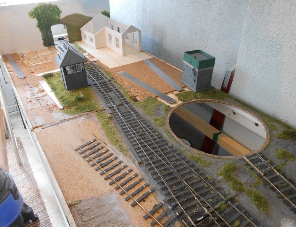

  2. More visualising Having got a fair way with the loco shed, I next wanted to sort out how it will 'sit' in the lefthand, rear corner of the layout. In an ideal world, both the landscape and separate, sky, back scene boards would be curved at about 10-15cm radius, to avoid a right angled corner in the scenery. However, this is not practical [at either end], so a bit of subterfuge is required. What I'm doing is to use a 'flat' - essentially a 1 cm deep gable end of what is meant to be part of a whisky distillery. This is angled slightly, so that when viewed, the lack of depth won't be apparent. In addition, I've painted another section of this building on the back scene, but at right angles to the 'flat'. Between the signal box and the white building [which is the admin section of the distillery], there will be a scots pine, about 20cm high, which I'm hoping will help to hide some of the above too - including the hole in the sky, where the main line exits to the fiddle yard. The Belmullet Distillery - home of Blacksod Bay Whisky - will be a useful source of traffic to the railway, with not just grain in & booze out, but also peat to fire the boilers. There are of course peat workings nearby and this also gives me the excuse to build and run two or three of those splendid 'peat wagons', made from converted WL&W six wheel coaches, by boarding up the windows & removing the roofs.

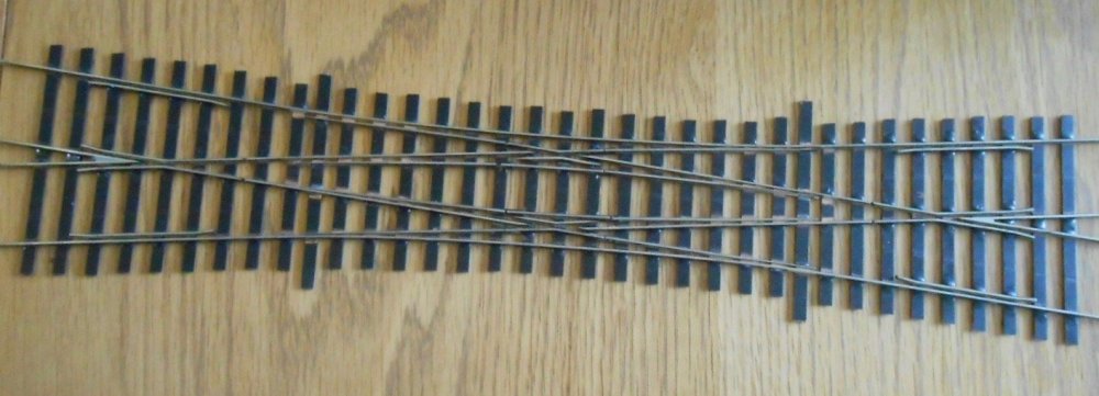

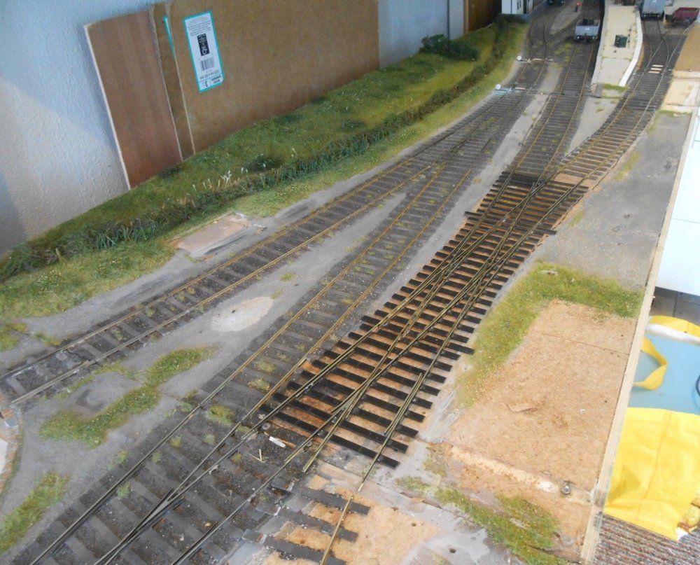

  4. Nice. Very nice in fact. That track just looks so right - no doubt because it is!
  5. The purchase option is there, DC. Marcway will do custom pointwork in 4mm and 7mm for a fee, usually about 50% above standard gauge, which actually not much more than Peco. Coaches, wagons and diesels not much of a problem, though steam outline conversions of RTR more difficult I think.

  17. A locoshed for Belmullet Can't believe it is 4 months since I did a workshop post, but everything has been layout orientated of late, so it is time to do something more specific. Anyone who has built a loco shed will tell you they can be awkward things, that are not a little fragile until the roof goes on. This is mainly because the opening for the loco results in weak spots on the two front corners while because they are perforce, single storey affairs, there is nowhere to put any internal bracing either. Experience has taught me that it is useful to build a loco shed on its own subframe, which can then be screwed to the actual baseboard once everything bar ground cover has been completed. I've based the shed for Belmullet on the one at Ballaghadereen, though I've made the workshop section only half the length. This is because I want a second siding coming off the turntable, so I can park a wagon of loco coal [and another for ash], alongside the line leading to the shed itself. This then made for another weak corner, which you might see has been braced with a short piece of aluminium angle. The core of the building is 5mm foam board, which is covered with Wills 'random stone' sheet on the inside and rendered stone sheet from the same source on the inside. The windows are from the York Modelmaking range and very nice they are too - saving a lot of work in the process, plus they only work out at around £1.50 each. Compared to covering the shell in Das clay and scribing the stonework, the Wills sheet is pretty quick too, while it also offers a lot more relief than scribing yourself. The downside is that a lot of filling is required to make the sheets match up, especially at the corners, with subsequent extra scribing too. The base is a piece of 3mm plywood [from Hobbycraft], which nicely matches the height of the cork floor tiles I use as track underlay. I cut a slot out for an inspection pit [which will be deepened by a similar slot in the baseboard itself], then made a length of track from copper clad sleepers and code 100FB rail, as per the rest of the layout. At this point, a couple of errors became apparent. First, the front opening was too narrow for any loco to pass through, and second, the shed itself was too short for any of my tender locos! A bit of robust filing eventually sorted the opening, but the shed length required more thought. At first I considered just lengthing it by adding a new section, but that would have messed up the symmetry of the windows. Instead, I've put an extension on the rear wall of the shed, using Wills corrugated asbestos sheet, as sold for 4mm scale. Indeed, all the Wills sheets are 4mm scale, but they seem ok in 7mm & the asbestos version has bolt heads moulded on as well. Anyway, the story is that, like the Achill Island branch, Belmullet was originally worked with MGW E class 0-6-0Ts, but soon after tender engines arrived, one was driven rather too enthusiastically into the real wall. Realising the need for more space at this point, the engine sized hole was enlarged slightly and a timber framed, wiggly tin extension built. A bit of fun was had with the interior, putting in a little basic detail in the form of a decent sized stove [large enough to do a bit of smithing], a workbench either side [one with a large vice on it], plus a storage cupboard for the loco crews. The flooring has been built up to be level with the tops of the sleepers, using card and more embossed sheet - brick setts this time - filled in with Das clay. On the outside, you can see my method of doing guttering. 2.5mm square plastic strip is used for the gutters themselves & this is projected out from the tops of the walls by additional pieces of the same section. The roof slates, when added, will overlap the gaps you can see at the moment. So there we are so far. I'm hoping that, by the time the shed is finished, a Kitwood Models 10.5" laser cut turntable kit will be available again, as that circular hole in the baseboard really needs filling!

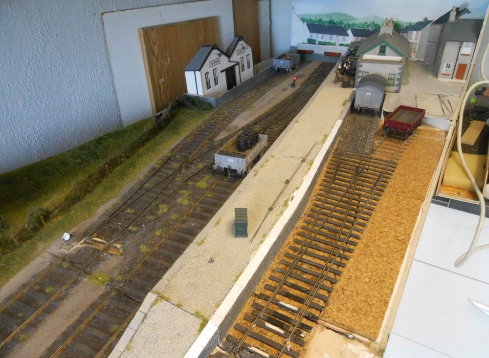

  20. More 'blocking in' work recently. not very exciting, but gradually builds up the overall scene. The goods shed and loco shed have both been covered in Wills 4mm scale random stone, while the other buildings are rendered stone from the same source. The goods shed is about 3/4 relief, so a very odd shape, which has been done very much by trial and error - lots of both in fact! The windows on the loco shed are from York Modelmaking. With micro strip now costing around 50p for a 30cm length, ready made, laser cut frames are increasingly both attractive and cost effective. Other work, if you can call it that, has been a case of spending quite a lot of time just looking at the layout. Not hours on end, but little and often, in an effort to try and visualise the scene and get the overall balance looking right. Hence the cottage will probably now move to the right hand end of the middle board, so there is room for a bit of hard standing/goods yard effect next to the goods shed.
