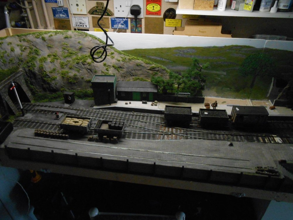

After a couple of months break, the layout comes up on the to do list again - this time under the 'general presentation' heading. The pelmets and fascias that I made back in April needed painting, so decided to use the same 'herb green' as on Fintonagh. It is the same colour in both pictures below - which only goes to show the effect lighting can have. In the last few weeks, I've also been brooding over the overall make up of NPQ. The original plan was for there to be a line exiting 'stage right' to the pier. However, there were two issues with this - firstly it would mean the need for an operator at that end and second that my existing drapes would not be long enough. On top of this, a fiddle yard at this end also meant something else to fit in the car, so in the end, decided it had to go. So, the hole in the sky has been boarded over. Operationally, this means the goods train which was supposed to shunt wagons on and off the pier, needed an alternative operation. I think I've solved this by shunting a single wagon to and from the right hand siding. This was originally intended as a sort of shunting neck for the pier manoeuvres, because I don't want a rake of wagons blocking the view at this end. However, a single wagon, alternatively dropped off or added to the goods [itself only three vans and a brake], shouldn't block much of the view. What I do need to do is add a second uncoupling magnet in the platform road to enable the move to happen fairly simply. Th train loco will uncouple, run forward into the headshunt and then reverse into the loop to pick up the van from the siding.. This will then be attached to the brake van and the two vehicles pushed back to the headshunt, ready to be coupled up for departure. My other concern has been the main, left hand fiddle yard. This has been a very effective feature of both Arigna Town and Belmullet, being able to both slide from side to side and rotate as well. Hence no handling of stock is necessary. Unfortunately it is very heavy, so will be cut down from 118cm to 100cm and have 10cm sawn off the overall depth too. The 7 track train table will remain, though the central axis will be off centre. The shortened frame will eventually gain a narrow gauge track table, so it can be used when Fintonagh goes out again after its Donegal/Swilly make over - saving a bit of space in the workshop too... So, lots still to do and NPQ's debut at Uckfield in October feels like it draws ever nearer!

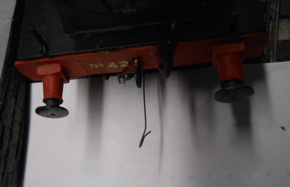

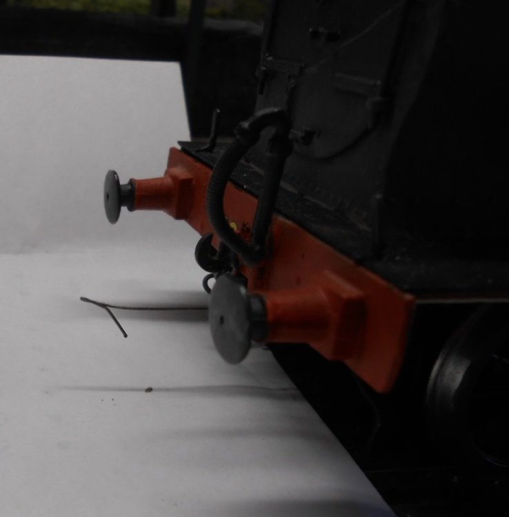

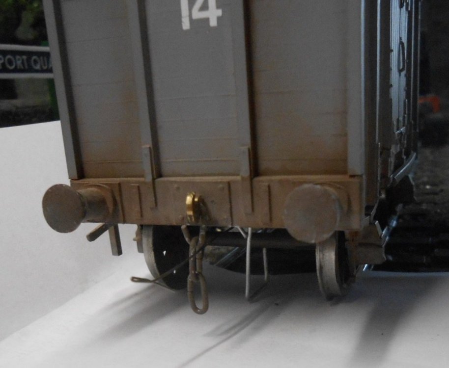

Fly is at last about as finished as any model is likely to be - the recent hiatus in modelling work partly down to a week on the Costa Brava and as a retired teacher I reserve the right to avoid going anywhere in the school holidays. Partly cost, partly avoiding former customers... Anyway, the remaining work was initially about getting the lining on the other side of the loco done, then adding a few final details. The latter have included things like the pair of lamps on the buffer beams, crew and one of those Spawns of Satan, the safety chains and hooks. These really are a pain in the primary orifice and I must either decide to omit such things in future, or reconcile myself to the fact they they will take at least four times as long as I want to spend on the job. The other task was a bit of light weathering. Earlier this year, was delighted to find the following set. Now produced by 'Finishing Touches', it looks very similar to one sold by Roger Freestone quite a few years ago. I think it is made of of little make up tubs, and as can be seen, there is a nice range of tints. I use the darkest rust on brake blocks and guard irons, then lighter greys and buffs on the footplate, smokebox and cab roof to suggest general daily dirt and the effects of smoke. Fly now looks like it works for its living, while retaining a well cared for appearance. While far from perfect, it is certainly a pretty little engine. I haven't properly logged the time taken on painting and lining, but would guess the latter has taken about the same time as overall construction, so about 60 hours in all.

An absolute beauty, Alan. Take away the track it is sat on and it could be a much larger scale, which says everything about the model's quality. Regarding weathering, the powders route might be the safest option - any issues and it can be wiped off with damp cotton buds. Agree that all locos benefit from a bit of weathering, so maybe sticking to the black bits is the way to go? Brakes, smokebox, footplate, cab roof and so on. We also need to see it on Loughan Quay with some wagons. Very much worth all the effort!
