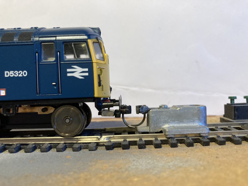

  4. It's an easy job with the Dapol Western, just bang in the decoder and speaker. There's room for a full size bass reflex speaker. Unlike the Heljan version which needs major surgery!
