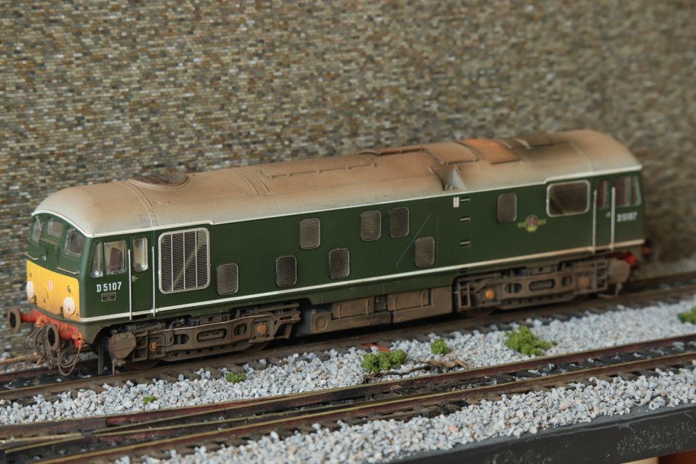

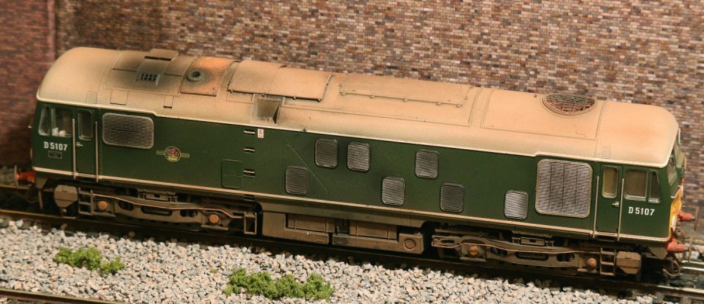

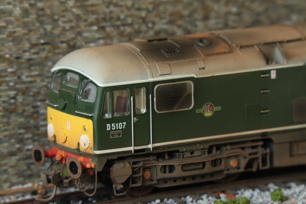

Something a bit unusual for my workbench - a BR Class 24 for light weathering. Might need a touch more.
