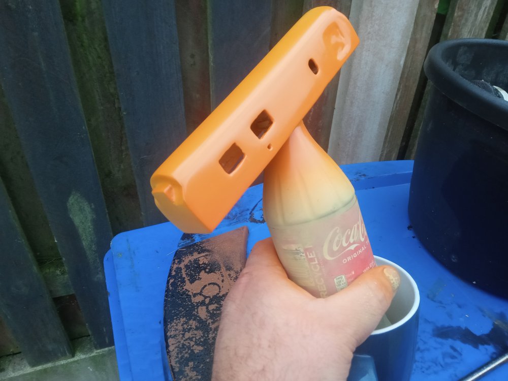

  21. One must take care when warming up spray paint from dealz, this happened as I was shaking the can
