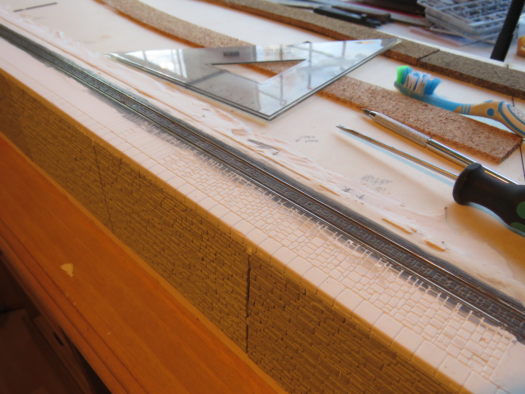

I don't know whether this is of any use, @David Holman, but I've been doing inlaid track on a Lynton & Barnstaple OO9 micro I'm currently cobbling together.
The track is just PECO N Gauge Code 55 flexi, pre-wired of course! The setts are simply a mix of Tesco all-purpose DIY filler with some PVA flipped in, spread over the track area and roughly levelled. Once dry, its sanded smooth and the level between the tracks slightly reduced for clearance, and the flangeways gouged out with an Olfa P-Cutter. The setts are scribed in with a scribing tool and a small screwdriver. This is a work-in-progress:

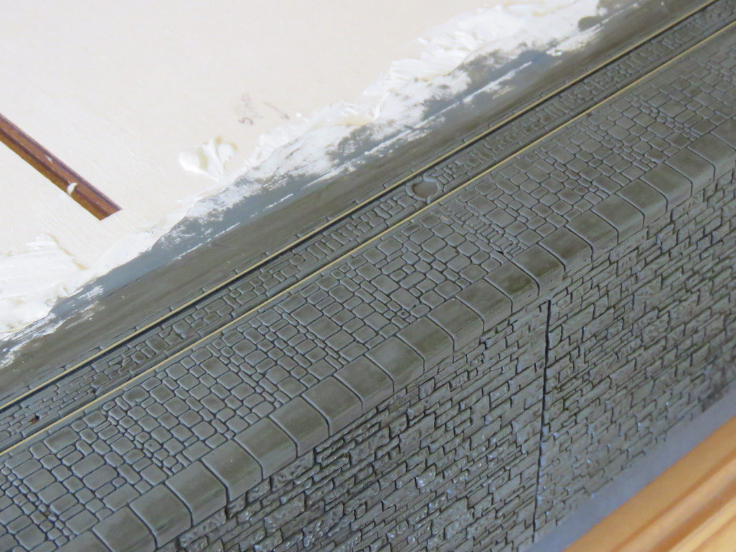

Painted with acrylics, with a wash of Citadel Seraphim Sepia and Nuln Oil. The quay wall is good ol' Wills Coarse Stone, of course :)

Hi David,
glad its of interest! If you should like to see a bit more detail, I've got a thread running on NGRM-Online here where I go into unbearable detail about the process from about halfway down Page 1 :D
Here's another pic which I think shows the results a bit better:
As a process, the scribing doesn't actually take that long, and its really rather cathartic :)
I might start a thread on here in the British Railways section (if anyone's interested).
