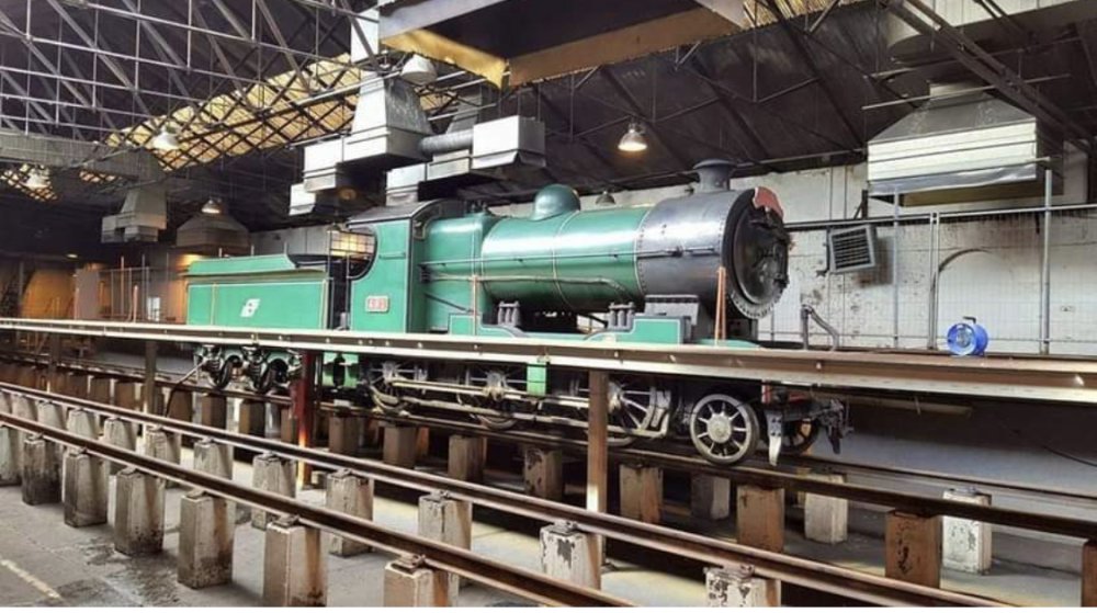

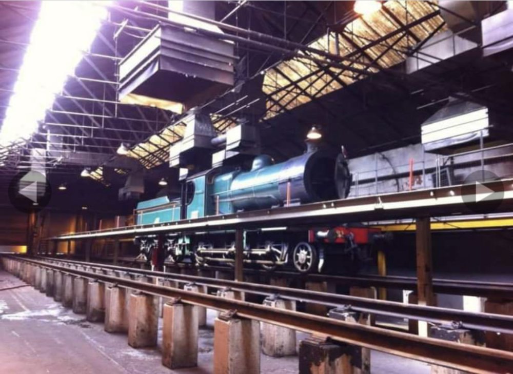

Darren.d Posted October 15, 2022 Posted October 15, 2022 Have started building a loose replica of the shed at Connolly station.im stumped as how to model the raised track on the inside of the shed.any ideas would be great.
Galteemore Posted October 15, 2022 Posted October 15, 2022 (edited) This is what I would do, if you don’t have the confidence to start from scratch with bare rails and a track gauge. Make a little jig which will allow you to cut lengths of square plastic rod to exactly the requisite height. The jig will ensure consistency. Glue these to a piece of standard sleepered track and secure the whole assembly on your baseboard, making sure it’s dead flat and not twisted. When glue is fully set, snip away the sleepers. That will give you an approximation of the look, whilst ensuring that the gauge is also correct. Edited October 15, 2022 by Galteemore 1
NorthWallDocker Posted October 15, 2022 Posted October 15, 2022 Might you be able to post a few photos of the "raised track" you want to replicate in miniature? I've considered a replica of the locomotive shed, too, during the steam locomotive era.
Galteemore Posted October 15, 2022 Posted October 15, 2022 (edited) Pics from RPSI Facebook page - credits to G Mooney and D Carse: https://m.facebook.com/photo.php?fbid=855588914506499&id=715053831893342&set=a.855588347839889&source=48&refid=13&__tn__=%2B> Edited October 15, 2022 by Galteemore 4
Darren.d Posted October 15, 2022 Author Posted October 15, 2022 Was thinking of scratch building .using lengths of flex track onto square rod of styrene.a 3d printed post with a chair for the rail would be ideal but iv no access to one. Cheers for the help.its good to hear someone else's ideas. 5

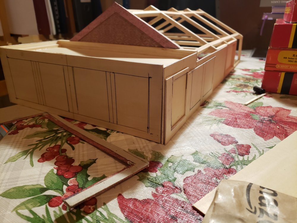

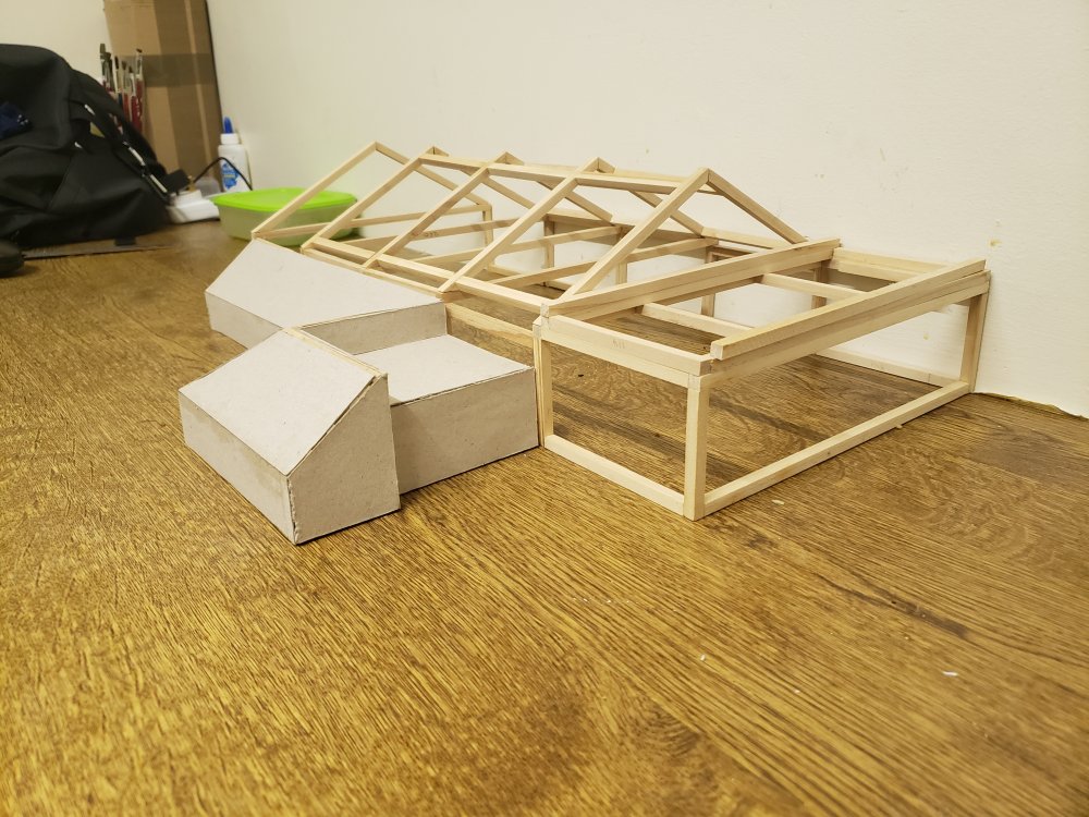

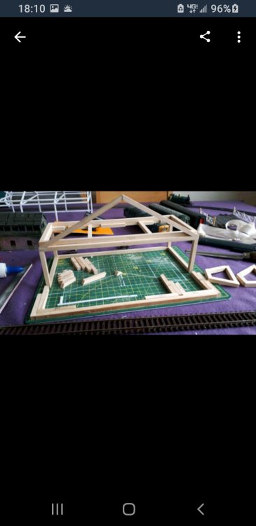

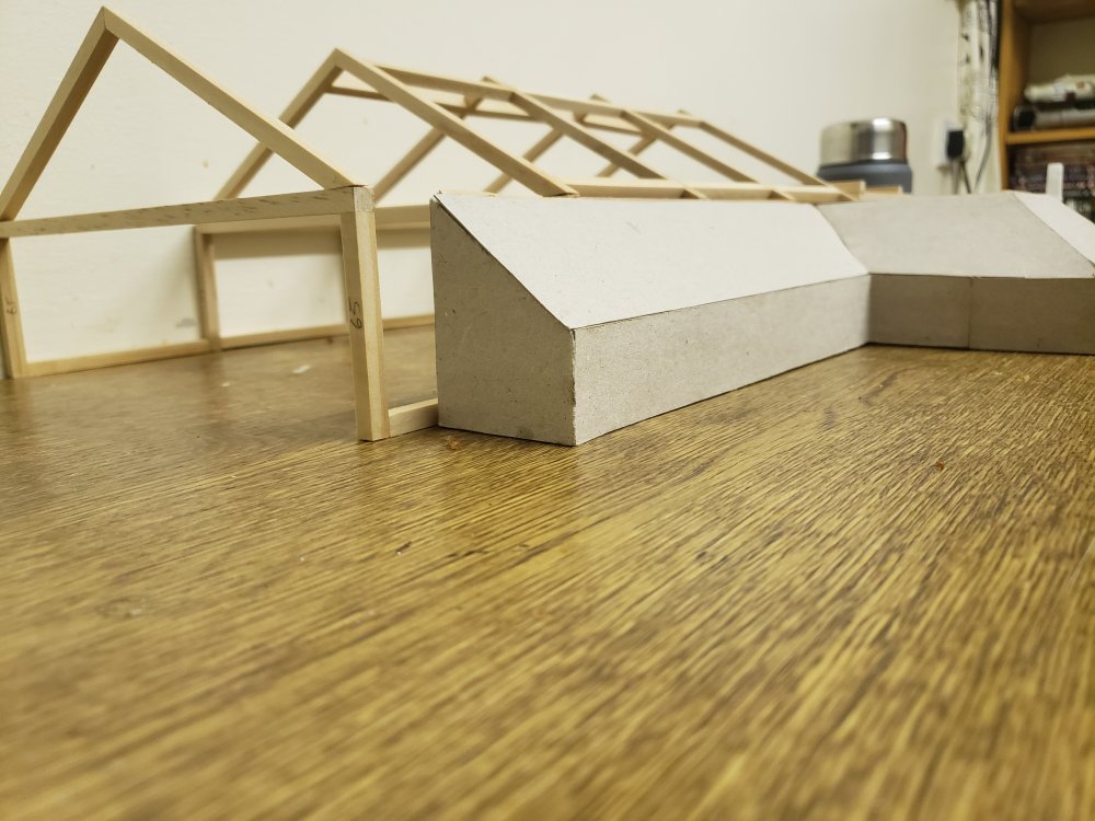

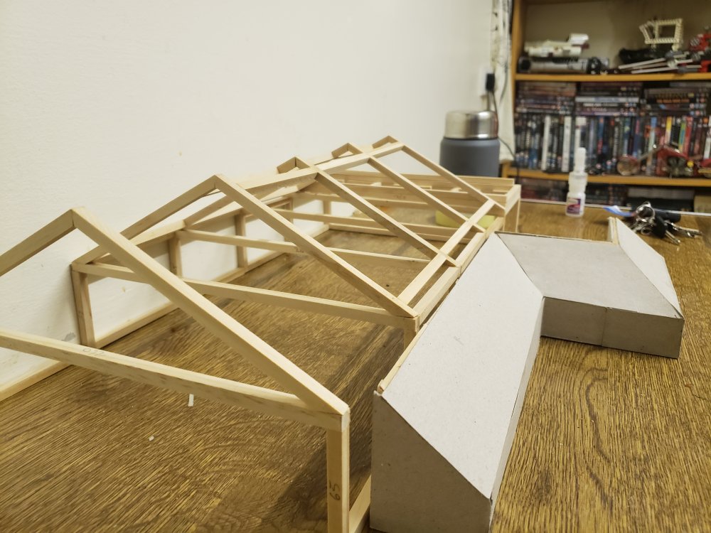

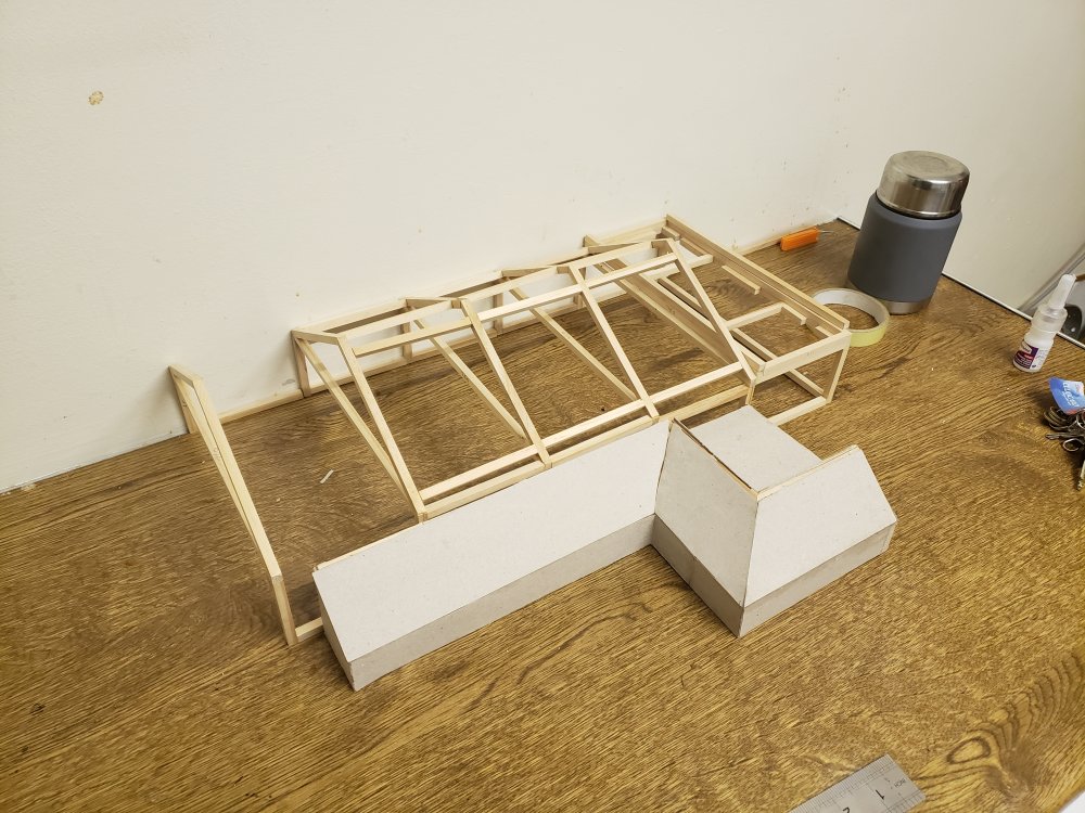

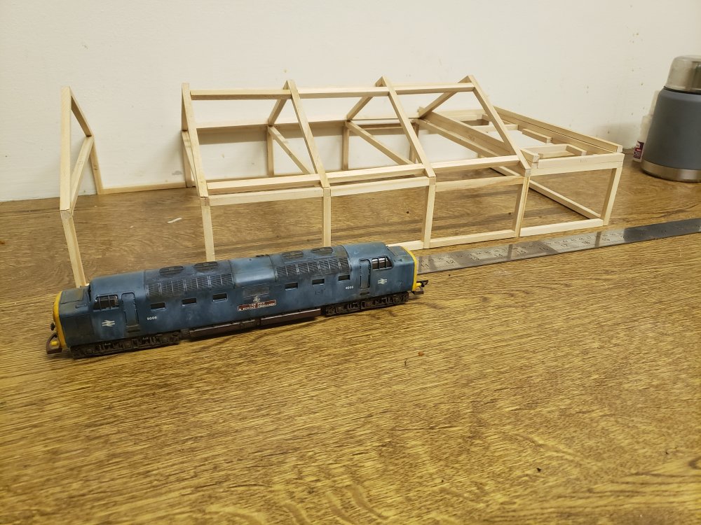

Darren.d Posted October 23, 2022 Author Posted October 23, 2022 Frame in 6mm balsa wood.500mm long so far.500 more to finish.have done side building separately in wood and clad in card before adding outer covering and roof,windows, gutters etc. 1

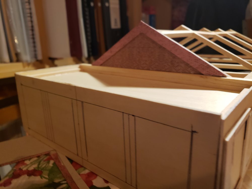

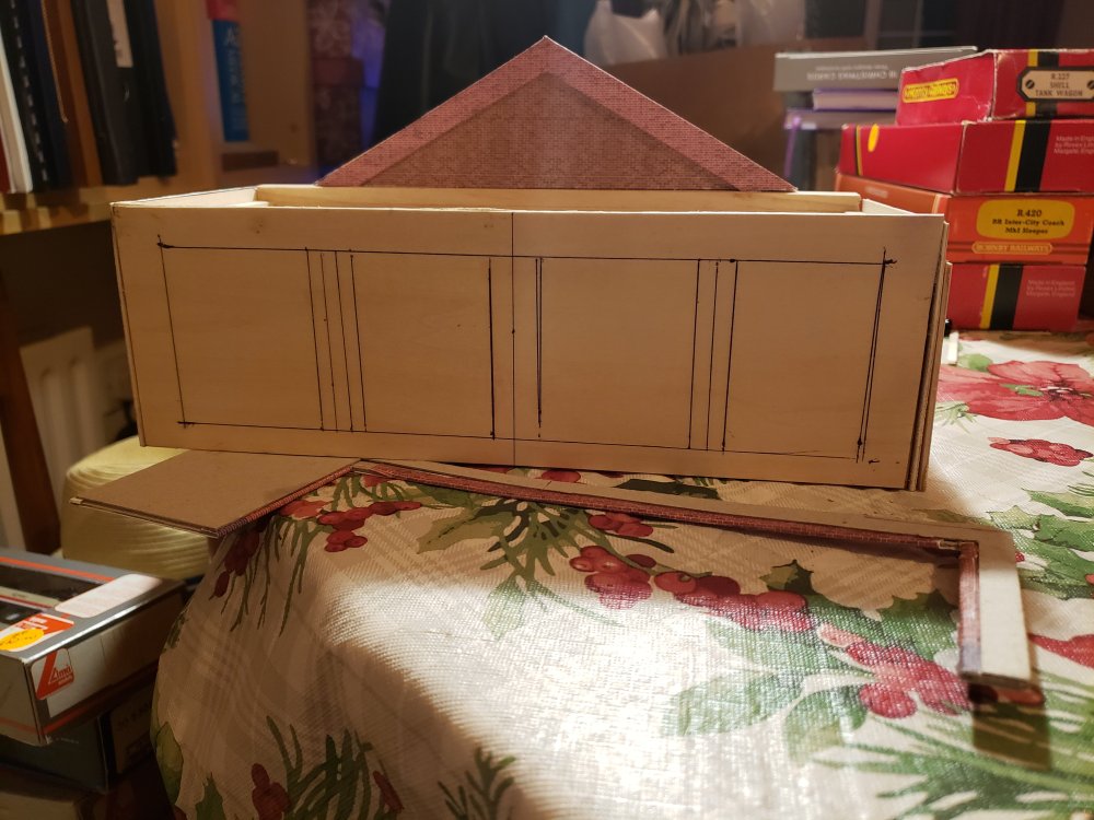

Darren.d Posted November 2, 2022 Author Posted November 2, 2022 Cladding in 1.5mm balsa sheet inside and out for strength. 12

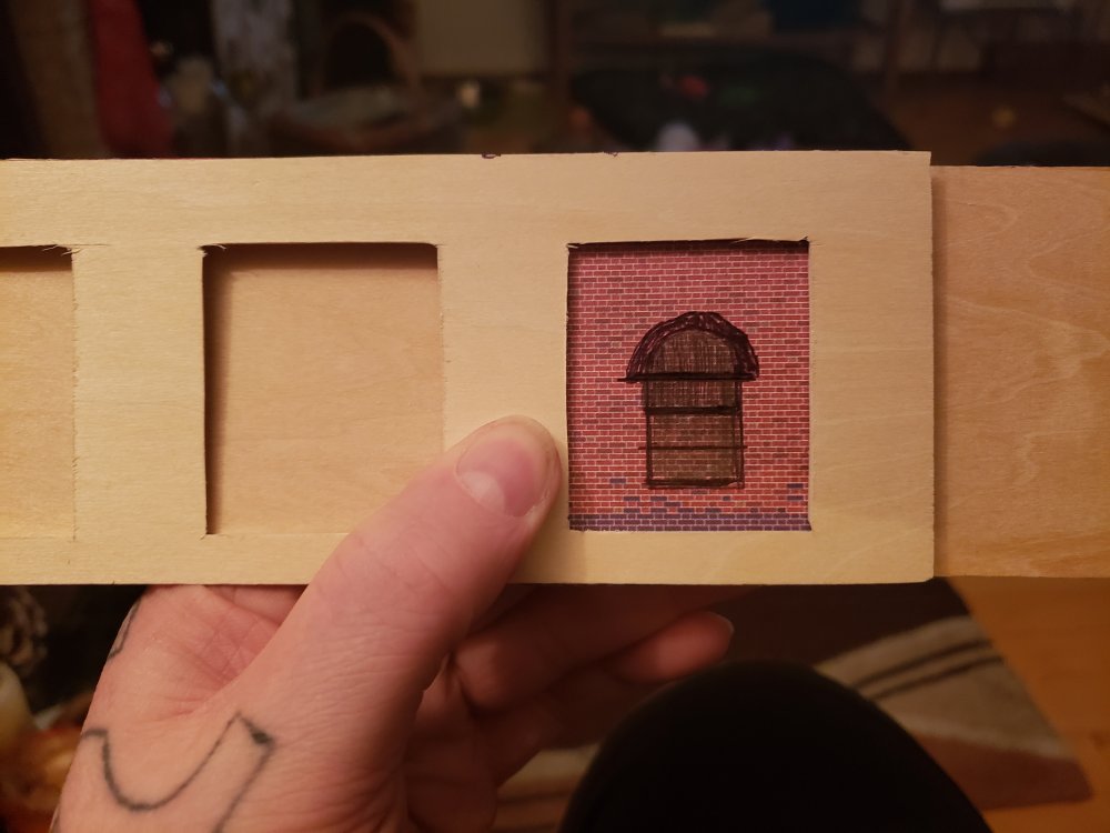

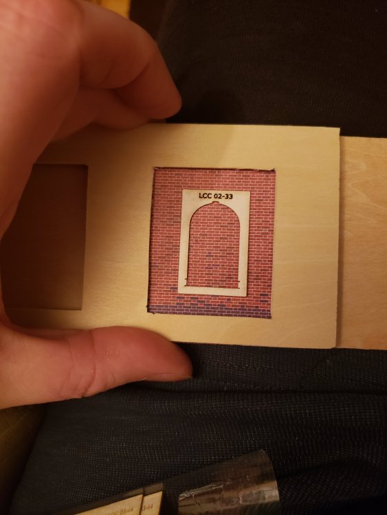

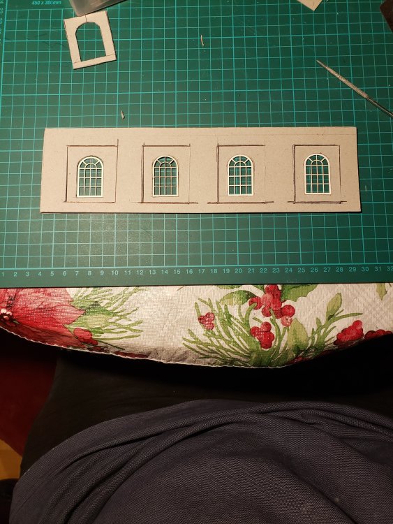

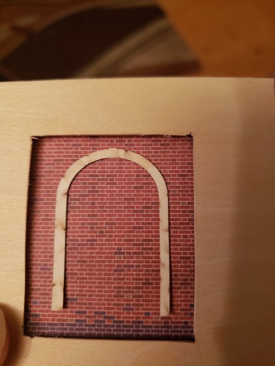

Darren.d Posted January 14, 2023 Author Posted January 14, 2023 Trying to figure out recessed window frames while waiting on a few bits from the uk. 8

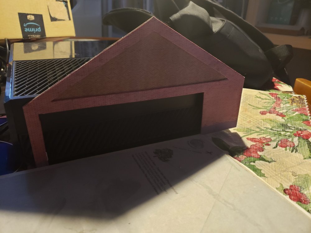

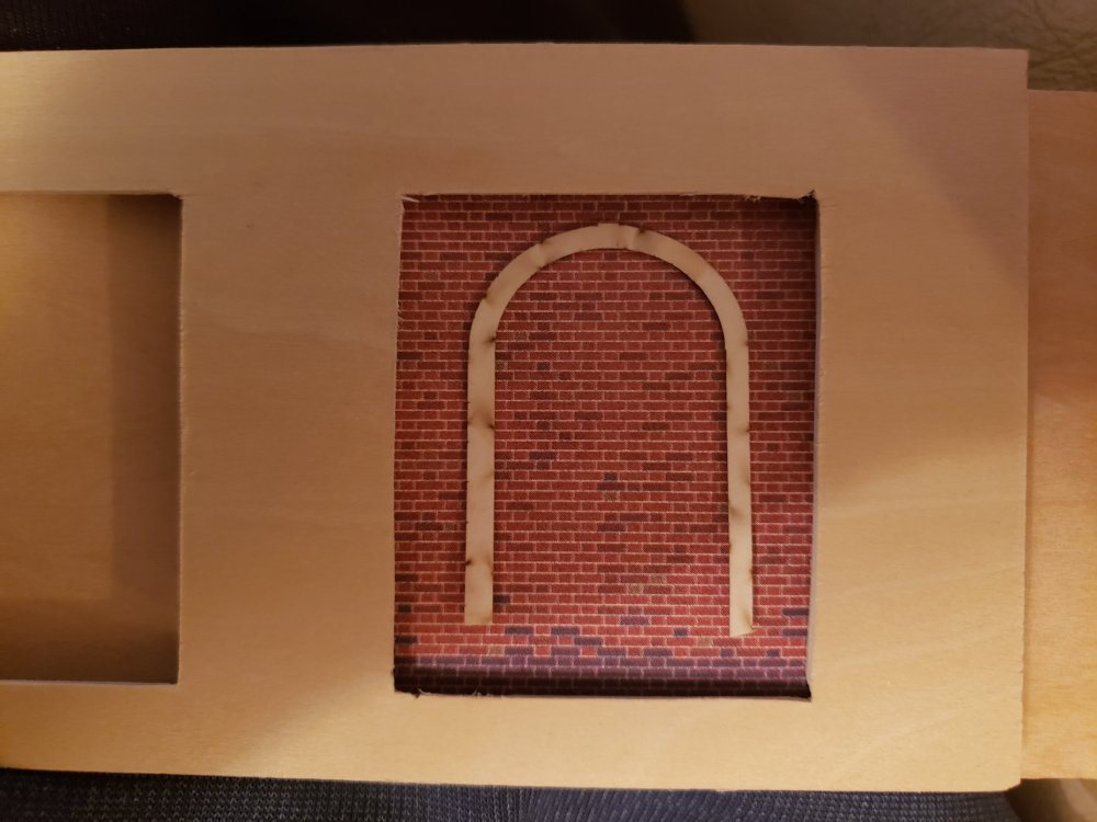

Darren.d Posted January 14, 2023 Author Posted January 14, 2023 Needs covering in brick paper and see how it looks.will be the end wall of the shed 7

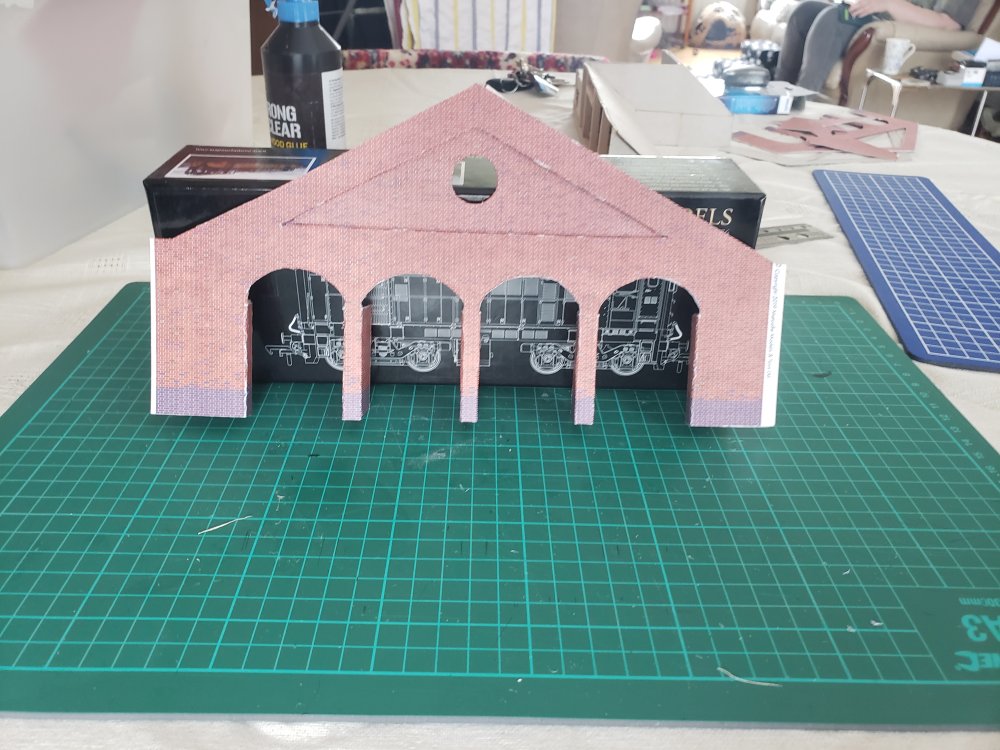

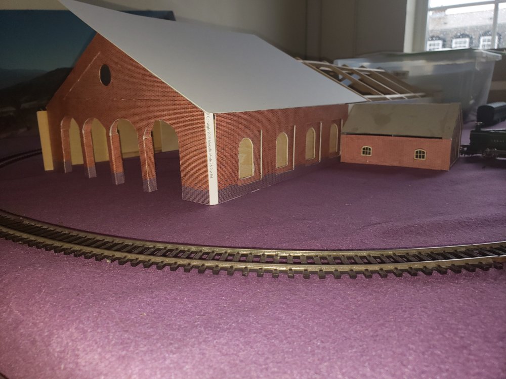

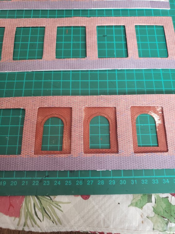

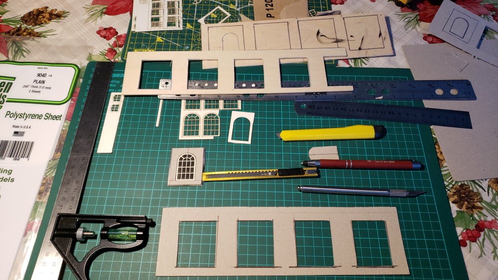

Darren.d Posted March 10, 2023 Author Posted March 10, 2023 Have knocked up a new front of arches.been spending time looking up pictures and videos online and after a bunch of attempts its not too bad.it also seems there's a side building and what looks like a chimney.also have looked at a survey map from around 1910 and there's a 4 track coal yard to the right of the turntable. Need a trip to marks models have to get brick paper sheets.trial and error iv used up my stock.also need windows and brick headers from lcut uk which takes several weeks . 14

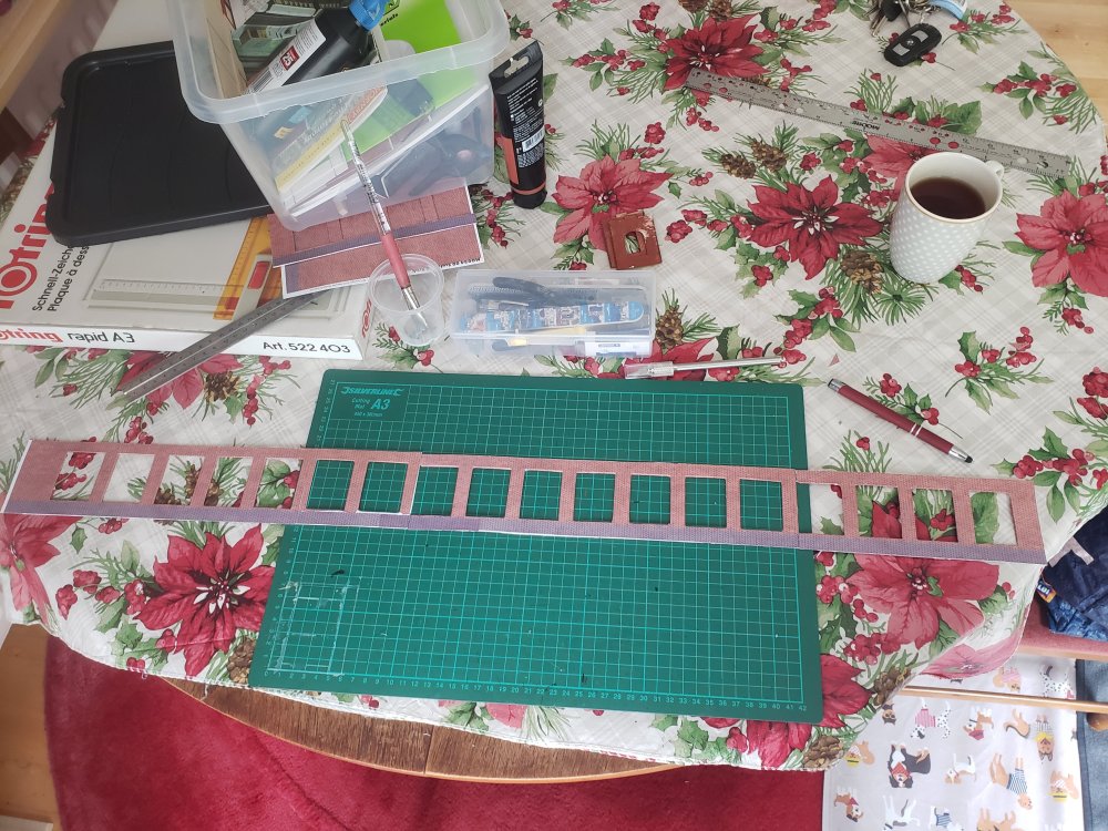

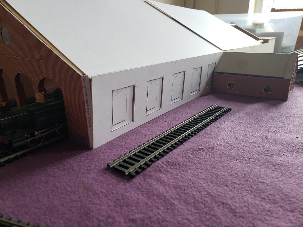

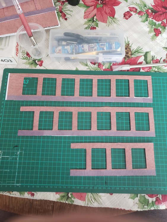

Darren.d Posted June 10, 2023 Author Posted June 10, 2023 Not been doing much of late.had all my window bays done and cut out and noticed id measured wrong id 16 instead of 18,so had to start over.18.bays done and covered in brick paper.when finished I'm now 40 scale feet short but its fine for me. 4
