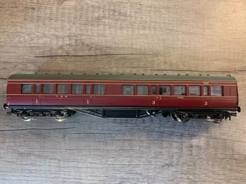

Now, the Mainline / Replica / Bachmann LMS coaches are representations of this type, but they only make the composite and the brake third, not the full third. These are the two sides of the composite:
Bachmann 34-251D OO Gauge LMS 57ft Corridor Composite Coach LMS Maroon Boxed - Picture 1 of 9 Bachmann 34-251D OO Gauge LMS 57ft Corridor Composite Coach LMS Maroon Boxed - Picture 3 of 9
I've seen accounts of people doing a 'cut and shut' using parts of two brake thirds to make a full third, or of course you can overlay the Comet etched sides to make a third.
Now, I know that Bachmann produced their composite and brake third in CIE dark green as part of their Irish set, and some people have dismissed them as completely incorrect. But are they really that bad? Am I missing something?
The older Mainline versions can be picked up on Ebay for not much more than a tenner each, so they would make a cheap basis for a conversion. I was wondering whether anyone has used these as the basis of Irish models? Some details could be changed quite easily: adding full-length footboards and an Irish livery would help a lot even if you didn't change the window arrangements.
Please show me what you've done!

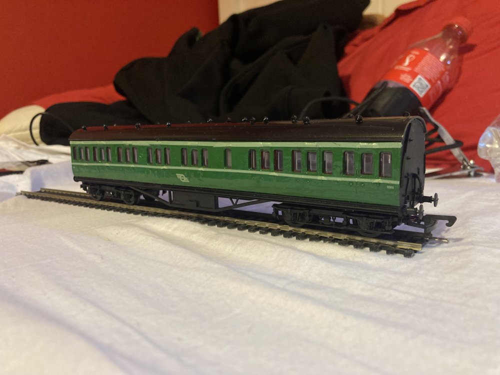

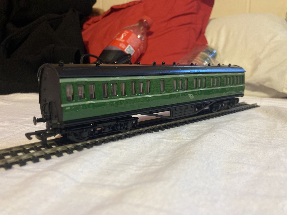

Here was my attempt a couple of years ago. it was on some cheap LMS coach from hattons.
Nice - thanks for sharing the photos. The green livery looks spot on - can you remember what shade of paint you used?

It’s a pretty good match, but it’s not perfect. It’s too dark for the lighter green and too light for the darker green. Colour was emerald green from memory

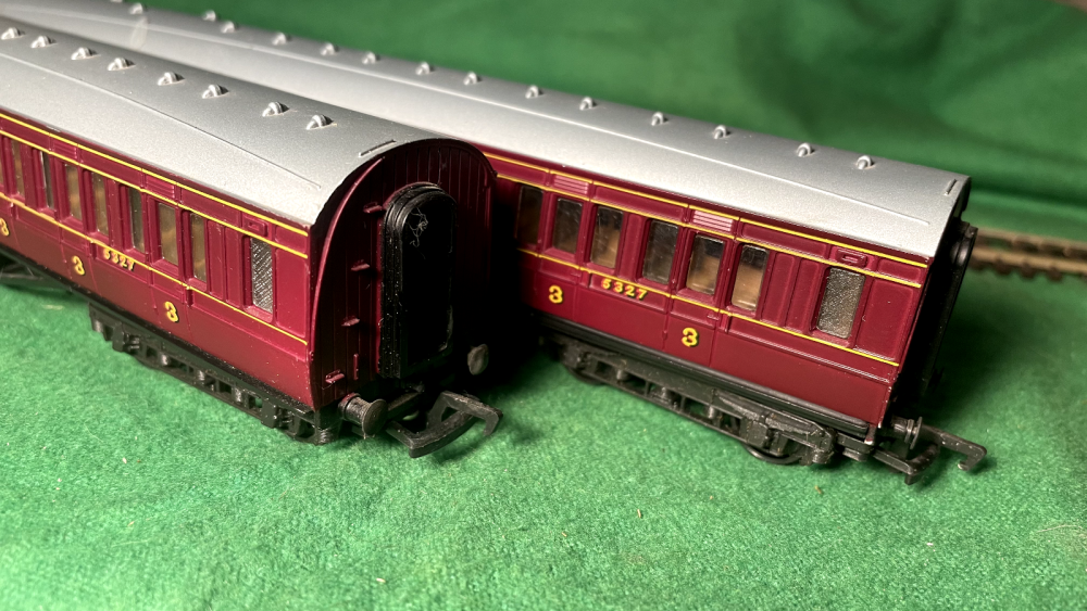

Window spacings and shapes on LMS types were completely different from GSWR. The narrower panes sere wider on GSWR types usually, and the wider windows spaced differently. Now; given the sheer variety of types on all railways, I would not get carried away by that. However, LMS roof profiles and side profiles were worlds apart from GSWR. Coach sides for the latter were straight from cantrail down to well below waistline, then curved in. Roof curvature was more even on post 1915-ish examples, or older ones were flat-roofed. By the time the LMS came to Ireland, older coaches on the NCC were all of older BNCR design, whole planets away from either LMS or GSWR in design.
Past comments, as far as I am concerned anyway, relate to the LMS designs which were in CIE livery to go with Bachmann "Woolwich" locos. In the absence of anything else, they'd do - but in the same way that a "Flying Scotsman" in CIE green might be seen as a "Maedb", or a random British 0.6.0 tank loco be passed off as Irish by painting it grey, or painting it black with "G N R" on the side. Two foot rule; fine. Looks like real thing: only on the way home from Gibneys, when half-scuttered! Not, of course, that I would be aware of that, and I wasn't even there when I didn't do it..... 😉
In summary, the main objection is the cross-section. The LMS sides curve in more at the bottom than the GSWR ones. The LMS roof meets the sides at an angle, whereas the GSWR has a tight radius to the vertical.
Illustrated below.
This is the model cross-section, from a eBay listing:

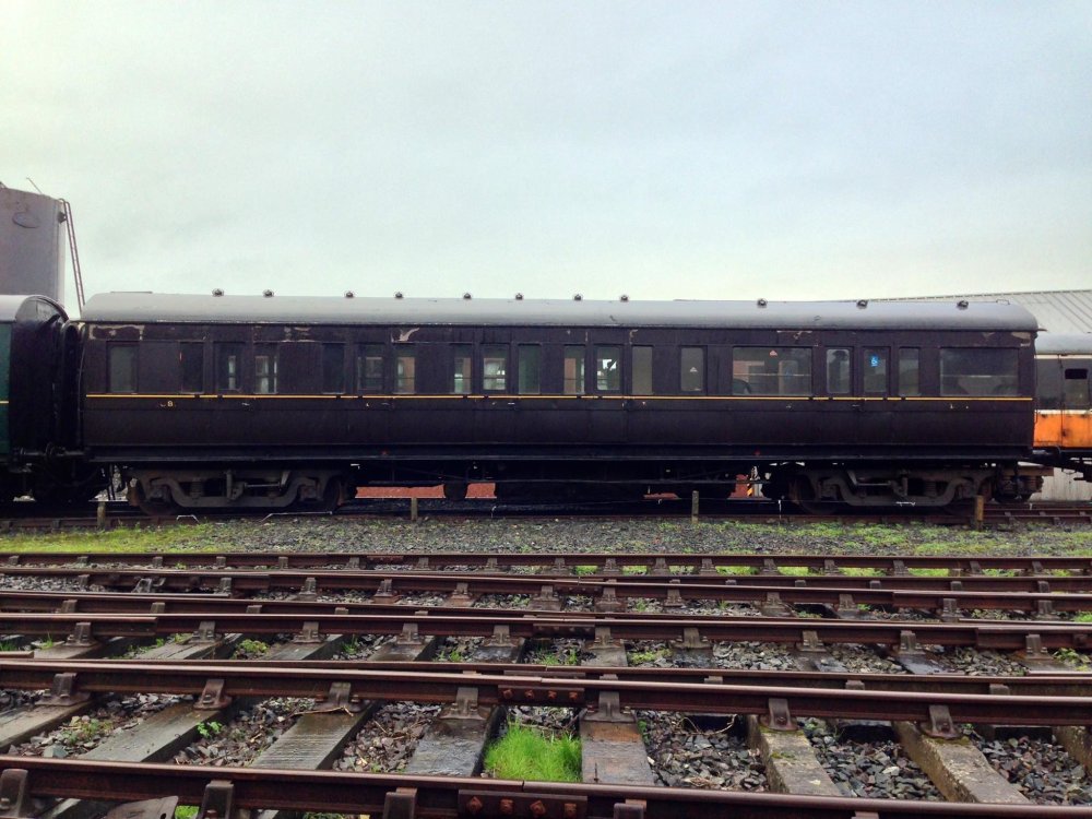

And this is the preserved first of a similar type, photo by Kieran Marshall:
1142 at Inchicore, 19/7/17
I can see the difference now you have pointed it out, but I'm not sure it's quite as bad as having the wrong number of wheels!
Anyway, the objections were so strong that I'll forget that plan.

That's very interesting, because I had been puzzling over the arrangement of that second coach in Ernie's photo.
This is a similar vehicle, quite possibly the same one:
GMK004 CIE 1955-xx-xx Cork, Youghal Excursion J15 195 TI215
Also interesting to note that the one at Downpatrick has had a bogie swap and lost its footboards, changing the appearance somewhat.
I think there were a variety of layouts for this 'family' of GSWR corridor carriages, although I'm fairly sure that the thirds were the most numerous. However, as yet I haven't found a list of types or numbers, nor any diagrams or drawings. I have an IRRS journal with a good article on GSR carriages, which mentions the thirds that were being built in the GSWR/GSR transition period. I don't have an equivalent article on GSWR carriages although I suspect there is something on that topic in the IRRS archives. The book 'Irish Broad Gauge Carriages', whilst useful, has a scope too broad to go into much detail on individual types. Based on photos...

Thanks for that photo. It gained commonwealth bogies and double doors in its saloon when it was converted to an ambulance coach, AM12, for the Knock pilgrimage train in 1959.
https://www.downrail.co.uk/rollingstock/gswr1097/
