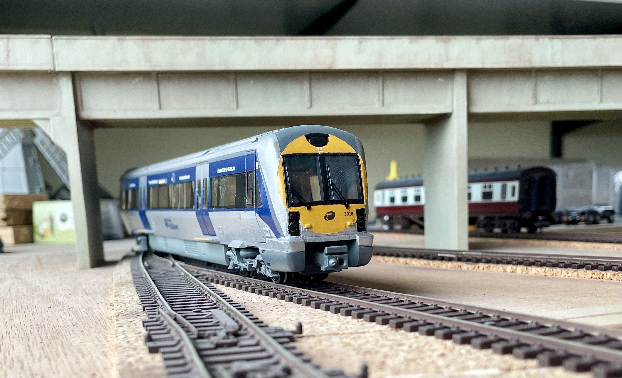

Darius43 Posted September 26 Author Posted September 26 It’s a duck under access scenario. Power bus installation tomorrow. Cheers Darius 2

Darius43 Posted September 27 Author Posted September 27 (edited) Power bus installed below the baseboards with feeds to each length of flexitrack soldered to the undersides of the rails. Found one short due to one of the turnout frog rails not having an insulated joiner - fixed. Running fine on DCC. Cheers Darius Edited September 27 by Darius43 7

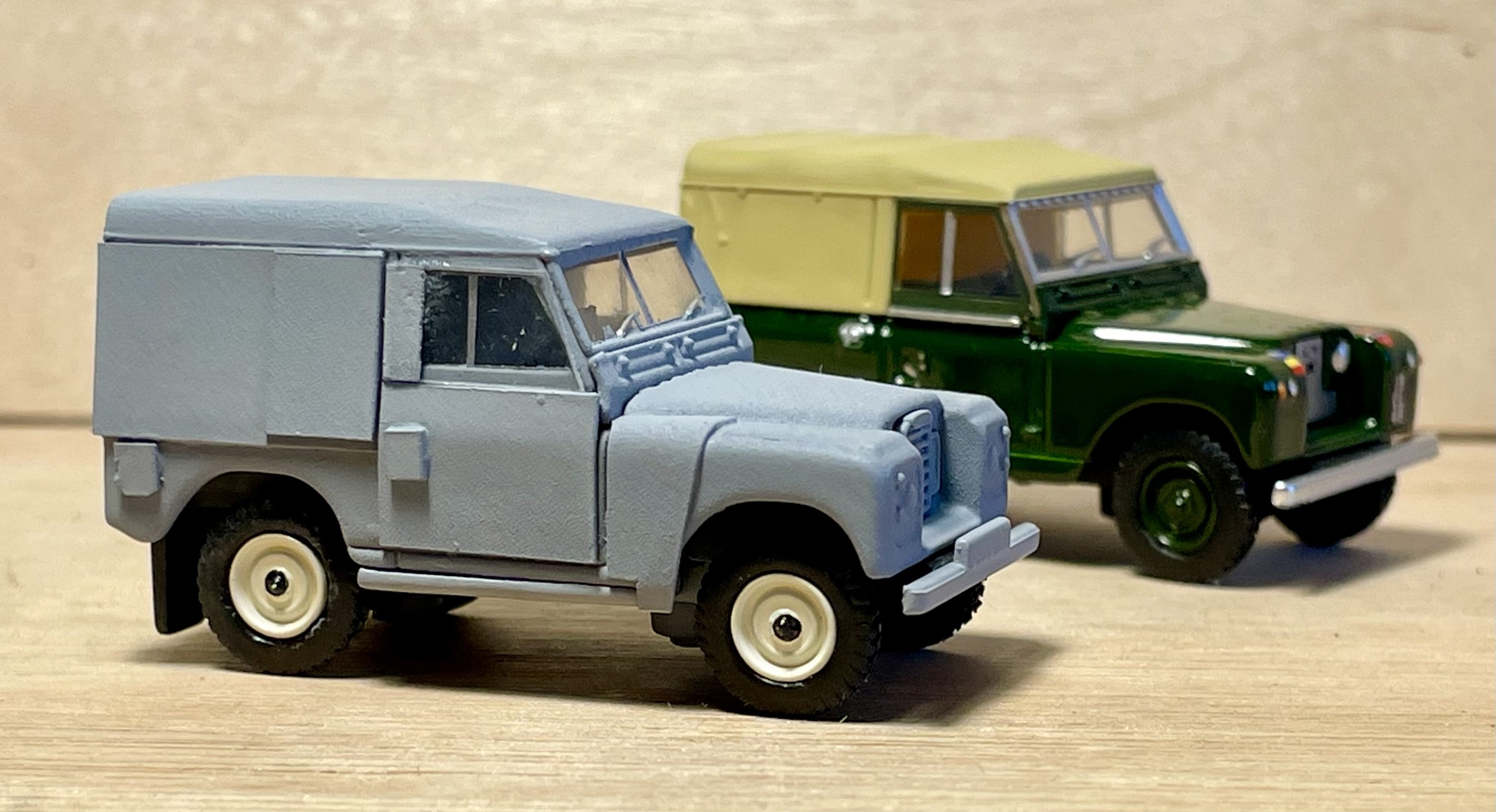

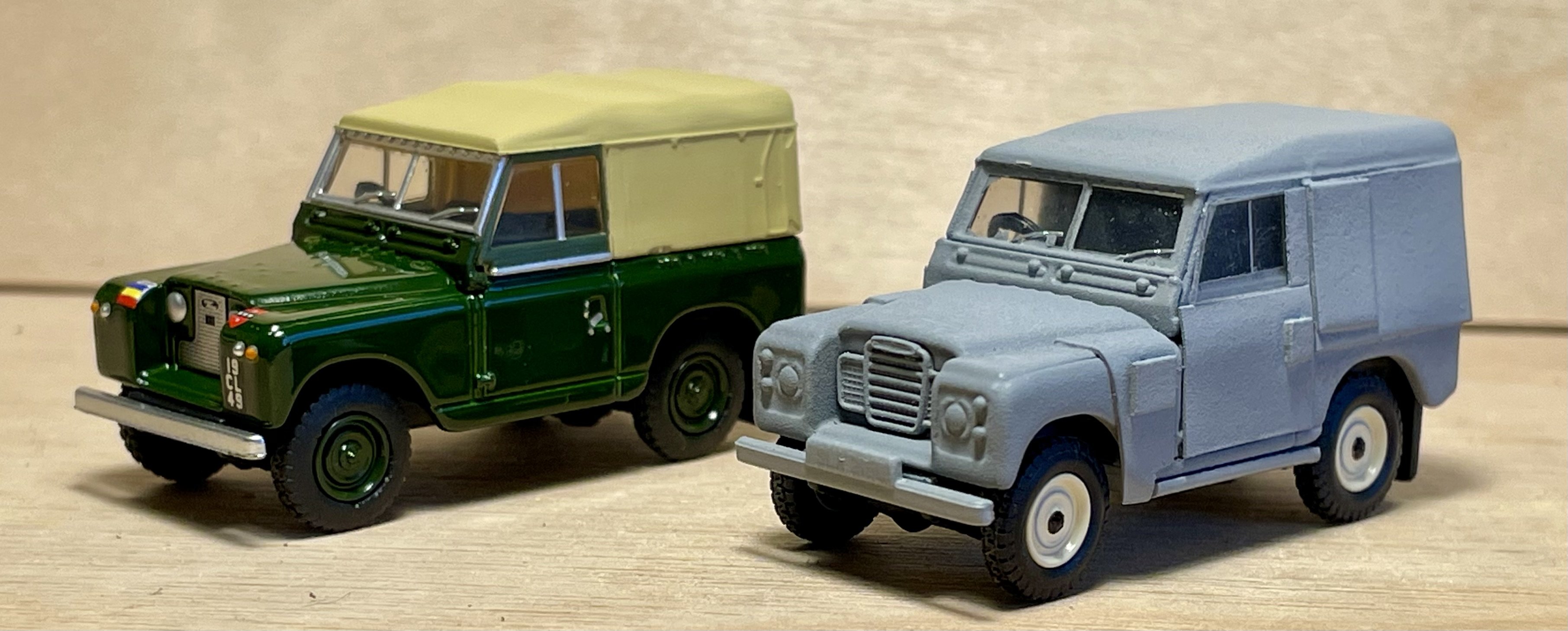

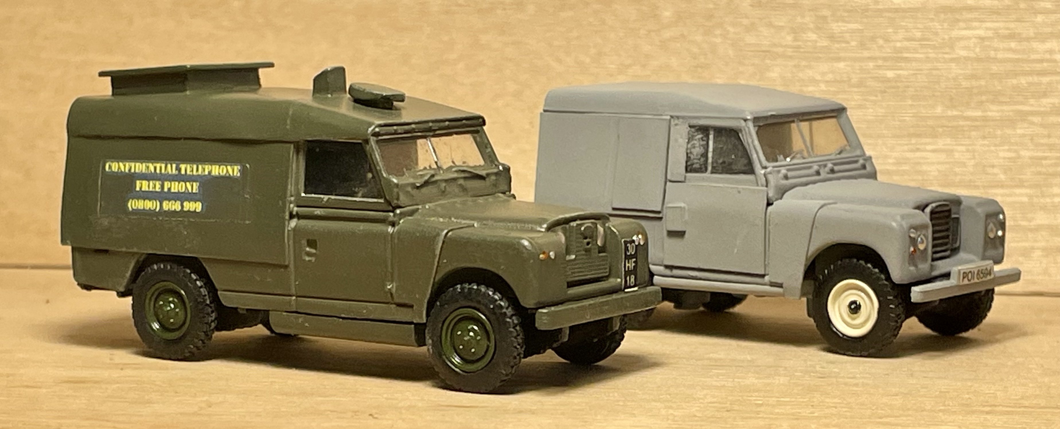

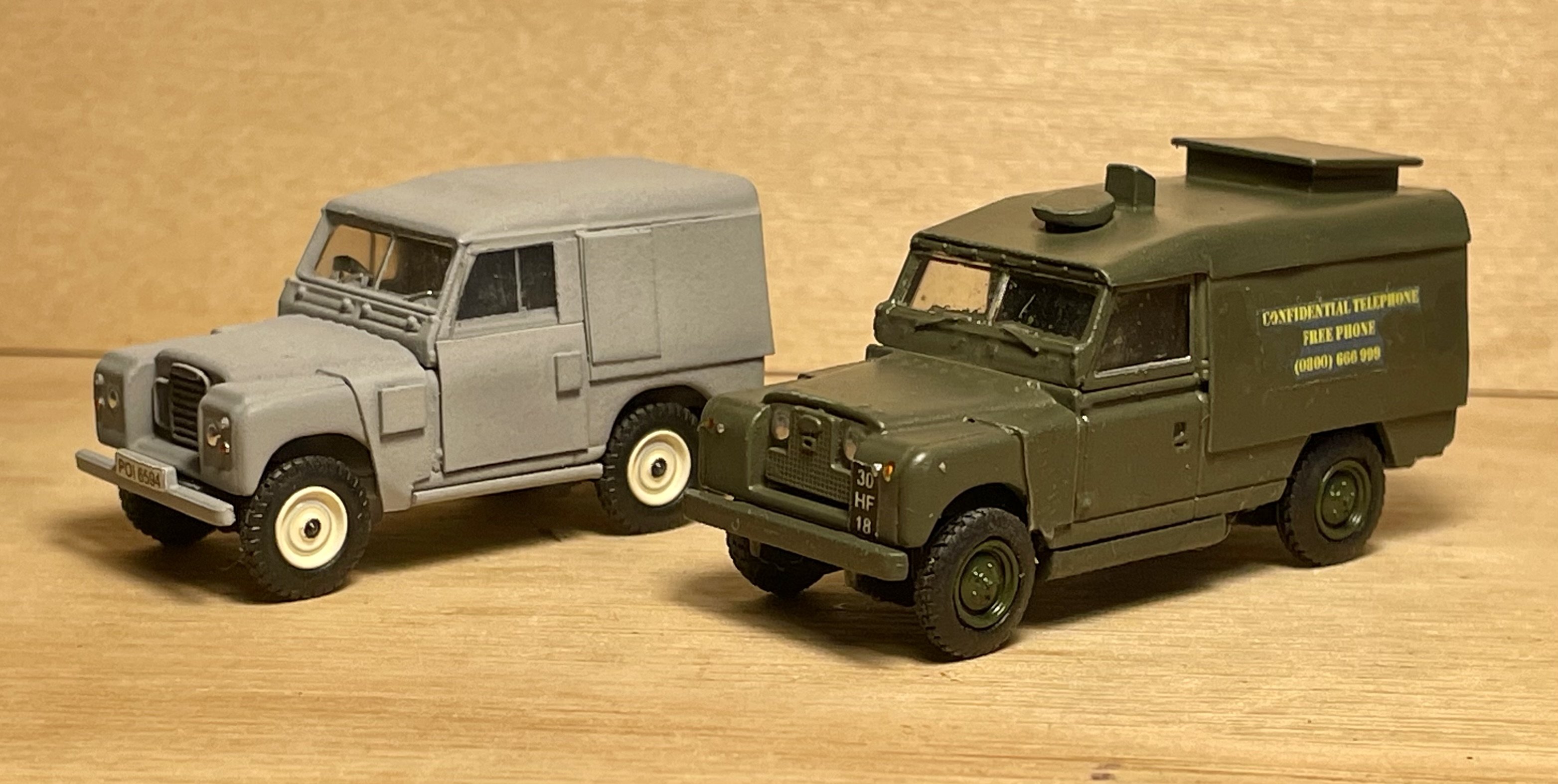

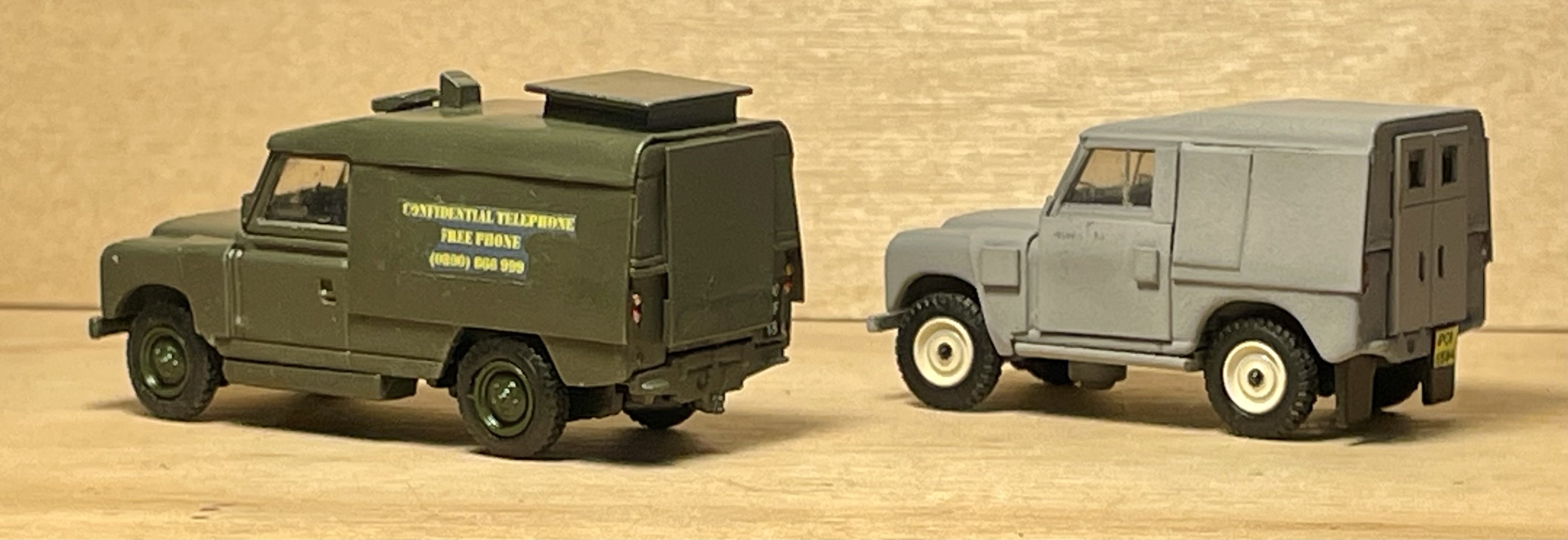

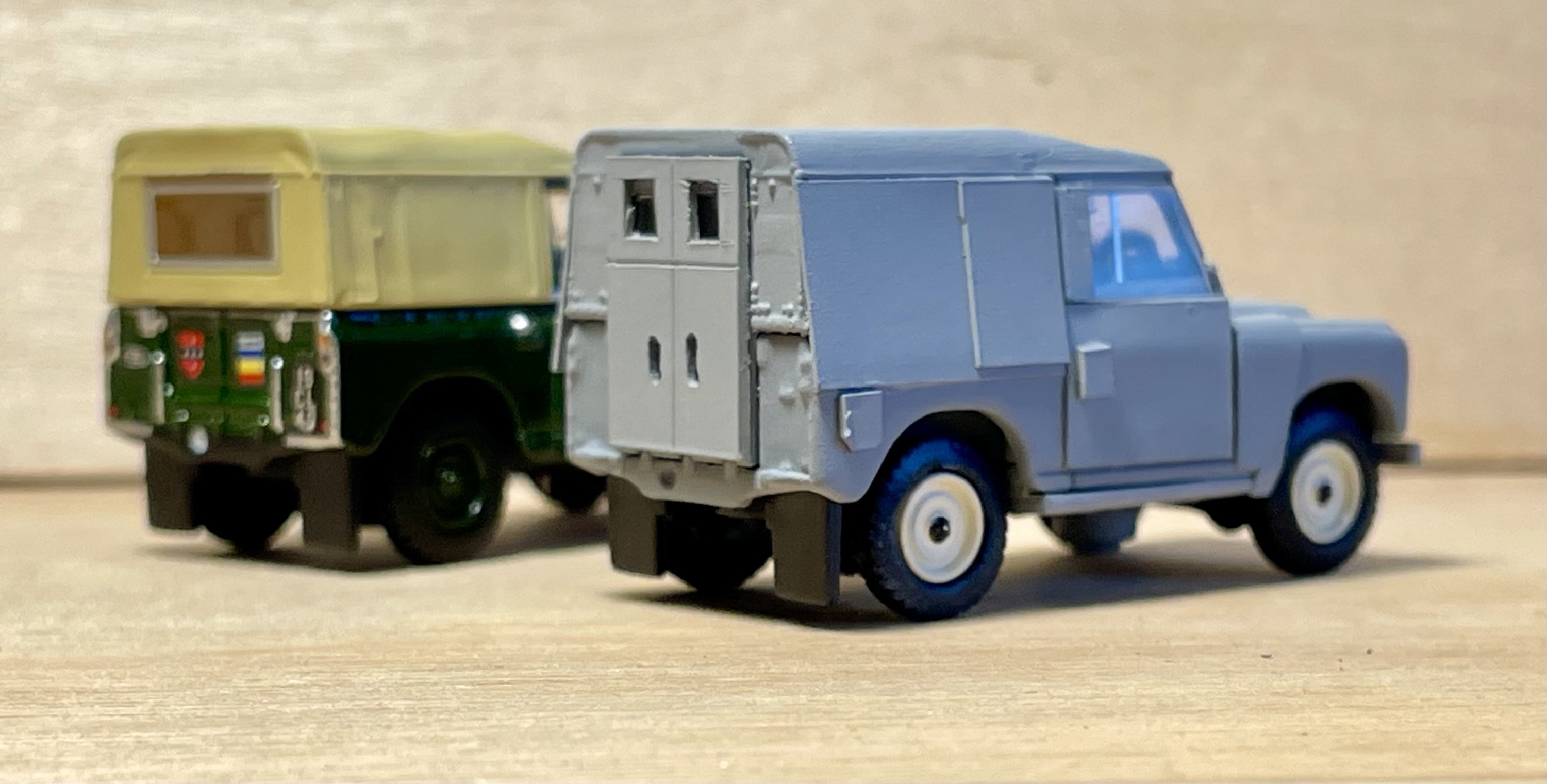

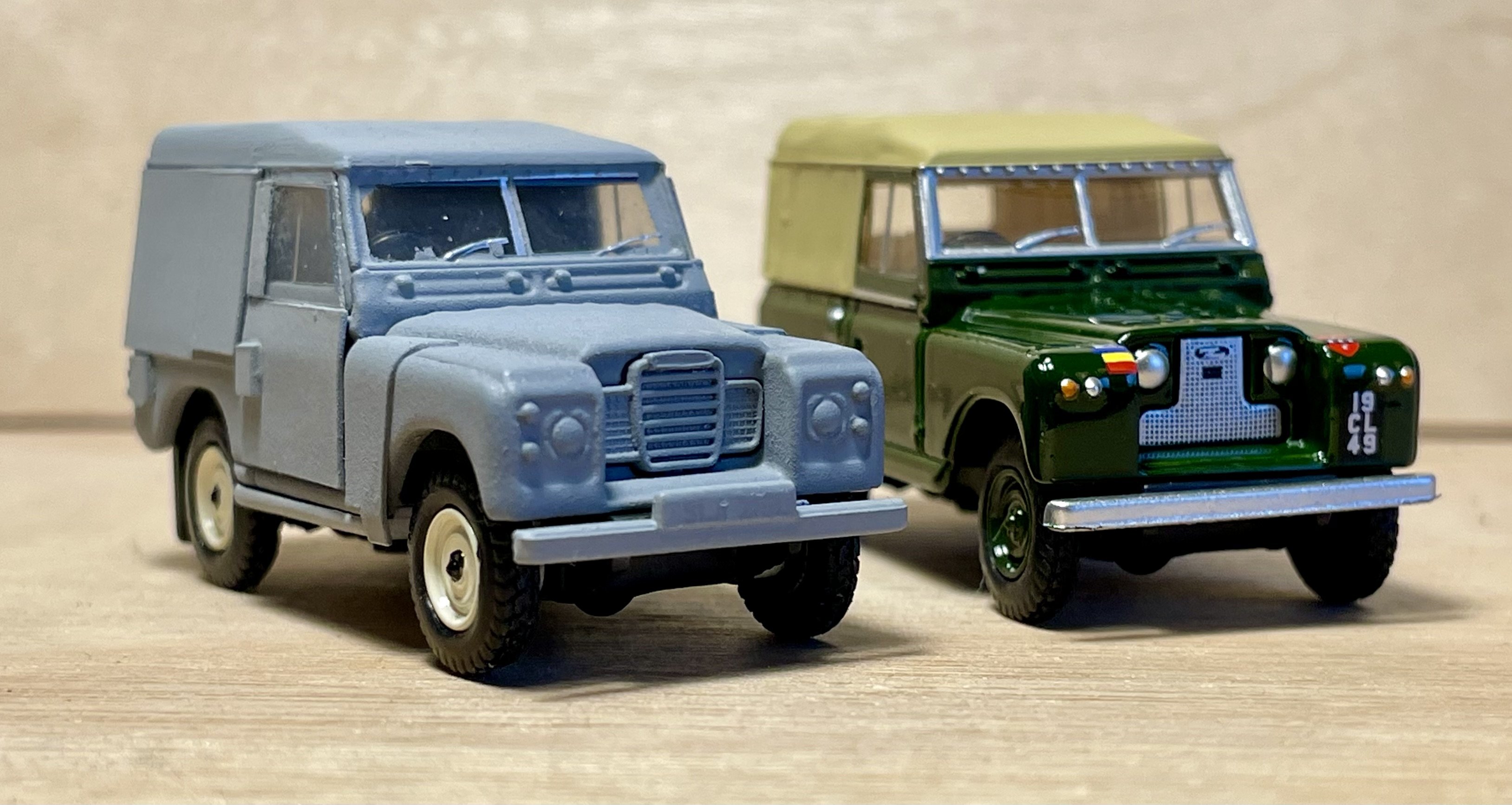

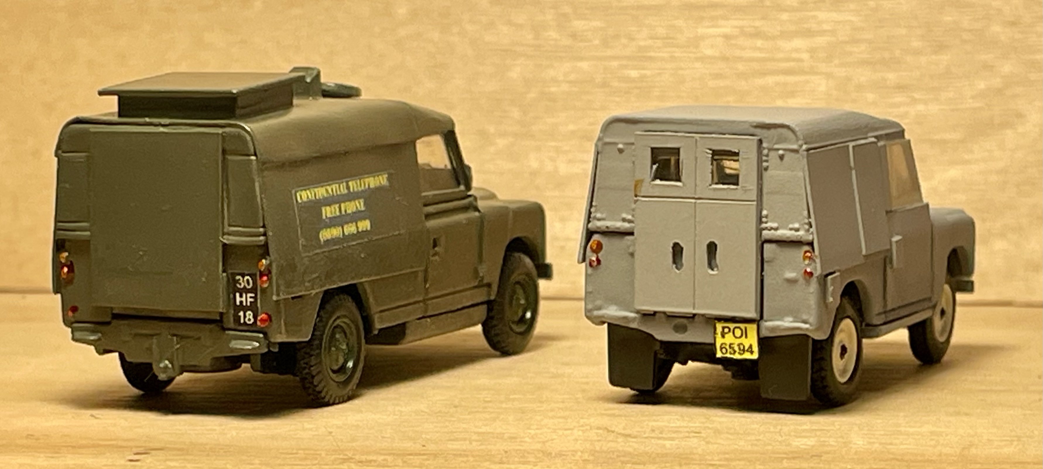

Darius43 Posted October 2 Author Posted October 2 Modified Oxford Diecast Land Rover using thin plasticard. Still need to add outer mesh screen to windscreen and touch in head and tail lamps - plus number plates. Cheers Darius 9

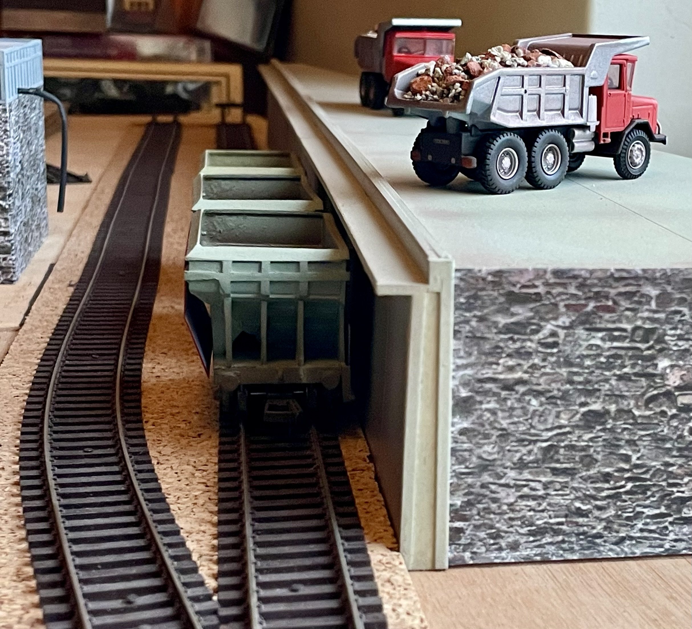

Darius43 Posted October 5 Author Posted October 5 Spoil loading dock constructed using 2mm card stock. The dock structure has now been coated with diluted pva prior to painting. Cheers Darius 13
Darius43 Posted October 6 Author Posted October 6 Spoil loading bank painted and weathered. Cheers Darius 10

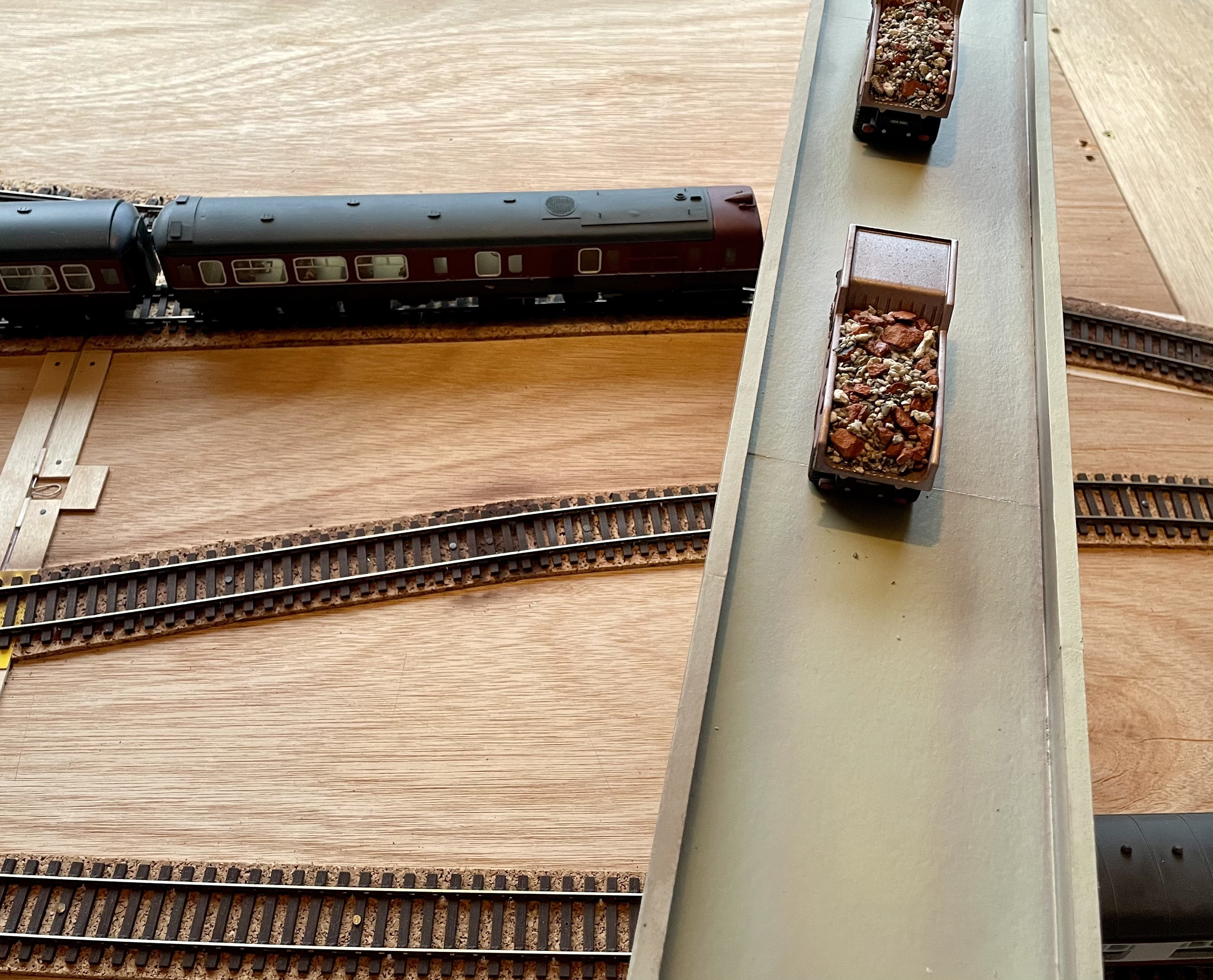

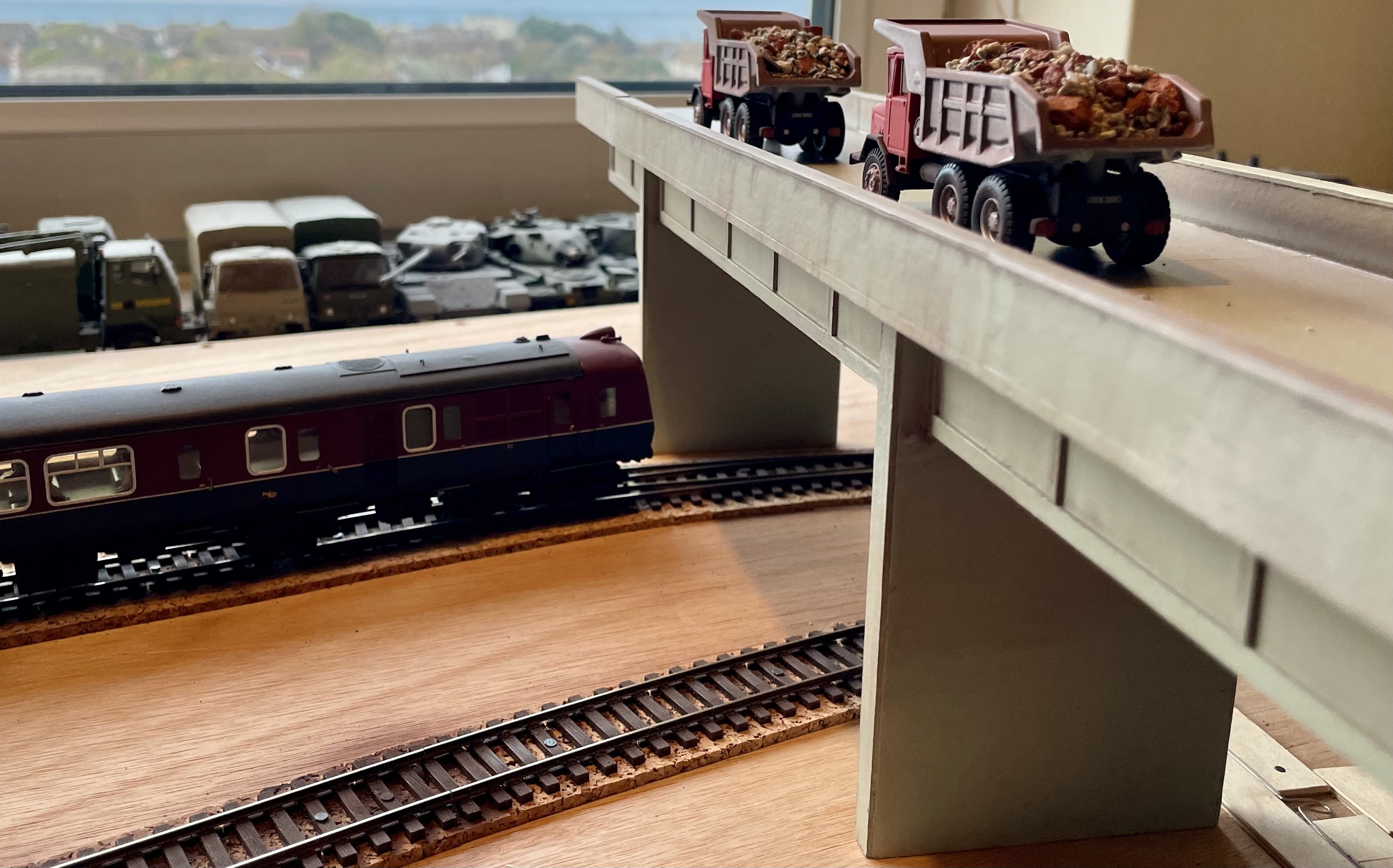

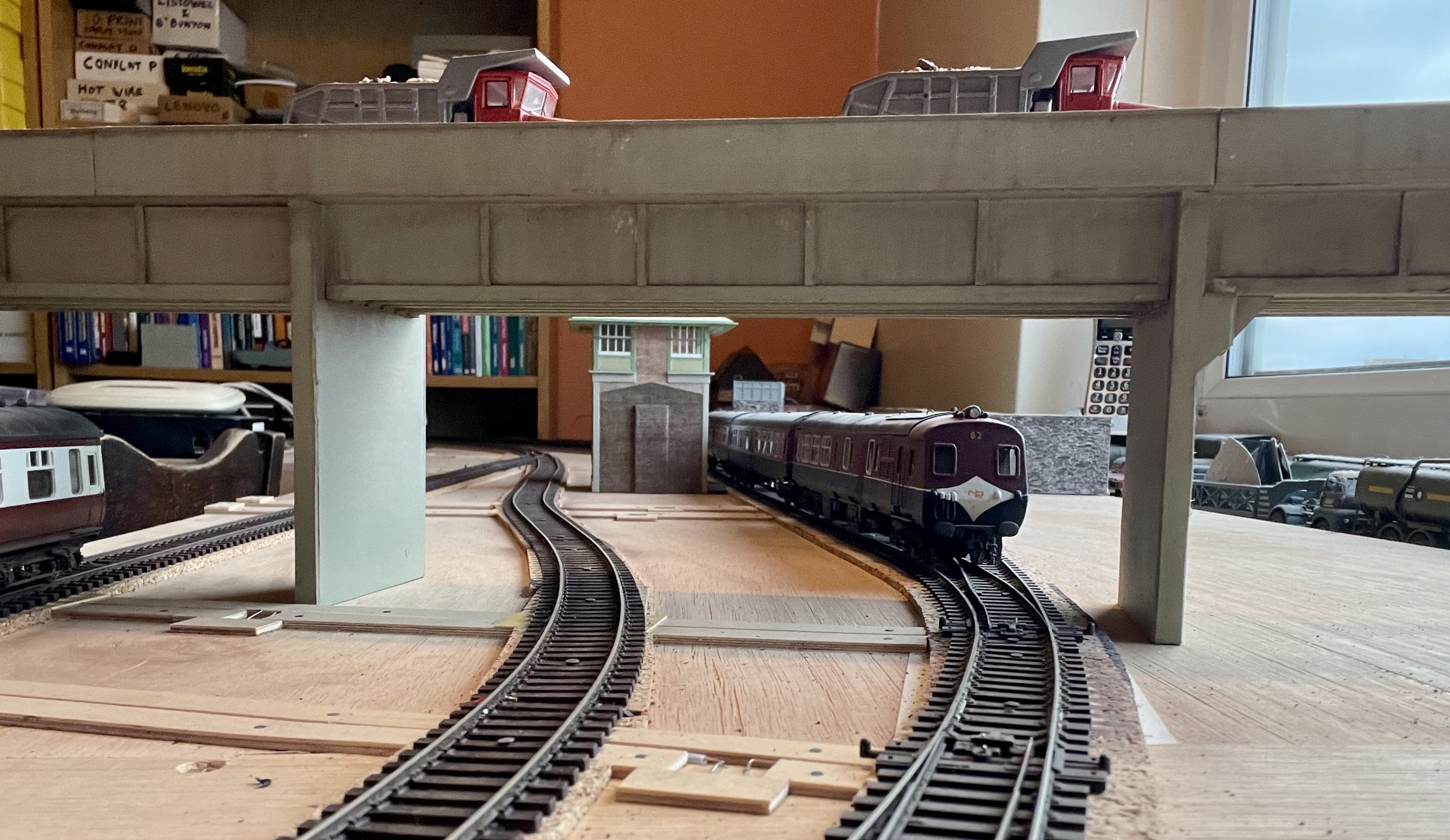

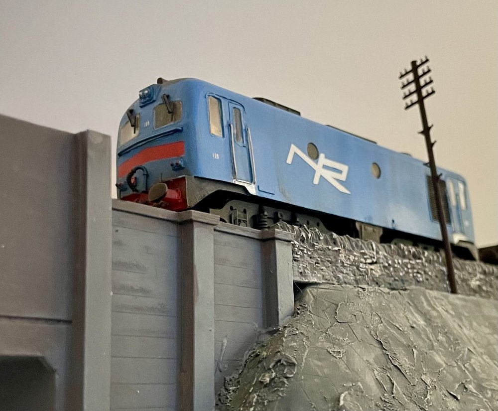

Darius43 Posted October 7 Author Posted October 7 (edited) Quarry road bridge constructed using hardboard, plywood offcuts and card stock. Cheers Darius Edited October 7 by Darius43 9 1
Darius43 Posted October 8 Author Posted October 8 (edited) Bridge painted and weathered. Cheers Darius Edited October 8 by Darius43 7
Darius43 Posted October 9 Author Posted October 9 (edited) No busses on this bridge… Dump trucks are repainted Oxford Diecast. Cheers Darius Edited October 9 by Darius43 9

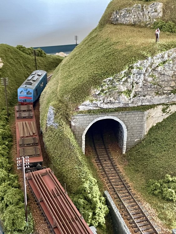

Darius43 Posted October 9 Author Posted October 9 Scenic element made from expanded polystyrene packaging and card stock for the roadway. I’ll let the glue set overnight and then sculpt it with a hot wire cutter. Cheers Darius 7
Darius43 Posted October 10 Author Posted October 10 (edited) Hot wire cutter used to sculpt the polystyrene. Then we get plastered. The slope at the right hand end is too steep so I’ll re-profile it later. Re-profiled. Cheers Darius Edited October 10 by Darius43 10 1
