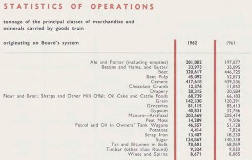

Mol_PMB Posted October 30, 2025 Posted October 30, 2025 Historical background Tar and bitumen are hydrocarbons, very heavy dense fractions which are almost solid at ambient temperatures. They are widely used in road surfacing, combined with stone chippings to produce Tarmacadam / Asphalt. In Ireland, tar/bitumen was primarily transported in barrels or drums until the 1950s. After the emergency years, there was a major boom in road transport. Many Irish roads were unsuitable for the increased speeds and tonnage of traffic, and so a programme of roadbuilding and improvements was undertaken. This required much larger quantities of tar/bitumen, as well as stone chippings. CIE was responsible for transporting both commodities – the stone was mostly transported by road from local quarries, but the tar/bitumen was imported to North Wall and distributed by rail. To cater for the increased quantities, a fleet of tank wagons was introduced – bulk transport being more efficient than handling thousands of barrels. CIE’s annual reports from the period often refer to this traffic, which seemed to be increasing consistently even in the context of declining freight overall. A summary of the main references may be of interest: 1952: The second development is the bulk movement of tar and bitumen, in gradual substitution for the former system of conveyance of these commodities in drums. The Board has commenced a building programme of rail and road tankers to enable hot bitumen and tar to be conveyed in bulk and the first of these units was introduced during the year. The economies achieved by this bulk transit system, as compared with the former, are apparent and the Board is taking all steps to secure as much as possible of this traffic. 1953: The development of tar and bitumen traffic in bulk is of recent origin and the basis of this traffic is that of bulk deliveries to storage plants erected by County Councils at various points in their areas from which distribution is made by the County Councils’ road repair vehicles. The Board makes every endeavour to facilitate the County Councils by the provision of sites for erection of storage plants. An additional 33 rail tar tankers and 8 road tar tankers were provided for the transport of hot bitumen. 1954: Goods traffic showed an increase over the previous year, particularly in the carriage of … tar and bitumen. … Seventeen new rail tar tankers were put into service, making a total of 50 in operation during the year. These vehicles, with a total capacity of 83,000 gallons, were fully taxed in dealing with the traffic offering. 1955: During the year, 30 additional rail tankers were put into service for the tar and bitumen bulk traffic, bringing the total number in operation to 80. 1956: Revenue from the bulk carriage of tar and bitumen increased by approximately £20,000 compared to the previous year and the demand for bulk service continued to increase. During the year, 28 rail tank cars of 1,200 gallon capacity each, were increased to 3,000 gallon capacity. 1957: Tar and bitumen carried – 48,474 tons – was an increase of over 9,000 tons compared with the previous year owing to an increase in road work coupled with a higher demand for delivery of this material in bulk. 1958: Ten open goods wagons were converted to tar and bitumen tankers, bringing the total number of vehicles for this traffic to 90. 1959: The carriage of tar and bitumen in bulk amounted to 51,340 tons, or an increase of 4,957 on the previous year’s figures. This rise was due to the increasing number of County Councils which are taking delivery of road dressing materials in bulk. For this traffic Coras Iompair Eireann operates a fleet of 90 special bulk tar tankers. From 1961, ‘Tar and Bitumen in bulk’ had become significant enough to be listed separately in the traffic statistics, and the annual tonnage continued to rise, as shown by these figures for 1961 and 1962: Traffic The tar/bitumen traffic seems to have mostly originated at North Wall, having been imported by ship. Photographs indicate that small numbers of tar/bitumen wagons were delivered by mixed goods trains to goods yards or private sidings all across the network. In the 1950s and 1960s the customer was usually the local county council, but later private firms became involved and these included Roadbinder Ltd, Cold Chon and Esso. Examples of locations receiving tar/bitumen traffic in included Lixnaw, Tralee, Killarney, Quartertown (Mallow), Sligo Quay, Roscrea, Oranmore, Cahir Abbey, and no doubt many other places across the country. 1

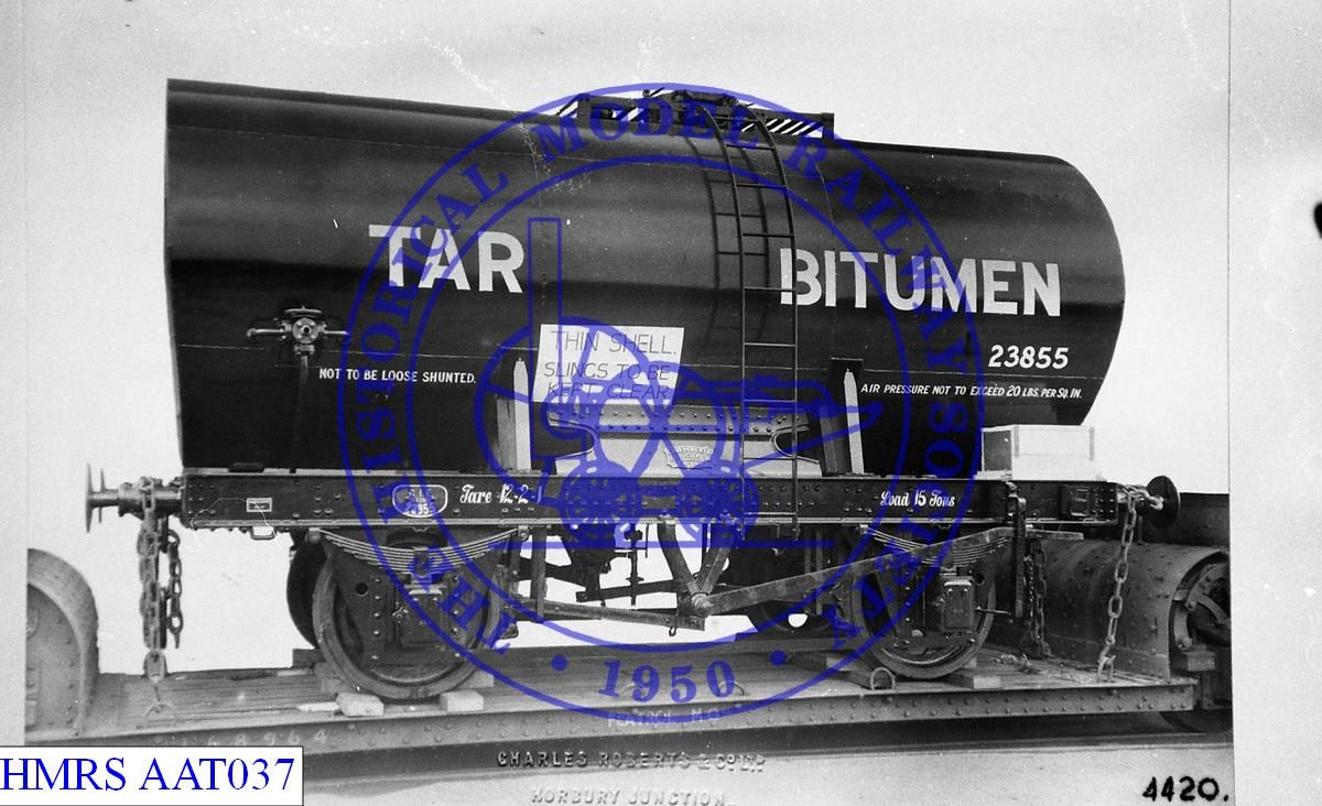

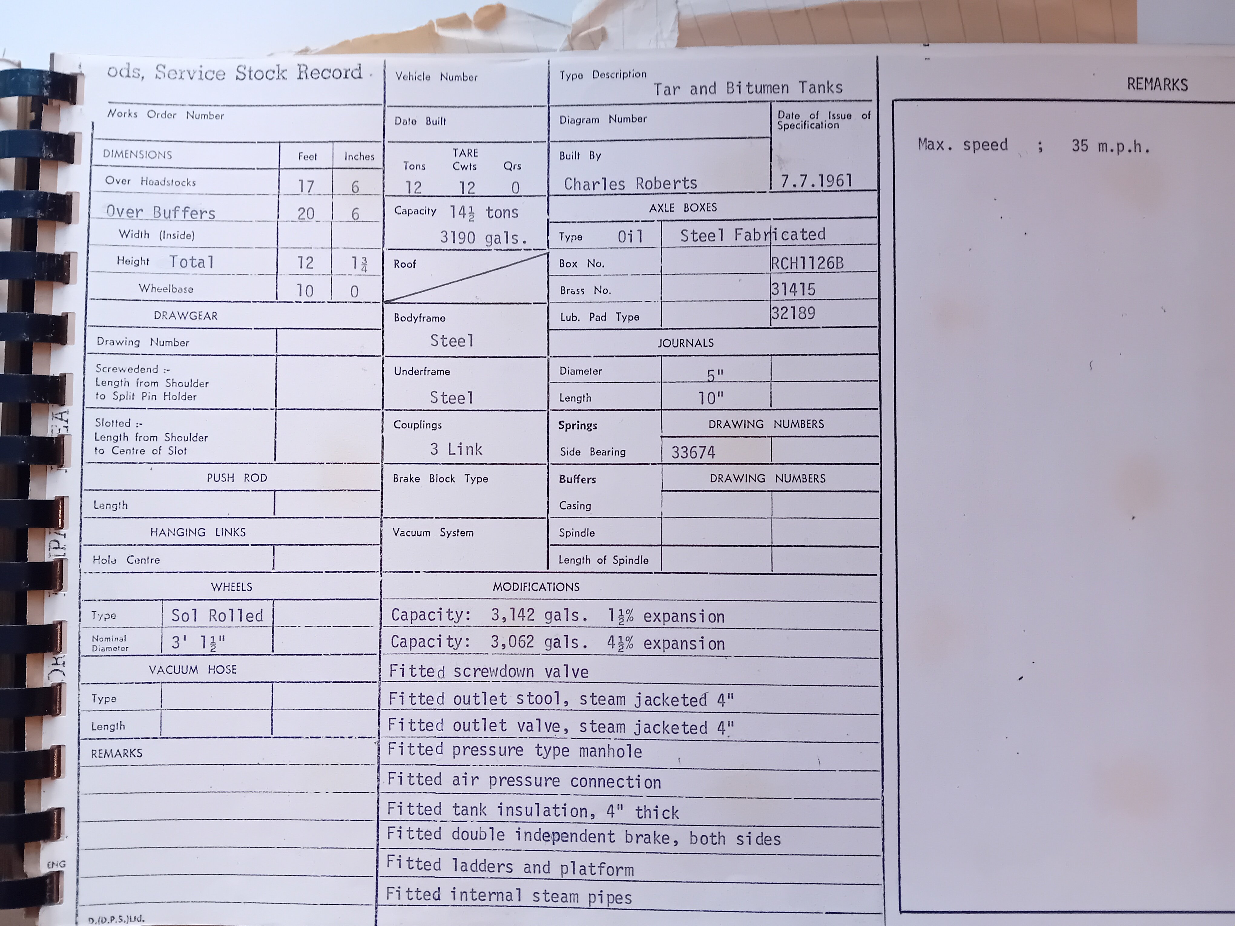

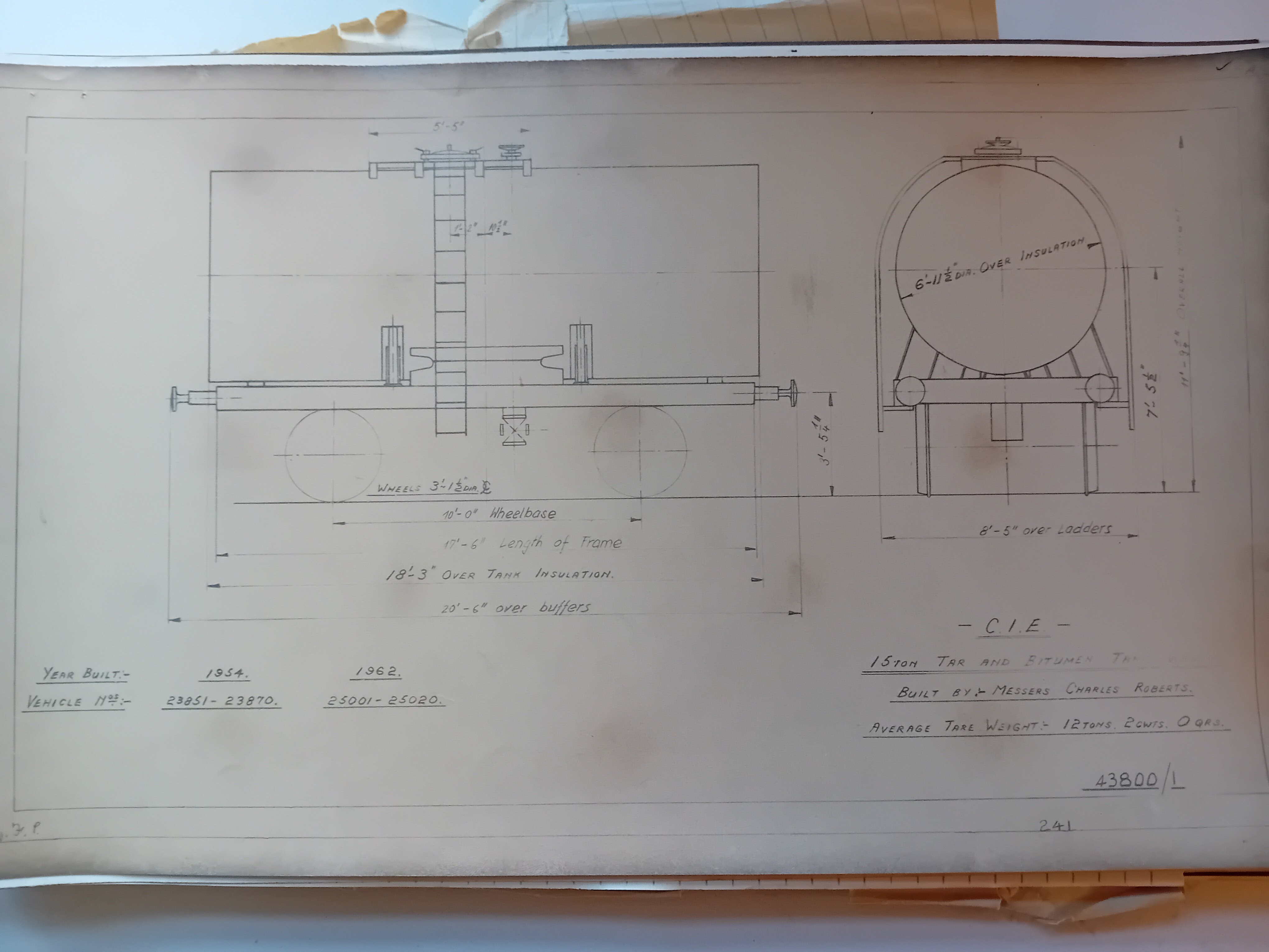

Mol_PMB Posted October 30, 2025 Author Posted October 30, 2025 (edited) Two batches of the tar/bitumen tank wagons were built for CIE by Charles Roberts, a well-established firm in Wakefield with particular expertise in tank wagons. The Charles Roberts records still exist in the care of the HMRS, and the archive of official works photos is available online. These wagons are also detailed in the CIE 1972 wagon register (of which Michael mfjoc has a copy). Consequently, there is generally more technical information available on the Charles Roberts wagons than the ones built or converted by CIE themselves. From the HMRS archive, this is a works photo of 23855 at the Charles Roberts factory on 23rd March 1954: This was one of the batch described by Pender & Richards as: 23851-23870, built 1954, 15 ton capacity, 17’6” length over headstocks, built by Charles Roberts, 3062 gallon capacity Considering the publication dates of the CIE annual reports, this batch of 20 probably missed the 1954 report and would be included in the 30 new tar tanks reported in the 1955 report. Some features to note in the photo above: GB RCH-style underframe, 10'0" wheelbase, BR-style plate axleguards with a circular hole in. Tie-bar connecting the axleguards. GB style brakes - independent brake each side operating brake shoes on both wheelsets. Tank (including lagging) is slightly longer than the 17'6" underframe. Tank secured by anchor mount arrangement with the cradles inboard of the wheels. Steam pipe fitting on the side of the tank (just left of the 'not to be loose shunted' lettering) There is also a note about air pressure - these tanks were fitted with an air connection to enable the tank to be pressurised slightly to encourage the thick tar to discharge. The tar/bitumen tank wagon diagram shown in CIE's 1972 diagram book is of this type. Many thanks to @mfjoc for a copy of this, which is extremely useful in giving the overall dimensions: Note that both batches of wagons built by Charles Roberts are listed on this diagram. The 1962 batch were similar, but not identical, as I'll show in the next post. Edited October 30, 2025 by Mol_PMB better image link 2

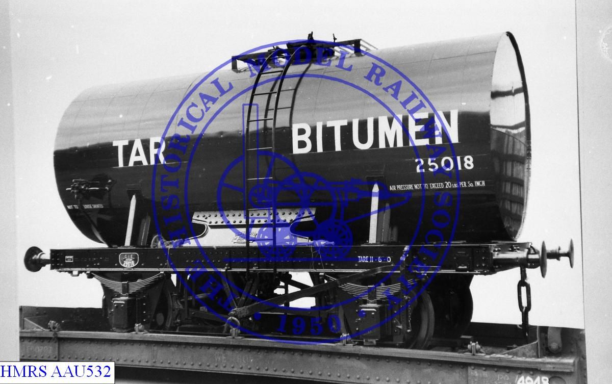

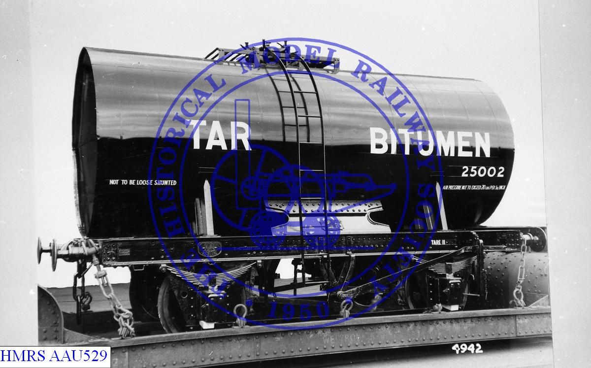

Mol_PMB Posted October 30, 2025 Author Posted October 30, 2025 The other batch of tar/bitumen tanks built by Charles Roberts was completed in 1962, and is illustrated by a pair of photos in the HMRS photo archive. Here's 25018 on 16th July 1962, showing the side with the steam fitting (left hand end of the tank). And here's the opposite side of 25002 on 31st May 1962, without the steam fitting. Note also the manhole and ladder are offset towards one end of the tank. These two were from the batch described by Pender & Richards as: 25001-25020, built 1962, 15 ton capacity, 17’6” length over headstocks, built by Charles Roberts, 3190 gallon capacity Compared to the previous batch 23851-23870, the major difference is that the tank support cradles have been moved further apart, and are directly above the wheelsets. These views also show that this final batch had the outer tank cladding slightly longer than the end cladding, so there's a 'flange' visible around the ends of the tanks. As shown in the previous post, the wagon diagram book entry has just one diagram covering these two batches, and the associated technical data is here: Note that the precise capacity depends on the condition of the load, and there is allowance for thermal expansion when it is heated for discharge. The absolute tank capacity is given as 3,190 gallons but lower values of 3,142 or 3,062 are also quoted which may be the usable capacity. This sheet also shows the load capacity as 14.5 tons whereas other sources give 15 tons. We probably shouldn't get too hung up about the 'exact' capacity (whether in gallons or tons) since it depends on the temperature and density of the load. In round figures all these Charles Roberts wagons are 3,000 gallon, 15 ton tanks. 4

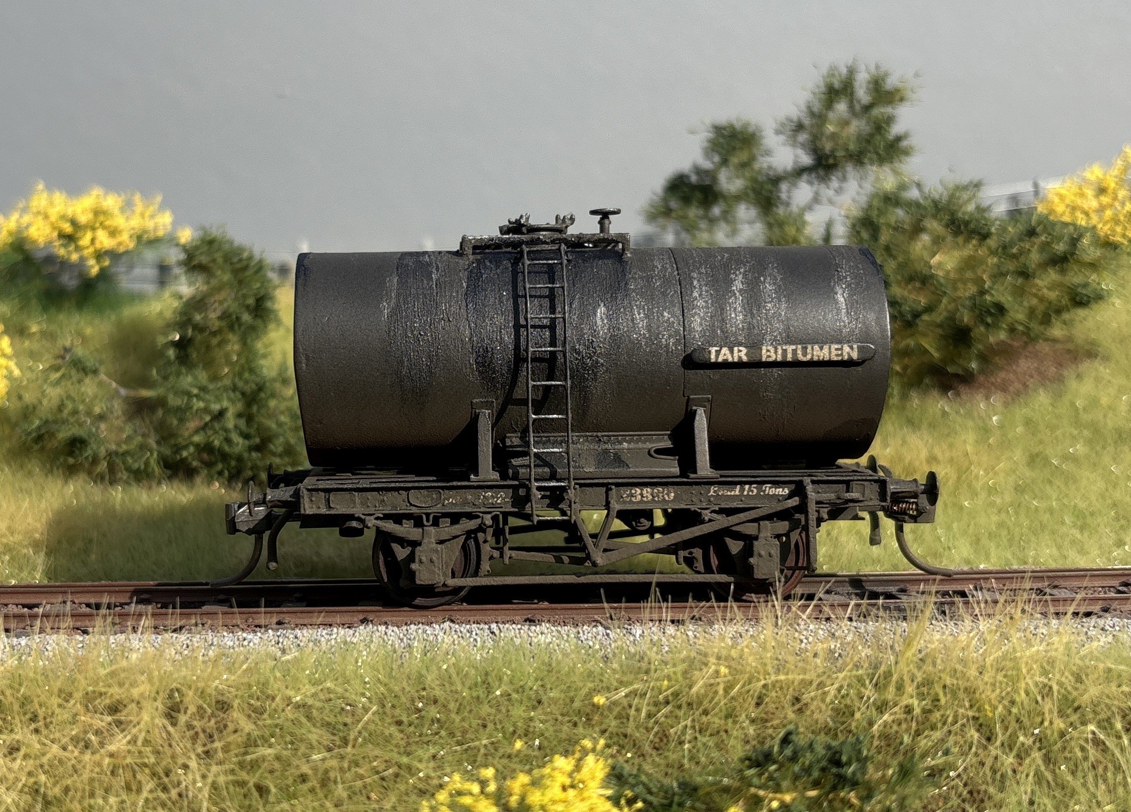

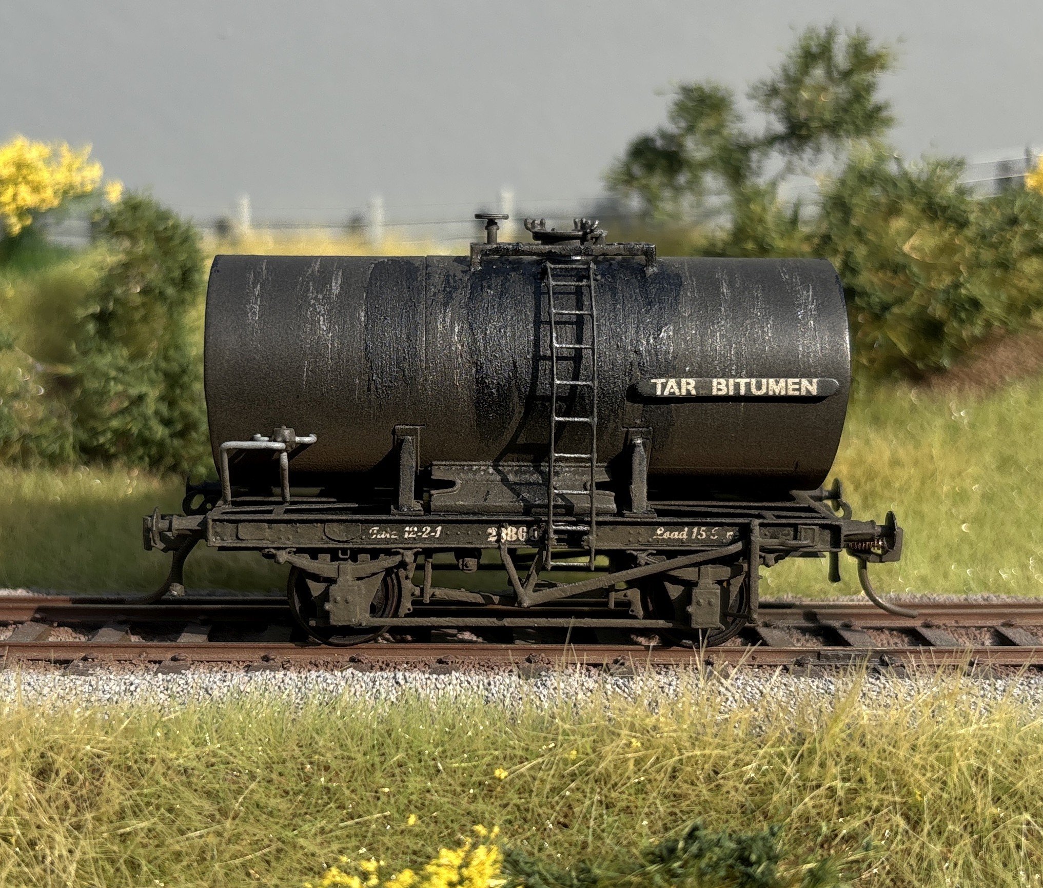

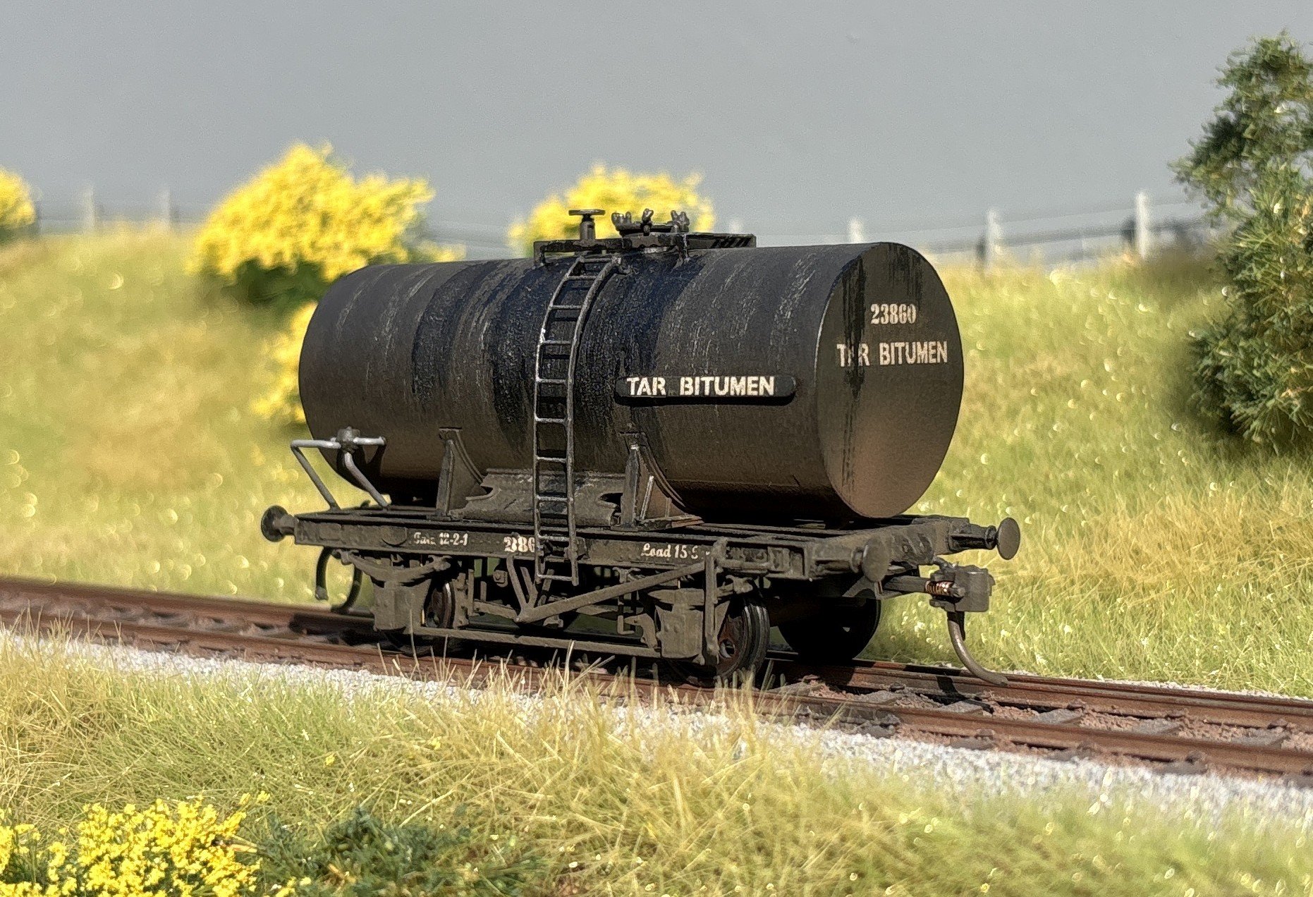

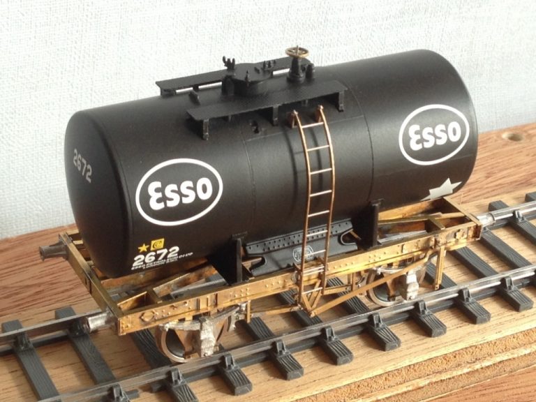

Mol_PMB Posted October 30, 2025 Author Posted October 30, 2025 (edited) Now, modelling. The best starting point is almost certainly the Bachmann anchor-mounted tank, which represents a Charles Roberts design very similar to those supplied to CIE in 1954 (23851-23870). This was made in black in Esso or Regent livery, and while the models are a few years old they aren't hard to find on EBay. A black one (class B) is a better starting point than a silver one (class A), as it has the right fittings for a tar tank including the steam heat connection on the tank side. The Bachmann tank diameter actually lies somewhere between the correct diameters for a 14T class B (6'7") and 14T class A/20T class B (7'3"). It's a compromise allowing the same moulding to be used for both. But for the CIE tar tanks it's perfect, because the diameter over the cladding of the tar tanks was 6'11.5" - matching the Bachmann model. For an OO gauge model, the minimum job is to remove the existing lettering and add transfers to represent the CIE livery. There are a couple of other discrepancies which could be addressed for a slightly more accurate model of the CIE Charles Roberts wagons: Reshape the tank ends to represent the cladding of a lagged tank Add a tiebar between the axleguards Add the extra steam plumbing fitted to the Irish wagons Widen the frame by 2mm to represent a broad gauge wagon (especially if wanting 21mm gauge). This would also enable the saddle shapes to be modified to better match the Irish wagons. Alternatively, the wagon can be modified to represent one of the Irish-built variants, with additional modifications to the brake gear instead of fitting the tie bar between the axleguards. For the more determined, you can build a replacement super-detailed underframe using an etched kit from Rumney Models; the kit also includes some more finely detailed ladders: https://website.rumneymodels.co.uk/tank-wagon-underframes https://website.rumneymodels.co.uk/wp-content/uploads/2017/04/B.71_14T_Anchor_Mount_Tank_Wagon_Chassis_Instructions.pdf This underframe kit would still need widening to suit 21mm gauge though! Edited October 30, 2025 by Mol_PMB correcting typo 6 1
