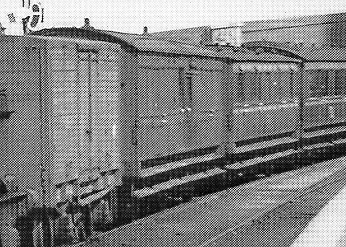

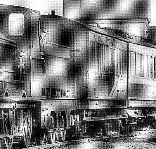

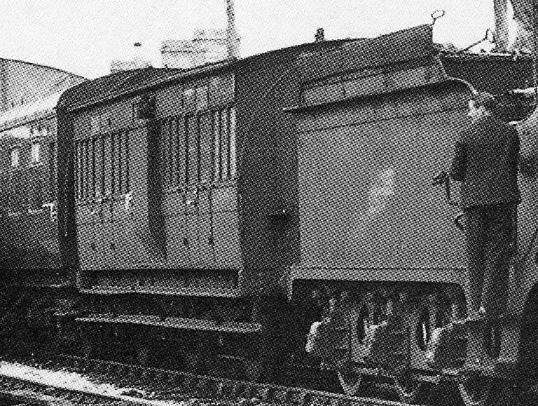

This is an excellent view which is reproduced in 'Great Southern Railways' - Murray, credited to W A Camwell and dated 1939. The photo shows two former GSWR full brakes, almost certainly diagram 88. They have full panelling with twin panels flanking the double doors, and a full complement of vents on the doors. The nearer van has skylights but the birdcage lookout on the roof is absent - probably removed by the GSR. However, the rear van retains its birdcage. Adjacent to the skylights are gas lamps to provide illumination after dark, exactly as shown on diagram 88.
The nearer van has a small window or hatch in the end, partly hidden by the loco tender, which is not shown on the diagram.

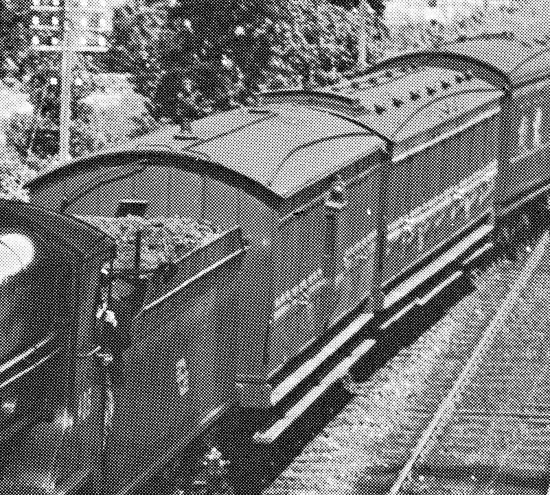

A nice view from a lower viewpoint is shown in the same book; this also dates from 1939 and is credited to the SLS. This diagram 88 van is still fully panelled but has lost its birdcage and the vents on the double doors.
Two other 1930s Camwell photos from the same book show distant views of similar diagram 88 vans without birdcages, but retaining a full set of door vents:

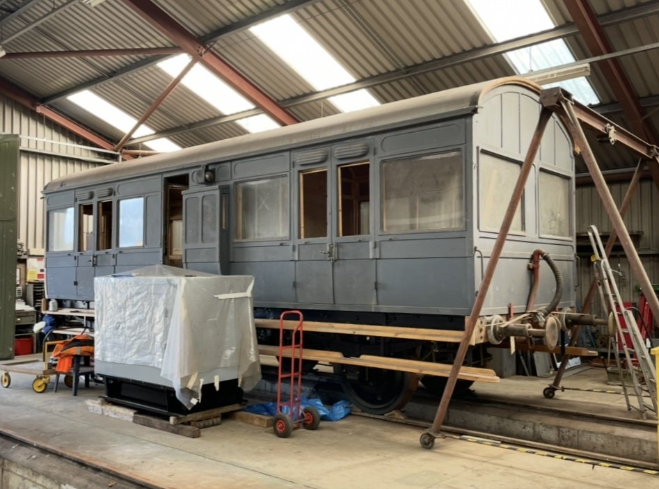

Great post. Worth mentioning that one of these coaches still exists, GSWR 69 built 1888, originally with a birdcage but was rebuilt at some point in service. It was one of only three I think to carry black and tan and is currently being converted to a first class saloon/observation brake (based on WLWR 77 which is at Belturbet) at Downpatrick.
Excellent. Do you have any older photos of 69 prior to its recent rebuild? I was about to ask if it was ever gangwayed but answered that question here - it was: https://www.downrail.co.uk/rollingstock/gswr69/  I'd still be interested to see any pics pre-restoration.
However, it wasn't the only gangwayed 6-wheel van (as claimed in the linked blog) as I will show in a future post on this thread. At least seven GSWR 6-wheel vans were gangwayed.

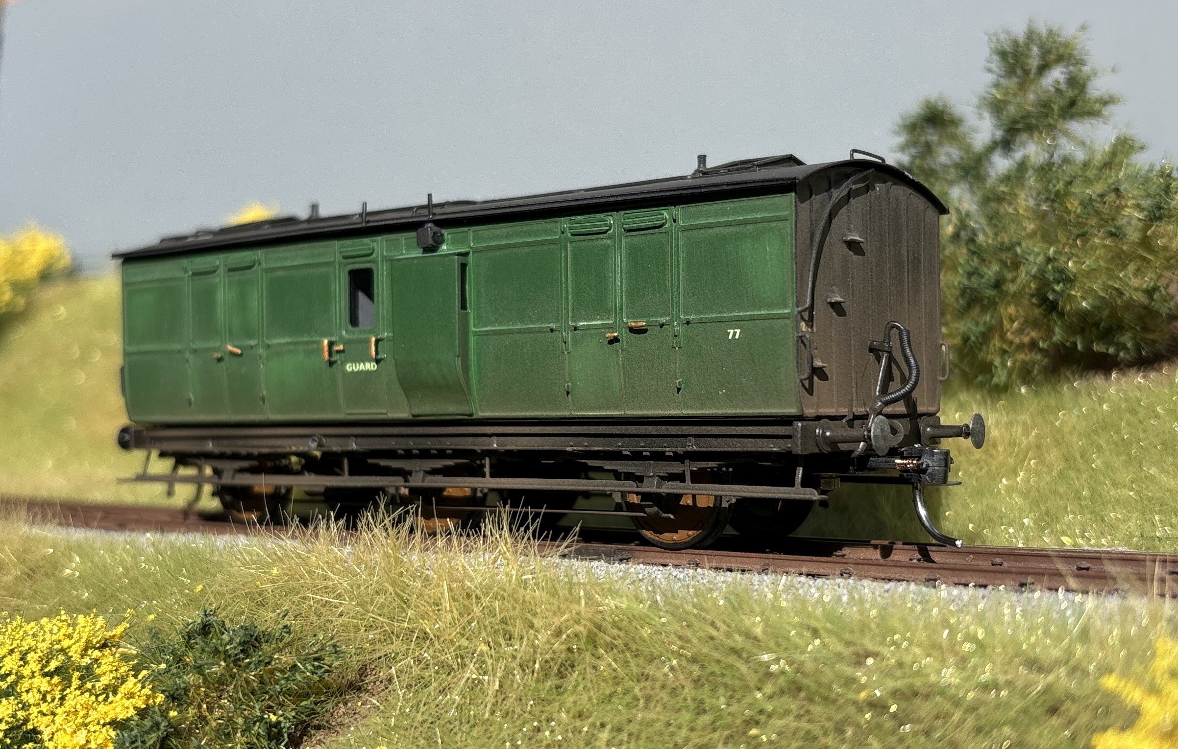

A brief intermission to show the artwork I've been preparing for a diagram 88 van in 1950s condition. Intended to replace the sides of an SSM third class coach kit.
I still need to do the duckets and the roof skylights, but I won't be adding a birdcage.

No.69 survives at Downpatrick, and is currently being rebuilt as a saloon. It has an elliptical roof and the description on the DCDR website notes that it was rebuilt in 1923, losing its birdcage when the roof was renewed. The website also notes that it was fitted with gangways, which were later removed.

46 minutes ago, Mol_PMB said:
A rare colour view of a diagram 88 full brake, still with its birdcage lookout, in 1959. The vehicle behind is not a GSWR one - most likely a CBSCR brake.
I wonder what shade of green this is, under the grime! I think plain unlined green could be either dark or light green.
It's dark green, and probably plain, though given the degree of weathering and fading, I would not rule out full lining, which is more likely to be what would be expected. The yoke behind it is - I THINK - a GSR heavy rebuild of an older vehicle which was a brake third of some sort. The contours suggest GSWR to me, though in and around Wisht Caark, boy, sure ye never know, boy! 😉 The roof looks too high for a Bandon vehicle.

The model is now just about finished. It may benefit from a touch more weathering on the chassis and roof to better match the decrepit condition of the body paintwork.
This is a vehicle at the end of its life around 1960 - last repainted in plain dark green in the early 1950s. New tin vans have replaced most of these and the few survivors are not worth a repaint as the branch lines they serve are about to close.
