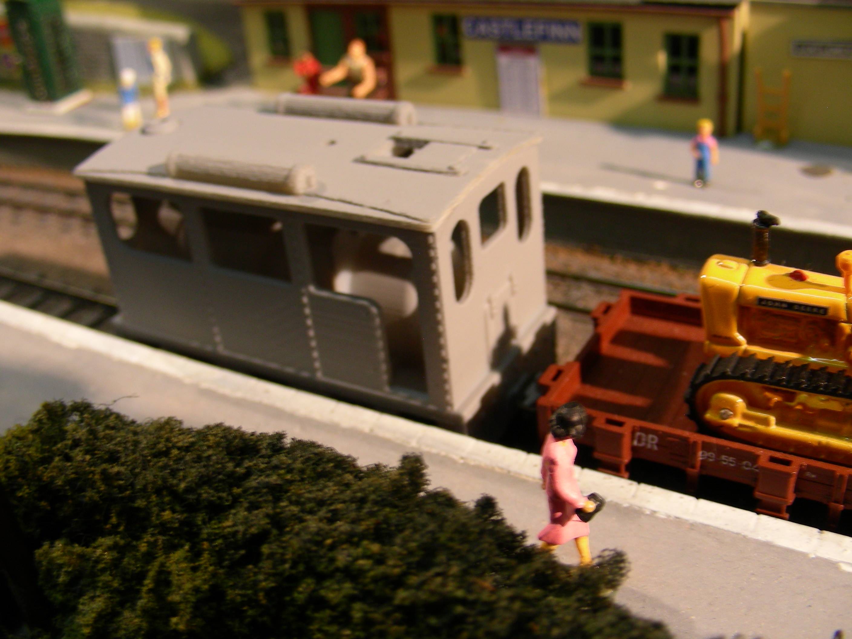

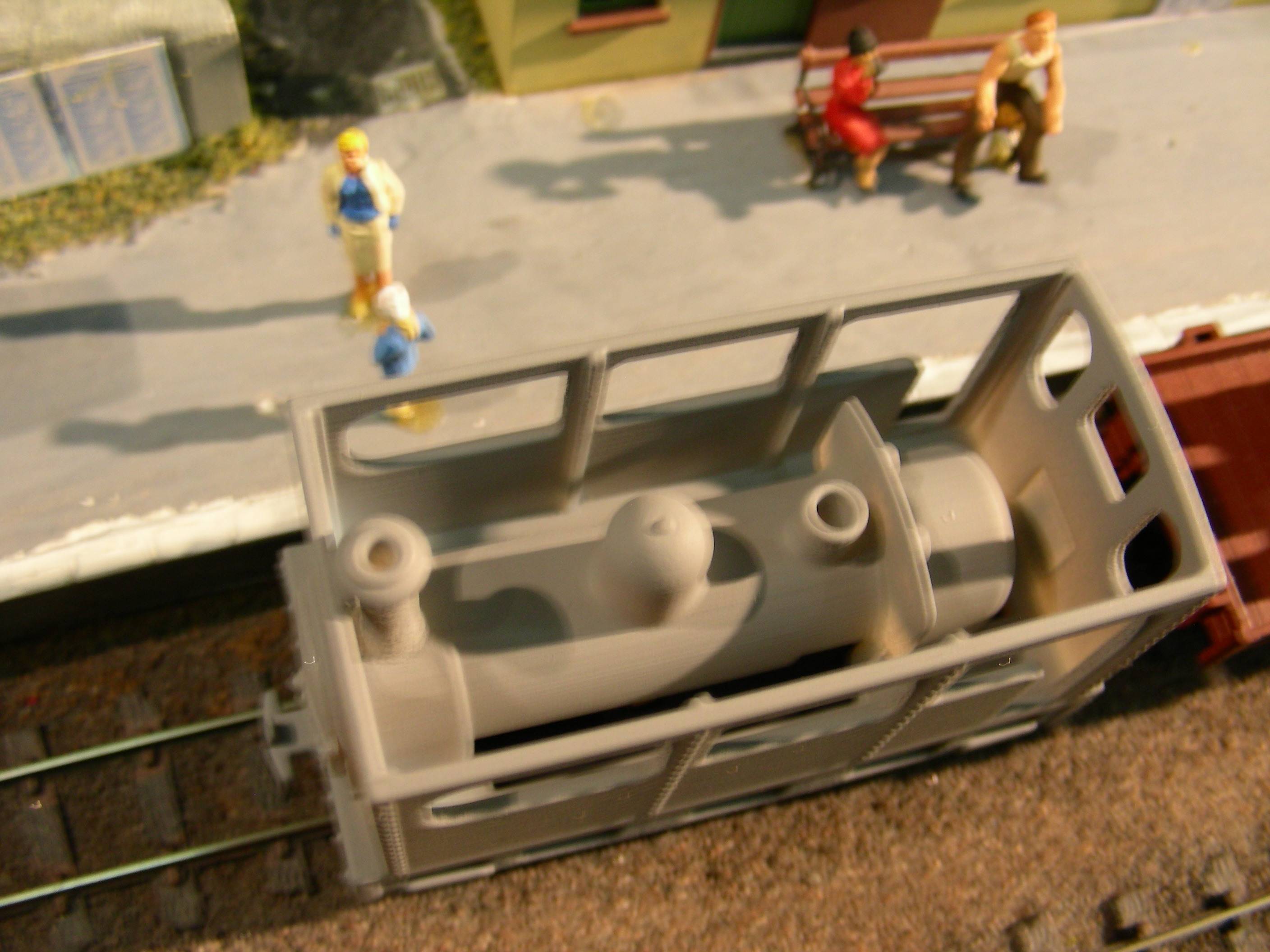

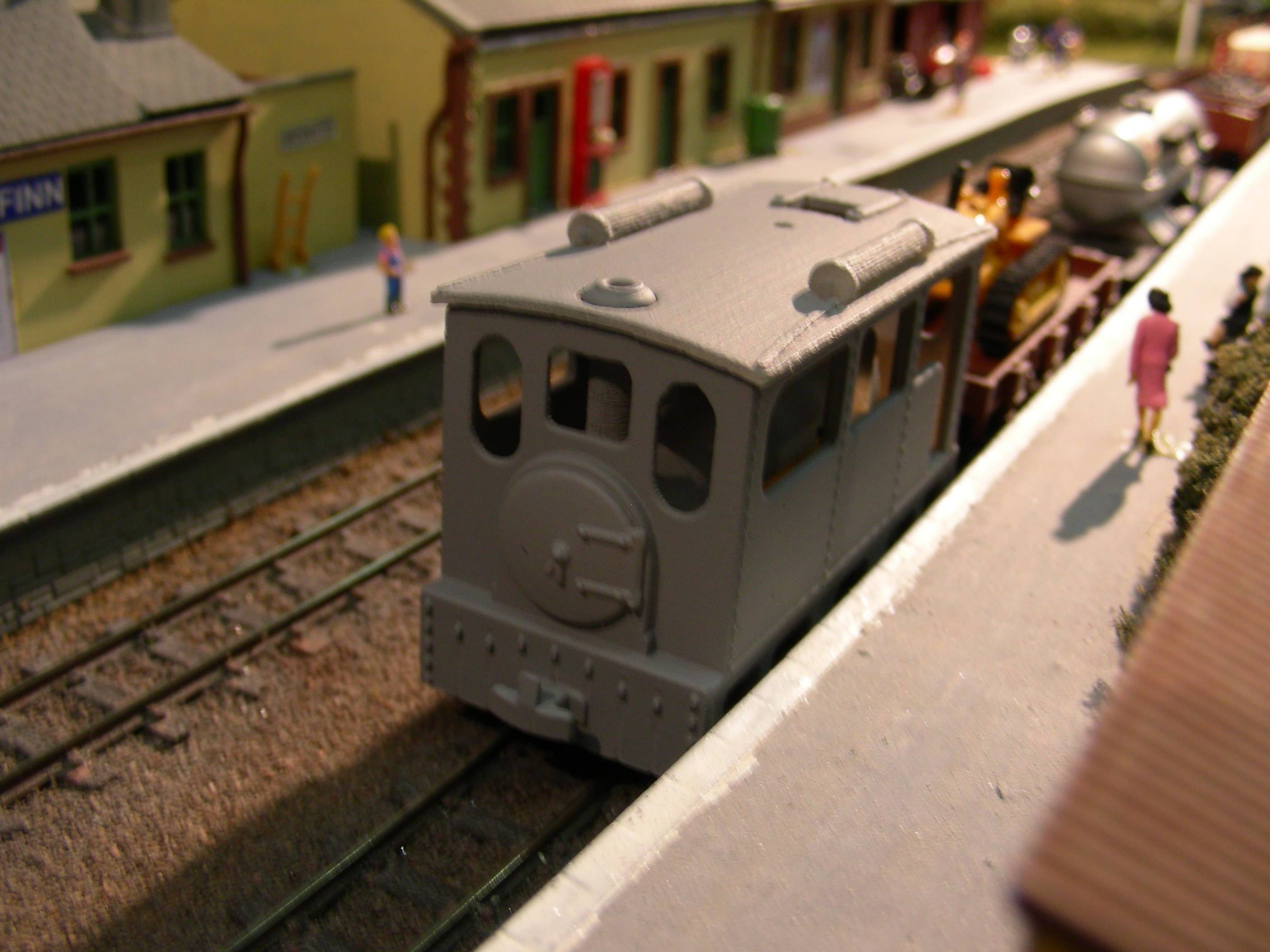

Broithe Posted September 20, 2013 Posted September 20, 2013 This little device was running on Castlefinn last Sunday at Abbeyleix. Straight out of the box and with a Kato chassis clicked into place. The finish was truly excellent - I thought that it would be a year or two before it got this good..

murrayec Posted September 30, 2013 Posted September 30, 2013 [quote=Weshty;36635 This is the quality of journalistic rigour in the BBC? God help us. Weshty You nailed it on the head Brothe Your pictures of the WARD printed loco;- Yes its a lovely little loco, though it is laced with under coat paint and you can still see the printer resolution lines on the model. I look at the loco at the show and reckoned it is a great system for small items, but imagine a DART- with its expanse of flat surface on its sides, it would require a lot of filling and clean up before painting. I'm going to buy one of the locos though murrayec
Broithe Posted September 30, 2013 Posted September 30, 2013 Brothe Your pictures of the WARD printed loco;- Yes its a lovely little loco, though it is laced with under coat paint and you can still see the printer resolution lines on the model. I look at the loco at the show and reckoned it is a great system for small items, but imagine a DART- with its expanse of flat surface on its sides, it would require a lot of filling and clean up before painting. I'm going to buy one of the locos though murrayec I thought the finish looked fairly good enough for something that was likely to be old and fairly grubby, with minimal rubbing down - not up to doing a shiny thing yet, though, I do agree.
