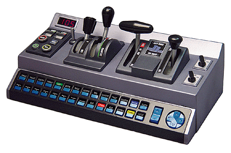

  4. Are there cab controllers with two knobs (ie power + brake simulation)?

4 - There are even USB controllers that simulate a full on loco :)
Also the Digitrax Zephr

Thanks BosKonay, this is really helpful. They are impressive. I'll do a bit more web searching on the controller options. I need to figure out which DCC modules types to install in my old locos. I'll do this slowly a few locos at a time. I presume I can use the simplest types for power only modules unless I need lights, sound, etc, but I may install small running lights in some of the steam locos which presumably need DCC modules with more wires attached to power the lights, and on the few diesels I have change the lights based on direction.
