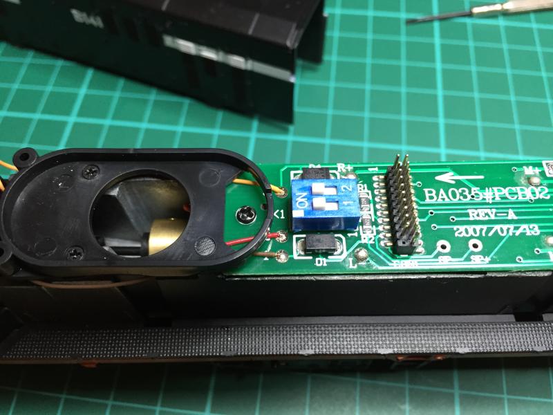

Zimo MX644D sound decoder and speaker from Mr Soundguy installed in MM B141 ready for sound checks
Will post video later
Edited by Noel
  • 0
That's a big speaker shoehorned in there! Is it enclosed at the back?
Yes it fits perfectly in the MM loco provided speaker cradle. EDIT: I later added some blue-tac under the speaker to anchor it in the speaker cradle and stop vibration which could cause sound distortion.
Edited by Noel
