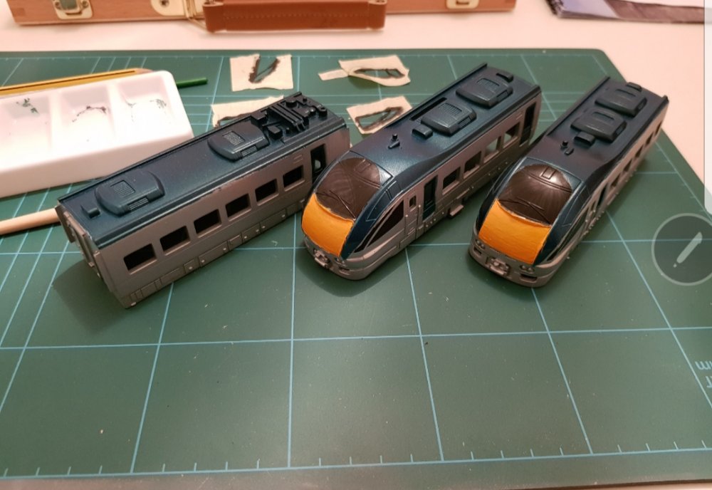

krose Posted December 21, 2016 Author Posted December 21, 2016 The purists on here are going to hate this post but I started a small project recently for my 3 year old son who wants a train for Christmas. I wanted something that resembled what he would see on rails here but it would have to be tough & strong so a Murphy Model 071 is out of the question. I found a 3 car Tomy set that would do as a doner for an ICR, as long as you ignore some of the details especially the roof detail Next I masked off the glazing and got it ready for priming with Halfords grey. Hope to start the silver tonight and then the green & yellow before Sunday. I got Des in Studio Scale to produce transfers for it which will set it off. Can anyone tell me what is the best way to fix the decals on so that they stay on, as this model will get quite a bit of handling? or point me to a video/webpage with a tutorial? Thanks Karl Quote
Noel Posted December 21, 2016 Posted December 21, 2016 Hi Karl. Great idea. Decal fix for the transfers over clear gloss varnish finish, then a coat of clear matt varnish on top to finish it all off. It will look a great Irish rail ICR for your son. Noel Quote

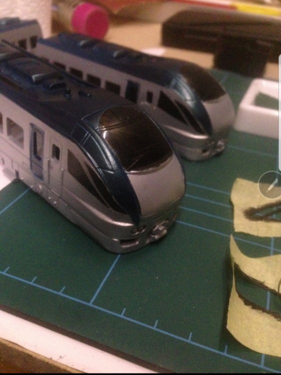

krose Posted December 22, 2016 Author Posted December 22, 2016 Thanks lads great encouragement. Got the silver on earlier and it looks a bit bright in the first photo. Then it was onto masking off for the green which I found very time consuming. Only got 1 car done this evening. I've planned to go for pints tomorrow night so I need to get a hurry on to have it finished on time. Quote

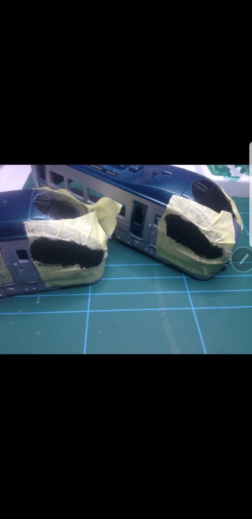

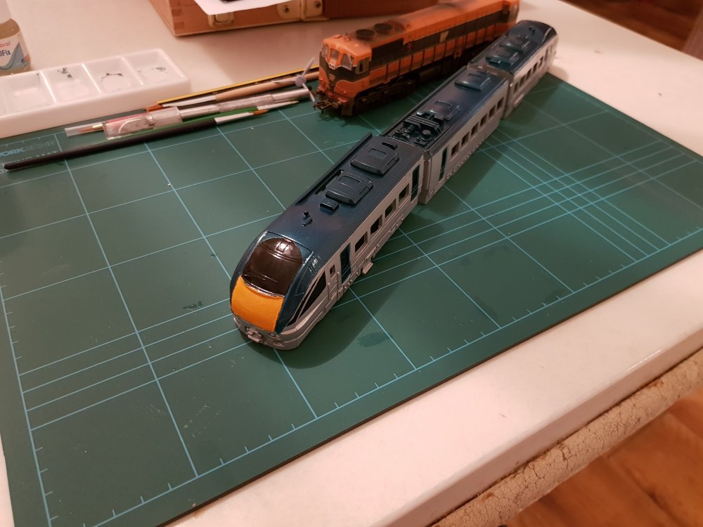

krose Posted December 12, 2017 Author Posted December 12, 2017 The ICR project ran into a few difficulties. I sprayed it all grey primer first, then silver then when I did the green it ran under the masking tape at a door handle and lifted both the grey & silver coats. it was christmas eve so i had no time to fix it so it was shelved. In the past month I've taken it out again and touched it up with a brush. I used a brush to do the black, yellow an gloss coat. next up is the transfers. 3 Quote
