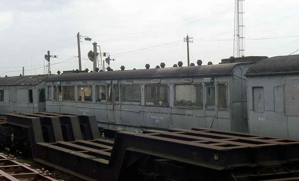

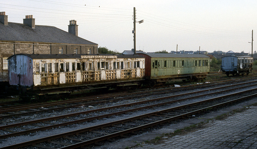

Rolling stock from GNR(I) had the suffix N with the strange proviso that coaching stock had also a prefix "C"
I've seen early CIE wooden panelled departmental coaches with the JL suffix also -
eire - old cie departmental coach north wall dublin 83 JL
eire - unrestored rolling stock mullingar 91 JL

Wasn't so sure about the "JL" - departmental stock was always numbered with an "A" suffix.
The vehicles quoted by that photographer who Glenderg quoted were vehicles i saw myself, and they didn't have "JL" an two-digit numbers when I saw them - maybe the original photographer had it wrong?
Incidentally, those carriages shown are an exceptionally interesting quarter and it's a real shame they didn't survive.
The grey one pictured at North Wall was the very last surviving MGWR bogie coach - originally Dining Car No. 1 (later 1M), and which was converted to an ordinary coach some years later. It had consequently been in the famous MGWR "Tourist Train". It was built in 1901 or 1902, and survived until the 80s at N Wall, where it was broken up.
The three pictured at Mullingar are from left to right, WLWR No. 935 (the last surviving W LWR bogie; the exceptionally interesting Director's Saloon of theirs, of 1897). Then 1110, a 1915 GSWR bogie corridor third, and in the distance, 13M, a late 1880s MGWR six wheeler, the chassis of which is now at Downpatrick underneath their GNR six wheel body.
I thought it's very obvious what the initials ''JL'' stand for, it's not unusual for photographers to initial their own photos, the initials JL!!!! stand for JOHN LAW, nothing to do with coach suffixes, photographers initial their own photos all the time, the splendid photographer John Law is no different.

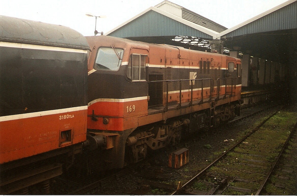

Some coaches had TLA, meaning train line with through air brakes fitted. It was on around 8 BR (including 3189 at Downpatrick) vans for stock transfers and TPOs (including 2978 at Downpatrick) for easy transfer on freight trains.
BR Vans & TPOs on Galway Night Liner/Mail were piped to run with 62'9" air braked container wagons.

  josefstadt said:
The 2-digit number in the photos linked to by Richie (post #4) is the year the photo was taken. JL is the photographer's initials.
The coach in Richie's photo appears to have the number 518A, and is sitting next to 519A. They appear to be departmental stock hence the 'A' suffix as described in the posts above.
Like 3180 TLA here;
169 Limerick 31st October 1996
