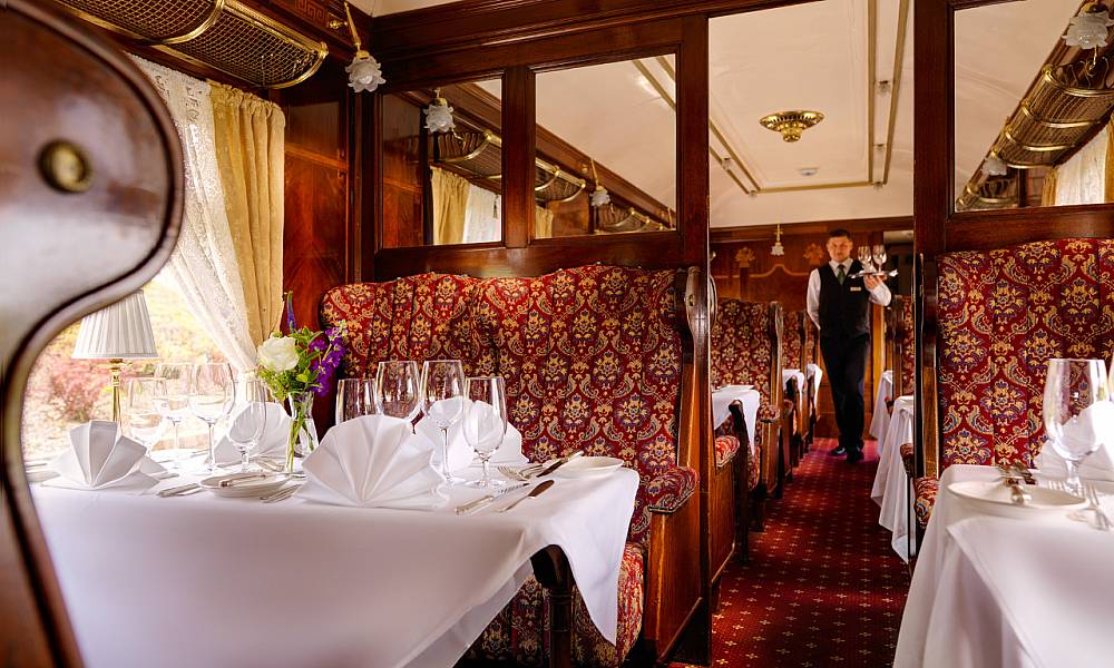

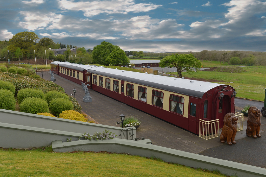

Three nice grounded coaches in use at 5-star at Glenlo Abbey hotel in Galway
PullmanRestaurant-1280px.jpg?w=1000&h=600
http://www.glenloabbeyhotel.ie/en/pullman-restaurant-galway/
Recently enjoyed by another forumite! :)
An interesting one, that Leona thing. LNER Pullman built 1927, a regular on the Devon Belle and Golden Arrow, used in 1965 on Churchill's funeral train, carried 'reverse rail blue' livery before withdrawl in 1969. I have more info on the three coaches there if you're interested (one is half a GUV).
