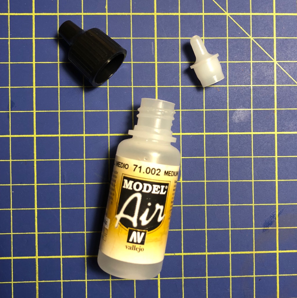

Noel Posted December 18, 2017 Author Share Posted December 18, 2017 Vallejo paint bottles can be recycled as mixing bottles. I didn't realise the top section lifted off which facilities pouring paint into the bottle. Quote Link to comment Share on other sites More sharing options...

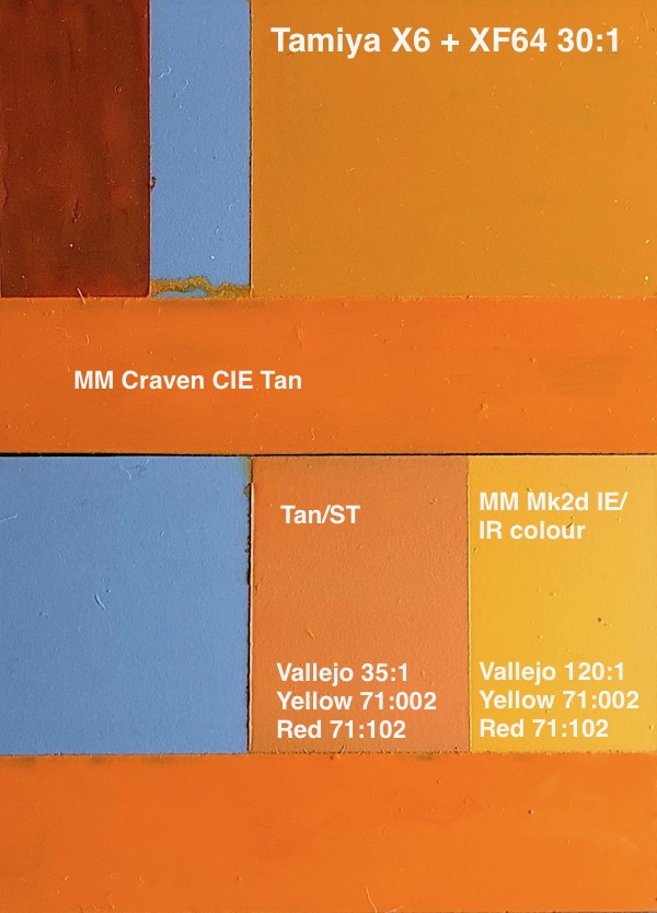

Noel Posted March 22, 2018 Author Share Posted March 22, 2018 (edited) One of my colour test cards with various shades of tan and orange. I tend to spray or hand paint test samples on top of the same grey primer I use on a models as it can have a significant bearing on the final colour. You have to be careful with colours because even these test cards can look quite different under different light conditions and with different cameras. White balance on cameras can really mess around with colours. Edited March 22, 2018 by Noel lexdysia again Quote Link to comment Share on other sites More sharing options...

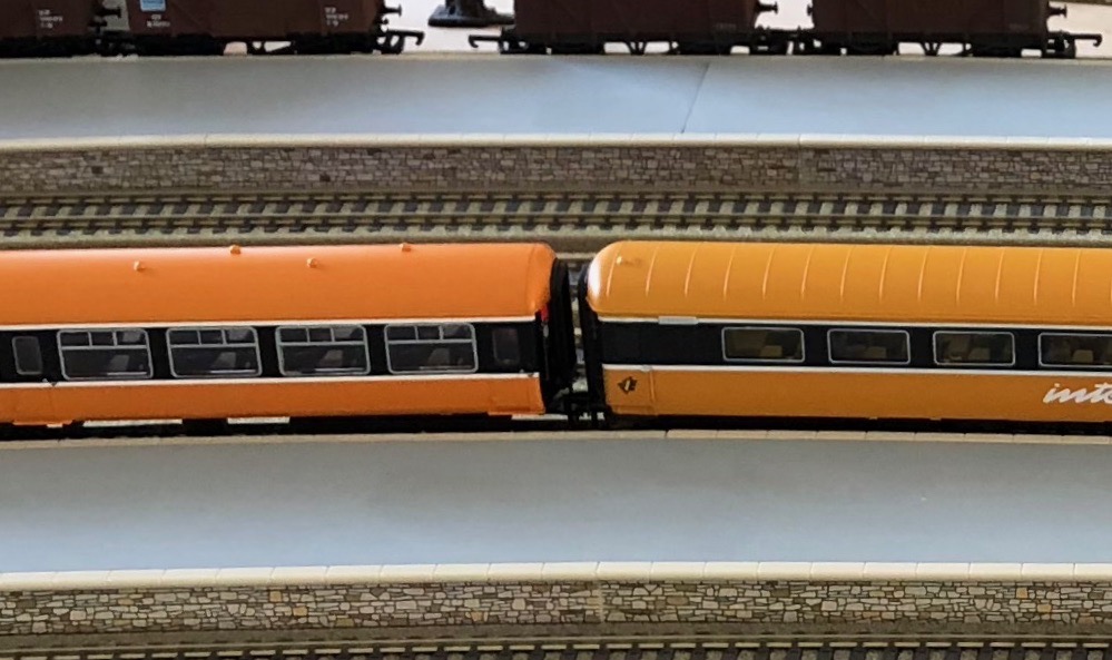

Noel Posted March 26, 2018 Author Share Posted March 26, 2018 (edited) Shades of orange - MM Mk2 coaches over the years. Interesting comparing the colours. LHS = Bachmann/Murphy Models Mk2a (more red in the mix) RHS = Murphy Models Mk2d IE (more yellow in the mix) Edited March 26, 2018 by Noel typo correct red/yellow lexdysia Quote Link to comment Share on other sites More sharing options...
popeye Posted March 26, 2018 Share Posted March 26, 2018 So the question is, were these coaches different shades in real life too? Quote Link to comment Share on other sites More sharing options...
Noel Posted March 26, 2018 Author Share Posted March 26, 2018 54 minutes ago, popeye said: So the question is, were these coaches different shades in real life too? I presume they were different colours based on reading past posts from folks like @jhb171achill , @Glenderg and others. There was some discussion on colours here: http://irishrailwaymodeller.com/topic/3996-mk-2-supertrain-coaches/?do=findComment&comment=62728 Richie has done a lot of resprays of mk3 and mk2 so he is probably best placed to answer. The thing is its impossible to tell from photos, varying light, white balance, etc. Even photos I've taken of the same coach a day apart in slightly different light conditions make the shade of orange look quite different. Forgive the humour, but the mk2d coaches seem day-glo bright orange enough for a ground marshal to use. 1 Quote Link to comment Share on other sites More sharing options...
Glenderg Posted March 26, 2018 Share Posted March 26, 2018 Ral 2011 is the actual MK3 "tippex" orange. It, however, does not scale at all well on the Mk3 models, has a real "bloom" to it. The shade as picked by Murphy Models for the 141/181 is the standard that I work to. Next time I'm out in HQ, I'll get the RAL cards up against a 181. There's pages upon pages of stuff on the effects of UV light on early paint as on MK2 and 3, deterioration of top coats, the effect of daylight, colour scaling, the list is almost endless. There's a fair time period between those two produced models, both from two different manufacturers, and the trouble is the colour conversion system used in China (PCS?). RAL colours are interpreted into a native version, translated to models via airbrush, or sometimes coloured plastic pellets and the results can vary. A few weeks ago, Rapido Models, had to bin several thousand loco shells, because the other factory producing batch B, had interpreted a green slightly differently, and if you had a double headed train, there would have been a serious discrepancy. There is no "right" colour. It is a minefield that I cross, with what feels like a combine harvester at full pelt, at least once a month, and it's terrifying. Paddy's 181 - colour match that, you'll be fine. R. 1 2 Quote Link to comment Share on other sites More sharing options...
