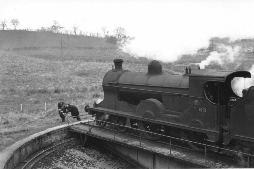

GNRi1959 Posted December 18, 2017 Author Posted December 18, 2017 (edited) StevieB, I have noted the size of turntables on the GNR, I guess the Peco turntable is much too big? JhB, I still remember Omagh well(pictured below), we used to play in it after school, long after the line closed! Edited December 18, 2017 by TonyMcGartland 1
