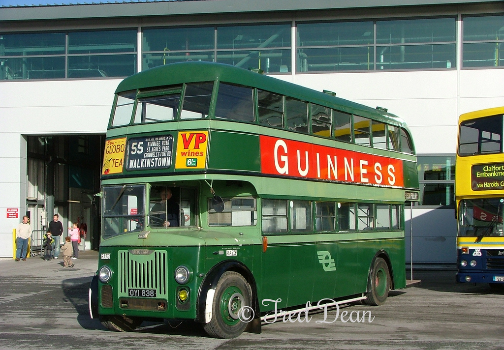

CIE RA73 (OYI838).
Green.....  accurate, though in this light, and with new paint, as under the floodlights at Ballyglunin for the "Quiet Man" scenes, the dark green shows as bright as it ever was. After being in traffic, it toned down and could look a bit darker and a lot "flatter".
The above weathered would do the trick on a model.  EDN shows accurately here - on my screen anyway!
