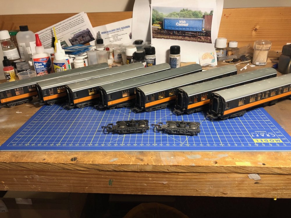

Noel Posted February 16, 2019 Posted February 16, 2019 The Lima BR mk1 Bsk I converted had similar bogies and I replaced them with the replica B5 bogies above for the GSV. Will try and post a pic of them later if I can find them. 1 Quote

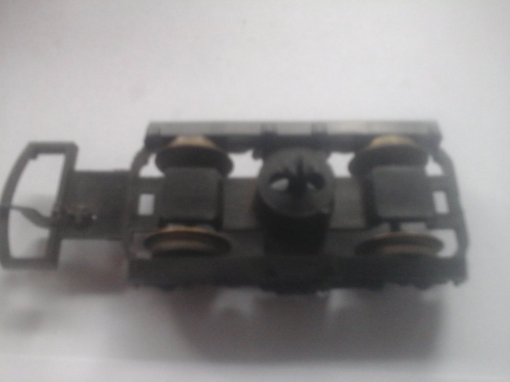

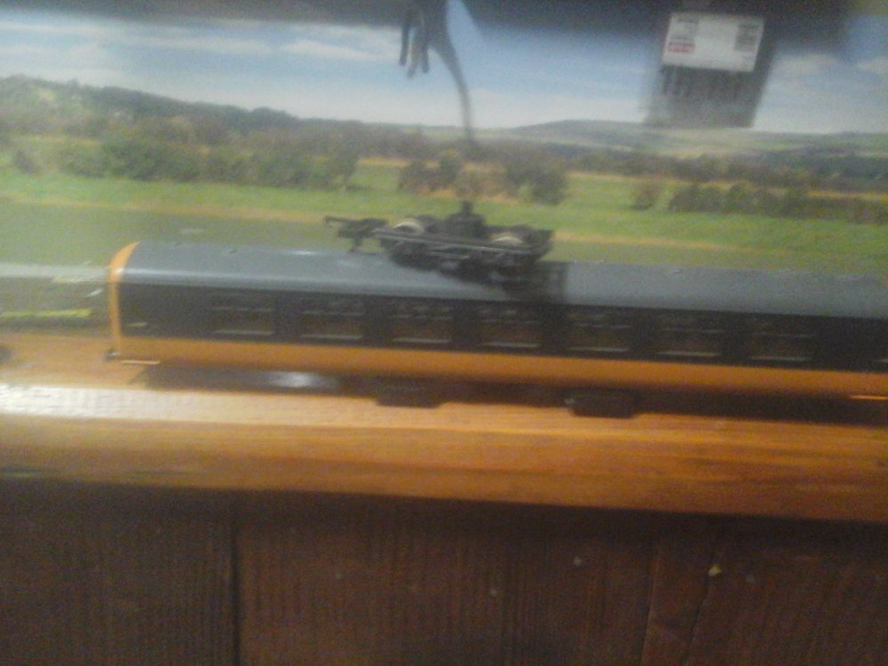

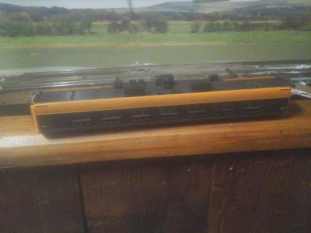

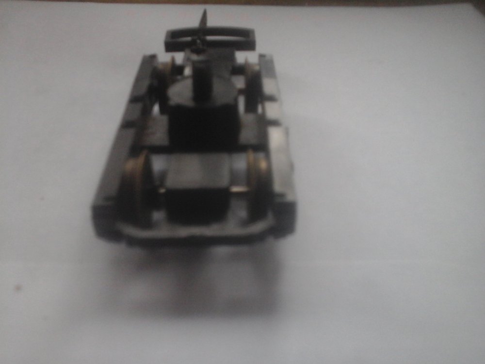

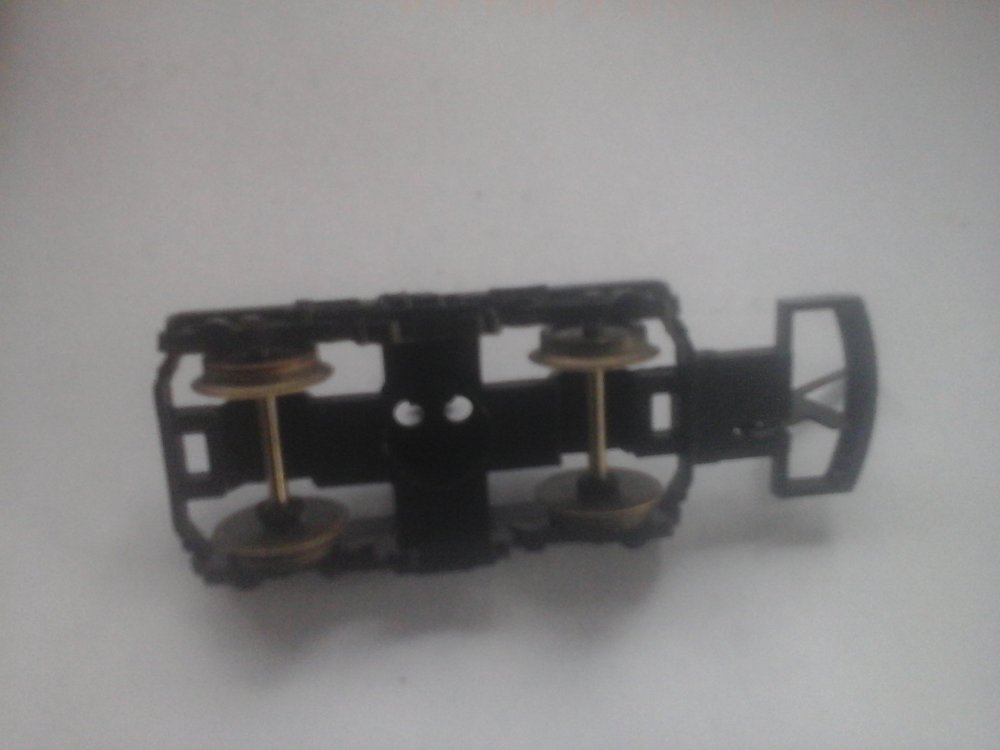

murrayec Posted February 16, 2019 Posted February 16, 2019 Hi Wayside It looks like the fix could work on the Lima, but if you could do closer up photos of top & underside of the bogie, and closer up looking down on the chassis socket/bolster I'd be able to see better? - fill the photo frame with the bogie, that close..... Eoin Quote
Noel Posted February 16, 2019 Posted February 16, 2019 (edited) I have a load of those mid 1970s Lima BR Mk1 CIE coaches. Bought them one at a time in W J Owens, 41 main street Bray, as I saved up for them. Owens was one of the best model shops in the state, now sadly gone as Willie retired some years ago. This rake of B&T coaches was my pride and joy until I saw an MM Craven coach. These are now retired as the layout has a complement of Cravens, Park Royals and Laminate stock as well as some modern era mk2d invasive species Not to mention the unmentionables (ie the recent arrival of IR Intercity mk4 coaches). The same coaches photographed about 1975 on my original layout. There are actual wires between those Telegraph poles. Here is a pic of the plastic bogie I removed from the BR Mk1 BSK donor used for a GSV conversion. It was easy to replace with the Replica B4/B5 kits with just a slightly larger hole and some styrene spacers needed. Hope this helps. Edited February 16, 2019 by Noel 1 Quote
WaYSidE Posted February 16, 2019 Author Posted February 16, 2019 Noel, thanks for the photos, so some like to make models, others to operate, some to recreate prototypes, the first lima shot makes me think i should collect 1950 lima coaches, they run so well , i luv em, i use my 3 for testing tracks, but i starting to rthink i shouldn't as they are so 1950s, if your ever selling please consider me.. you Irish modellers are amazing, the effort you put into helping others on this site, i have read hundreds of usa, uk web pages, not once did anyone mention, as a saw on a post on IRM, that the wee turnout clips abridge rails on points can corrode or get dirty..,, yous go to the trouble of hosting pictures, crawling the attics for archives, supporting other modellers. thanks for all this info.. uploading photos is a slow process around here, rural broadband, = on all the time windup copper line, 1 hour ago, murrayec said: Hi Wayside It looks like the fix could work on the Lima, but if you could do closer up photos of top & underside of the bogie, and closer up looking down on the chassis socket/bolster I'd be able to see better? - fill the photo frame with the bogie, that close..... Eoin will do, uploading photos is wowfully slow, but when i next in office, it be faster Quote

WaYSidE Posted February 17, 2019 Author Posted February 17, 2019 i think the lens is damaged, if i get a chance ill photo with another camera Quote
murrayec Posted February 17, 2019 Posted February 17, 2019 Hi Wayside Yes there is something wrong with the lens all right? Though I can see it a bit better- the nut, bolt n washer idea should work like the Craven coach fix, sticking the washer on the underside of the bogie will be a bit fiddly to get it on centre, but it should work- saves buying new bogies... 'I like fixing stuff rather than buying replacements' Eoin Quote
WaYSidE Posted February 20, 2019 Author Posted February 20, 2019 WRENNEIRE kindly solved the Lima problem, he supplied me with bogie, many thanks 1 Quote
