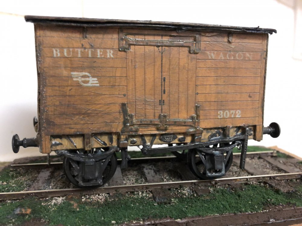

Another Alphagraphix kit under way here: real old school modelling this one! Card and - if you want a running vehicle - white metal. What you basically do is cut out the card bits, laminate to thicker card, and glue it all up together. Add a few bits of whitemetal and you have a running wagon in theory. This is my first one - may try another few. It’s a CIE butter wagon with double roof, running on Walsall Model Engineering wheels pushed out to 36.75mm. It’s a bit rough around the edges (literally!) and I have now learnt a fair bit about how many knife blades such a kit will burn through (about 5). But it’s a cost effective way to acquire stock and fairiy quick. Just some final painting and finishing to do. I’m hoping some gentle weathering will smooth off the rough edges!

Thanks JB! Comes as a flat Card sheet. You cut out each piece and stick to 1mm mount board. Then fit those laminates together. This one also features cereal packets, coffee capsule boxes, and wooden stirrers in the mix!

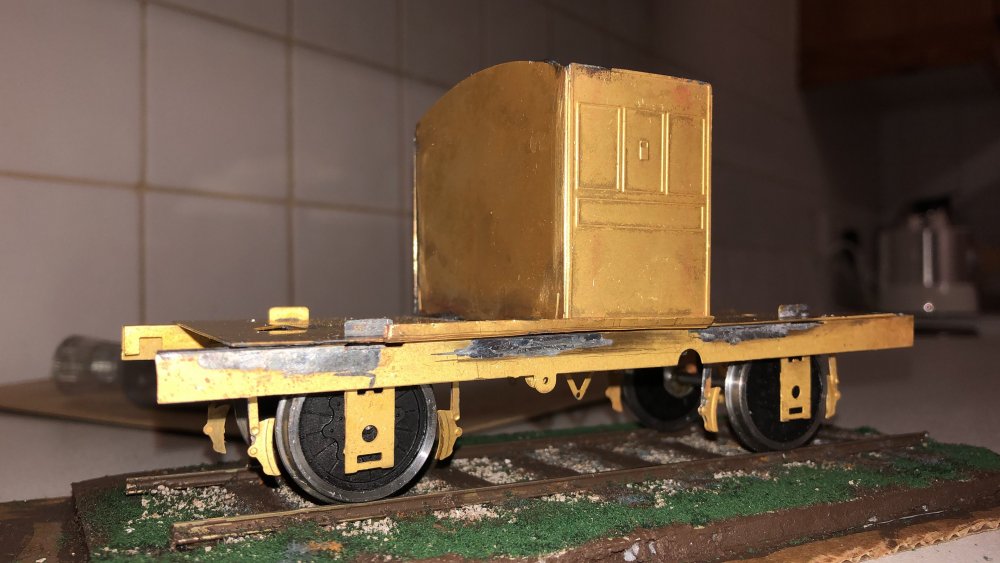

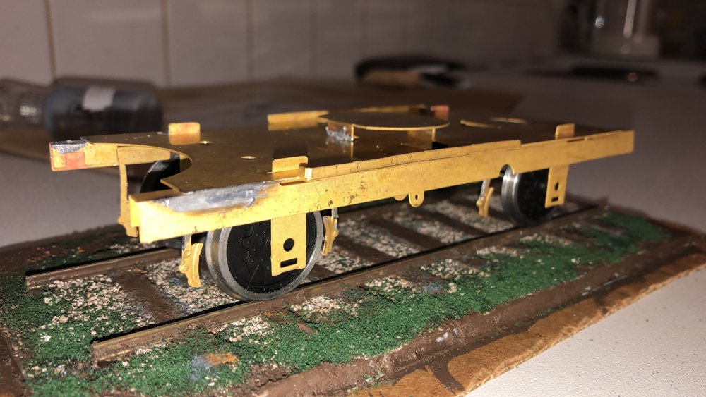

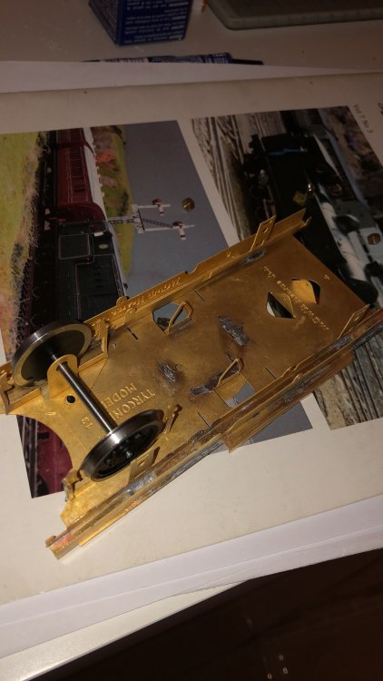

MGWR parcels van under way ....partly putting this up to show what can happen. Bending the u channels for sole bars did not go well and one snapped. Soldered it together (liberally using 145 degree stuff into some tight angles hence the very obvious solder bleed in places). Was all pleased until I realised that I’d solidly soldered it all to the wrong side of the chassis. Choice was to live with it (only real consequence being that the doors will run left-right rather than right-left) or risk twisting the chassis by wrenching the solebars off. I went for option a! Building to 5’3 brings its own problems. The brake gear has had to be moved outward , and the bright idea I had of inverting the axle bearings backfired as the axle then sat unevenly. But brass is very forgiving ...

Following this one with more than usual interest, as I have one to build too! That said, the chances of me making similar mistakes and more will still be high...
 I've used 1/8" I/d brass tube for bearings in the past, which has worked well. An issue with Tyrconnel coach kits is they are designed for 32mm gauge, so brake gear is a bit of a faff

Thanks David - that’s helpful. I keep finding even more errors! I tried the old Tyrconnell loco bearing trick but the axle step on carriage axles rules that out. It’ll be green I hope with Flying Snail when Railtec get them in. Found a shade of Ford green which I’m keen to try on this before the passenger stock proper gets under way...

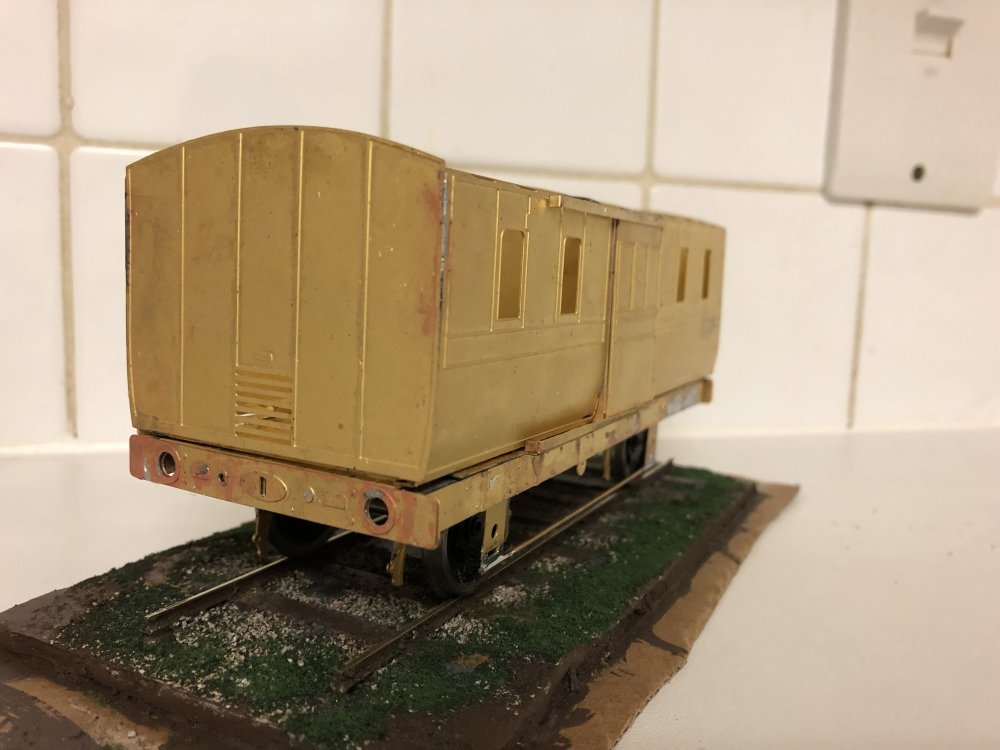

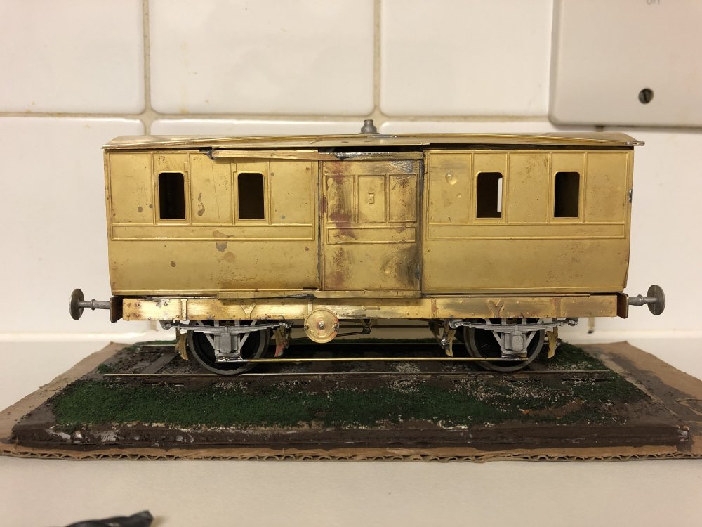

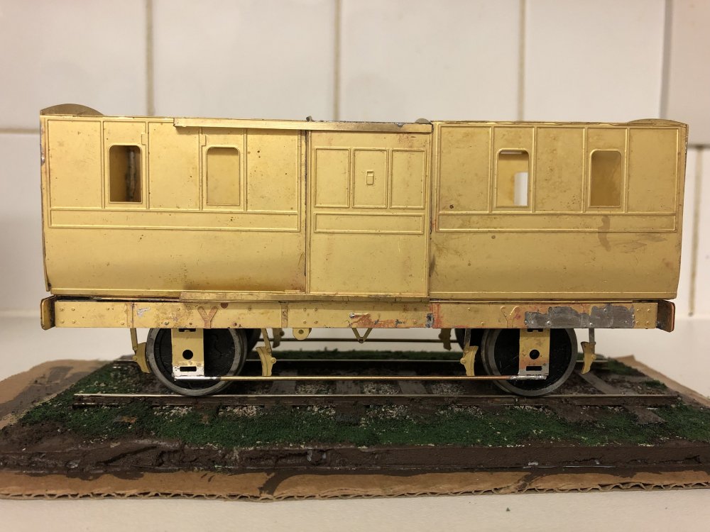

After many delays I have finally got this ready for the primer stage. The early mistake in construction has worked its way through the build - the lovely etched roof provided has had to be inverted to fit the door runners and therefore I’ve had to fit my own rain strips. Hey ho - not the end of the world.  On the night construction started I was actually fearful I’d completely trashed it so again it proves how forgiving brass can be....

Thanks JHB - it’s my first Irish coach so I’m fairly content. Learned loads. She’ll be finished in 1950s green as per Des Coakham’s pic below.

Well, a van like that is absolutely appropriate for such a scenario; indeed, it's likely its the same one that was on the opening train in 1899!
The livery will be well shabby by then - the light green lines in that livery were lined in thin black and gold lines, and the "snail" in gold only. The logo I use beside my name on this site is a photo of an actual flying snail transfer, so use that; the green it is mounted on is authentic Inchicore paint, as now seen on "Maedb" and various preserved buses. Ends black and roof dark grey; both weathered, though, to a nondescript dark greyish dirty colour....
Entirely appropriate for the 1st and possibly last trains on the Achill Branch or the afternoon "Perishable" from Rosses Point to Sligo.
The Alphagraphix kit is a model of MGWR Mortuary Vans 42 & 58.
The GSR re-numbered the vans 56M & 58M and ran them as fish vans.
56m (van in photo?) appears to have ended her days most likely as a luggage(pram?) van on the Waterford & Tramore.
(Carriage Stock of the MGWR) IRRS paper Padraig O'Cuimin 1972?

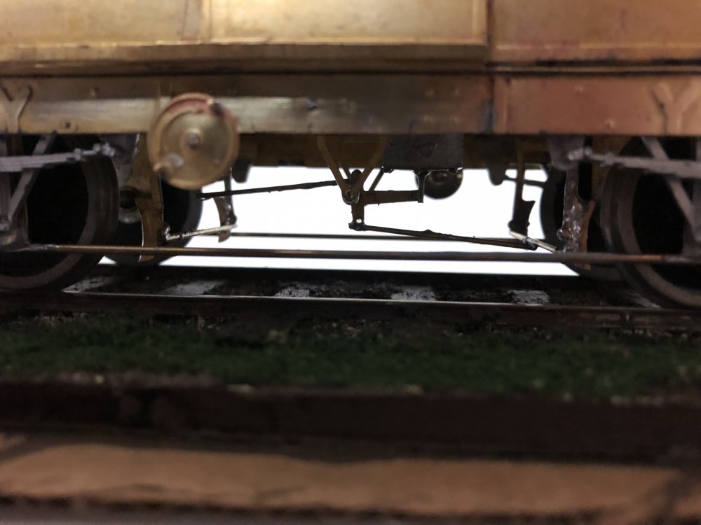

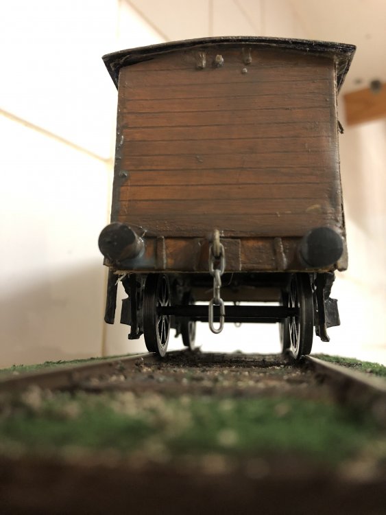

Seriously good stuff, everyone! Especially interesting for me as I have one to build too, though maybe not that soon. The brake gear looks good too. Have always hated doing it, so any pictures/info welcome. The one problem with Alphagraphix etched brass kits is they are designed for 32mm gauge and need a bit of fettling. This one looks very nice indeed.

Thanks David - she’s prepped for priming tonight so I’ll post some brake gear pics when there’s some paint on and all the masking’s off. The brake rodding etc didn’t take too long but bending the brake shoes out to clear the 36.75mm became rather vexing. Envisioning the afternoon perishables ambling off to Sligo helped me persevere. And I’m very keen to see how this Ford aerosol works out in yielding the right shade of green....
