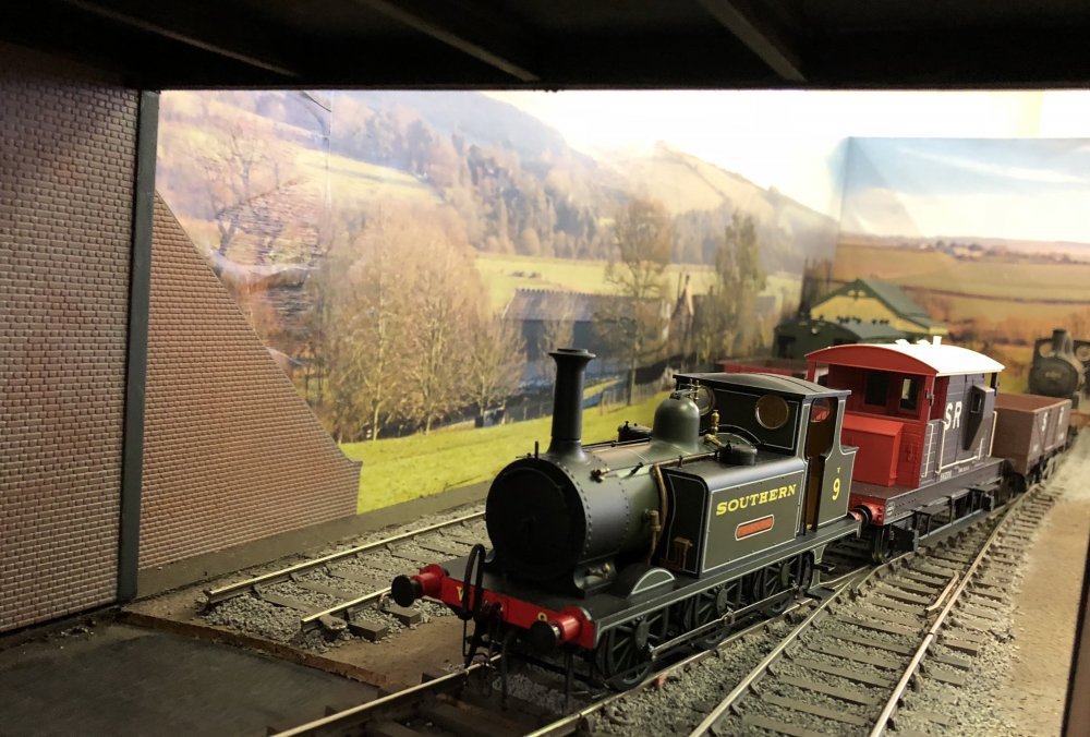

265DA71C-AB41-4E93-8D41-47055B77B6AC.thumb.jpeg.3b104b5c87f4f8a996332b84ff1d5da6.jpegIndeed I do remember JHB senior - proper railway gentleman of the old school. If it’s any consolation I’m sorely tempted by what OO works have been churning out but after experimenting in a variety of scales this is where I’ll stay for now. O gauge needn’t take up too much space though - Some pics of my now sold English light railway - all in 5’ by 1’....

That is the one area of British outline I would consider modelling, a quiet Southern branchline terminus or Colonel Stephens light railway

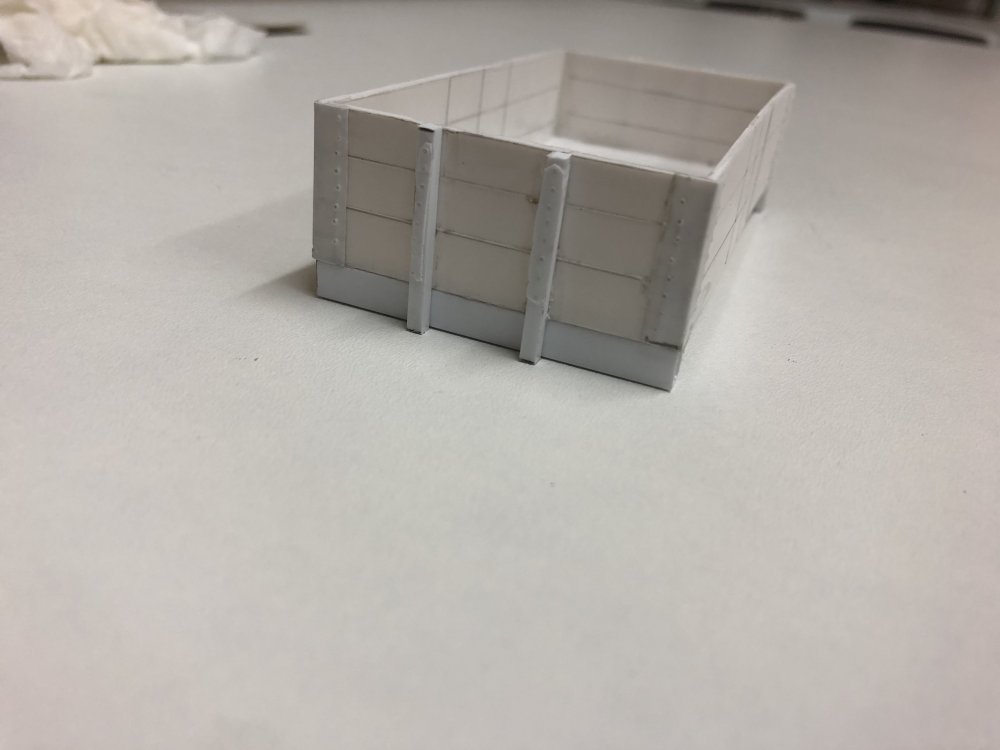

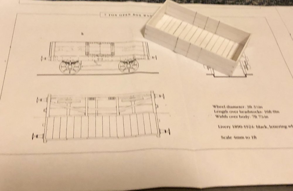

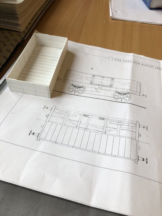

No progress on the hearse as I’m away with work. First green coat will go on when I get back. But what to do on my week away? I packed a basic modelling box to use in the downtime and set about my first ever scratch build. This is the result of the first burst of activity. It’s a 3 plank MGWR open from a plan in Ernie Shepherd’s MGWR book. Loads of mistakes already but as ever learning as I go...wheels,body and underframe are currently at 3 different locations around the UK so it won’t be finished as soon as I’d like. If it goes well I may get more adventurous.

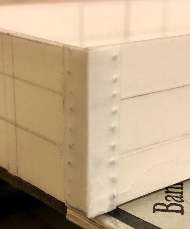

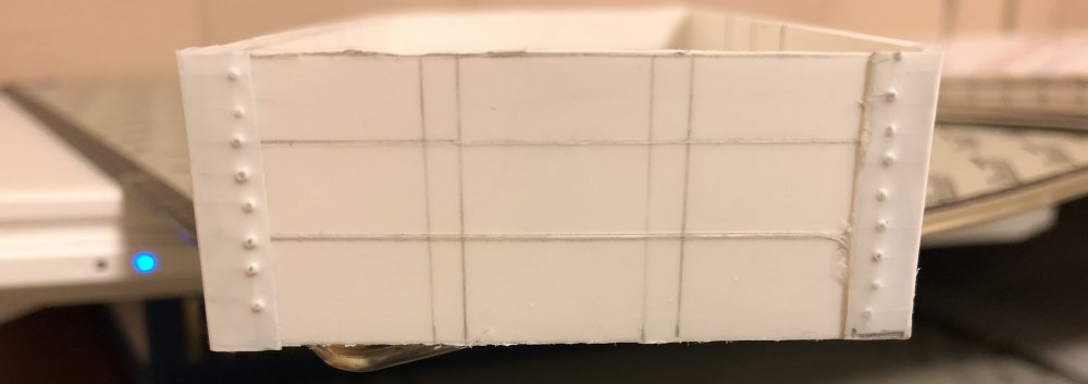

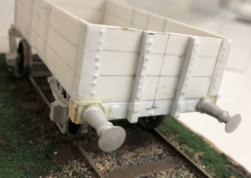

Tonight’s little experiment. Wagon body is made from 60 thou plasticard which makes a strong carcass but doesn’t really offer much scope for detailing beyond grooving planks. So tonight’s effort has been a sheet of 10 thou with rivets pressed in by hand to make the corner strips..it’ll look ok from a distance !

It will, for sure, though there is a lot more work in an open wagon than two sides, two ends and floor. My Clogher Valley opens had around 200 separate pieces if you count each rivet - though best not to!
 A coat of paint and it will look fine, to say nothing of the immense satisfaction of having made it yourself. Nice one!

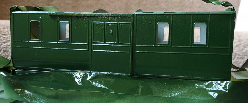

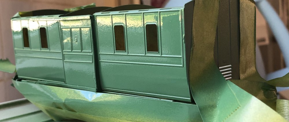

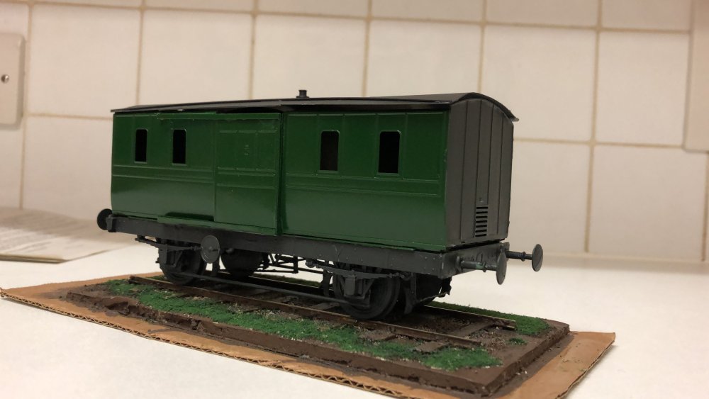

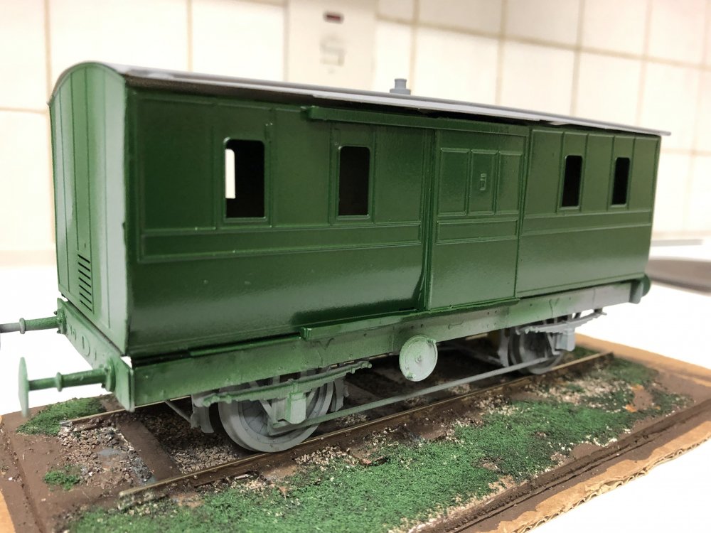

The wearing of the green - part 1
CIE mid 50s green - now there’s an issue! Being a former modeller of 1930s Southern Railway, I had a tempting can of olive green. But no - not quite the thing. My cunning plan that followed was Ford Meadow Green - but that’s not quite right either..I took a long hard look and tried again but I’ll post that one later tonight when it’s dried a bit
Link to comment
It's not 100%, but it's not far off it either. Since a vehicle like this would rarely see a paintbrush, it would spend almost all of its life very weathered looking. Once you've applied the lining and "snails", I suspect it would look just right with mid to heavy weathering on it. The green you've used is fortuitously somewhat "flat" compared with what a newly painted vehicle would look like. That would fit very well with the above idea.
Seeing it in daylight is the key to judging it.
....And you're quite correct in not using British SR green - it was nothing like the CIE shade!

4 minutes ago, jhb171achill said:
That is SPOT on. I spent the first 25 years of my life looking at an actual sample (with a flying snail on it; my "logo" here) on the wall in our house. That's exact, whatever shade it is.
Thanks - that’s endorsement! I’ll post a better pic later. But it’s Rover Brooklands green over Ford Meadow Green over Grey Primer... all from Messrs Halfords

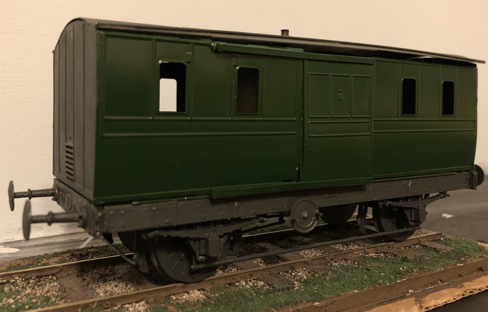

I won’t bore you with pics of this ad nauseam but here’s one last look without masking tape as promised. Travel commitments mean this will not progress any further for a week or two but when the black bits and stripey bits are done I may post a pic or two.

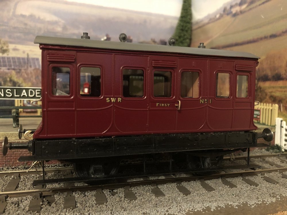

That’s absolutely right. The gloss finish helps the decals fix. Here’s one I made earlier which was so treated. Now sold to fund Irish kits, it’s a 4’8” former royal saloon built for the LSWR which finished up with Col Stephens. I used maroon car paint on it which was really glossy but a few coats of satin varnish calmed it down.
Edited by Galteemore

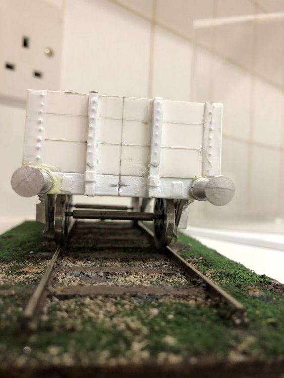

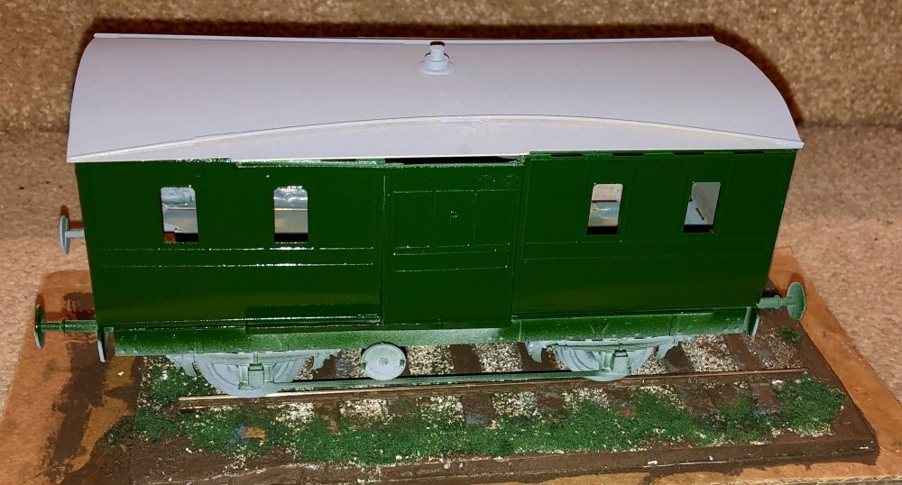

A mixed few days. Attempt at eau de nil lining on the MGWR van did not go well. There’s no way I’m posting pictures of what happened! Basically because the bilious green running everywhere was washed off as quickly as I could manage it before it dried! So I’ve requested Railtec for a 7mm version of their lining transfers to be added to my flying snail order.

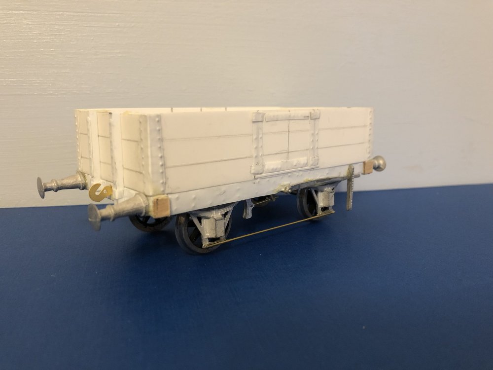

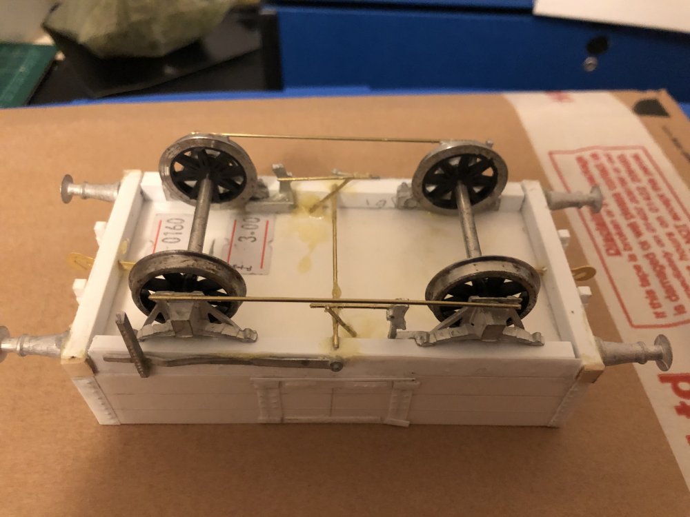

The open wagon inches towards the paintshops. Drilled out the axleboxes tonight and glued in the bearings. Glued on buffers at one end and couldn’t resist a dummy run with the wheel sets...the brown bit you see at the end of the buffer beam is a cut up coffee stirrer to blank off the open ends of the plastruct channel used for the beam. Thank you Starbucks!

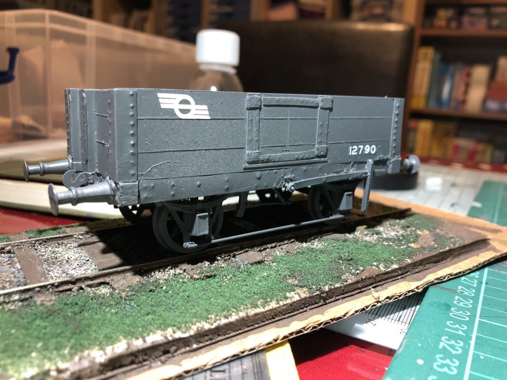

Next stop - Primertown - and after that Greyville.
But first an apology - to the thousands of humble open wagons everywhere. For years I’ve slighted you, distracted by your more alluring siding mates. The tank wagons, the box vans, the parcels vans. I paid little heed to you - just a crate on wheels. How wrong I was. Your solebars, your planking, your door fastening and even your brake gear is full of mystery.
My rather histrionic way of saying that even this beginner’s scratch-build of a ‘simple’ wagon hasn’t been that simple! It’s been a mixed media effort in recent days - white metal castings and brass wire. Looking forward to a nice coat of grey to blend it all in....

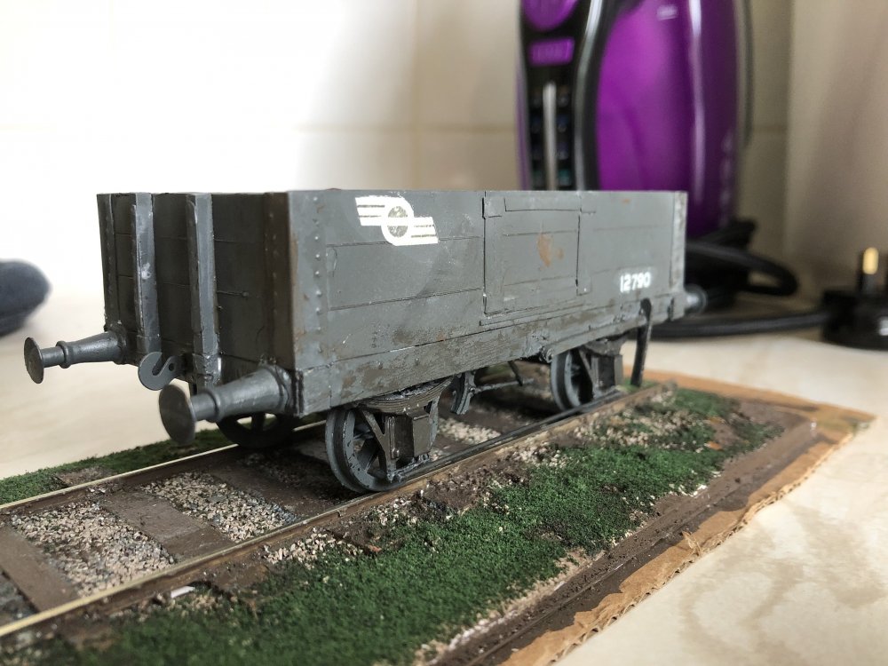

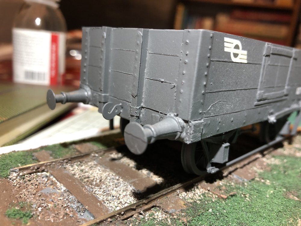

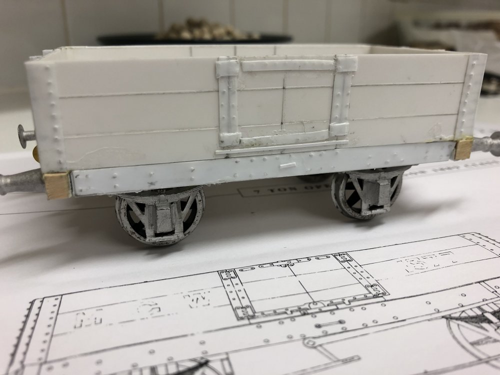

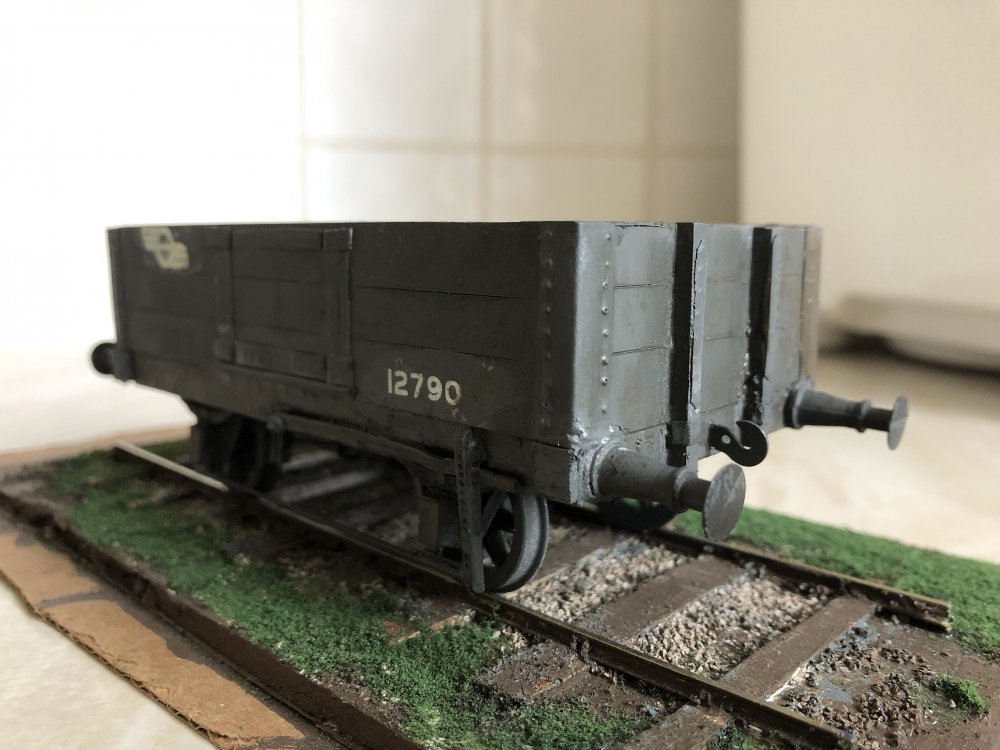

Doesn’t look quite so pristine now. Had all been going so well too. A coat of varnish over the transfers turned milky white 🤯. A few washes with dirty thinners later and hopefully something has been salvaged that I can bear to look at!
Well that’s it for now. First scratchbuild done. More or less. Lessons duly learned. Onwards and hopefully upwards...
