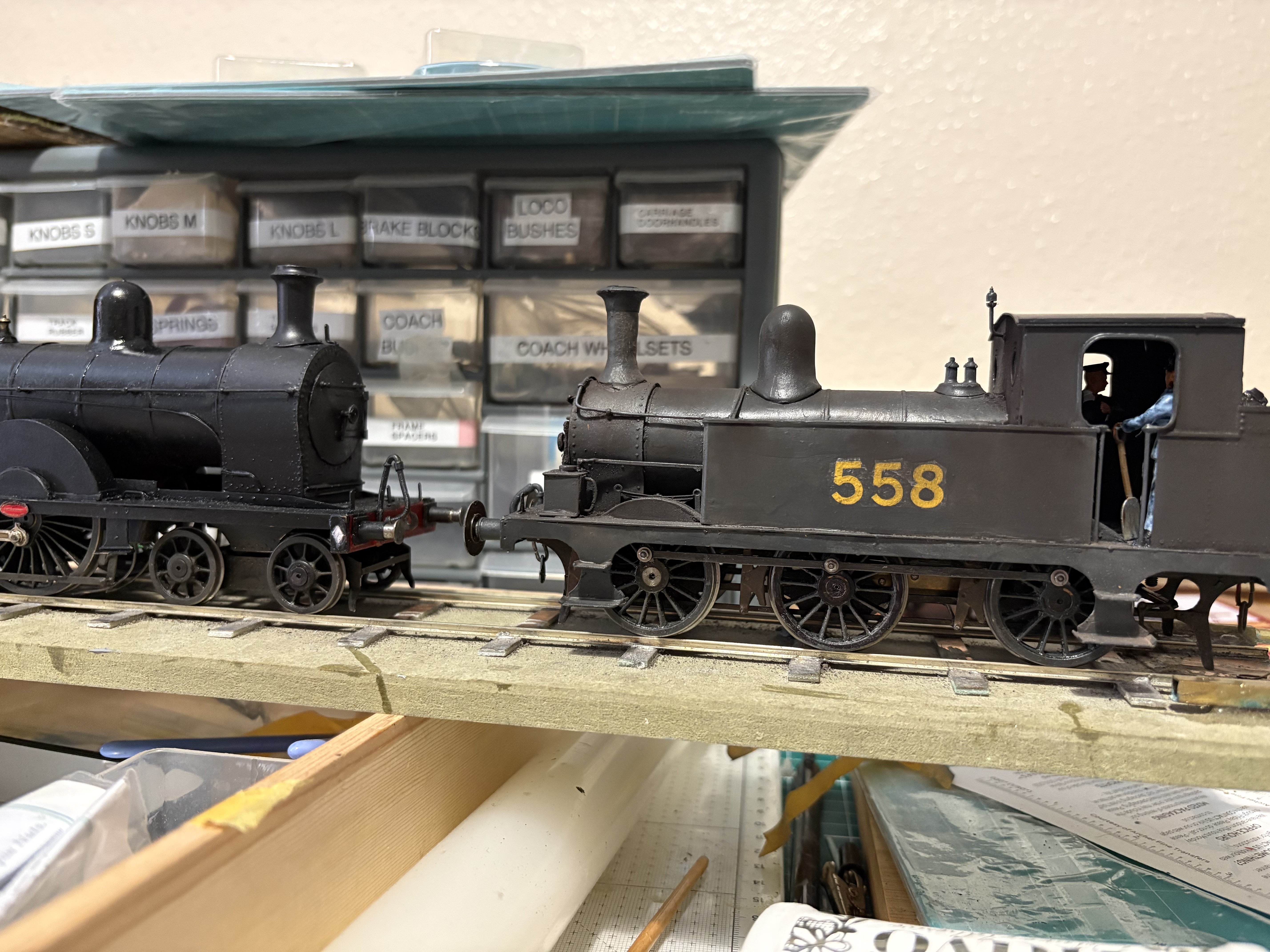

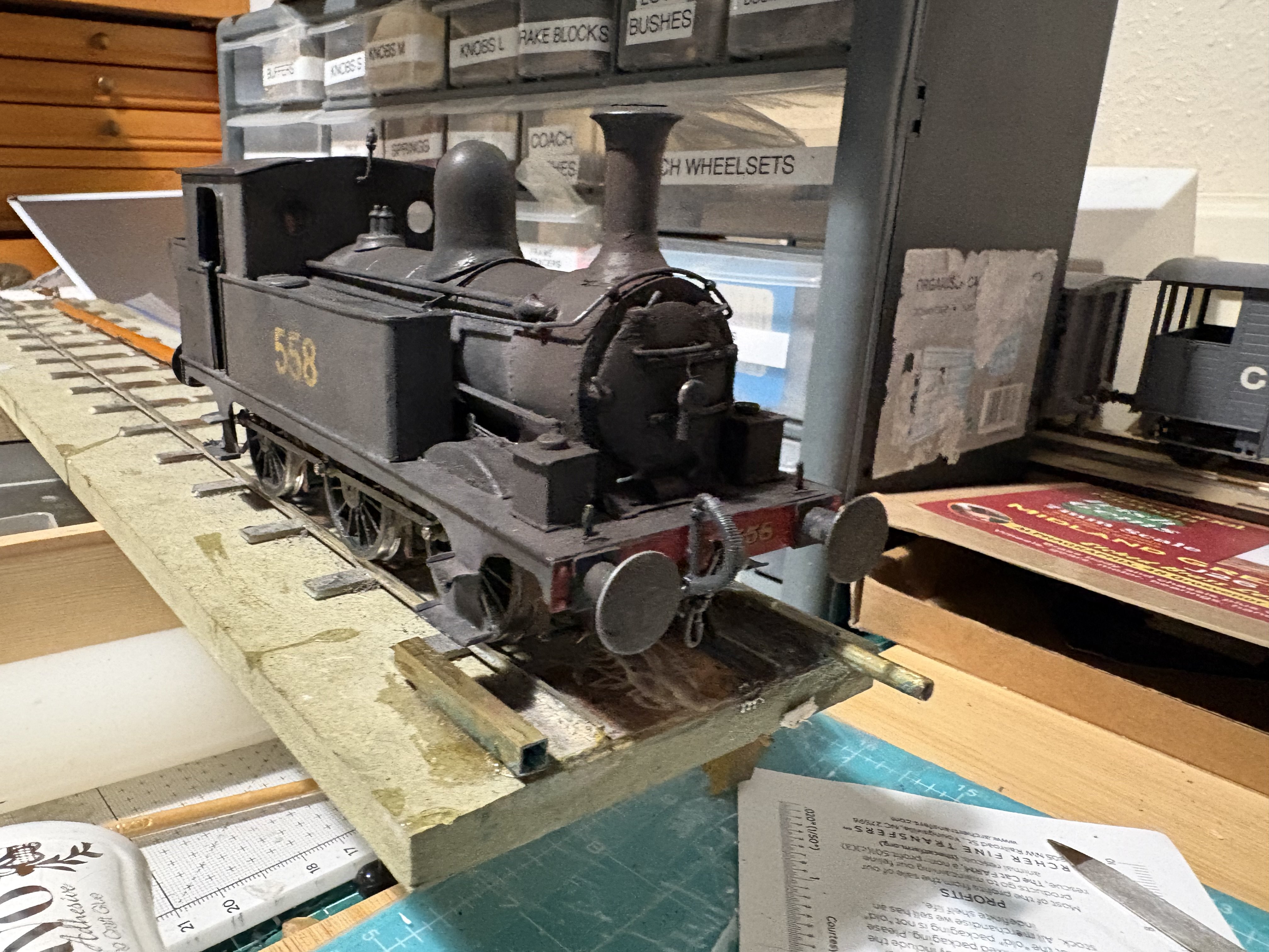

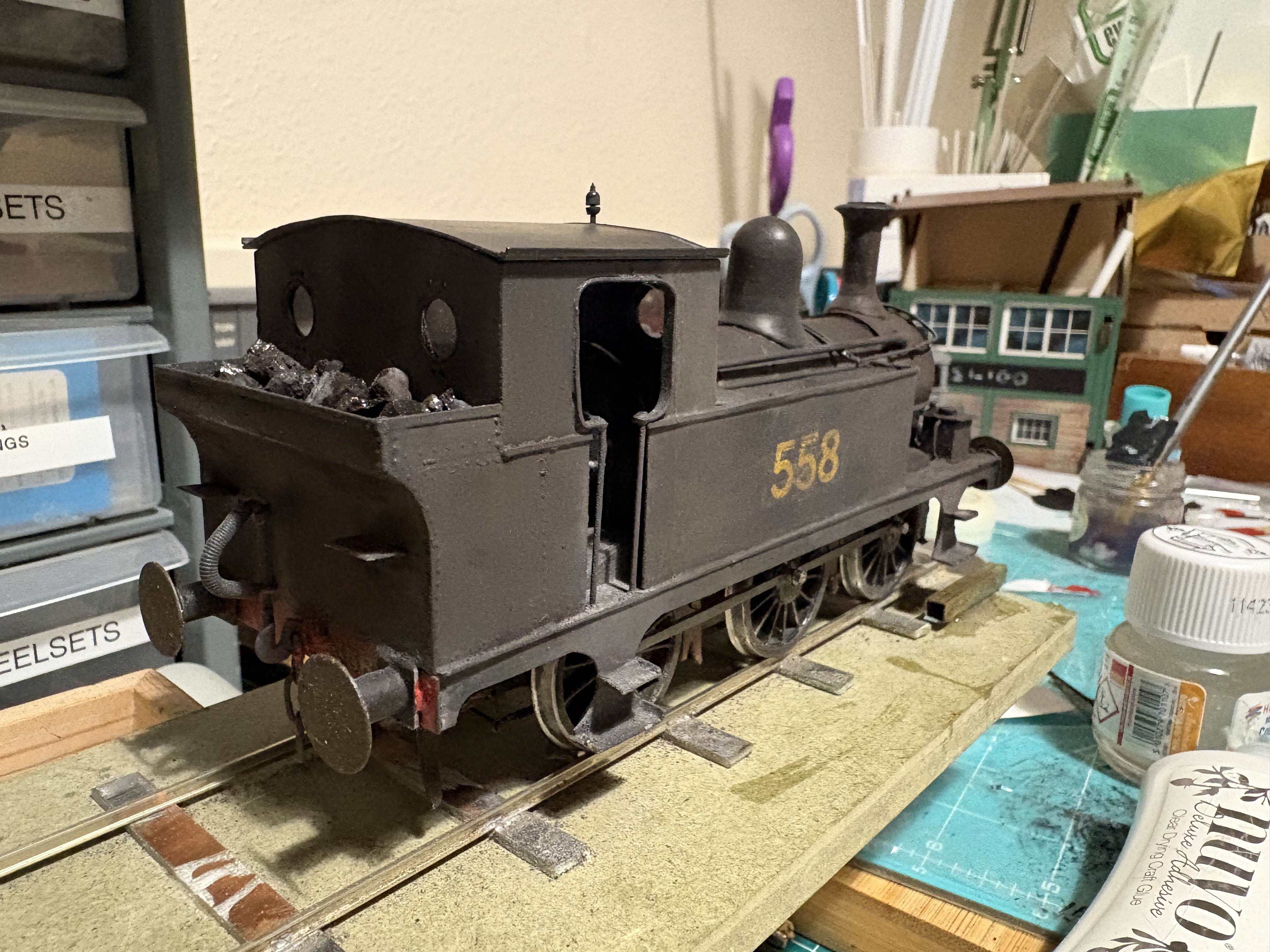

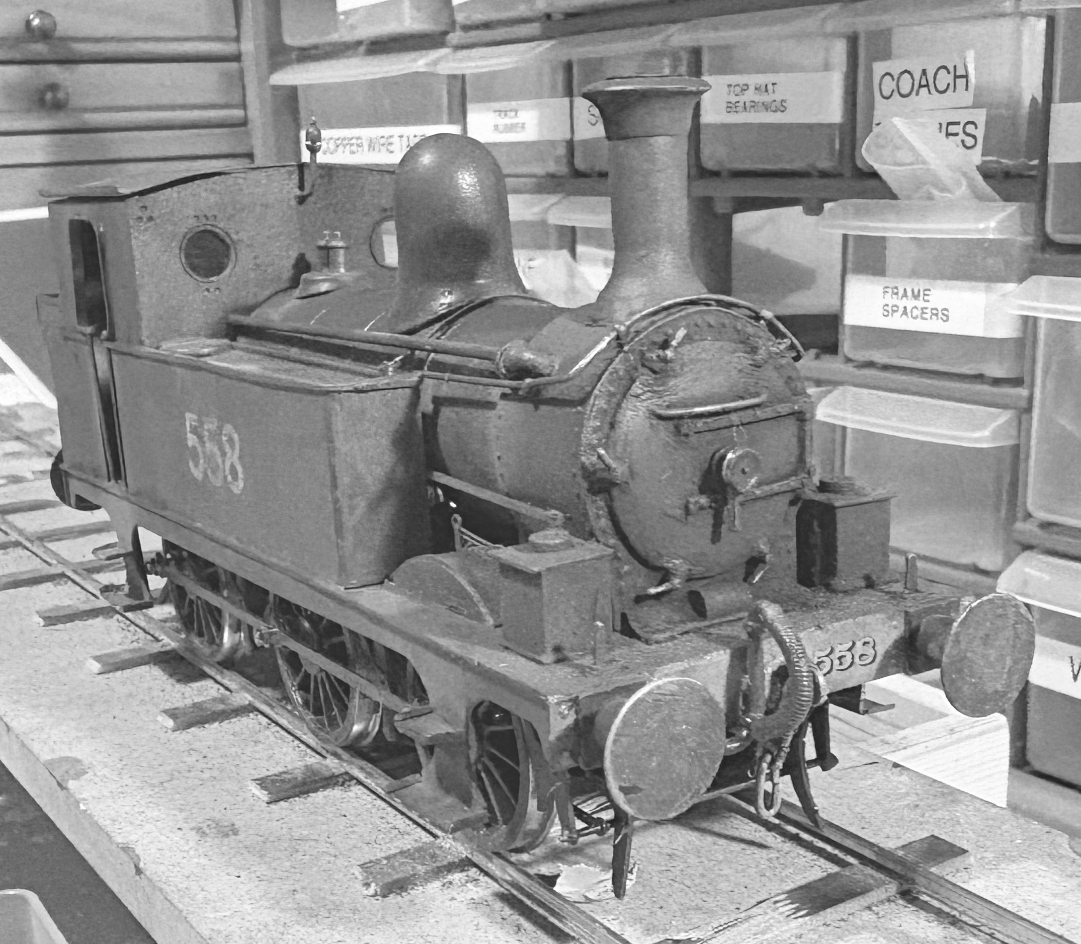

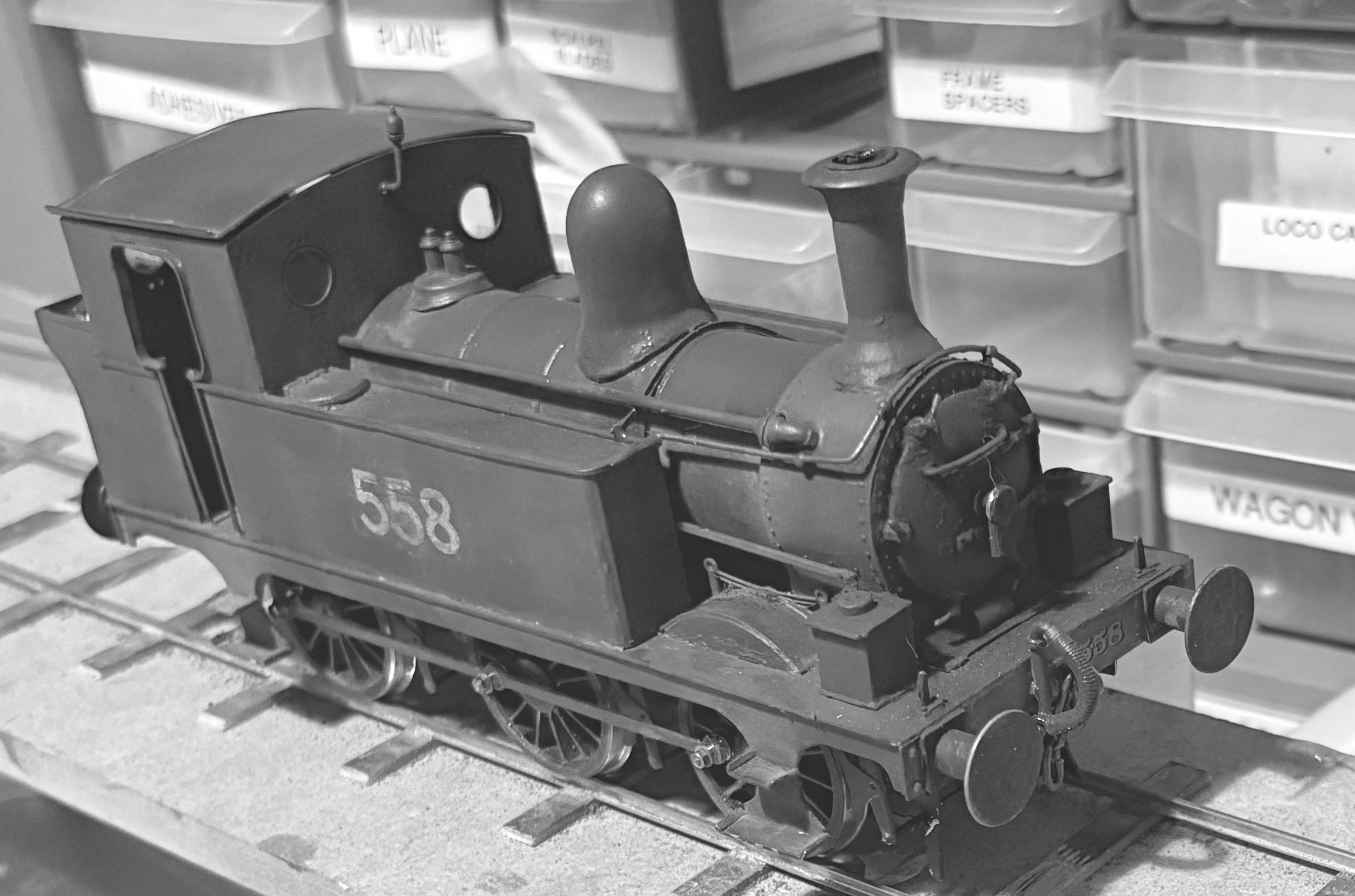

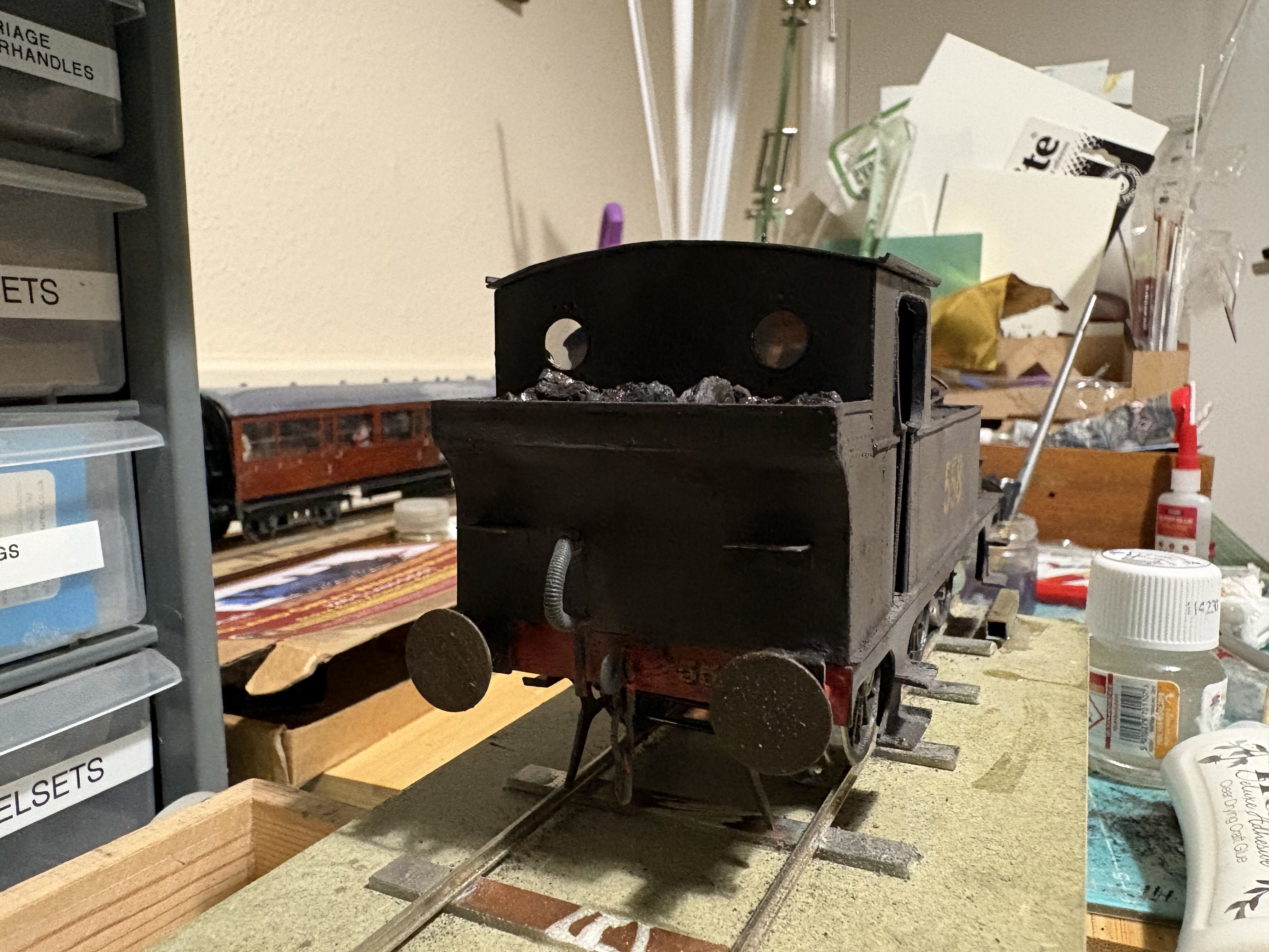

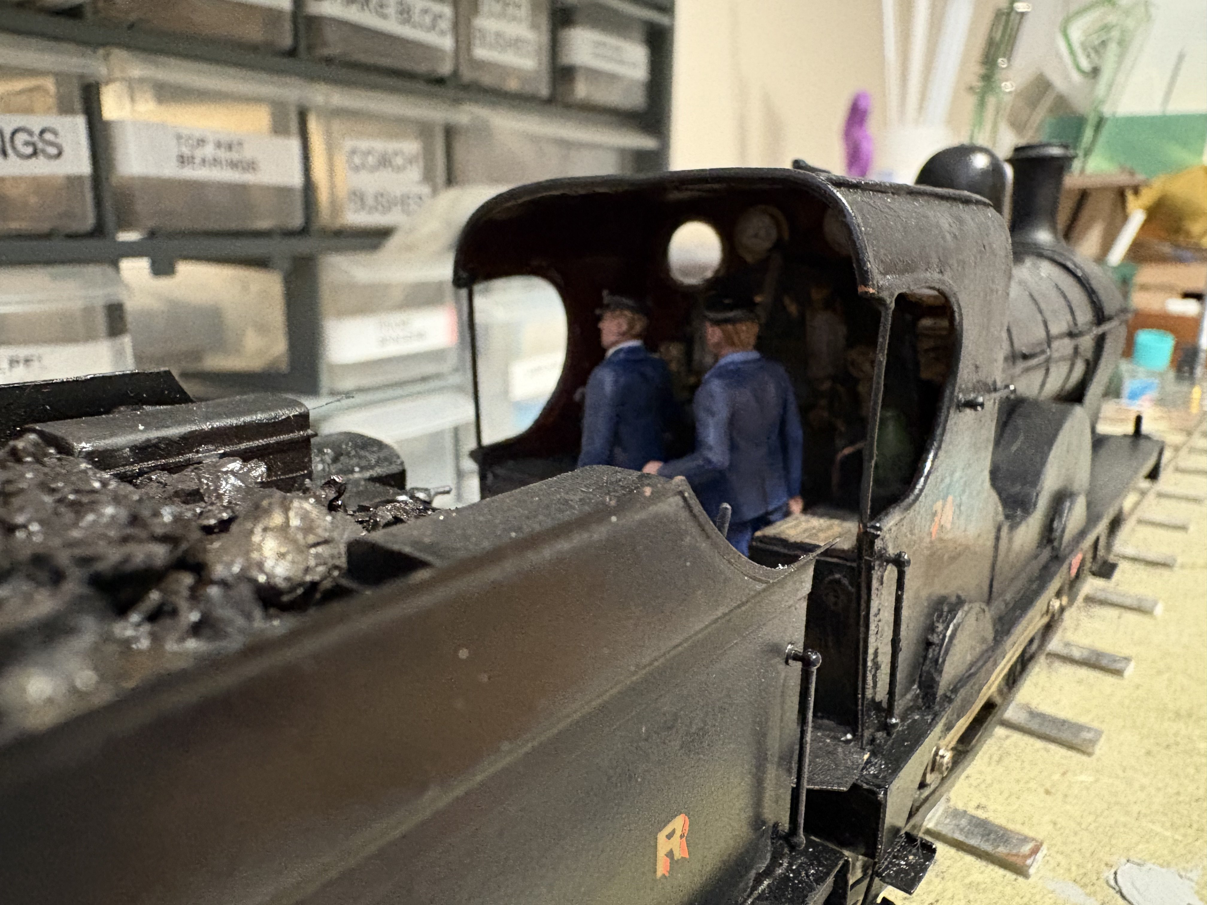

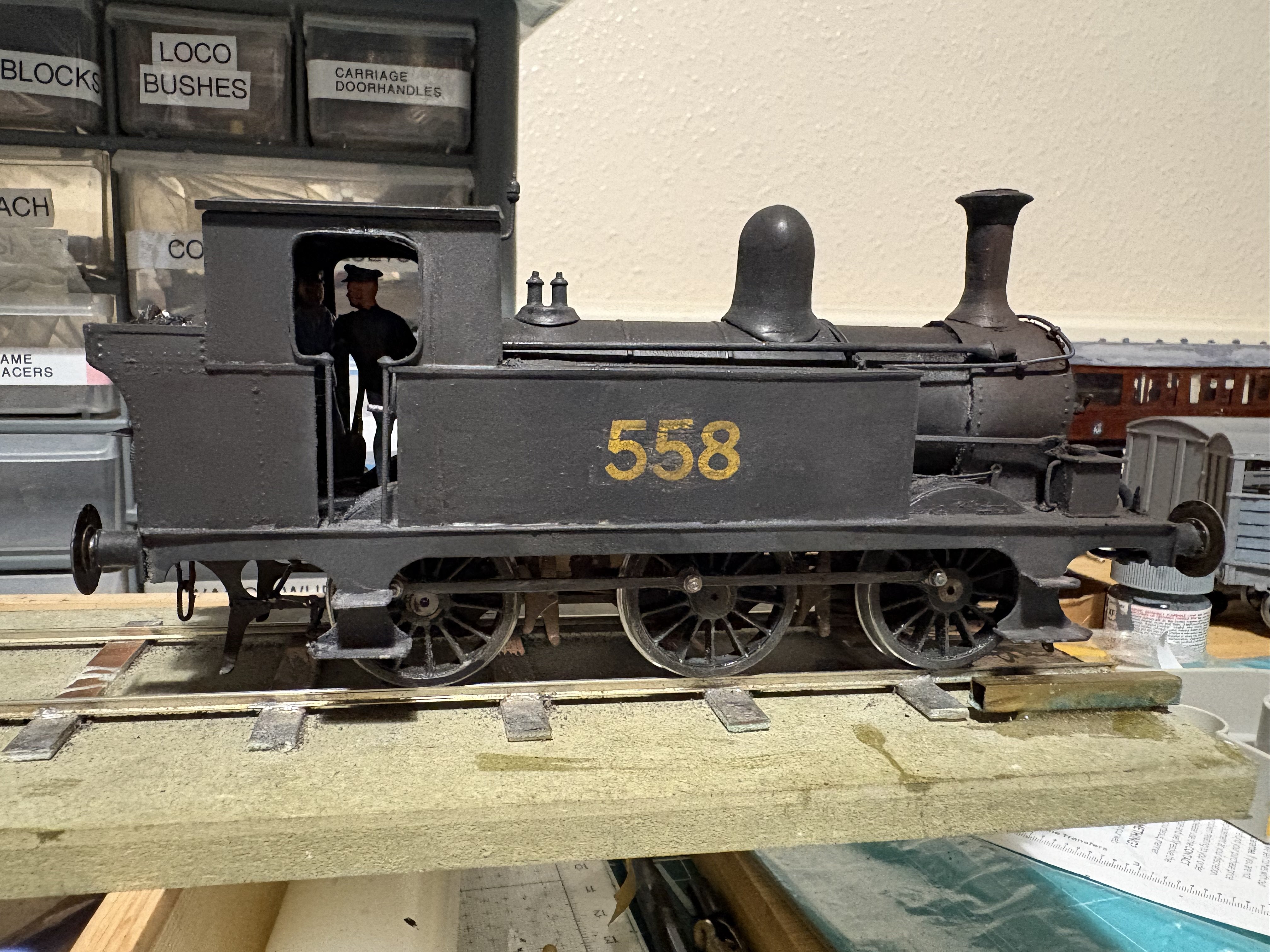

Galteemore Posted June 3 Author Posted June 3 (edited) After the relative disappointment of Black Lion, I wanted to finish a simple engine to get some inspiration back. It took longer than I thought, thanks to @Mol_PMB who has inspired more exacting standards by the details he identified in J26 variations. 558 seems to have had more variation than any other non-Tramore loco, including bunker steps, a tank brace, door clips, and an extra handrail, plus huge buffers. Sourcing some parts took time, and the buffers I found in the end are from a Heljan diesel so I suppose technically this has an IRM link. And thankfully @Tullygrainey she runs beautifully - due in large part to a special helical gearbox. Just the cab roof to glue when the crew have set and she’s done. Numbers are slightly too big but just about ok…. Edited June 3 by Galteemore 10 7
Tullygrainey Posted June 3 Posted June 3 That's spot on David! A great build and a perfect weathering job. Every inch a hard-working, well used engine. And a good runner into the bargain! Ticks all the boxes. I know what you mean about inspiration. It's so easy to lose heart, and interest, when things don't work out so I'm glad this one has come good. I hope you're planning the next one. Onward and upward. 2 2 1

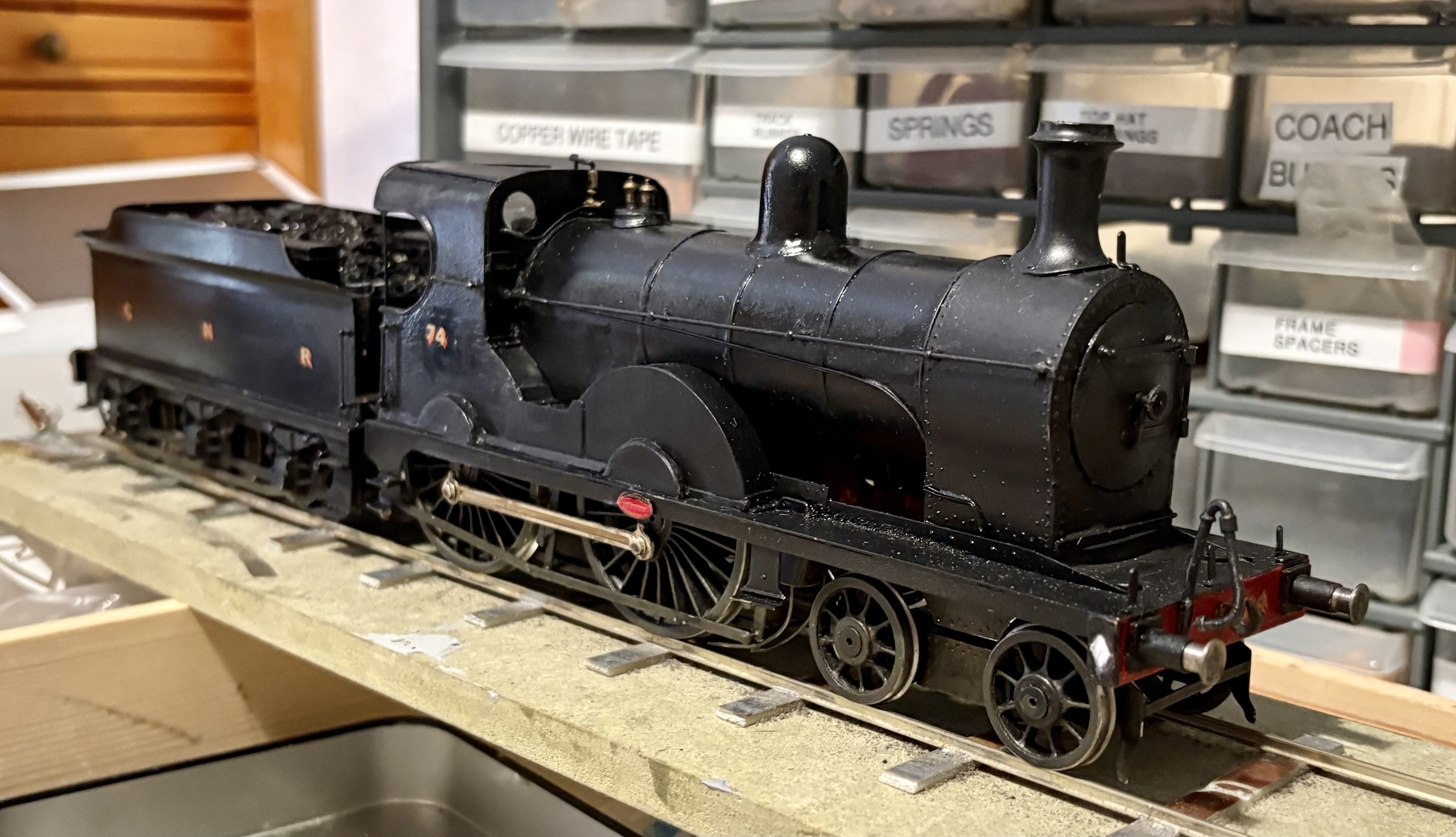

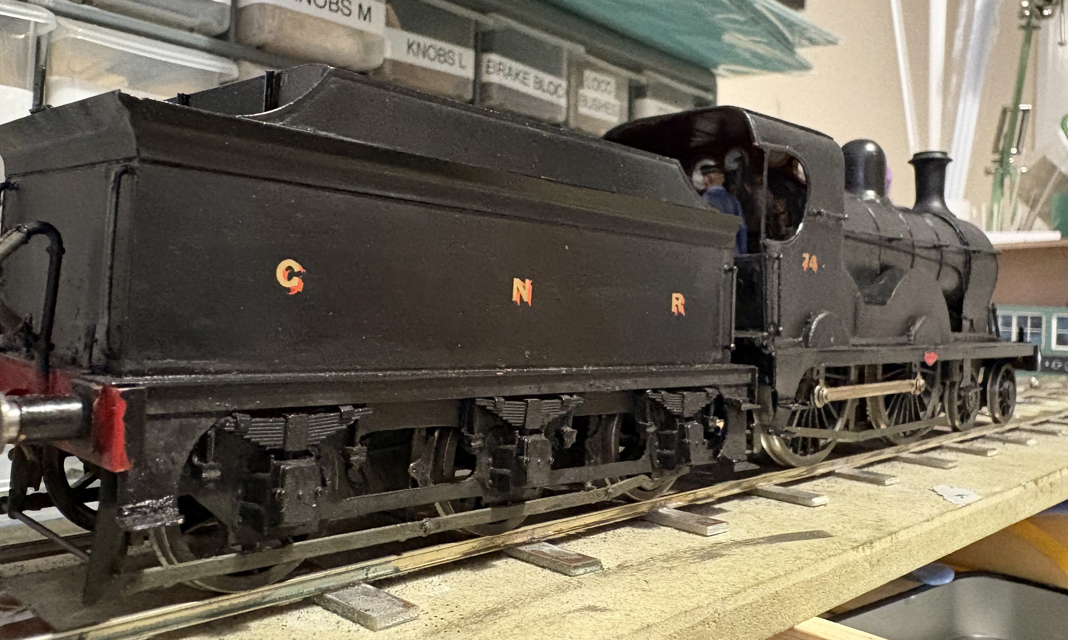

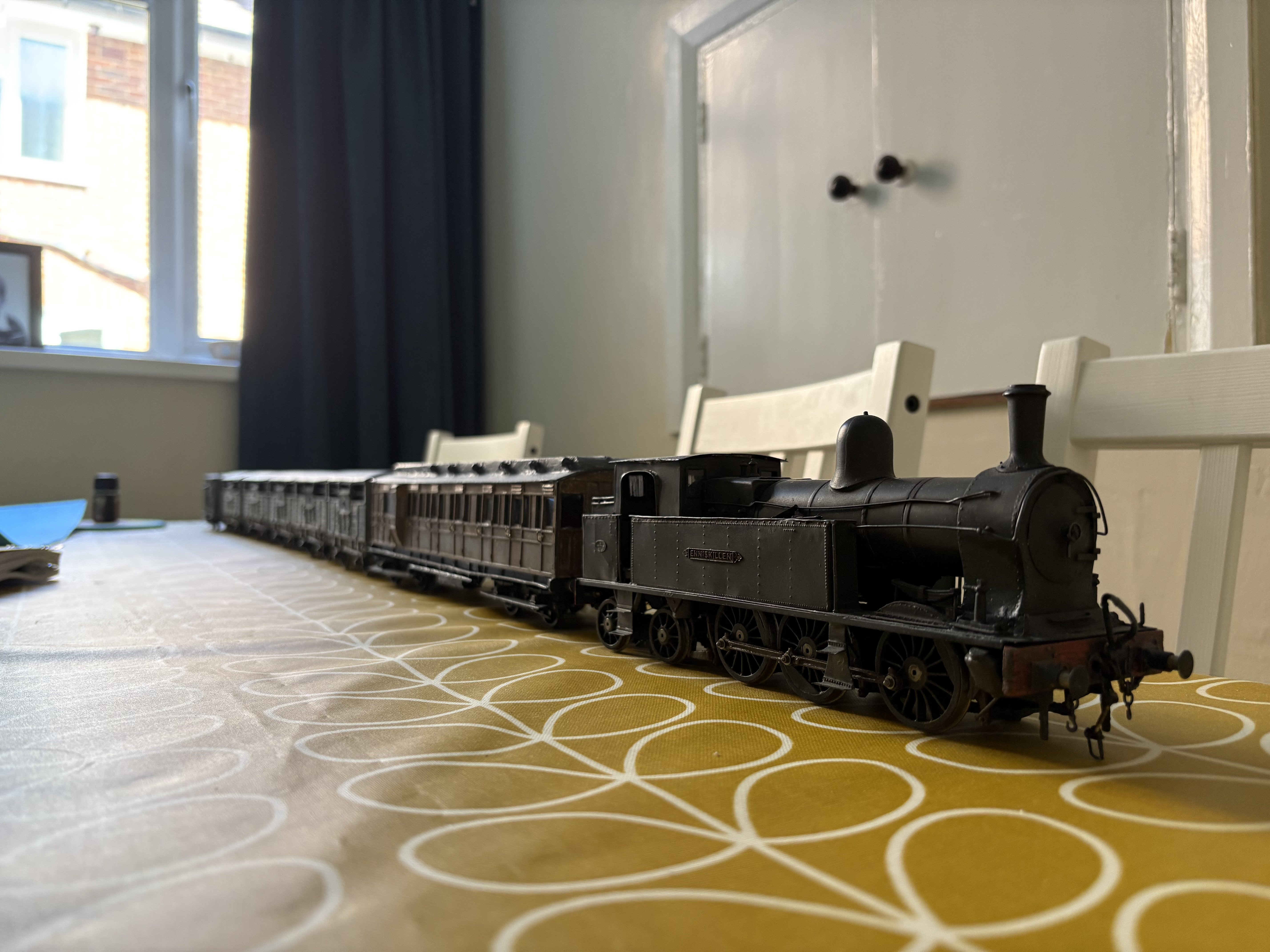

Galteemore Posted June 6 Author Posted June 6 (edited) Inspired by @Tullygraineys PP build I dragged mine out of the box to give her a blast up and down. Reassuringly she ran - also gave me a chance to pose a CIE grey loco with a proper black engine - the colour difference is striking. We are moving house in a month or two so this will be my last loco build for a bit - I have a blue 4-4-0 to do but that’s not a job to rush. I may try another small project though…..watch this space !! Edited June 6 by Galteemore 11 4

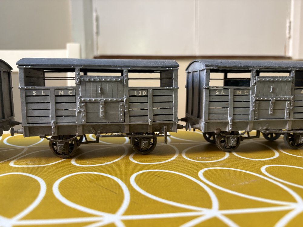

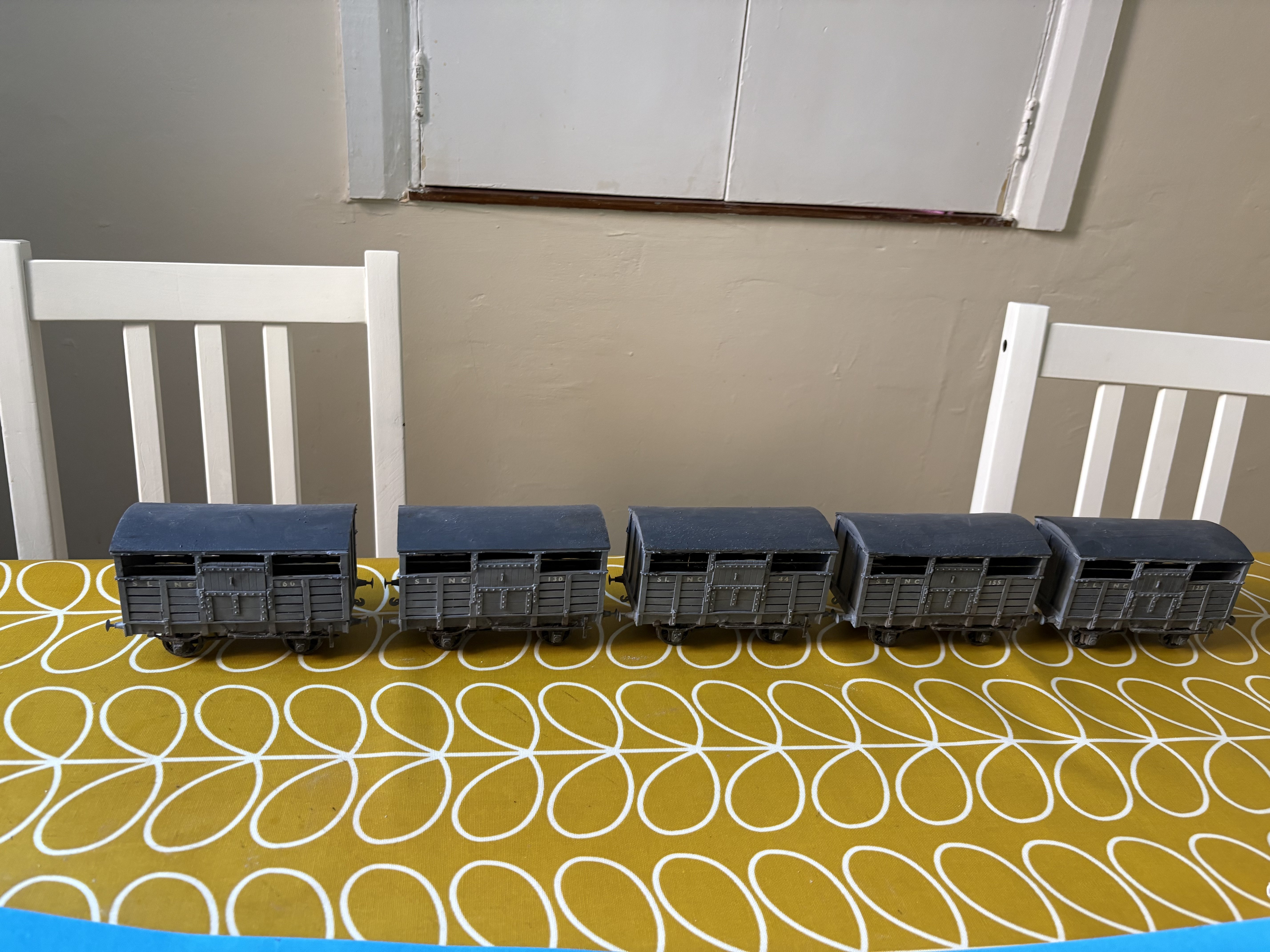

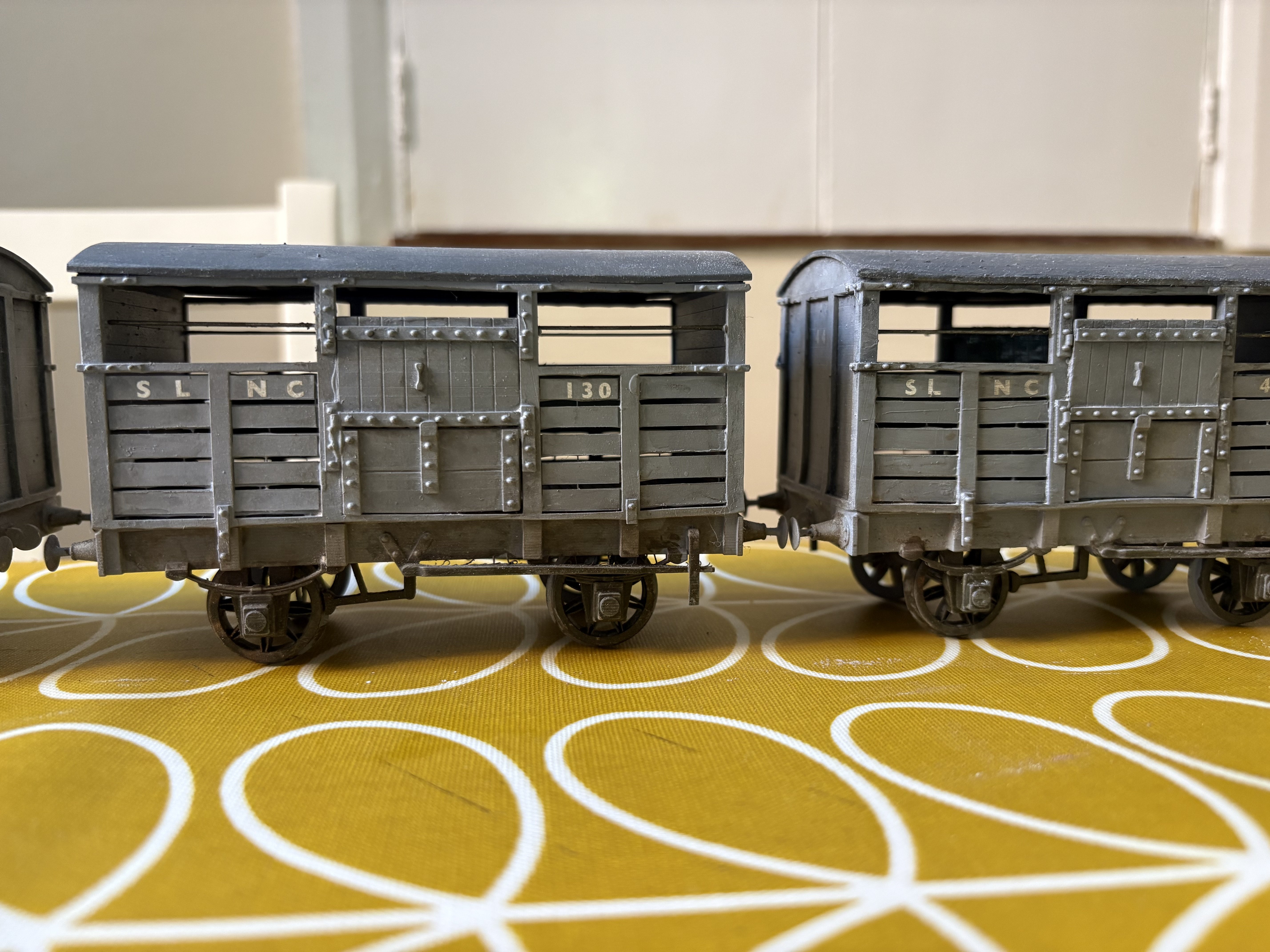

Galteemore Posted Sunday at 14:11 Author Posted Sunday at 14:11 (edited) Main effort of late has been finishing off some printed cattle wagons. These arrived in fairly good shape, 36.75mm wheels already fitted, with just painting, fitting of bars (0.7mm wire was what I figured would work) and putting the doors on. As supplied the planks had a distinct curve across the length of each, so I cut new planks from 10thou plastic and superglued these on top. Make a very nice rake. Ther is the odd irregularity, but one tends to look at a whole train in the case of wagons like this, so it all blends in. Cattle trucks, like signal cabins, are tricky to make, and this has saved a lot of work. Just need to fit couplings (thinking of using S and W). The 7:20 has a few empties tonight ! Edited Sunday at 14:13 by Galteemore 11 2
Mol_PMB Posted Sunday at 14:16 Posted Sunday at 14:16 Very nice - that's a great looking rake! Which breed of cattle will you use - eBay, etsy, woodlands scenics, or win the lottery and get ModelU? 1 3
Galteemore Posted Sunday at 14:18 Author Posted Sunday at 14:18 Just now, Mol_PMB said: Very nice - that's a great looking rake! Which breed of cattle will you use - eBay, etsy, woodlands scenics, or win the lottery and get ModelU? Thanks Paul. Too late - doors are glued! This will be an empty rake. Got some tyre weights to glue underneath if weight is needed 1
