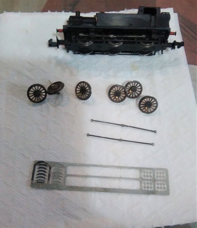

Angus Posted November 2, 2019 Author Posted November 2, 2019 I started on the Jinty conversion this afternoon. Firstly the components were brought together. The crankpins have been soldered into the wheels and the conversion commenced. The balance weight have been cleaned up with a file and superglued onto the wheels. As I suspected the brakes have had to be cut off and will need moving out to align to the wider gauge. The rear footsteps are also close to the wheel faces so these have been thinned down with a file to create a bit more clearance. After a false start due to cutting a wheel muff too short ( I forgot the axles are 1mm further apart) and I've got a 0-4-0 rolling chassis. Tomorrow should hopefully see the remaining axles complete and installed. I'm intending to use a plain muff first to enable a rolling chassis to check and remove any tight spots in the rods before I install the geared muff. For anyone doubting the benefits here is a comparison of the Farish coupling rods and wheels to the finescale ones. 3

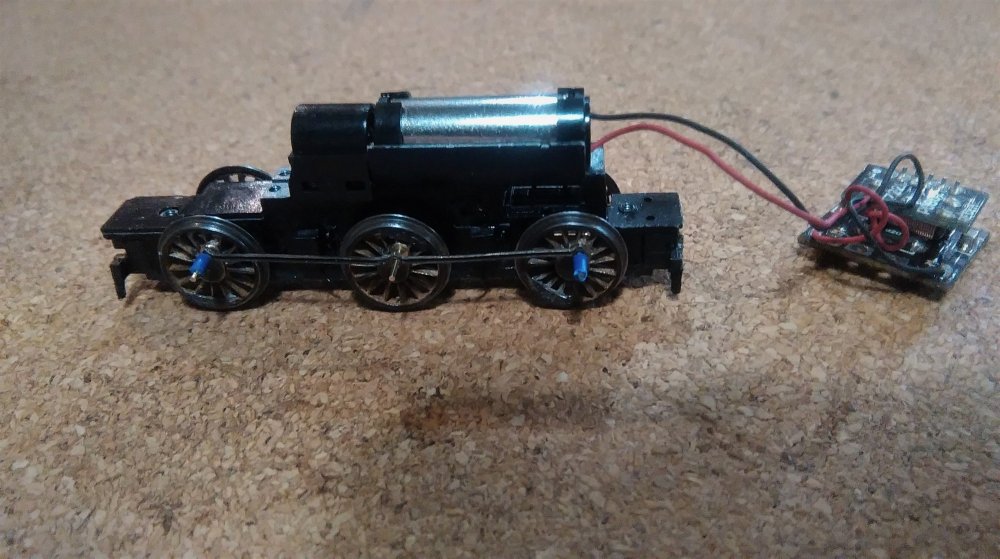

Angus Posted November 3, 2019 Author Posted November 3, 2019 The result of today's work is a rolling chassis with all three axles:- I've since removed the plain muff on the drive axle and replaced it with a geared muff. I've then run the chassis under power and all seems well. Next step is to solder the coupling rod washers in place and shorten the crankpins so the body can drop on. Hopefully I won't solder everything solid on the process! 3

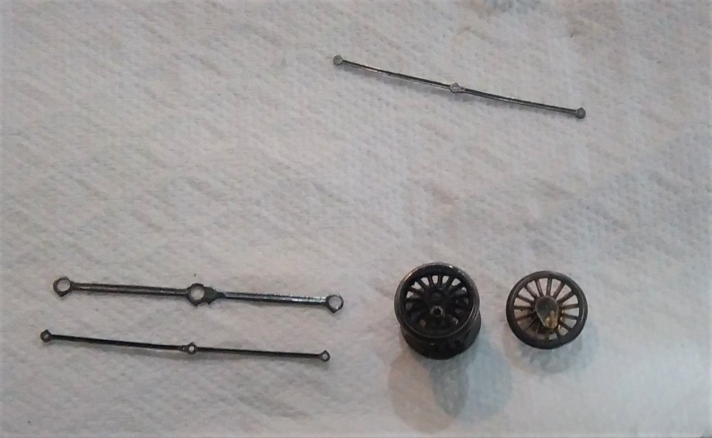

Angus Posted November 10, 2019 Author Posted November 10, 2019 (edited) Well, the inevitable happened when I soldered on the coupling rods onto the Y class and I managed to solder two of the pins solid. Strangely this was the last two I did so I was obviously getting complacent. I've freed them off now but in the process loosened one of the wheels. With a bit of fettling everything is running again, I just need to attack the recalcitrant pins again when I'm in the mood. Instead I turned my attention to developing the layout a bit more. Some 6mm MDF was salvaged from the garage and cut to shape for the station platforms. This actually took quite a while due to the need to size everything around the buildings. And there in lies a problem, I can't find any consistent data of measures. So short of trudge across the Irish Sea with a tape measure (I did suggest a holiday to my wife but she seemed unimpressed by the this....) I've gone with what looks right. My datum points were the 25 inch OS map, Bing maps aerial view and Google earth. All three give different dimensions for the buildings What initially threw me was the goods shed. I had presumed this would be the same as the one at Glenfarne. It looks similar in the photos and an I've bought an Alphagraphix kit of the structure, scanned it in and re-scaled it for 2mm. Looking at the Dromahair structure in more detail is is clearly a bigger building. I think I've got back to a pretty good approximation. No doubt if I ever get to Dromahair armed with said tape measure I'll find I'm widely out. Still if it looks right........ The building in the photo above are just held together with bluetak. The corners need chamfering and more door and window cut outs are required. The white strips are foam from a pizza base that will be scribbed and painted as rough stonework. Some initial experiments look promising. Edited November 10, 2019 by Angus 3

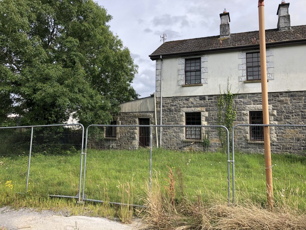

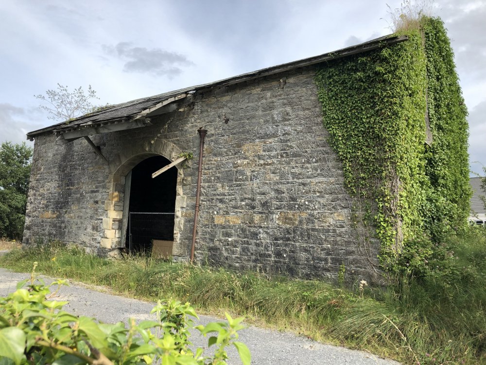

Galteemore Posted November 10, 2019 Posted November 10, 2019 (edited) Looks good to me Angus. I was fact finding in Dromahair in July and took a few snaps. As I’m looking for the SLNC house style to emulate rather than a exact replica, I’m afraid I didn’t take a tape measure...but the goods shed looks a bit bigger than Glenfarne, which I have just this week mocked up in 7mm. Edited November 10, 2019 by Galteemore 1 1
Angus Posted November 10, 2019 Author Posted November 10, 2019 Thanks Galteemore those two views are most useful. I haven't seen a rear view of the goods shed. I am puzzled why the downpipe hopper is so low though. It's the same on the front:- http://eiretrains.com/Photo_Gallery/Railway Stations D/Dromahair/IrishRailwayStations.html#Dromahair_20060618_005_CC_JA.jpg
Galteemore Posted November 10, 2019 Posted November 10, 2019 (edited) Yes, Angus, rather odd. I’m sitting in Amsterdam airport right now so can’t check my SLNC collection but I do remember that I thought the water pipe arrangement wasn’t quite what I expected when I made the Dromahair-ish station building... Edited November 10, 2019 by Galteemore 1

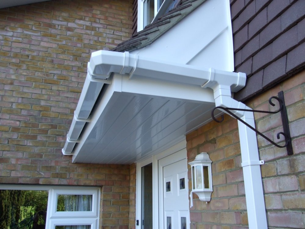

Broithe Posted November 10, 2019 Posted November 10, 2019 43 minutes ago, Angus said: I am puzzled why the downpipe hopper is so low though. It's the same on the front:- http://eiretrains.com/Photo_Gallery/Railway Stations D/Dromahair/IrishRailwayStations.html#Dromahair_20060618_005_CC_JA.jpg Was there maybe a gutter along the front of the 'porch', with a bend and a run back into the hopper? This sort of thing. 1
David Holman Posted November 10, 2019 Posted November 10, 2019 Possibly, though expanding the be photo shows the downpipe from the roof gutters stopping short of the porch which suggests there was a gulley next to the wall on the porch roof and water from here went down the next drainpipe to the ground. A slight gradient on the porch roof towards the wall?
Angus Posted November 10, 2019 Author Posted November 10, 2019 Hi Brothie, I did wonder if that might be the case but hoppers look higher than the front of the porch. It might just be an optical illusion in the photo mind. I'll have to spend some time looking at the historical photos.
