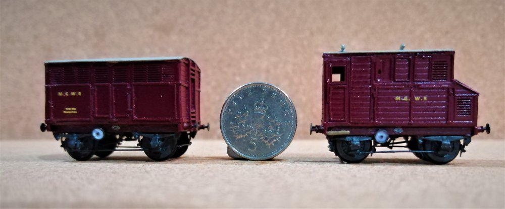

The MGWR vans have been taken as far as I can go at present, apologies for the photo quality, natural light is hard to come by at this time!
I had some lettering made up using standard fonts, not shaded but I think I can get away that in 2mm. I've included the 5p just for David 🙂
The wording "to run with passenger trains" is almost legible which is a tribute to the printing skills of Rail-tec transfers who produced the lettering. I just need some numbers to match but they are currently out of stock of the ones I need.
Once I have these I can seal the vans and apply some weathering to tone the colours down and blend everything in.
The letter is slightly small (a problem I never thought I'd have in 2mm scale!)

Following these photos I've lightened the grey on the rooves, I'm guessing by early GSR days they wouldn't be so white, I've add the white inner circle on the brake wheel apparent in the first photograph.
I've not included the "to run with passenger trains" wording on the horsebox as I can't see any evidence of it, that said it could easily be obscured in all the shots.

 Love the 5p picture. I hand lettered mine with a fine nibbed dipping pen, so this is another level entirely!

Anyway, enough dreaming! Prompted by a request for a photo for the 2mm Scale Association's bi-monthly magazine I've finished the horsebox build (still needs paint and decals)
The vents were formed from 0.6mm wire, two lengths being bent to shape and the backs filed to half thickness and the pair soldered together.
It was actually easier than I feared, the harder part was getting the vents mounted in the roof at a similar level and alignment.
Seen here posed on the fledgling Dromahair at the end of the goods bay ready for loading.
I'll have to re-do the station sign as it has warped.
I'm now on with the first of the meat vans. I'll post up progress as soon as I have anything worthwhile.
Wow - that is spectacular! The level of detail is amazing!
