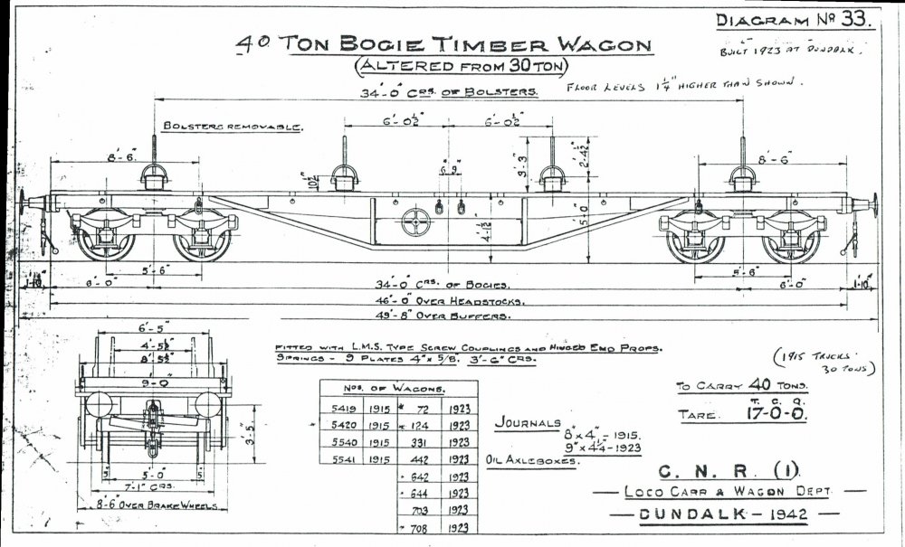

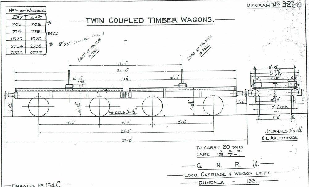

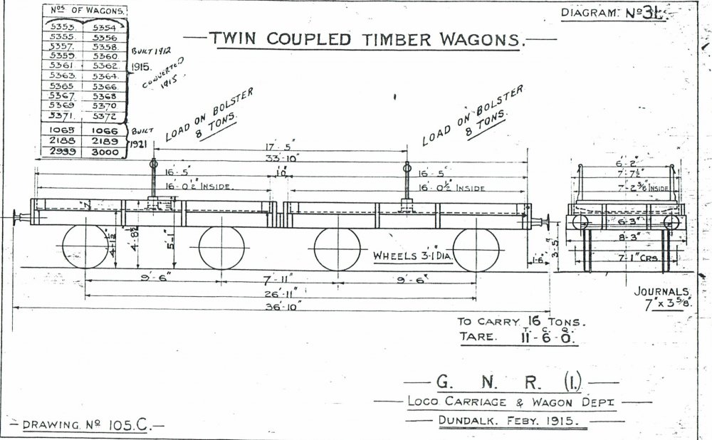

Thank you all very much for your replies. John M's drawings and minister  for  hardship's postings gave me just what I needed. Its the Ratio wagons that i have got.
