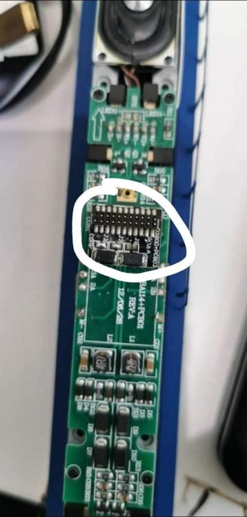

IANG Posted February 29, 2020 Posted February 29, 2020 Does anybody know where I can get a replacement or what to do now as I have a non runner. Can I just bypass this and wire a decoder to the motor? Quote

0 Noel Posted February 29, 2020 Posted February 29, 2020 (edited) 1 hour ago, IANG said: Does anybody know where I can get a replacement or what to do now as I have a non runner. Can I just bypass this and wire a decoder to the motor? Ian could you please gives us a little more info. was the loco running ok on DC or DCC? Is the item in the photo the DCC blanking pub that plugs into the locos main PCB? and why do you think it needs replacing? Would not recommend wiring decoder directly to a Murphy Model loco. The onboard PCB has all the logic for controlling the lights, etc, which you'd lose. Are any of the pins sticking up from the 21pin plug on the main PCB bent? If there is no apparent damage to the main PCB on top of the loco chassis all you need to do is install a 21pin decoder and test it as ADDRESS 3 until you re-program the loco address. Would you prefer to run the loco on DC or DCC? Edited February 29, 2020 by Noel 1 Quote

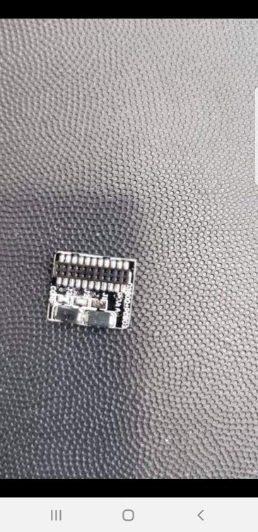

0 IANG Posted February 29, 2020 Author Posted February 29, 2020 It was running on dc and I was just testing it but I noticed there was another loco on the track so I pulled it up and it hadn't been working since that. So I gave it to a guy who has a electrical shop he was checking it over with volt meter trying to fault find he thought it might have been a short circuit and he came back with the decoder socket isnt working from what I understood. I have asked him again what was wrong to get better idea. That's photo he sent me Quote
0 enniscorthyman Posted February 29, 2020 Posted February 29, 2020 That looks like the blanking plate that covers the 21 pins when the loco is running dc. Quote

0 WRENNEIRE Posted March 1, 2020 Posted March 1, 2020 Very unusual Ian, never had any trouble with them unless it has been installed incorrectly Where are you based? I have some spare blanking plates that you could try Or can you stick the blanking plate in another loco to see if it is OK? Quote
0 Noel Posted March 1, 2020 Posted March 1, 2020 6 hours ago, IANG said: Is it possible for these to short out ? Very unlikely. Are the contacts on the wheel pickups clean? Make sure the blanking plate is plugged in the correct orientation. If I was trying to fault find, the first thing I'd do very very carefully is put the loco on a work bench and supply power directly to the motor using micro croc leads to see if the motor was running ok. Then I'd work back from there and check for any loose connections between motor, the PCB and the PCB and the wheel pickups. The MM071 chassis are very fussy to disassemble and one thing out of place and they won't run. Those blanking plates are almost indestructible. Are you able to run another DC loco on the same section of track work with the same 12v DC controller? Quote

0 IANG Posted March 5, 2020 Author Posted March 5, 2020 This is the part what's gone could somebody explain what it is and where I'd get another one Quote
0 skinner75 Posted March 5, 2020 Posted March 5, 2020 That part you have circled above is the '21 pin dcc decoder socket' by the looks of it Quote

0 IANG Posted March 6, 2020 Author Posted March 6, 2020 (edited) 1 hour ago, RobertRoche said: The part circled needs to be installed when running on DC, or it needs to be removed and replaced with a digital decoder when running on DCC. Make sure it is installed correctly and is in contact with all the pins. There is a right way and a wrong way to put it in. Seemingly this is why loco isn't running on dc it was as you can see from the messages above and then whatever I did it just stopped no power nothing and am completely lost to what is wrong I give it to this guy who is running am electrical shop in athlone called I be fix it he is the one who told me this is what's wrong fisrt he sent me photo of blanking chip then I got my mate to talk to him (because he recommended him) I couldn't get answer of him and he told him this is what is wrong and sent the above photo and now wants €10 for nothing Edited March 6, 2020 by IANG Quote
