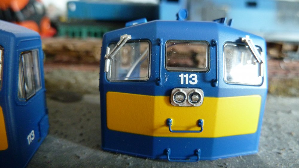

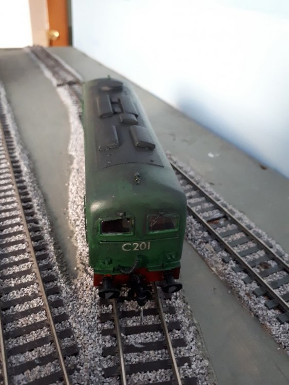

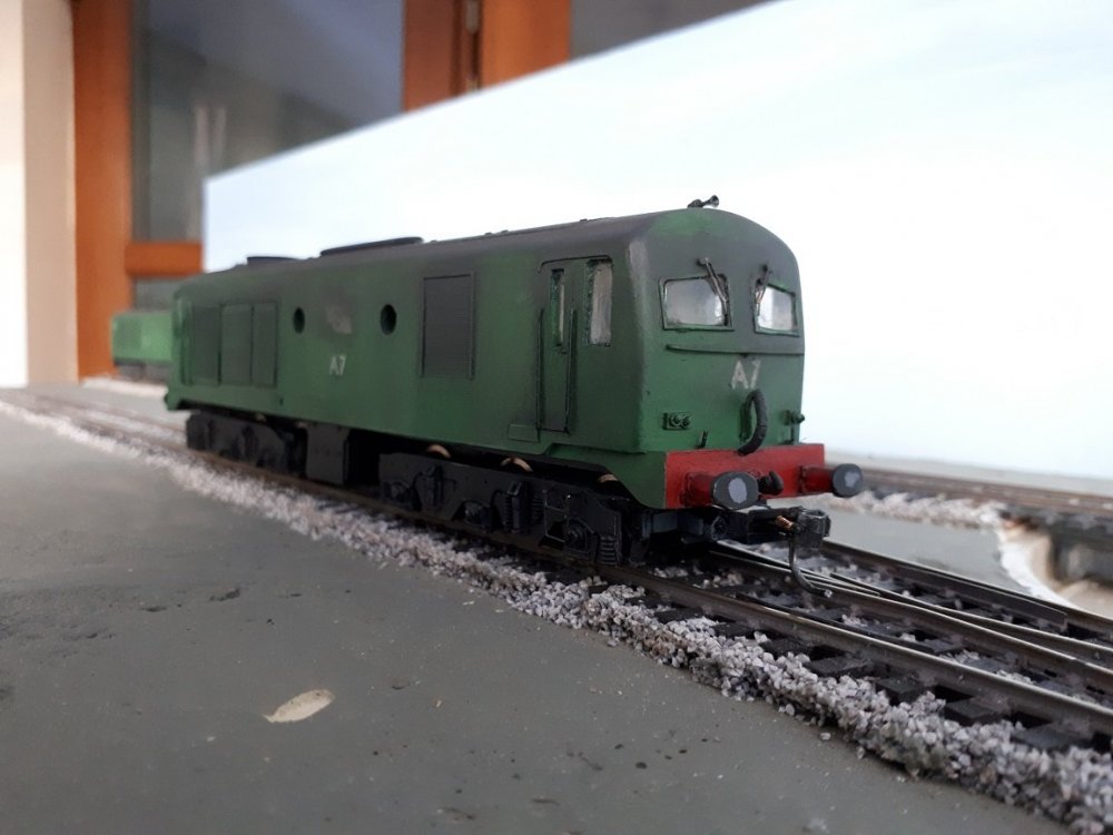

Just a couple of things I have been doing during lock down. My god the camera is478062064_DieselC2012.thumb.jpg.13d122b2a812eeec397411b9fef8f5a3.jpg1146273293_DieselA7.thumb.jpg.7406f74f57a0593cb2683a3581c890cc.jpgIMG_6650.JPG.a453f430f580b91e0a30452798786113.JPGIMG_6655.JPG.4595579e5de530244060010b614bab57.JPG349185846_DieselC201.thumb.jpg.2ad38d9438a814ffbf32015fb8b767ca.jpg cruel! I hesitated before posting!  They both look better in the flesh! Honest! Can I blame the camera phone?

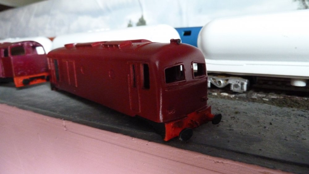

About an hour ago I added the etched frames to my MV / C class found in a box with a engine shed full of other part built resin, cast whitemetal offerings  - I have 2 silver Fox A class and a white metal one.  couple of Hunslet diesels - one now maroon.  a resin 121  now in orange  and a MIR 111 with broken handrails ...  your efforts put mine to shame you have finished a  two locos and the Sulzer B is coming on well- but looks like a lot of glazing to fit.
They look very good. Great job. Enjoy.
Ps what chassis did you use?

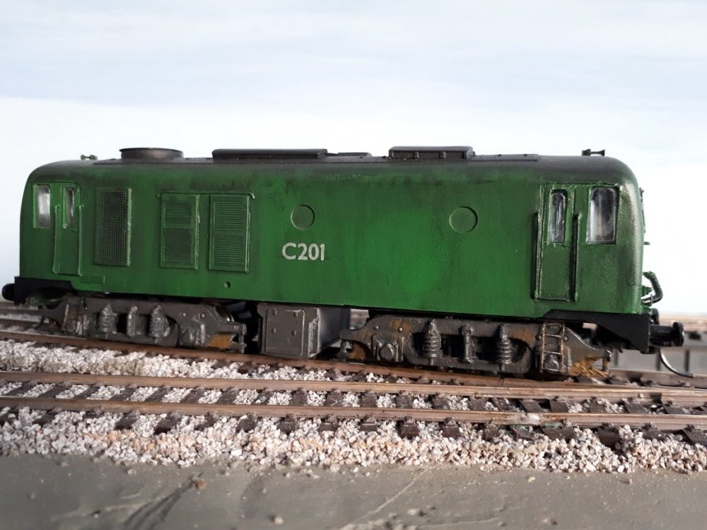

Noel, the A & Sulzer are on Hornby Deltic chassis the C is on a Hornby  Electro-Diesel cls 73 I believe. All bought on ebay and run well which is fortunate. All have the later enclosed motor, not the pancake one! Thanks for all the likes guys.
Robert, I have started glazing, cutting up Ferro Roche boxes and filing to shape is a dull and boring job! So best man up and crack on. I did wonder if I have overdone the grime but I did use colour photos and filth does seem to be the order of the day in the Crossley era.

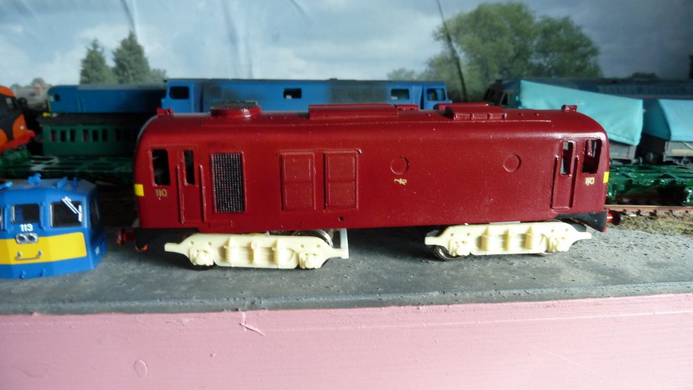

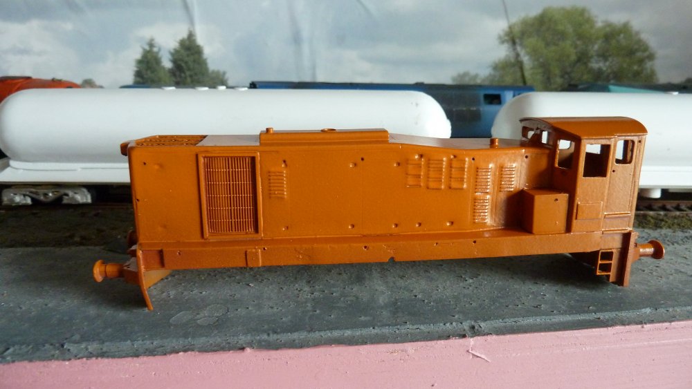

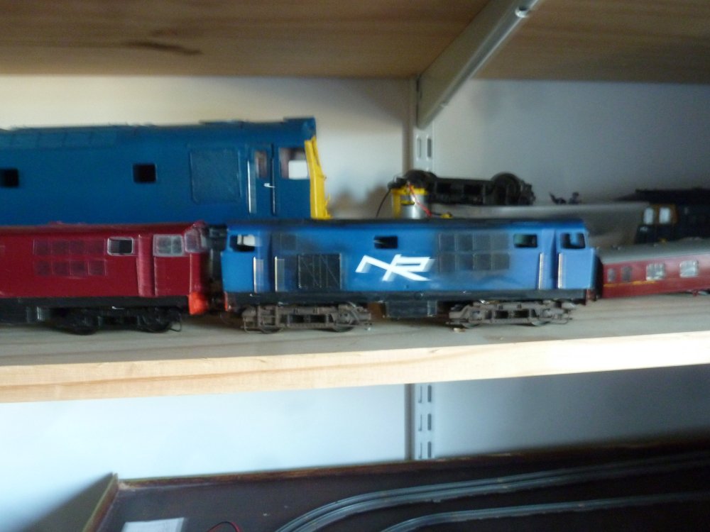

A bit more done on the loco front with rubdown logos - but these have reacted to testors dull coat and Humbrol acrylic gloss - If anybody has any of the smaller 101 NIR logos tucked away  and open to reasonable offers I would like to get a second set and the MIR red transfers.
Flash on 111 makes it looks a bit garish but ok really . Behind ,as I guess are  more across the land, 121 being finished as the rtr model makes final approach and behind 3 A class. 121 is an MIR resin and then two fox A and a white metal Q kits A class- this does need a big motor or a set of jacks as a depot queen.

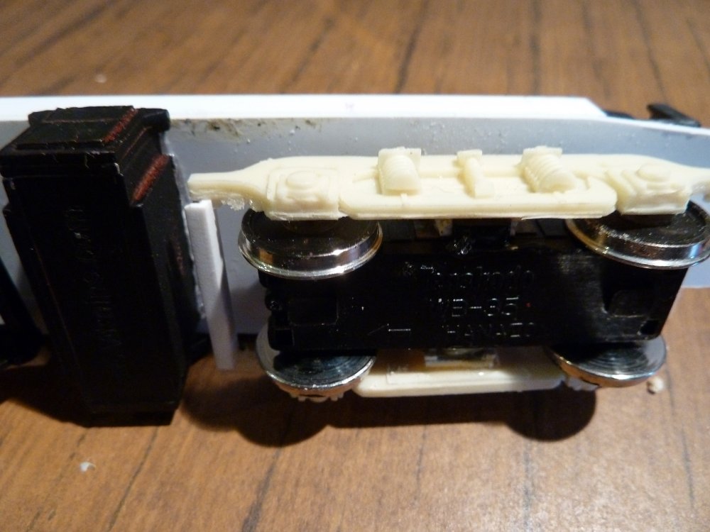

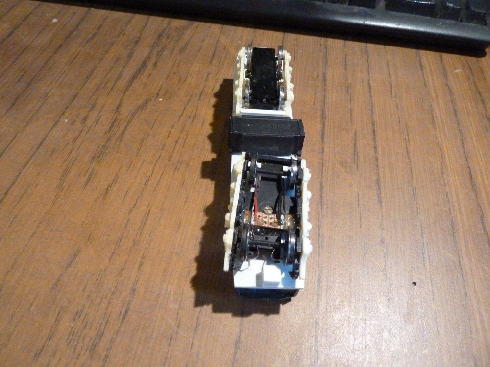

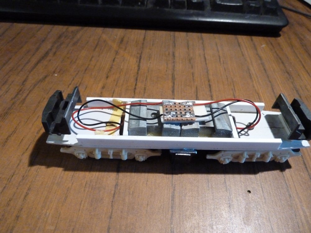

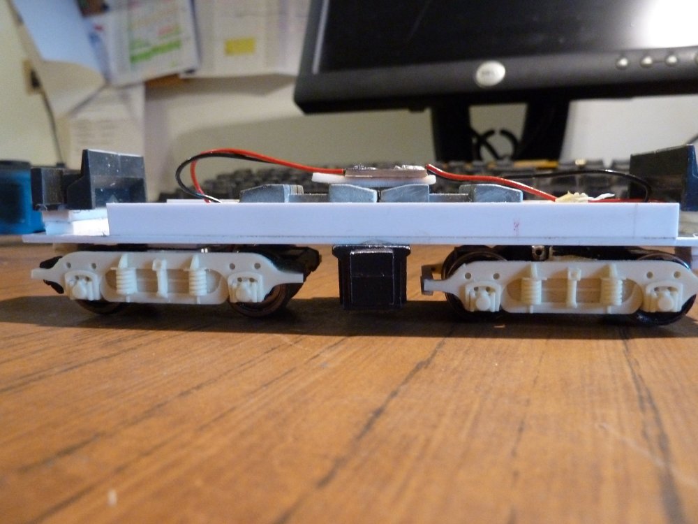

MV chassis pics 438505987_MVchassis101020007.thumb.jpg.04aed10d3601b6b8fa2278f38485836c.jpgSide view - noticed bogie frames not same height - will have to correct !
1571357560_MVchassis101020001.thumb.jpg.2e4352533483096343dacb5c3c51fb6a.jpgtop down Hornby 25 weights, IIRC replica cab units 80 and 60 thou plasticard. vero board to link bogies - It would be possible to mess with black bettle and arrange use of a rtr PCB board to support lights etc. being a dino this might happen in the 22nd century !
176521022_MVchassis101020002.thumb.jpg.4f591952838e15ed3d8eed9012ed8d6d.jpgMk1 Bachmann coach with pickups  and SF sideframes, coupler mount for Kaydee 5s- plan anyway.
813208557_MVchassis101020006.thumb.jpg.9257c35dfc30c100b6dc8439d0307eaf.jpg Black bettle as power base , Just see Eion`s cast weight.  lovely job and adds weight low down.   Finish off with matt black and a dust of frame muck.

Looks like a nice installation there Whizz, I filed the holes out in the bogie side frames. Not sure it was worth the effort when all is painted black and then weathered to 60's filth style.

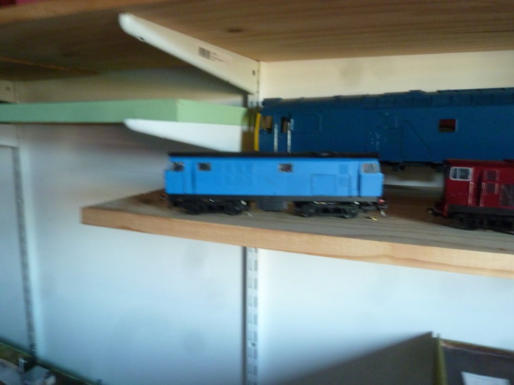

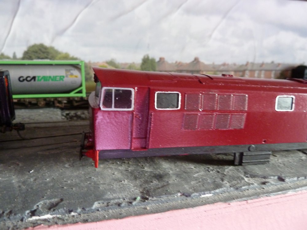

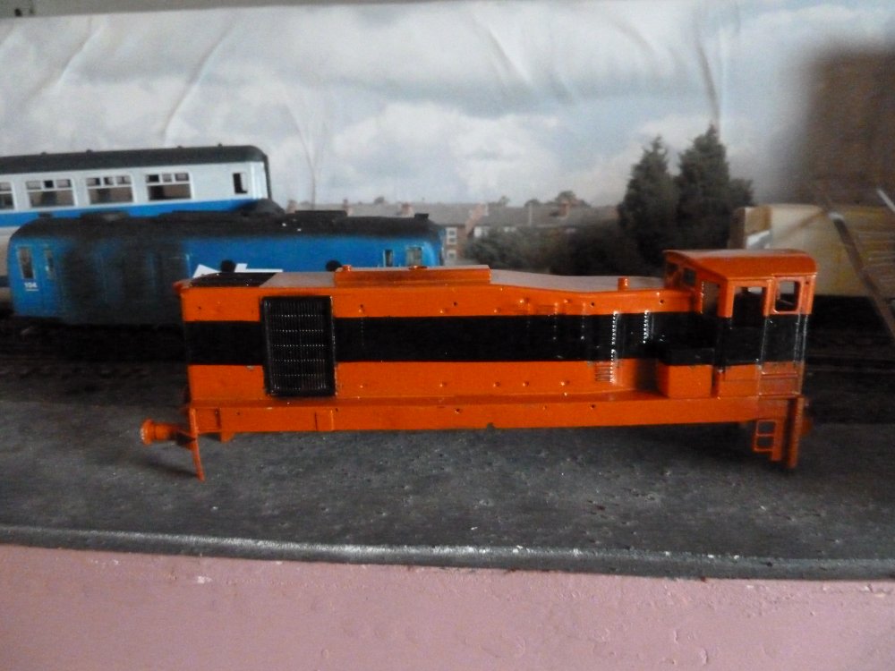

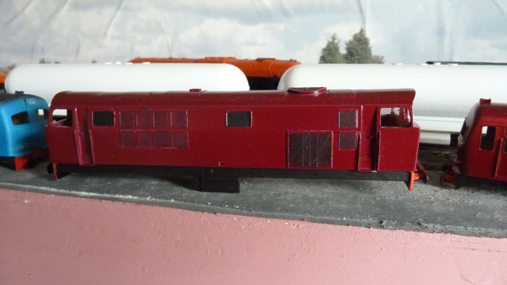

The MIR resin 121 got a bit of the black on - go round with a band and will use the IRM ends to fashion spray masks .
The 104 got 4mm loco numbers but closer checking of pics show much smaller numbers used - the look coach sized numbers so I will scrape off first efforts, in back ground of 121 pic a case of two steps back, ho hum.

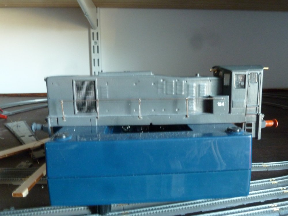

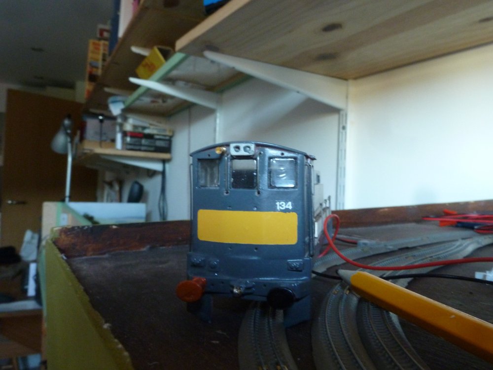

Much later ..  the 121 has gone UP "gray" as 134  and another 101 on the way.
1650670455_NIRloco010322011.thumb.jpg.6b6936e540899e81fcd3115681a13d40.jpg1076652490_NIRloco010322006.thumb.jpg.0d75aece498214122f89efaa4b338d04.jpg
I have emailed Steve at Railtech to see if the eruo long number and RSPI crest possible in white.  Chassis will be a motor bogie and coach bogie with 3D print sideframes in stock.

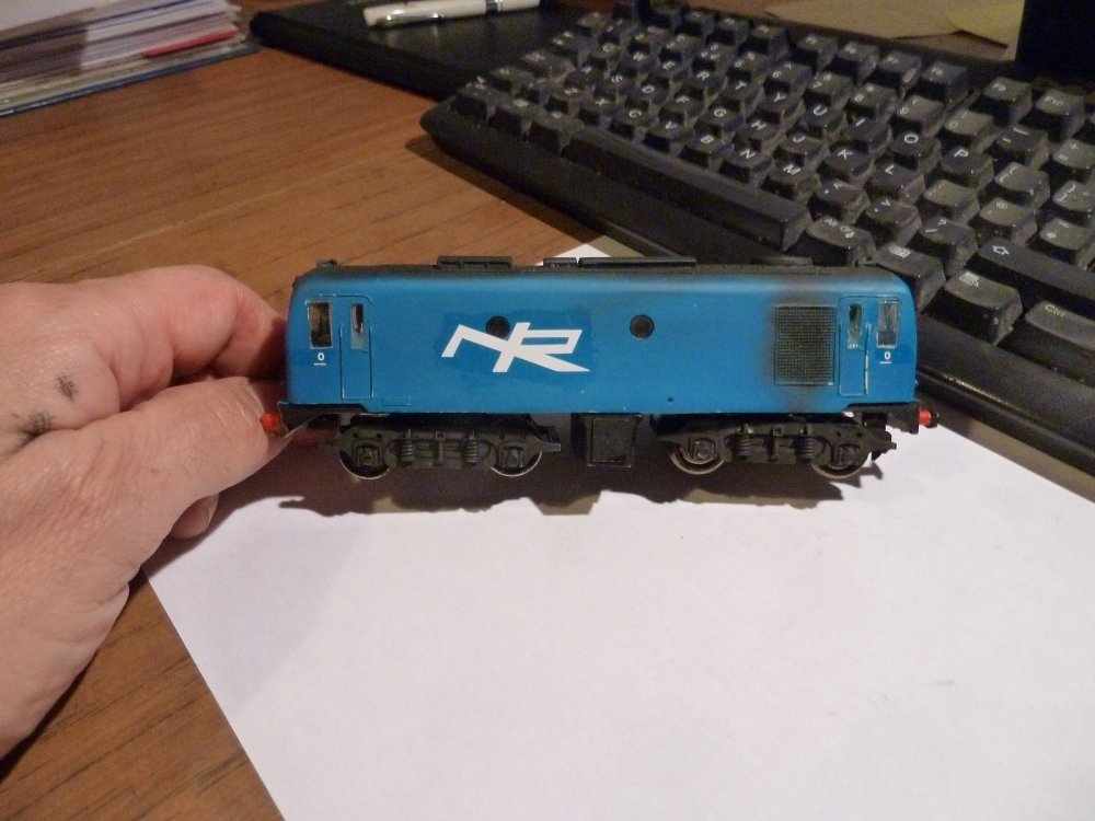

Sorry a biz fuzzy but shows third 101 with black roof as 102 in faded blue.1538998558_NIRloco010322001.thumb.jpg.40229fa7a7c6aa01ae1d444eca6fe202.jpg1538998558_NIRloco010322001.thumb.jpg.40229fa7a7c6aa01ae1d444eca6fe202.jpg
last pic  a bit of camera shake but shows handrails added and sitting on new weathered chassis ex ebay for £60, but at least ride hights the same on all three. I glued a piece of PCB 5mm up from body edge to make a level foot for chassis to sit on andwith a little sanding of chassis so the resin tanks just rub on chassis fuel tanks the chassis is a friction fit - a spot of evostick later to avoid chassis dropping out seems the way to go.  Kaydee 19s fit well, Detailed one end ready for PP stock from IRM! Next is to do ends with grab irons and transfers. worst job looks to be cutting glazing out of thick clear acyrlic - but the chocs were good ambassador!

Wow!!! Superb. I actually like that grey livery on a 121….
Cheers, I guess we are spoilt now as the MIR resin model is "basic" compared to bells and whistle of detail levels but I now wonder if I should have got out some 5 thou shim/ plasticard to make bonnet doors, I thought a dose of grime might hide but expect 134 will now kept to a medical grade of cleanness...    Indeed  the grey does sit well, but it is a short lived livery so the model will capture a moment in time. It did occur that I can get an 071 tranfer for a grey livery and mess with numbers to get a 121 version- with care.  Steve has a colour RPSI crest for the gen vehicle so a white one should be possible.
