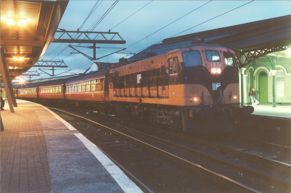

0 DiveController Posted July 26, 2020 Posted July 26, 2020 Not directly related to your question on the snack car but look at the lead Cravens coach on this formation and spot the difference. Maybe the only one running between 1989 until 1991-ish
0 jhb171achill Posted July 26, 2020 Posted July 26, 2020 11 minutes ago, DiveController said: Not directly related to your question on the snack car but look at the lead Cravens coach on this formation and spot the difference. Maybe the only one running between 1989 until 1991-ish The one with the two IR logos! There was that one coach. Something suggests there may have been two coaches with that on them, but I am not sure. Certainly no more. It was short-lived too. On 7/24/2020 at 9:52 AM, murphaph said: Hi all, What was the shortest regular train in passenger service where a Cravens snack car was utilised? How many standard coaches in that train? Perhaps Waterford to Limerick services? Claremorris to Ballina, Waterford to Rosslare, Rosslare - Limerick and Limerick - Nenagh often, if not USUALLY had a train consisting of a single coach plus genny van. Latterly this was a Craven, though in the 1970s / early 80s it could be a Park Royal or an old laminate. It would not have been a snack car though as none of those services had one. The shortest consist WITH a snack car was probably the snack car, plus genny van, plus maybe four or five other coaches. It would not be worthwhile putting a snack car on a service with less, unless it was closed up as such and only used for extra passenger accommodation. 1
0 DiveController Posted July 26, 2020 Posted July 26, 2020 Incidentally, I suppose for anyone who might not know, 187s is in a 'transitional livery', a worn Supertrain livery with IR set of points logos added to the sides, and to the cab fronts to cover the old CIE roundel. This is 1991 4 years after the IR log was introduced.... so the Cravens has (not only logos, but) Tippex stripes whereas the loco does not 1

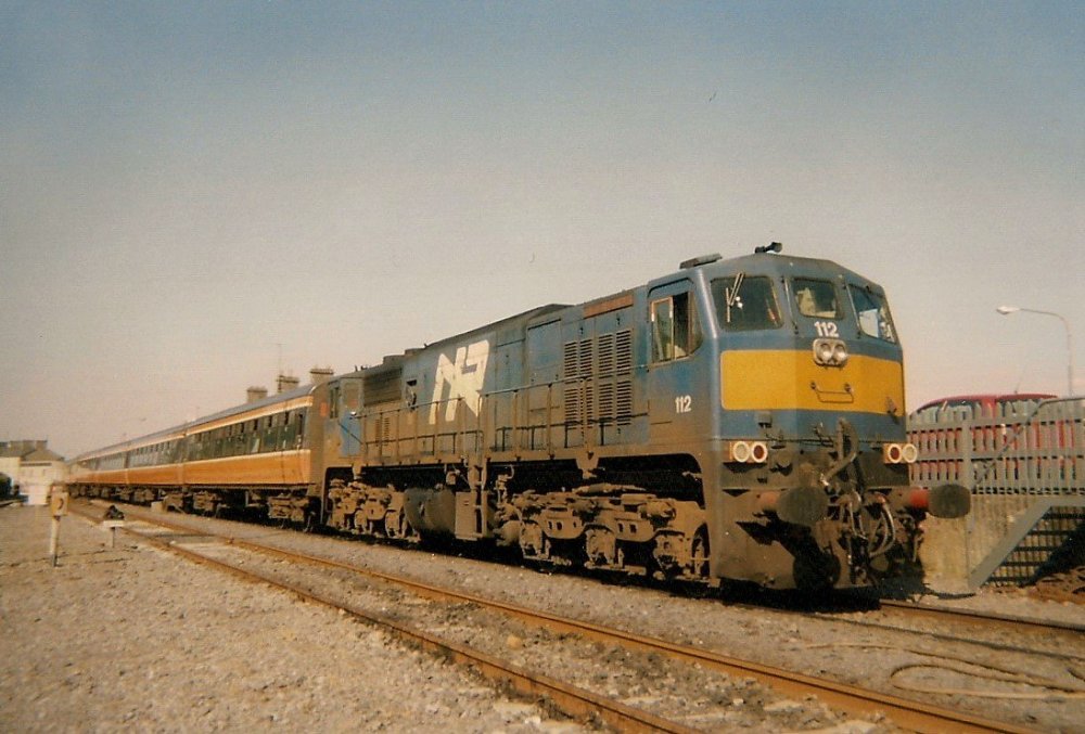

0 ttc0169 Posted July 26, 2020 Posted July 26, 2020 4 hours ago, hexagon789 said: Give me a bit jhb and I'll turn up an instance of a snack car as part of a two Cravens+GSV, it's somewhere in my notes of such things. Definitely being used only for seats though, I think it was a Ballina branch shuttle so no snacks, just a bone-shaking ride! The Cravens snack car was included in the formation of the Ballina branch Cravens set on only one occasion when part of the RPSI Cravens rail-tour set was used to strengthen the branch train back in 2003, I will check my Guards journal notes for dates and formation numbers but it was hauled by NIRs on loan locomotive 112. 1
0 ttc0169 Posted July 26, 2020 Posted July 26, 2020 2 hours ago, ttc0169 said: The Cravens snack car was included in the formation of the Ballina branch Cravens set on only one occasion when part of the RPSI Cravens rail-tour set was used to strengthen the branch train back in 2006, I will check my Guards journal notes for dates and formation numbers but it was hauled by NIRs on loan locomotive 112. 112 in Ballina prior to working the 18:00 branch train to Claremorris which included Cravens diner 1508 second from the locomotive (May 2006) The formation was 112,1532,1508,1507,1550 & GSV 3189. 1 2

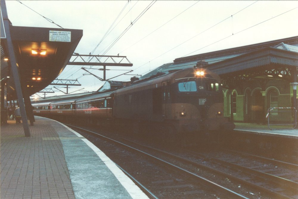

0 KMCE Posted July 27, 2020 Posted July 27, 2020 On 7/26/2020 at 2:19 AM, DiveController said: This one I recognise. That's the 17:25 to Arklow on Platform 5 - Huston. I travelled on that train for 4-5 years (c. 1988), which normally consisted of 4-5 coaches with a generating van - there was never a snack car on this one as it was commuter only. This one would have been the Dublin Rosslare train aroun the same time (again platform 5 - 18:30) which always included a snack car - not always open however. Not sure how useful this is, however it did bring back some memories!! Ken 1 1
0 murphaph Posted July 27, 2020 Author Posted July 27, 2020 Thx Ken. I guess you mean Connolly rather than Heuston but valuable info nonetheless.
0 KMCE Posted July 27, 2020 Posted July 27, 2020 3 minutes ago, murphaph said: Connolly Of course - Jaysus, you think I would get it right after that amount of time on the train!!!!!! 2
