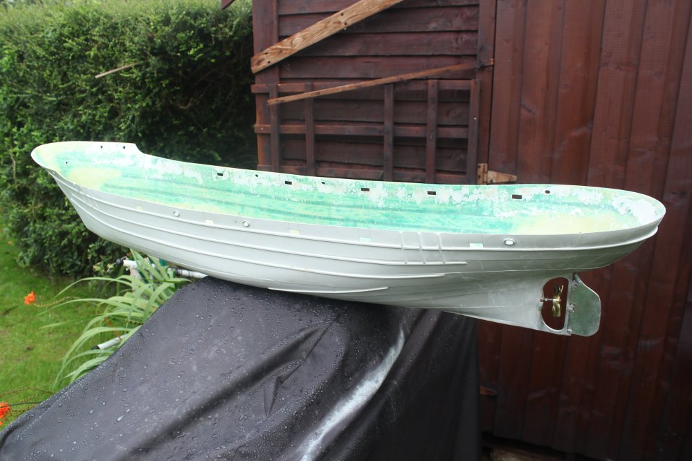

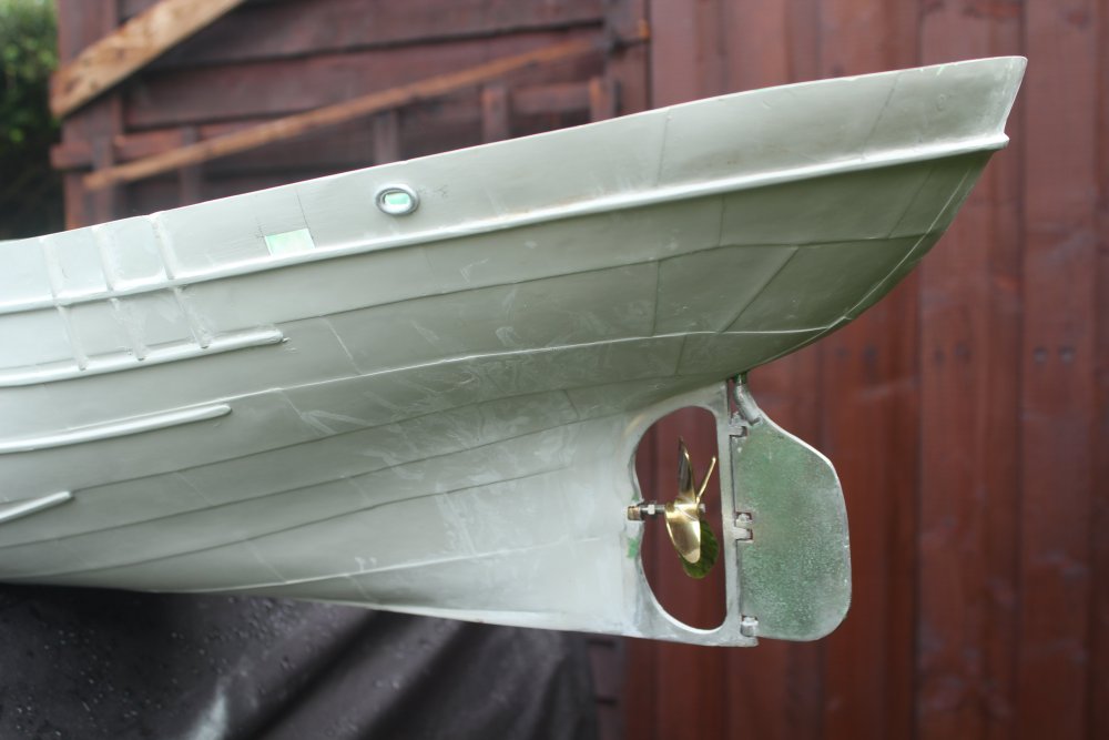

Managed to kick this into gear over the past 2 weeks, P38 car filler used around the Bulwarks and sanded smooth, the Deck drainage holes and the prop shaft hole  drilled and filed out, the Skeg and rudder are put on and fill used to blend the whole lot in and again sanded along with the white metal rope and Anchor eyes. Now waiting for a motor and universal coupling to arrive in the post and I can set the prop shaft in for good.

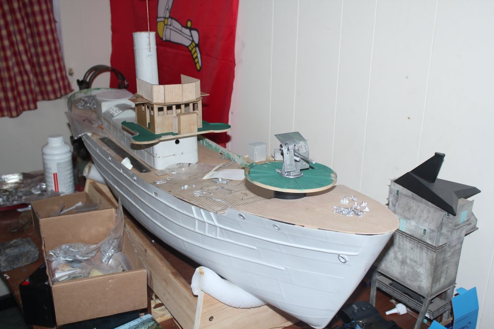

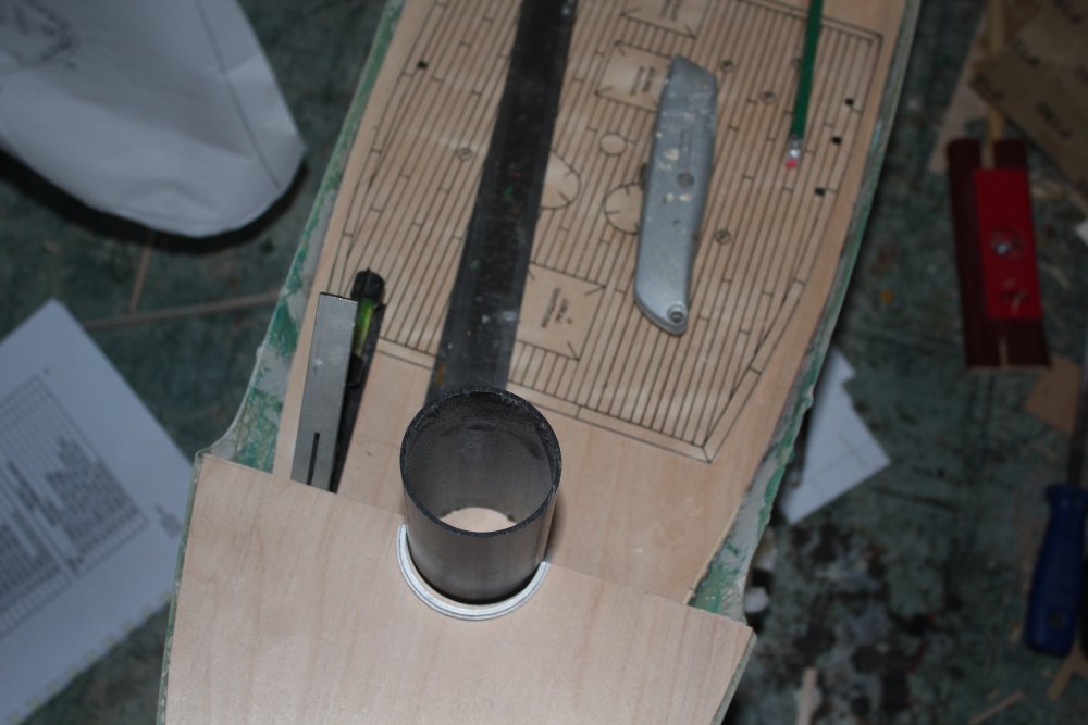

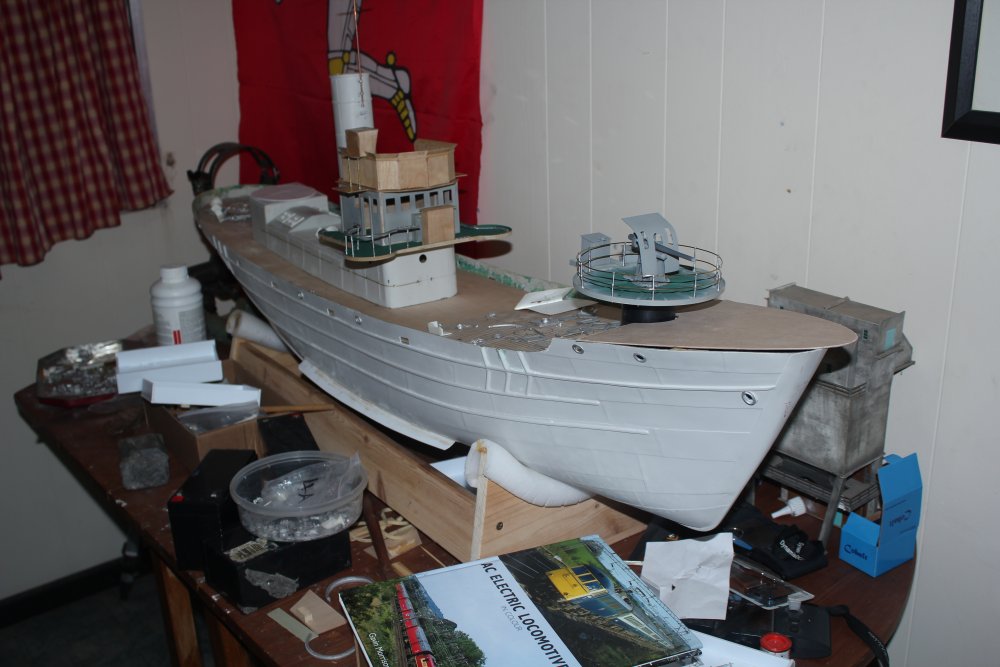

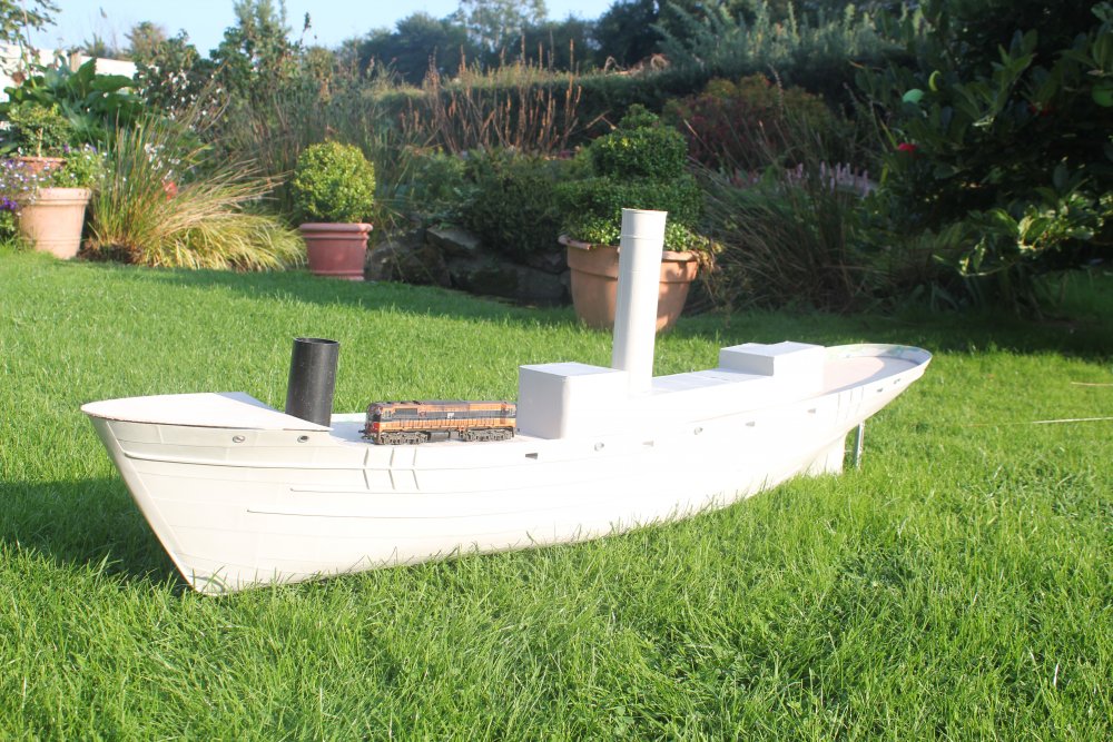

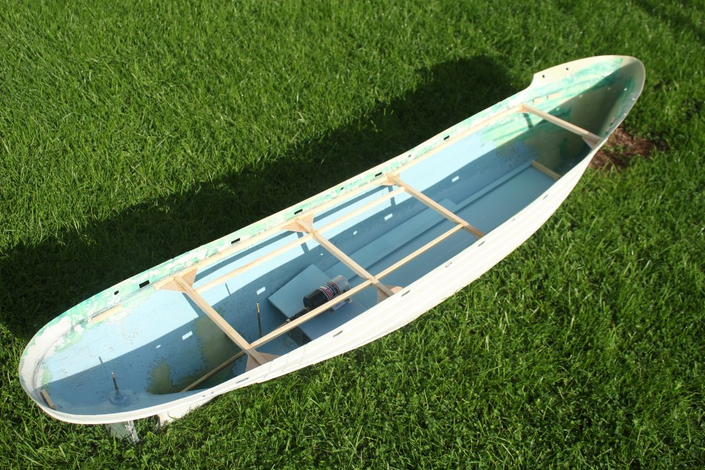

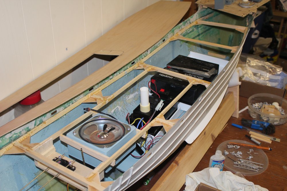

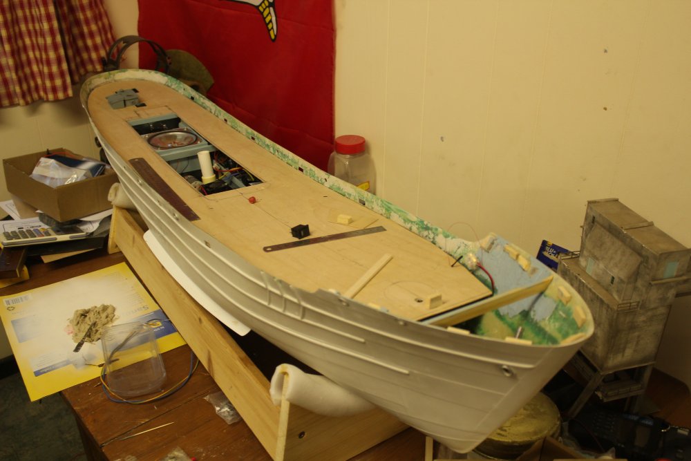

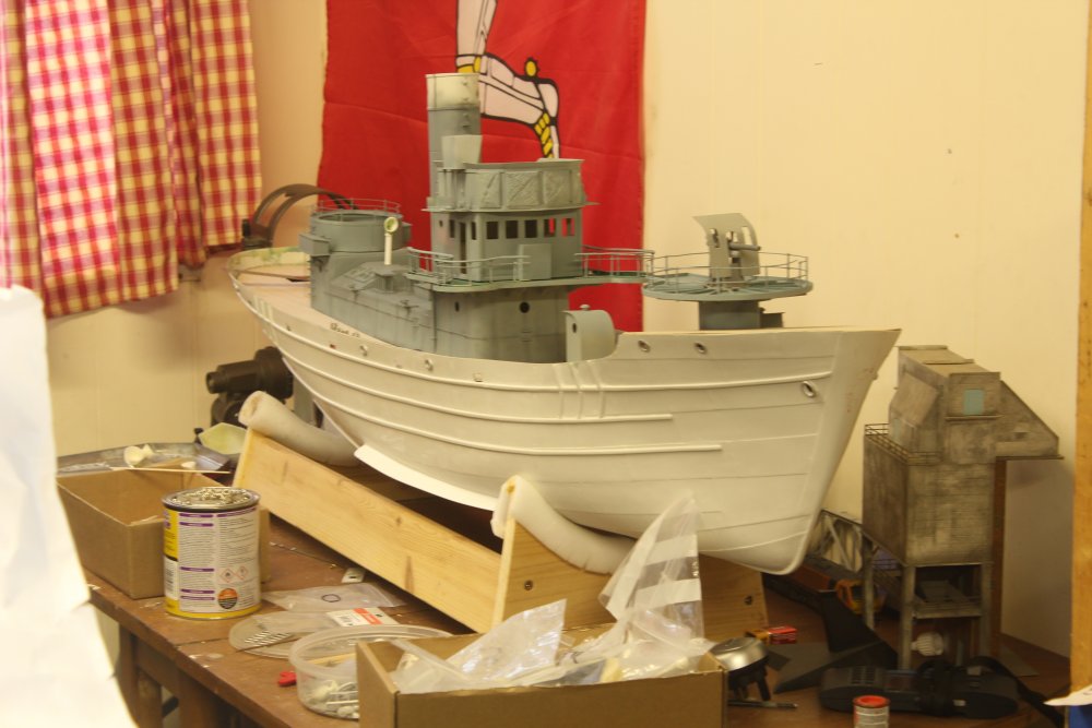

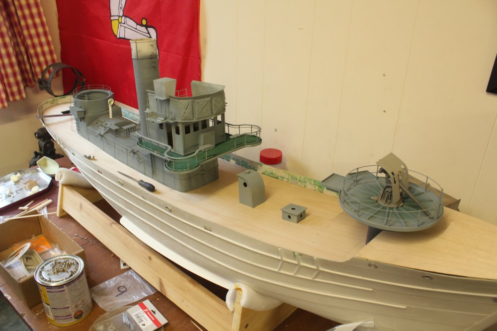

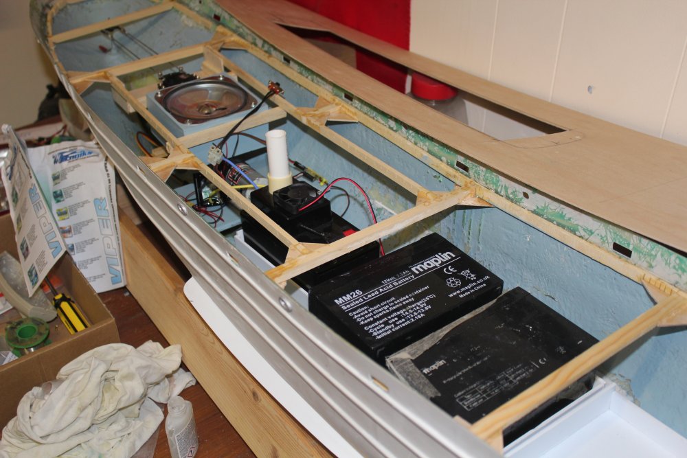

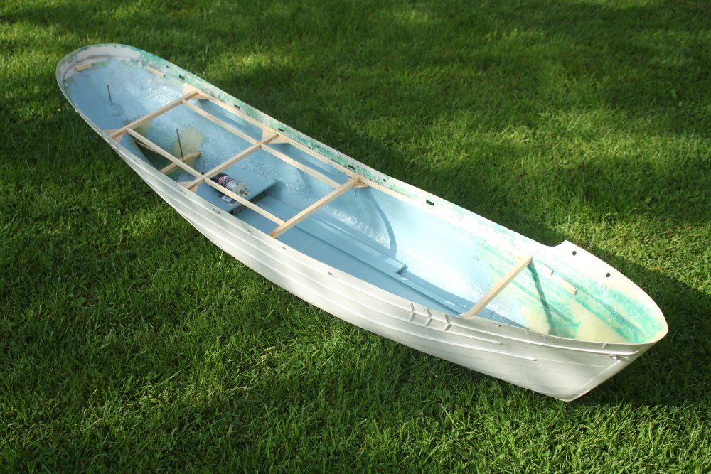

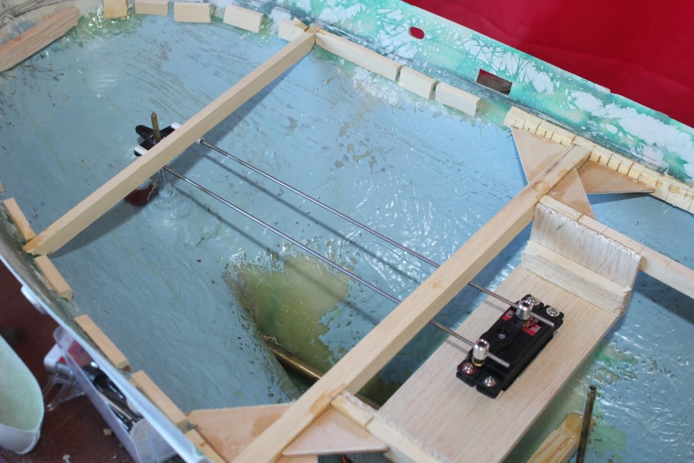

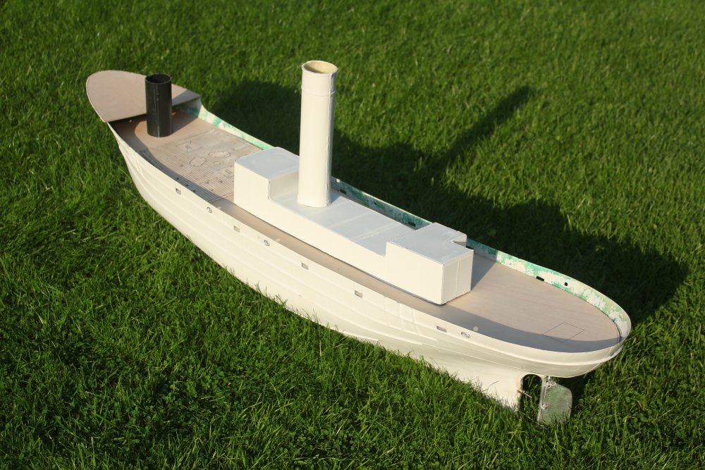

Rumbling along on this one, most of the work being done outside as the model is so big.

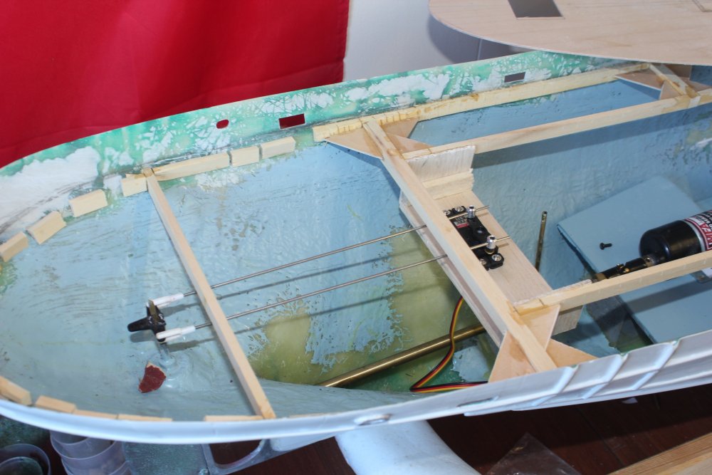

Deck supports mostly in, Motor and shaft Secured, Battery and weight tray has been made, I will be able to slide batteries along this using the guides on each side.
Deck and superstructure just plonked on for a test fit. Note the 071 for Size comparison

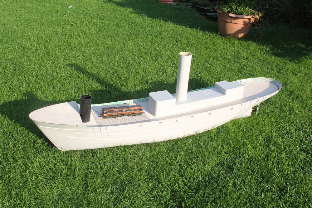

Hi Lads,
while me 121 is busy running in I thought I might update this.

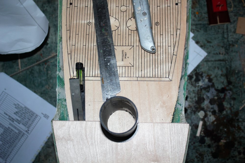

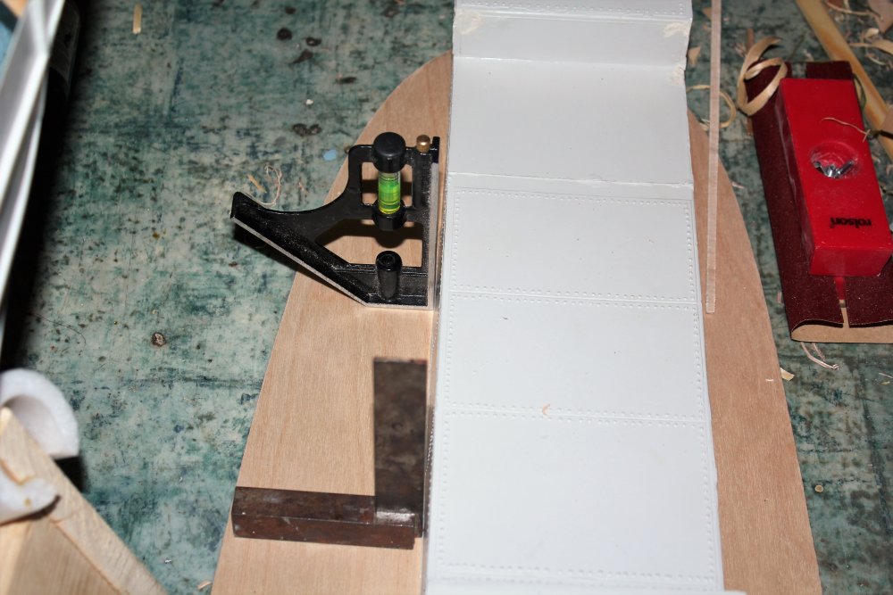

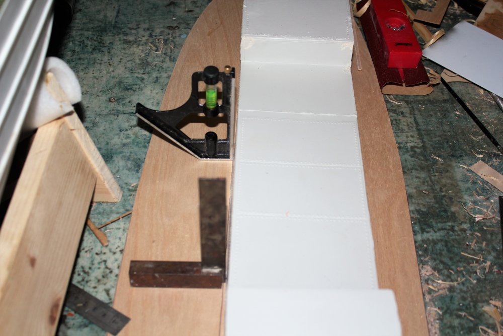

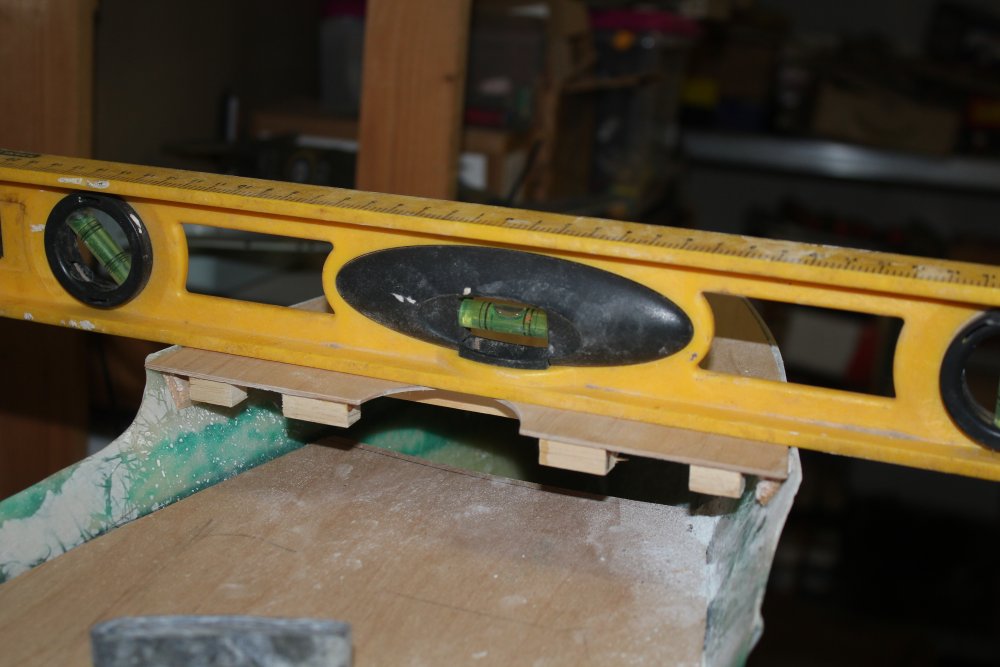

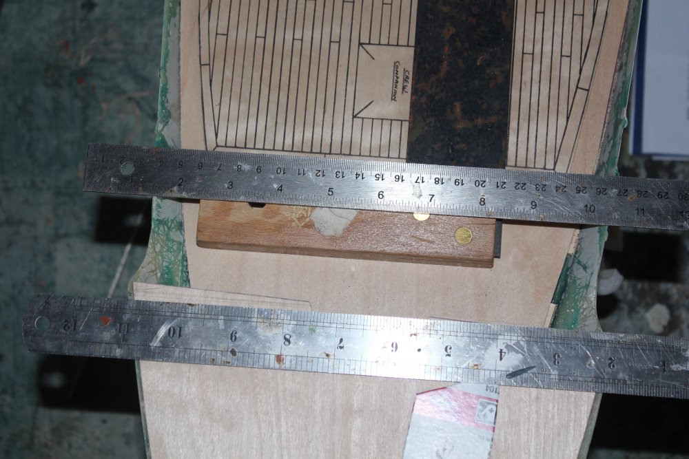

Tipping along on this one and I noticed that the hull is not symmetrical, there is a about a 5mm difference and you can see this here with the ruler, after some thought I decided to re profile one side with a file to it would be square to the other. being a boat and you can only see one side the difference should not be too noticeable, not much I can do about it any how.
I was just about to cut the access hatch for the main deck bit also notice on side of the fiberglass superstructure is splayed out about 4mm, I will have to think about how to fix this now next, Will it be surgery or a simple brace but I will have a combing in place so a brace may not be possible. Arse anyway,

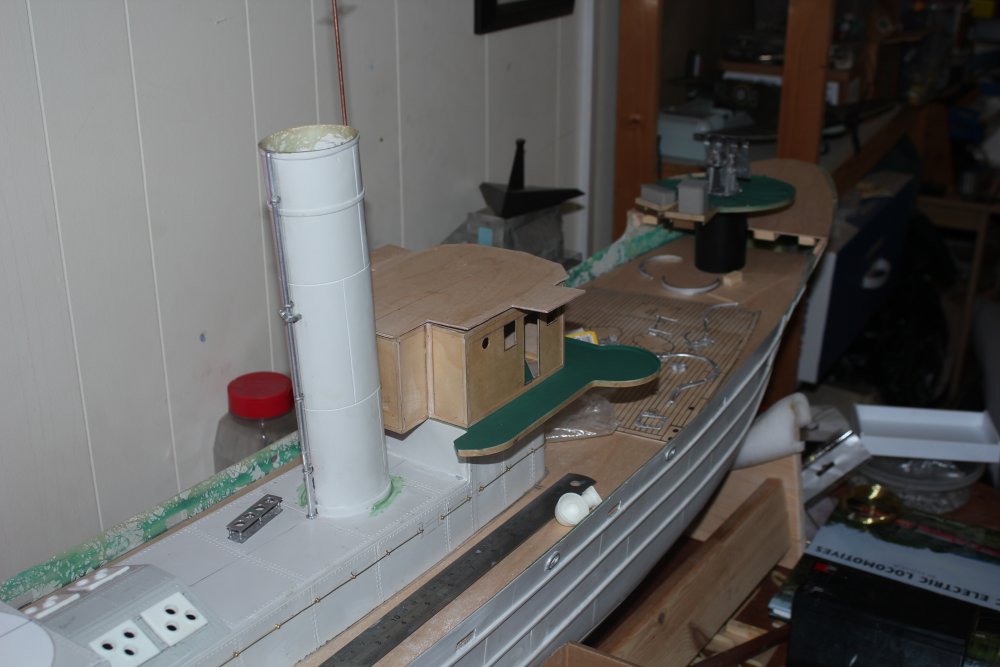

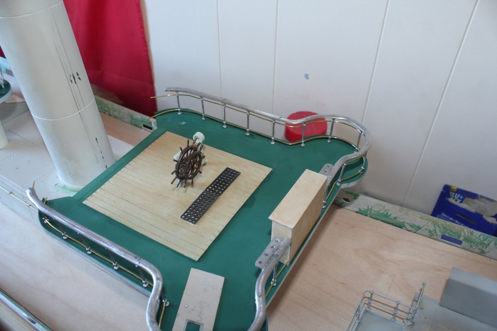

Still Waiting for the Sound unit so the deck cant be glue down,

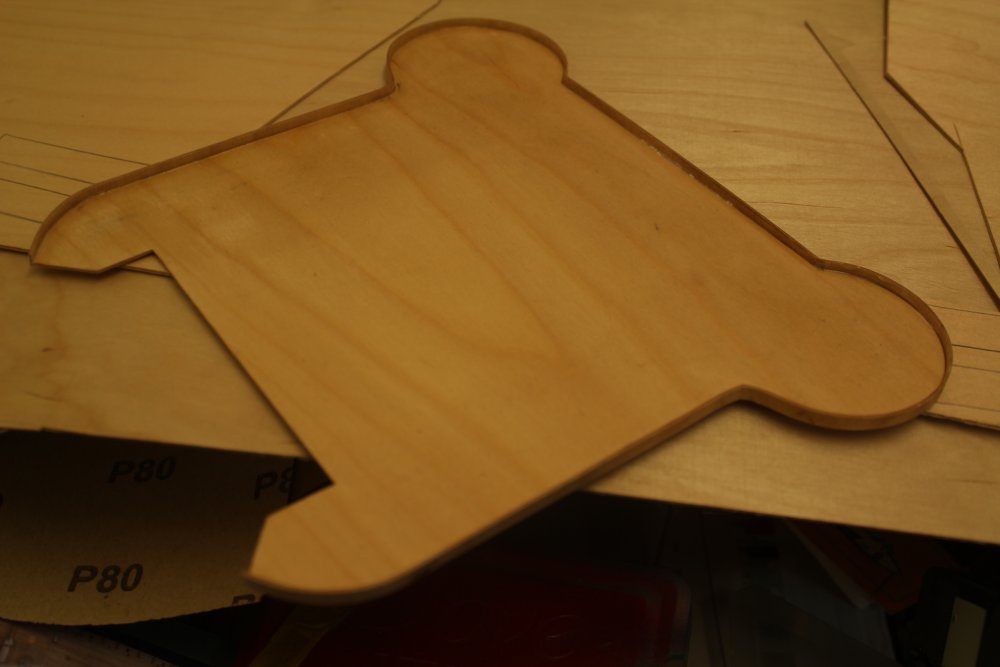

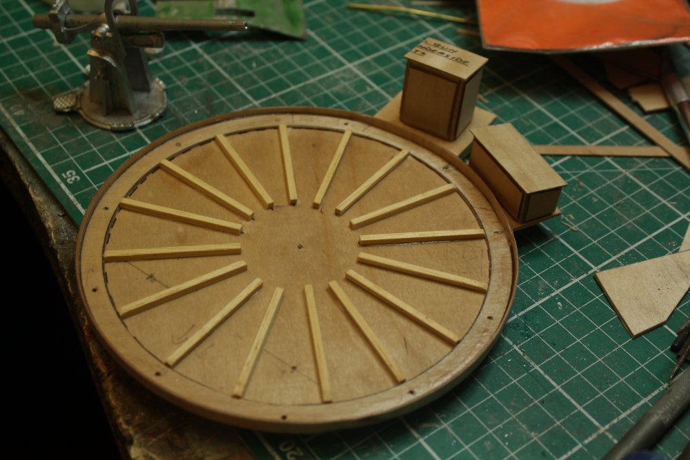

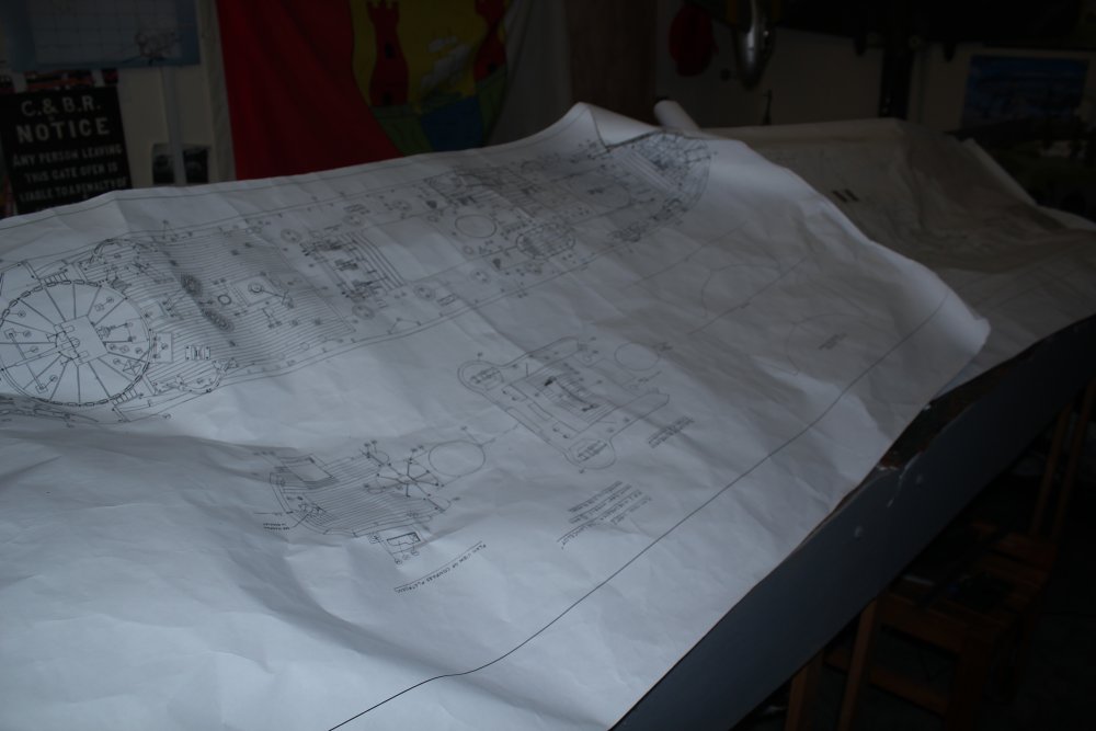

The Compass deck is mostly built, Need to put on another coat of paint and the windows and doors, The  bridge about is made up along with the Bilge keels.  White strips on side of hull, The plans along are 12ft long!

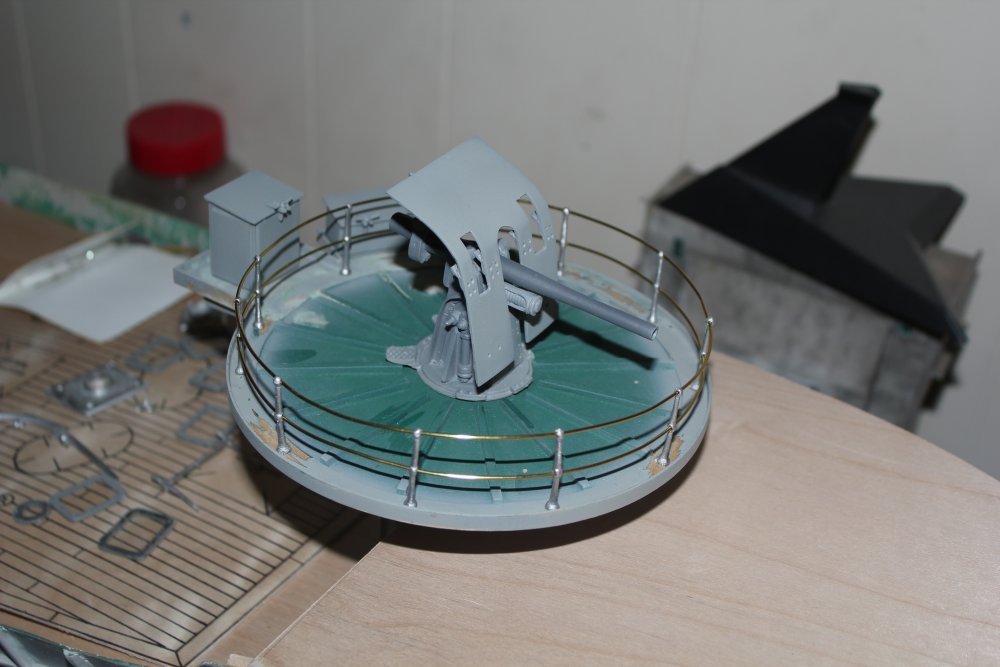

The Font Gun platform Railings went on during the week.

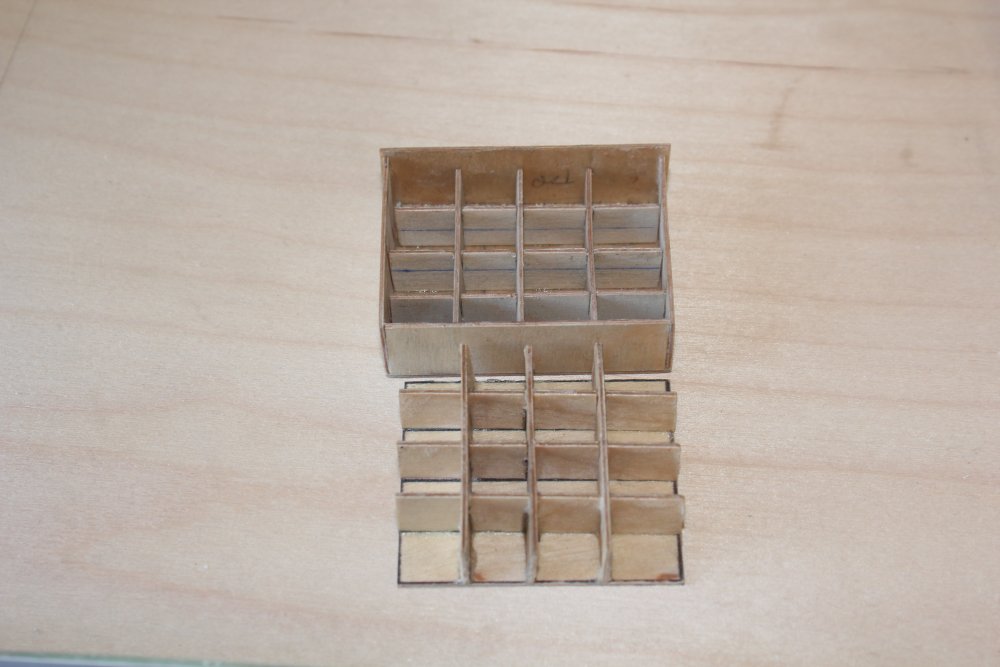

Some little issues when you cut out the printed sections and make them the end result ends up wrong, IE the Flag box  on the green platform is too small and should but up against metal hand rails so will have to cut out and built correctly.

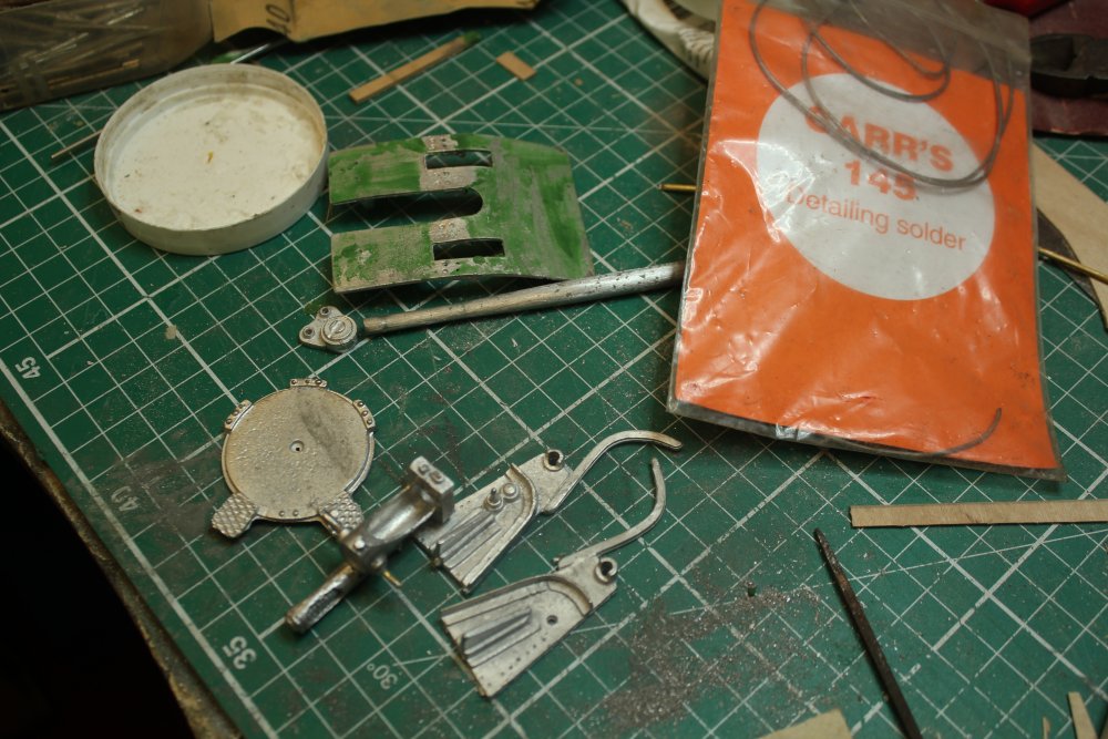

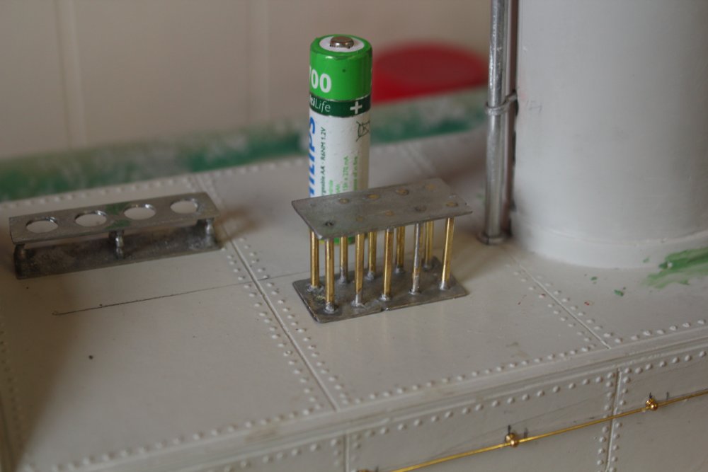

Also it been flipping Baltic in the shed these past weeks so not even venturing out much. Bit Mild last night so managed to escape and spent 1.5 hours soldering up the 1 life belt rack, Brass rod cut up to 25mm lengths  and white metal top and base. Wooden top to be cut next. The Lifebelts go in between the brass rods.

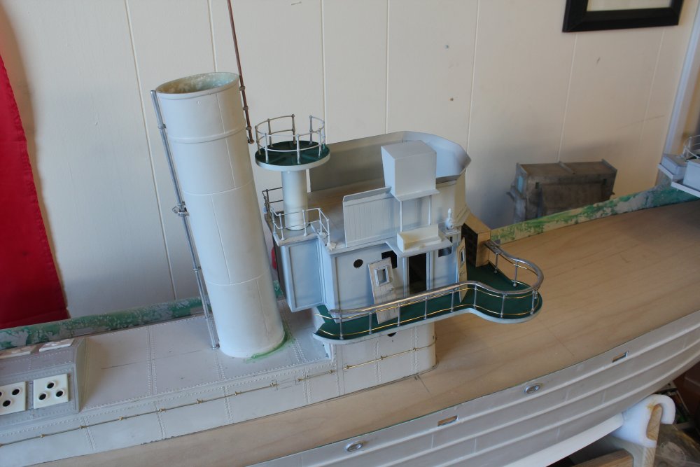

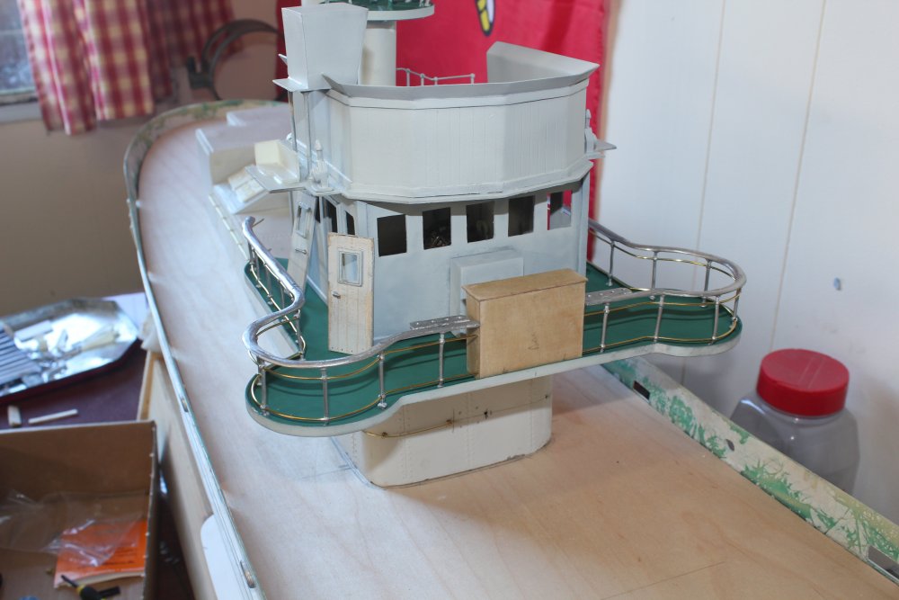

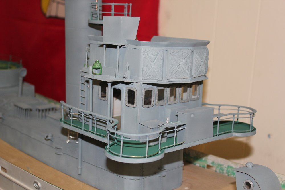

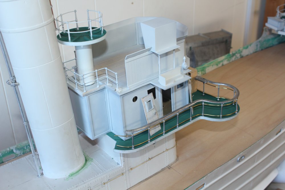

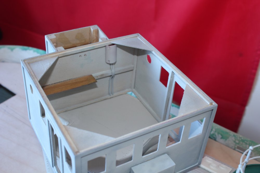

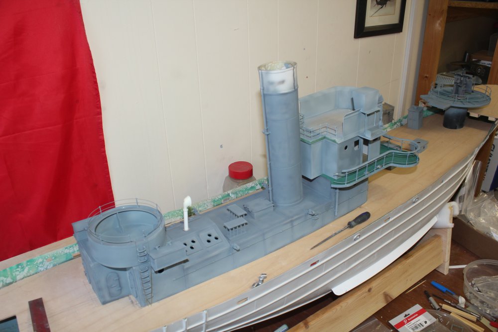

Slowly working away on this now the nights are a bit warmer!

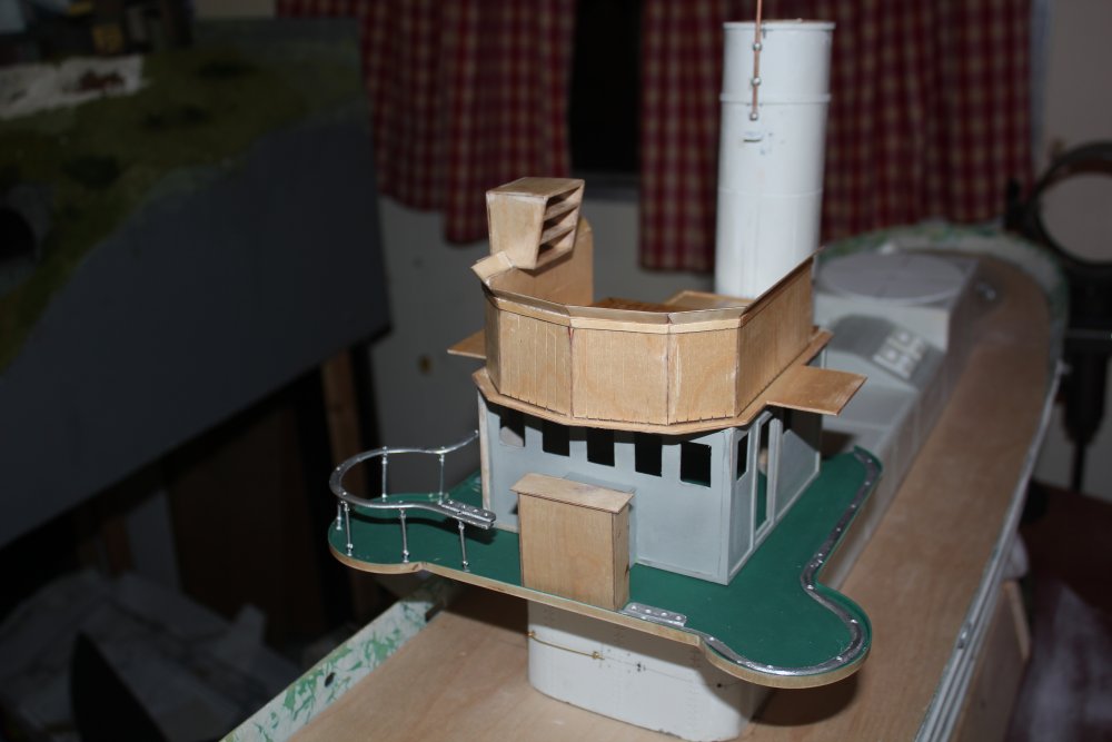

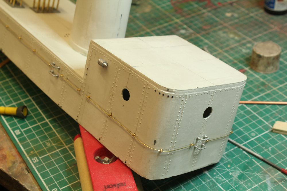

Tried a few different grey paint on this one and will settle of the grey shown here. I have put down a floor and scribed the floor boards on the ply and the Steering wheel and Steam powered wheel is installed and I will add some details in the wheel house walls to add a bit of interest not that there was much in there anyhow!

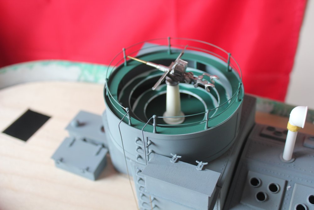

The Hand Rails took flipping ages to get right, Lots of curves and bends plus the White metal handrails were pretty badly molded. A new Flag locker was made as the one laid out on the plans was too small.
I either did not get the white metal steering arm or lost it so a plastic one was attached to the Rudder post, Hope it holds!
The Searchlight platform was also constructed.
  • Like 6

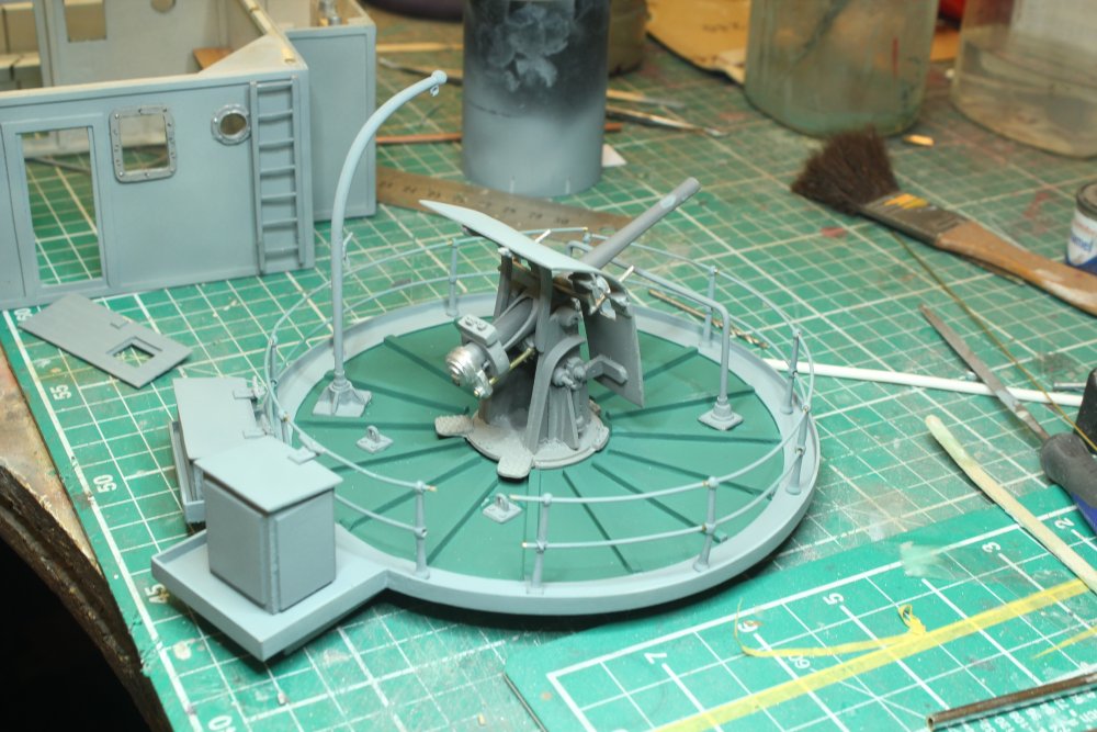

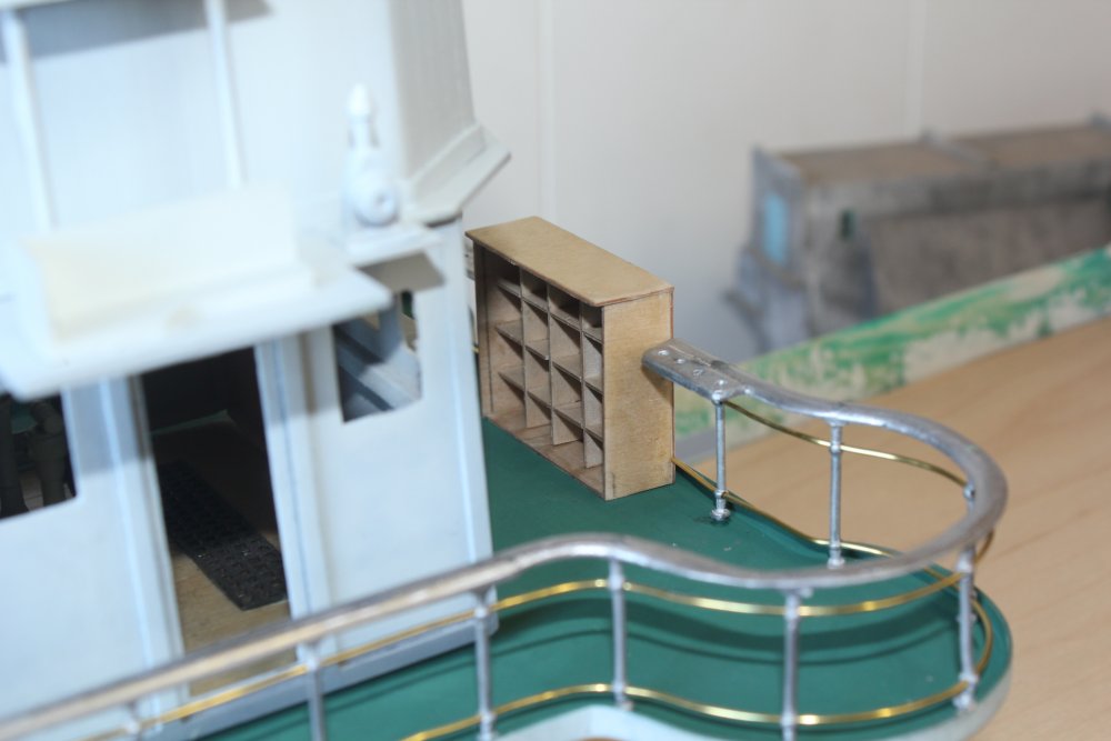

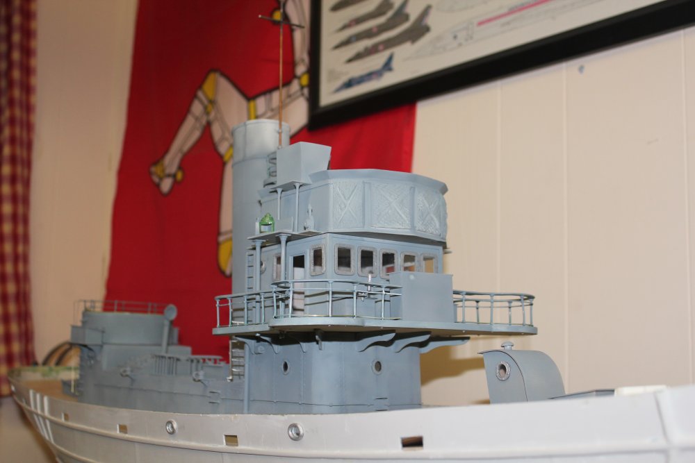

19 hours ago, Galteemore said:
Nice work George - what material is gun tub made out of ?

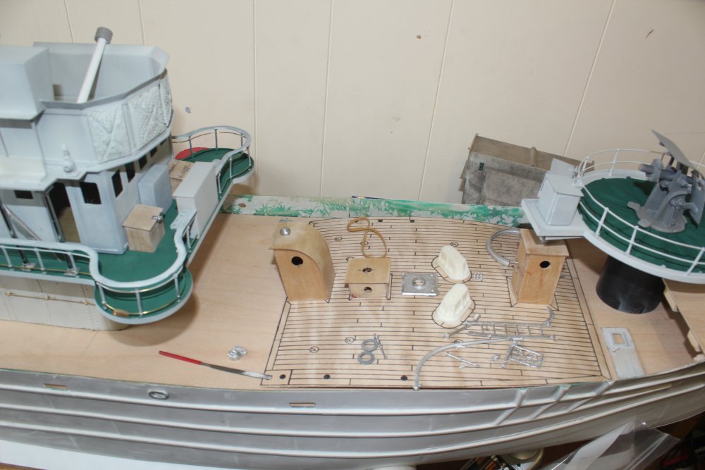

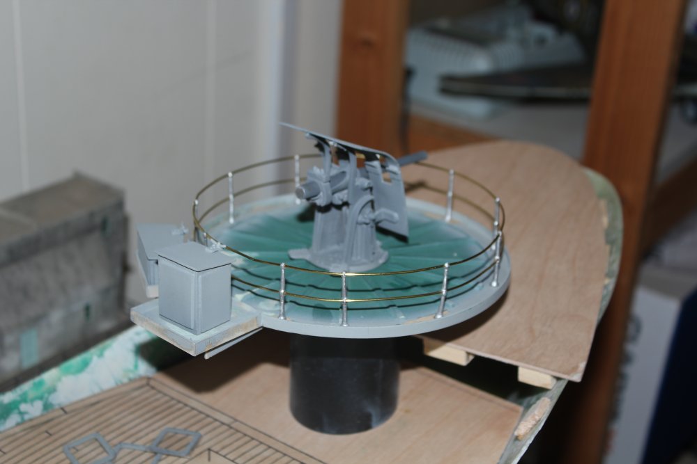

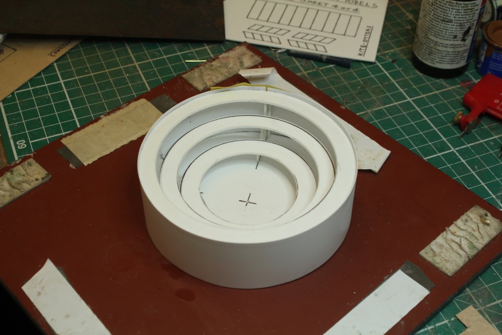

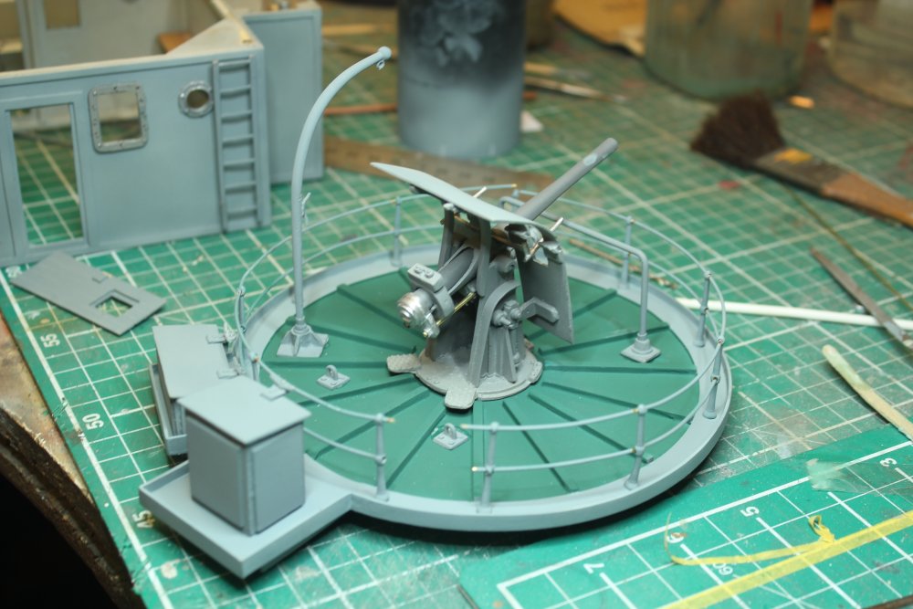

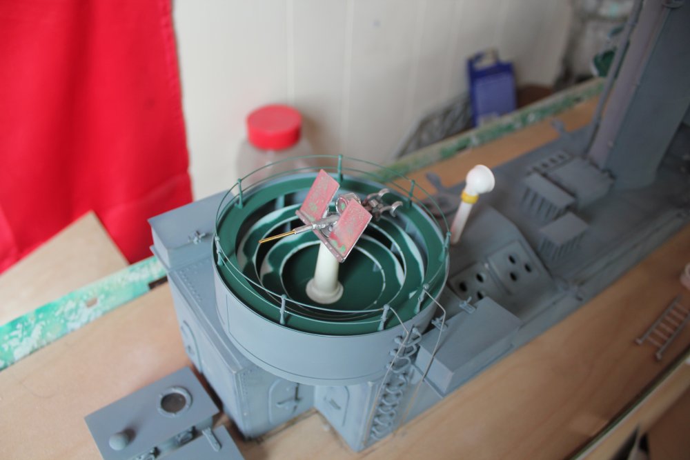

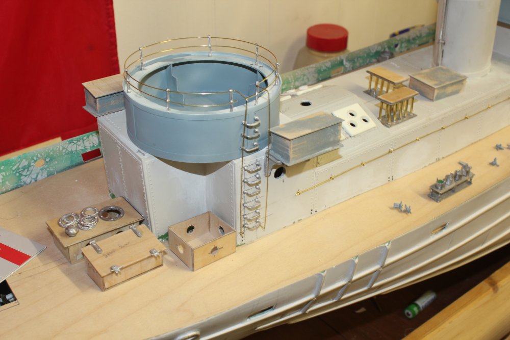

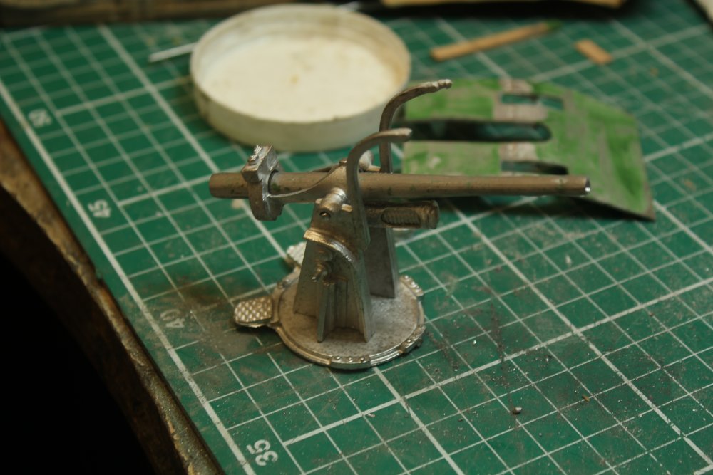

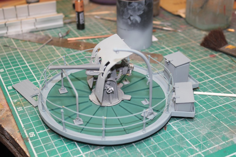

Gun Tub is Styrene Galtemore, Quite pleased on how it turned out TBH! Here are some more pics showing the stowage boxs and the Companion ways build, Sealed and sanded ready for a splash of colour. Its starting to look a bit busy now!
  • Like 6
Link to comment
Some bits came through from Blighty today, No Customs so managed to save 20 notes! Speaker, Relay switch of the Searchlight, Power board and a variable speed Fan unit. Got a nice surprise from Marks Models to, Will be having this with a cuppa at 9PM
Also the grab rails and Stanchions with handrails were done for the gun tub.

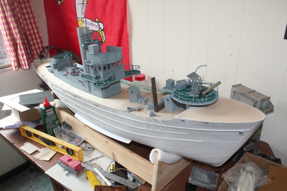

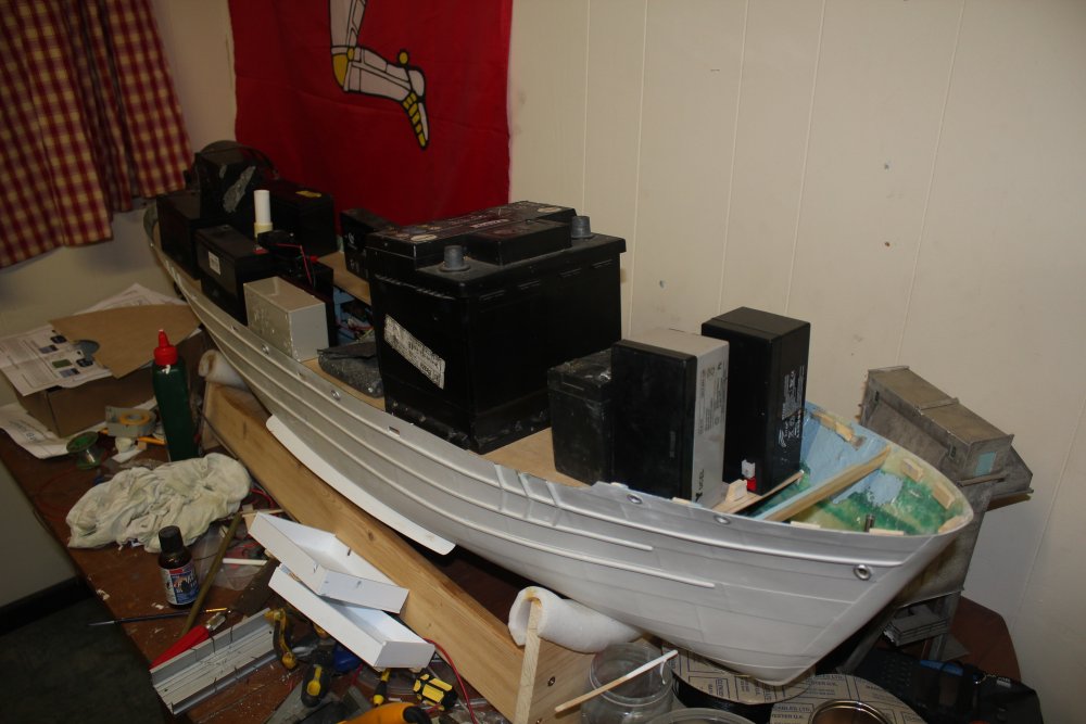

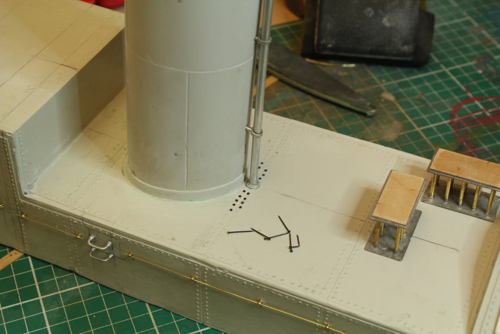

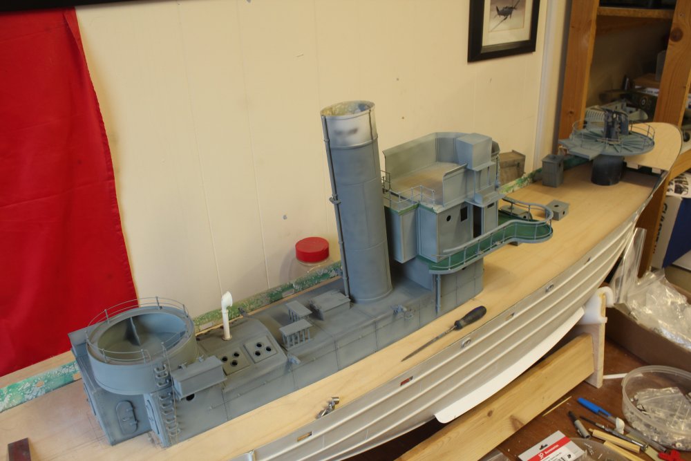

With a week off managed to tip away between the Garden and the Shed so a good jump in progress.
I had to replace the lost rivets and used snipped Peco track pins for the Rivet heads.
With some consultation and research I have discovered these ships were painted in Home Fleet Grey which was a much darker shade which now makes the ship more sinister and war like! Humbrol 145 was used, initial coat with pre shading done.
  • Like 5

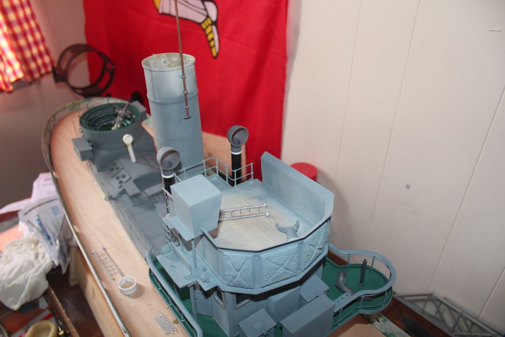

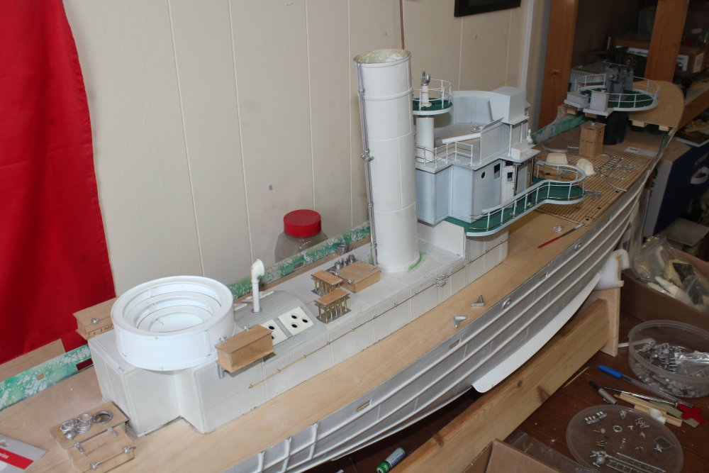

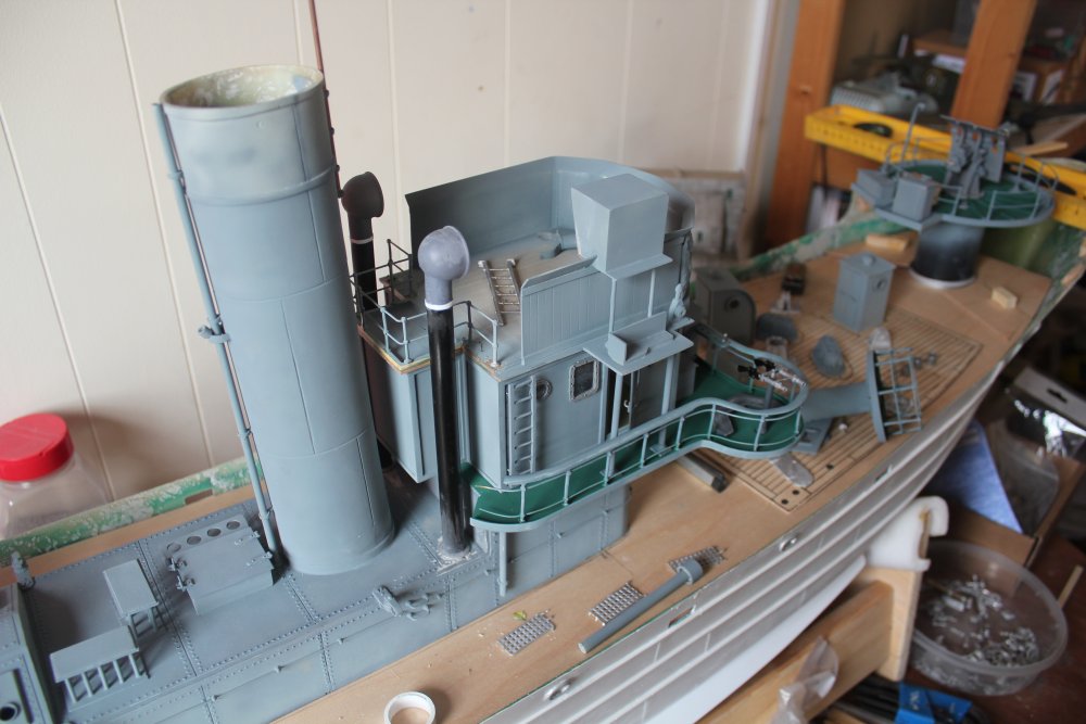

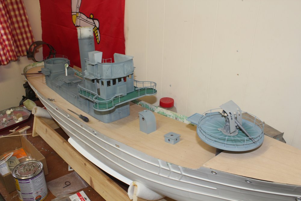

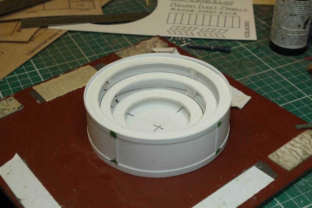

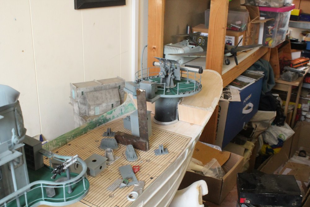

And the Boat Yard is on O/T this week. Windows in, Gun Platform more or less done
I need to get better cowl vents and the ones supplied are just very poor and too thin to tidy up as per the pics and the hole that has appeared in the one I tried to do.
and the leccy stuff is being worked on and where best to place what is needed where, Although it is s huge hull the batteries and smoke unit take up
Edited by Georgeconna

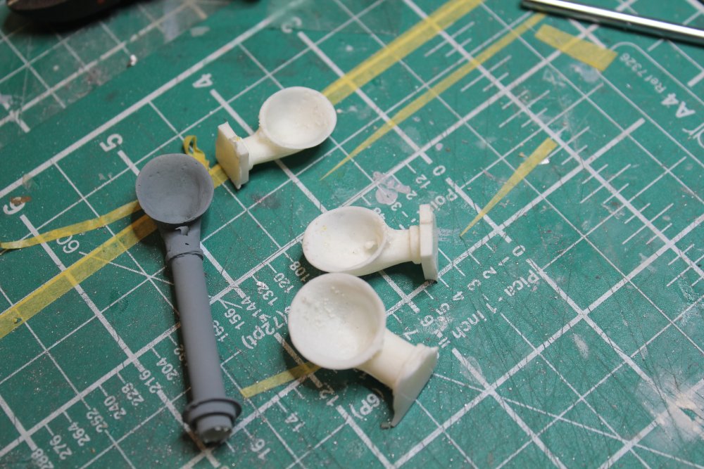

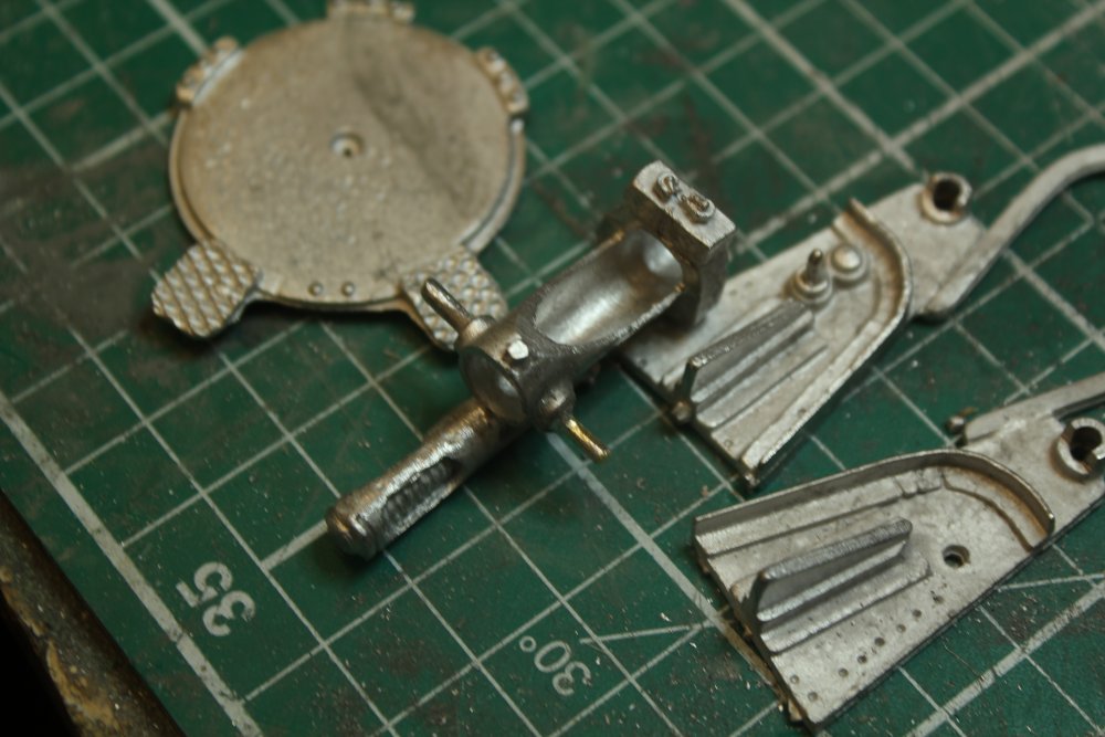

Still working away on this one, Lots of tidying up with the white metal parts and my order from Cornwall Model Boats arrived with the replacement cowl vents which look fab, I think they look to be 3D printed.

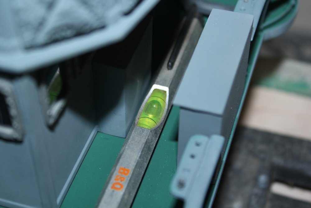

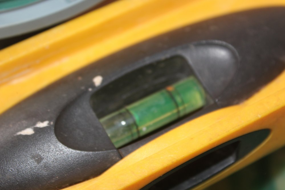

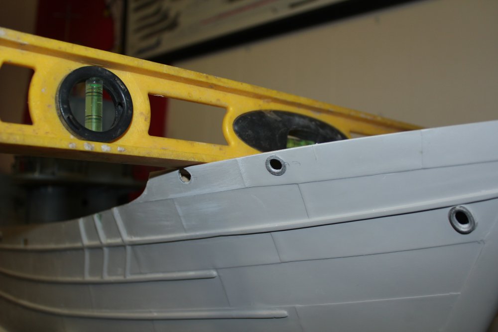

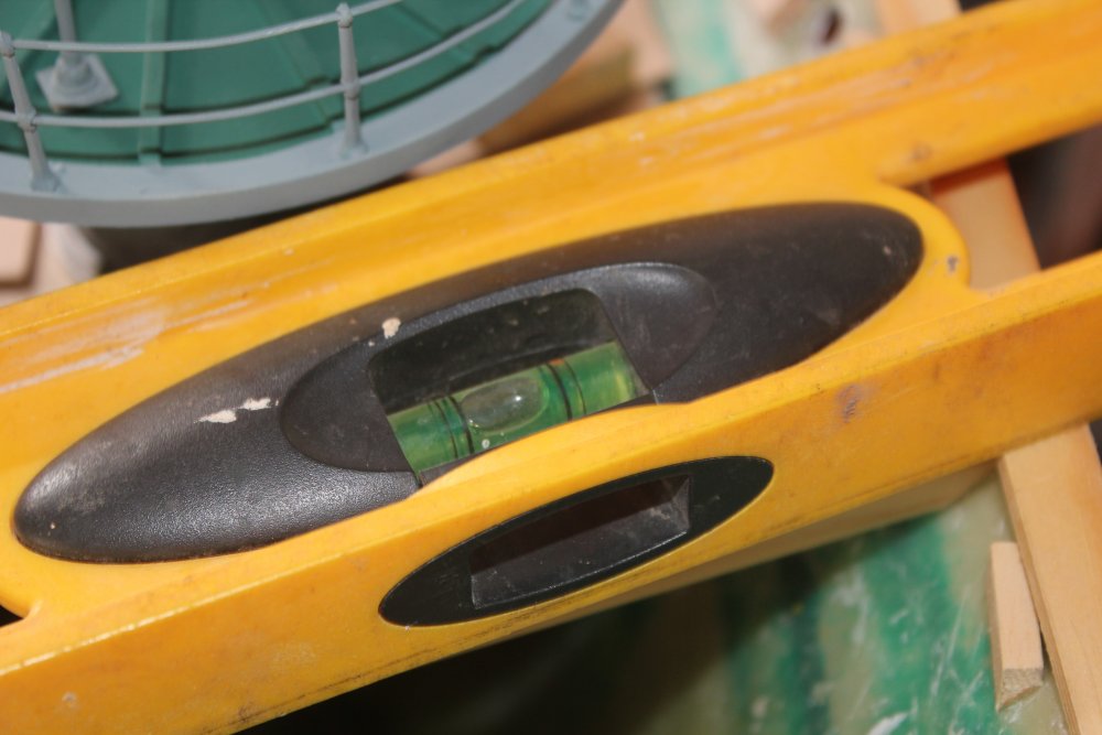

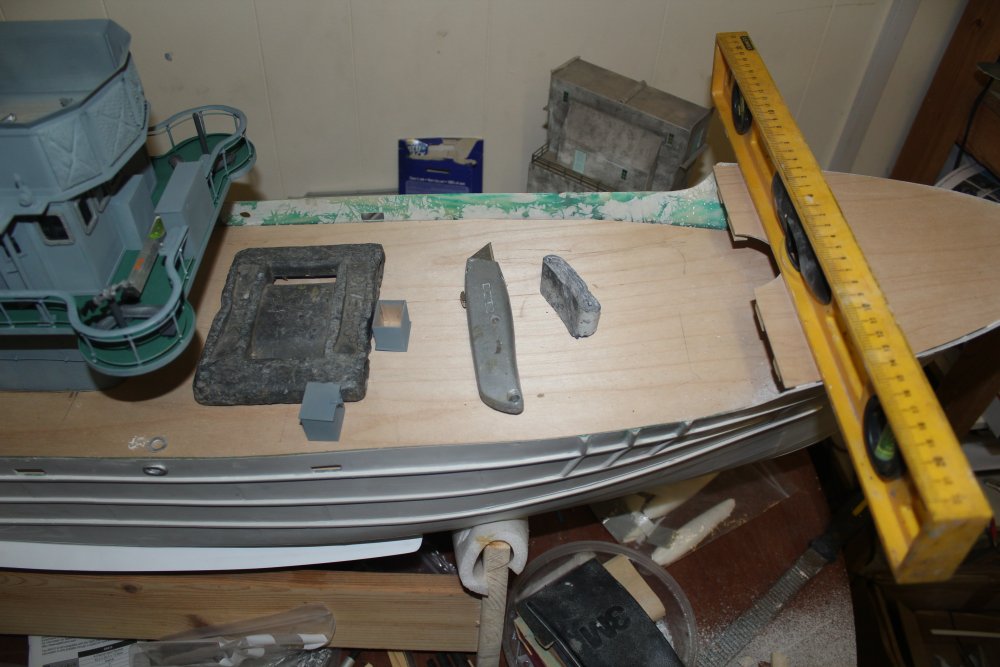

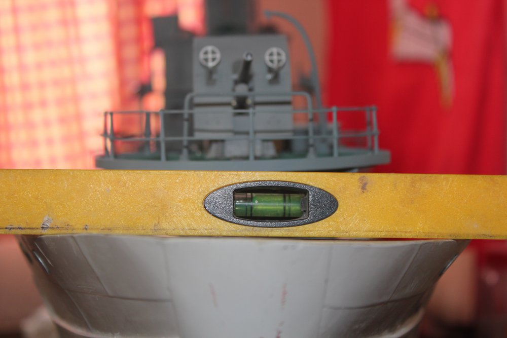

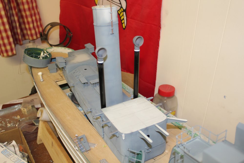

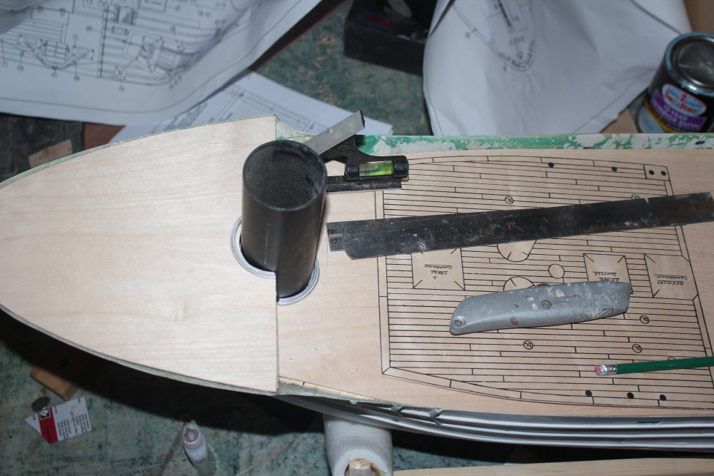

I was hoping to have the sound unit installed but these are not able from Action just yet so I have installed the speaker and I will work on how to install the other wiring but the next big step will be the deck and after placing all the bits n bobs on the deck I noticed something is just not right.......

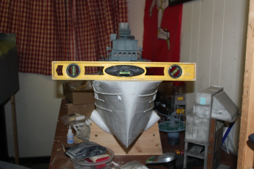

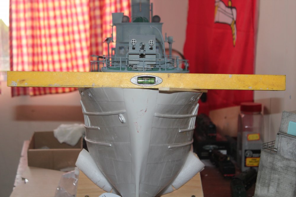

As per the photo I have the Main Deck Level as the bubble indicates (these are not calibrated BTW!)
Also the Superstructure stuff is not glued on so don't panic! (just yet!)

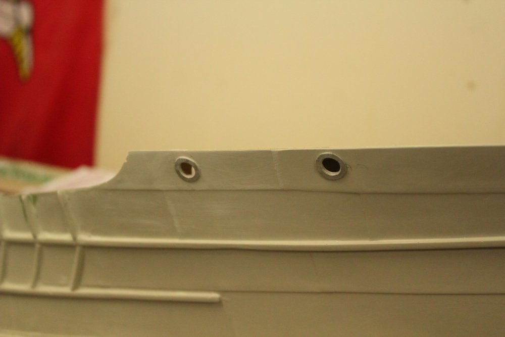

Its Alive!!!
Managed to bring down the port hole after lowering the deck, Happy with that.

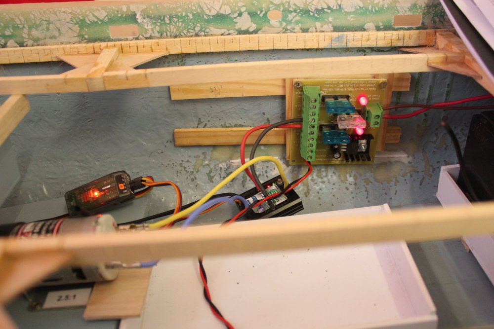

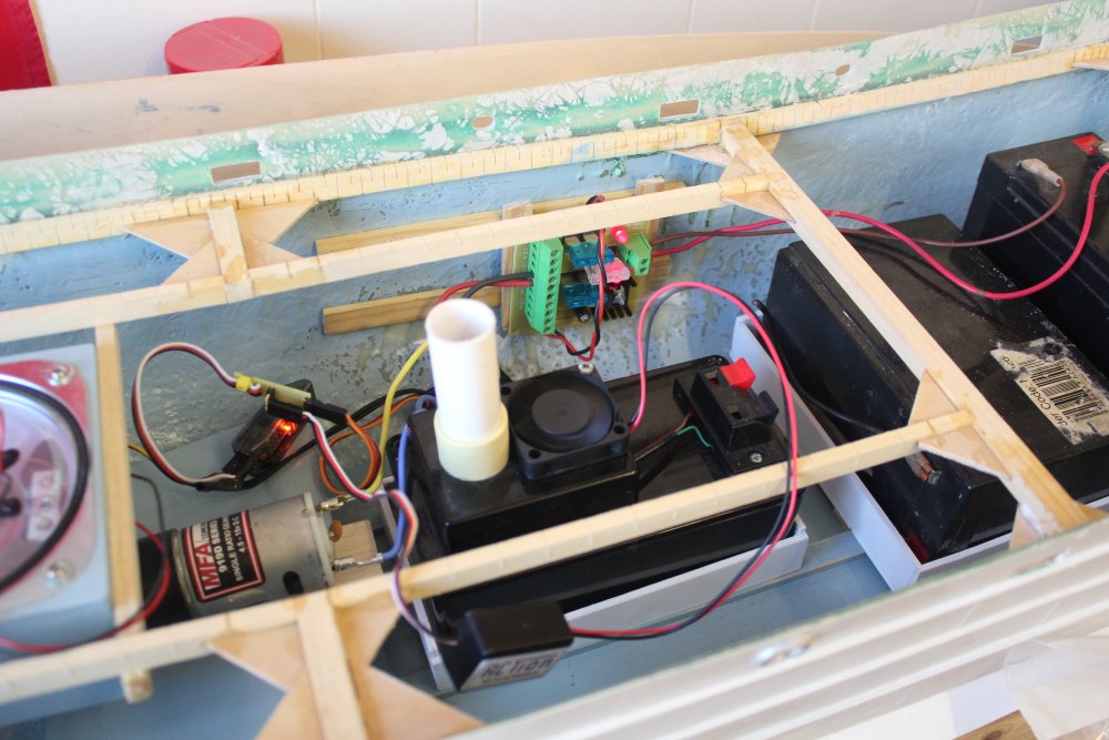

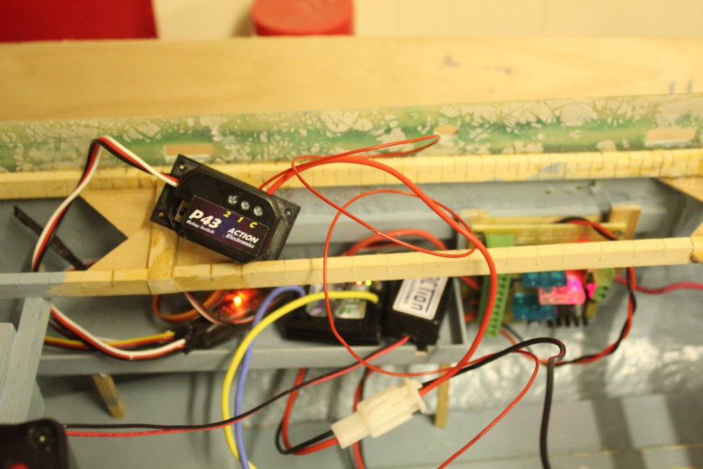

Leccy were being worked on today before I had to do some garden work and another change in the Receivers where they have an in built button to bind to the transmitter, No more little bind plugs! There is telemetry also on this receiver for 24 quid, Unreal price.
I have run everything through a power board from Action electronics, at first the there was no power, Lots of head scratching before I noticed to on off switch on the speed controller, Ah great, Went to hit that and the switch fell apart, I bared the wires and have power that way for now until I get another better switch.  I'll be making  little tray to hold the Receiver, speed controller and Fan control unit Another step forward now to getting that deck on.

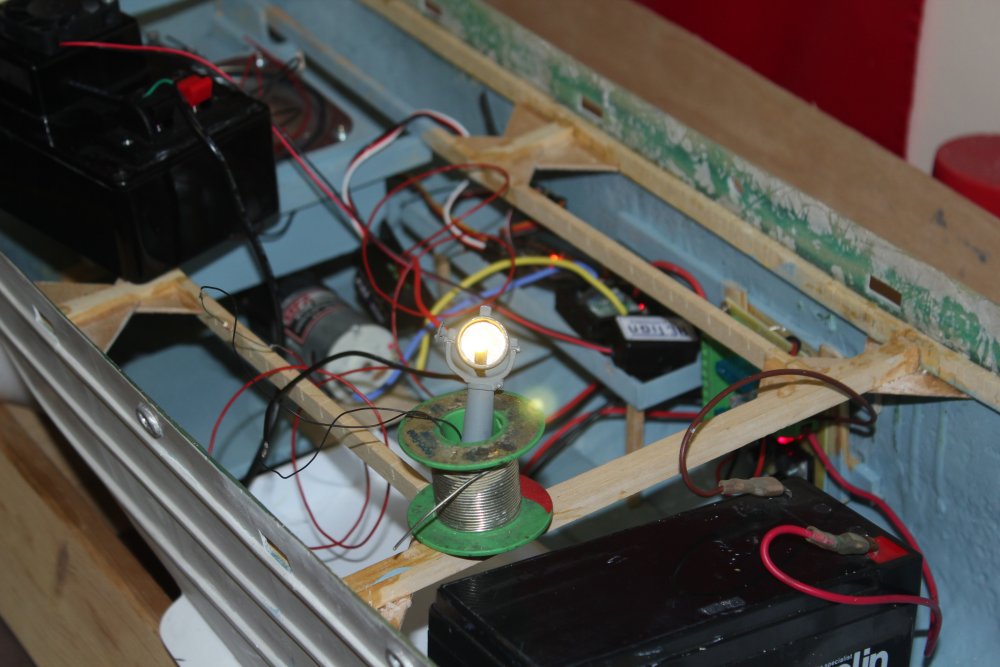

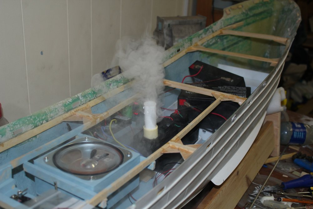

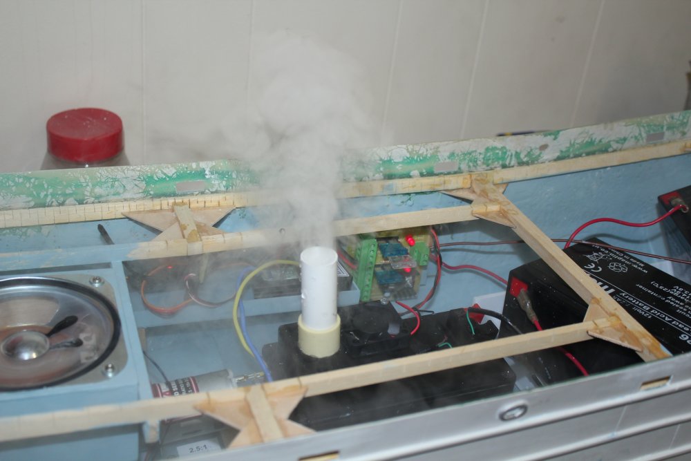

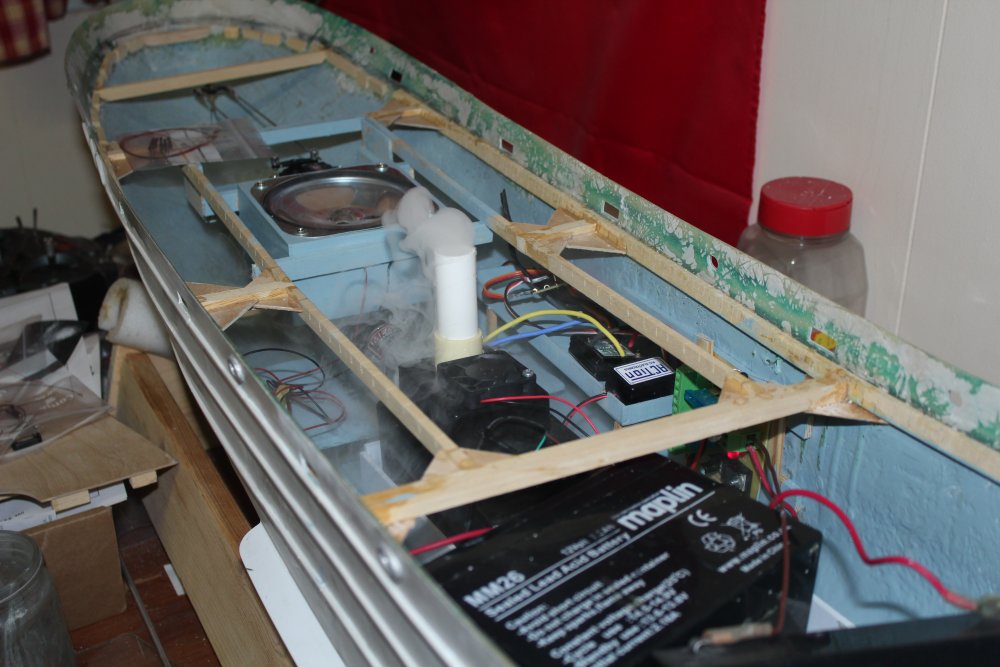

As the Red Arrows say during their display Smoke on Go!

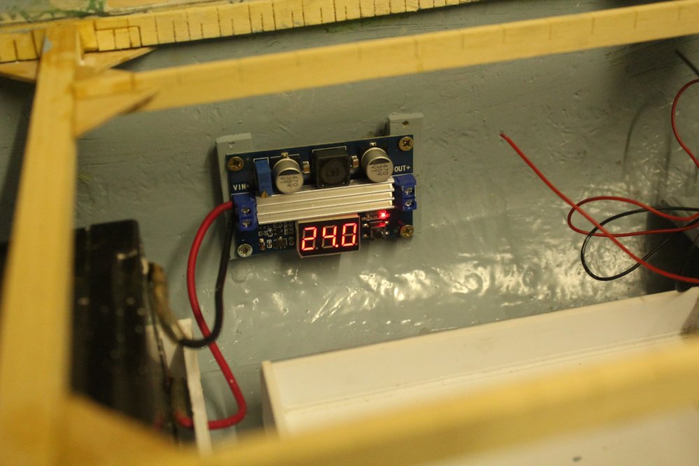

Step up 12 to 24V wizardry installed, Luckily I had a few spare as one or two have gone up in smoke. ran off a 12V battery it steps up the Voltage to run the smoke Generator which runs using water.
Need a tad more pipe though to run this up the funnel.
Link to comment

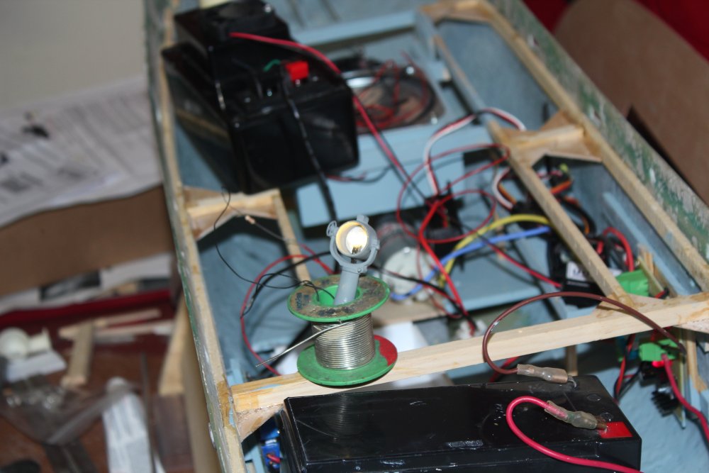

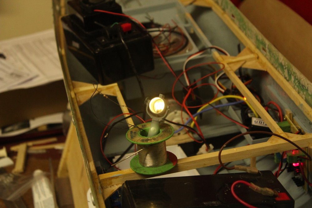

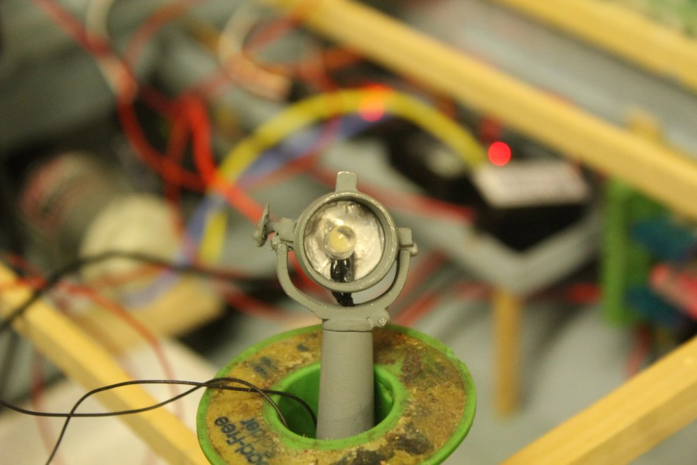

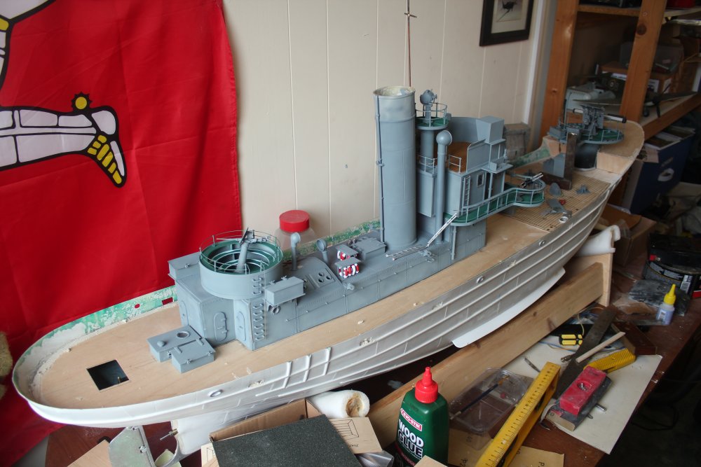

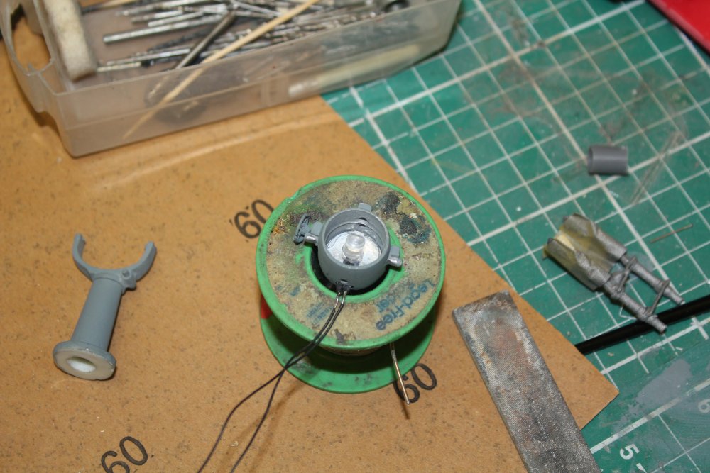

Work in the dockyard continues with some massive step taken, all the wiring is complete internally for the lights in the hull , Superstructure, mice little Prewired LED were installed.
Also work on installing a Bright LED into the Search light and this was completed and tested as well as a Reed switch operated by the transmitter, its not latching so I used the off option with the on happening at the flick of a lever on the tranny. At the rear of the light Silver foil at the back was glued on to give a Mirror appearance.

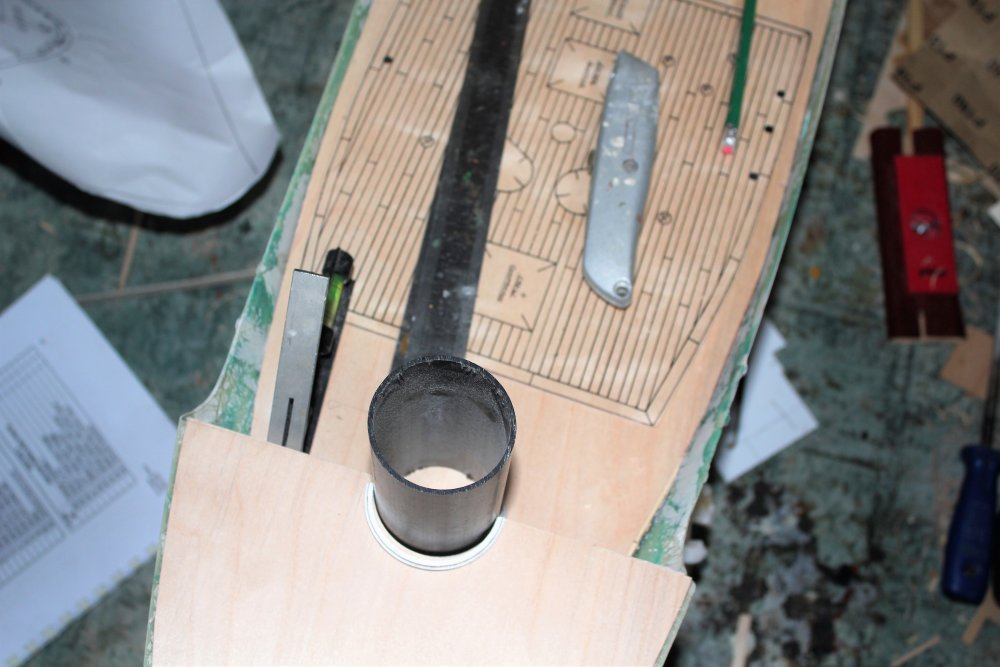

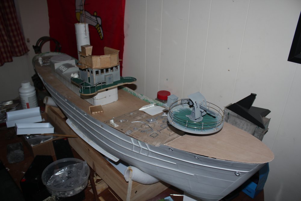

And finally I plucked up  the courage and decided to stick the deck on used copious amounts of wood glue so the next step will be to probably paint the hull and then to the Deck Armour plating. Flying along here!

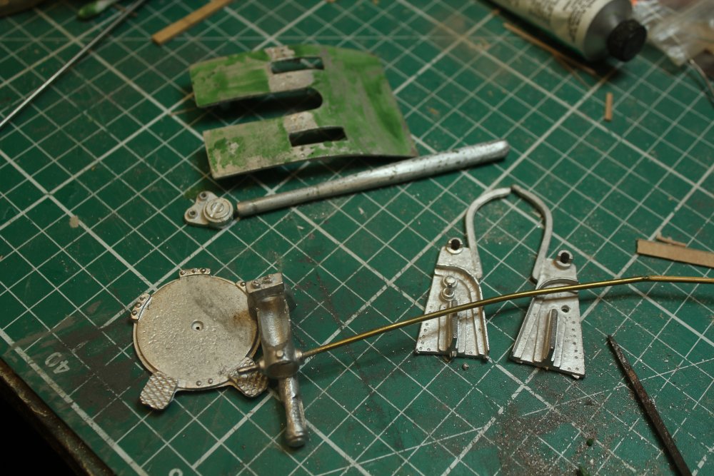

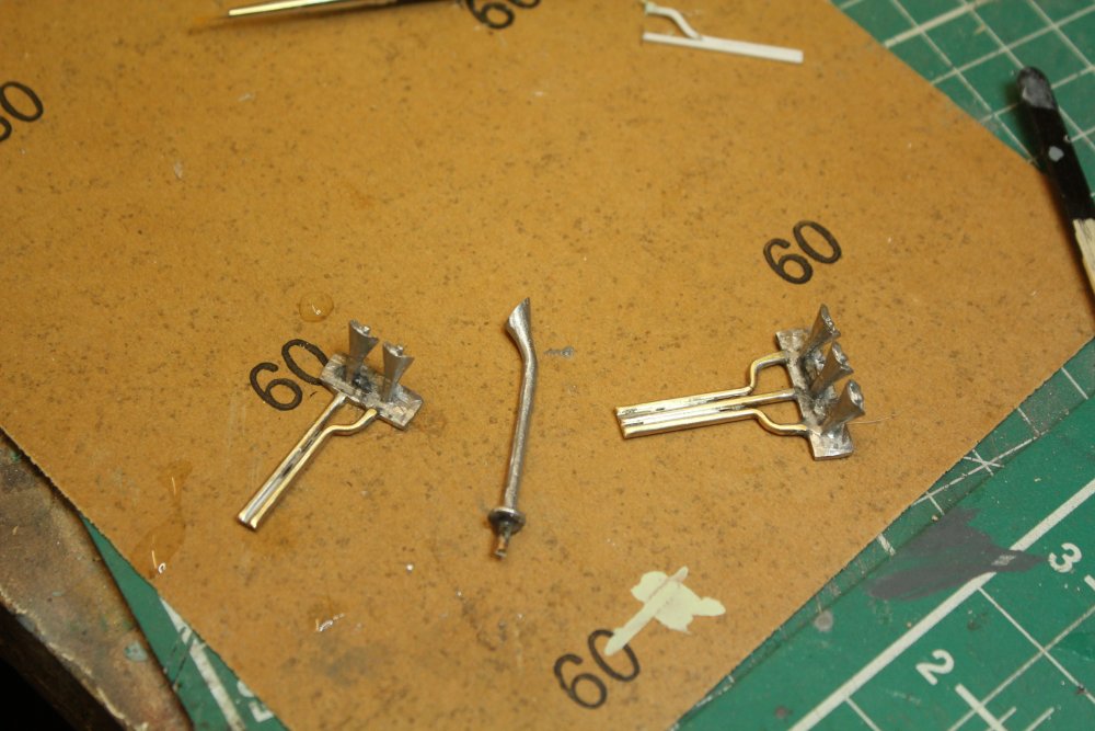

Well that went well except I glued a LED wire under the Deck and a cross beam but that sorted now and the little Light rewired and the LED working under the Bow which will look nice on Sailing a dusk which I have never done!

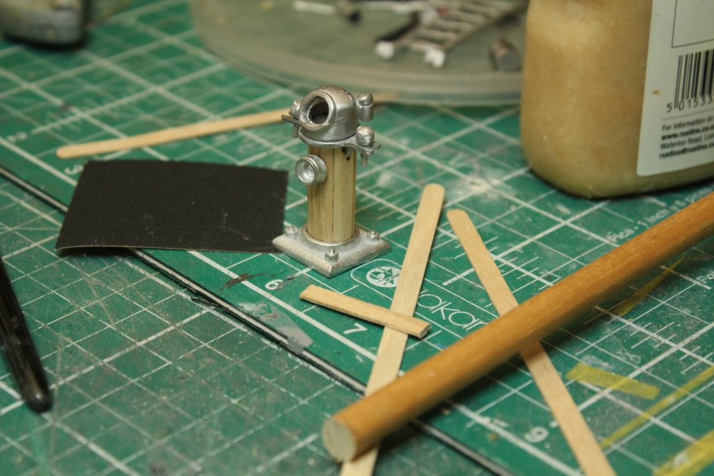

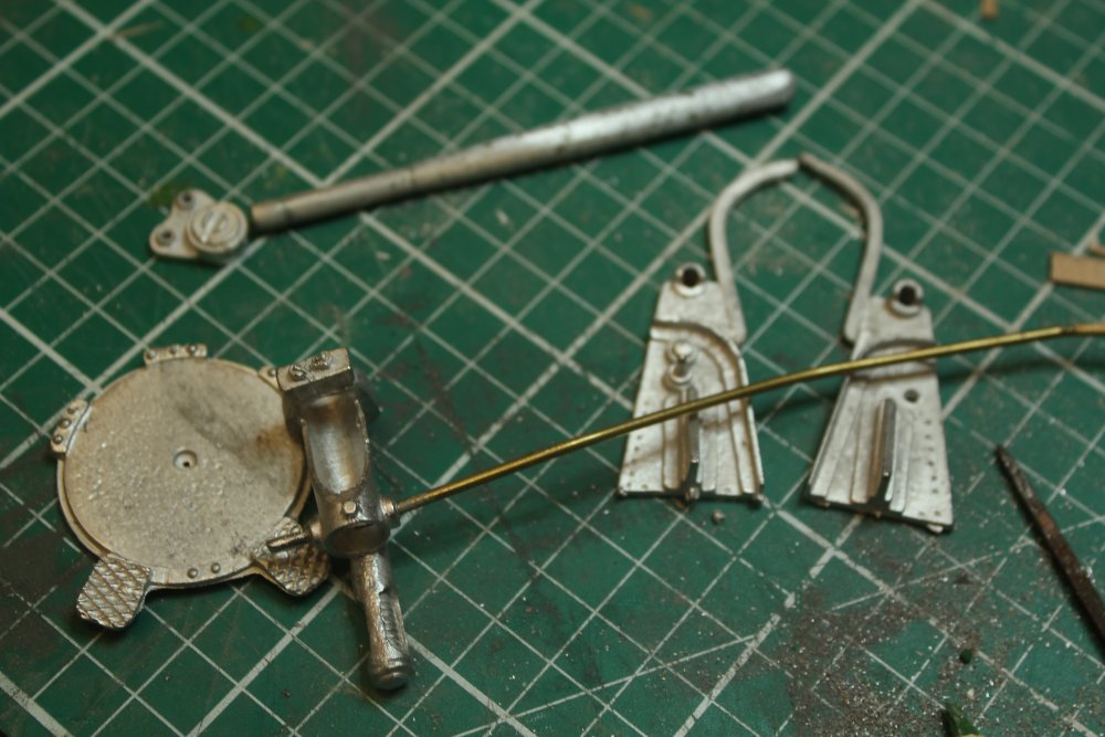

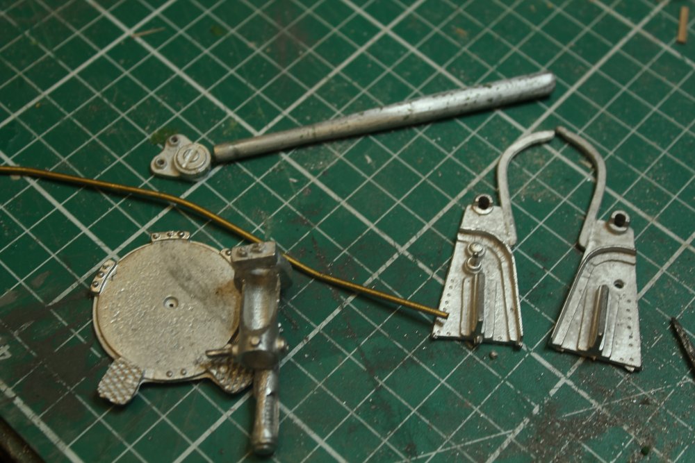

I then soldered up some White metal and Brass rod for the voice pipes for the Bridge and started on the Binnacle using some 9mm dowl and coffer sticks sanded smooth! Needs to be Paint next.
The Bow plate was also glued down with PVA and Left to Dry and then the edges were filled in with P39 Car Filler and then sanded smooth, Well the front part anyhow.
I need to adjust one of the tall air intake pipes and one seemed to of moved and has set slightly off which is a balls but thems the breaks!
