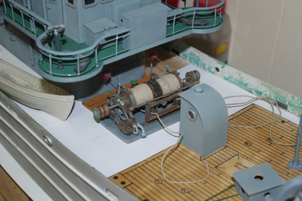

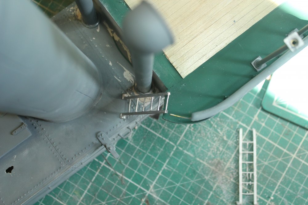

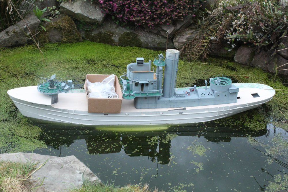

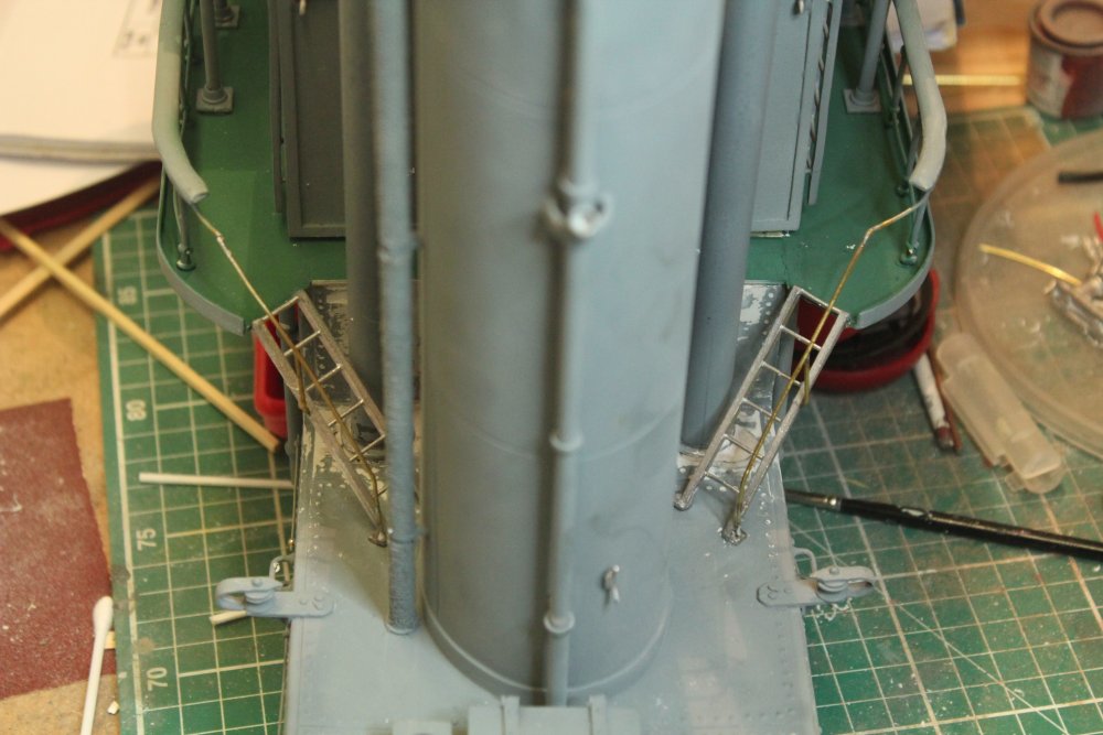

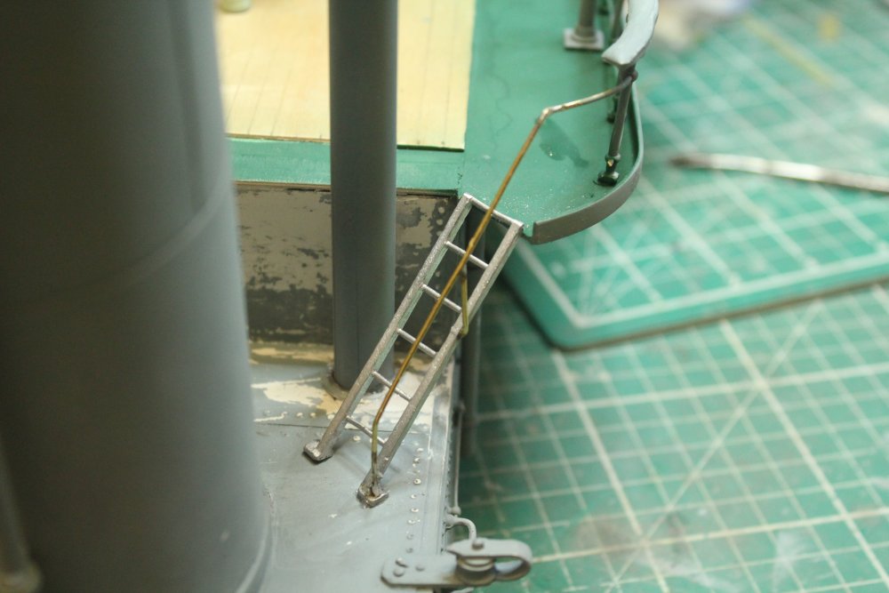

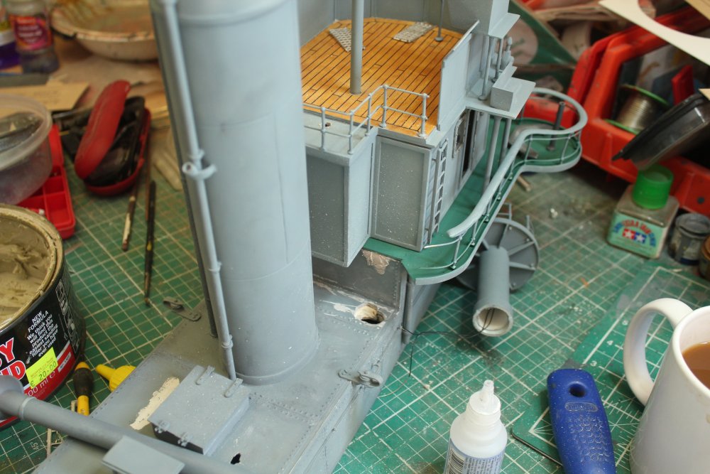

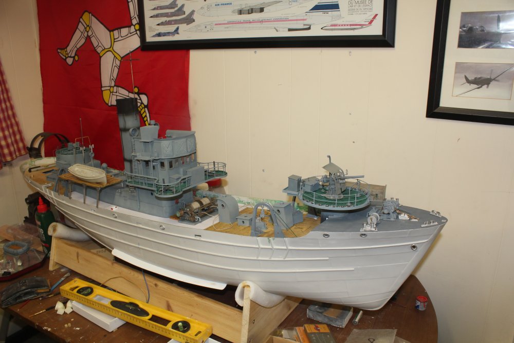

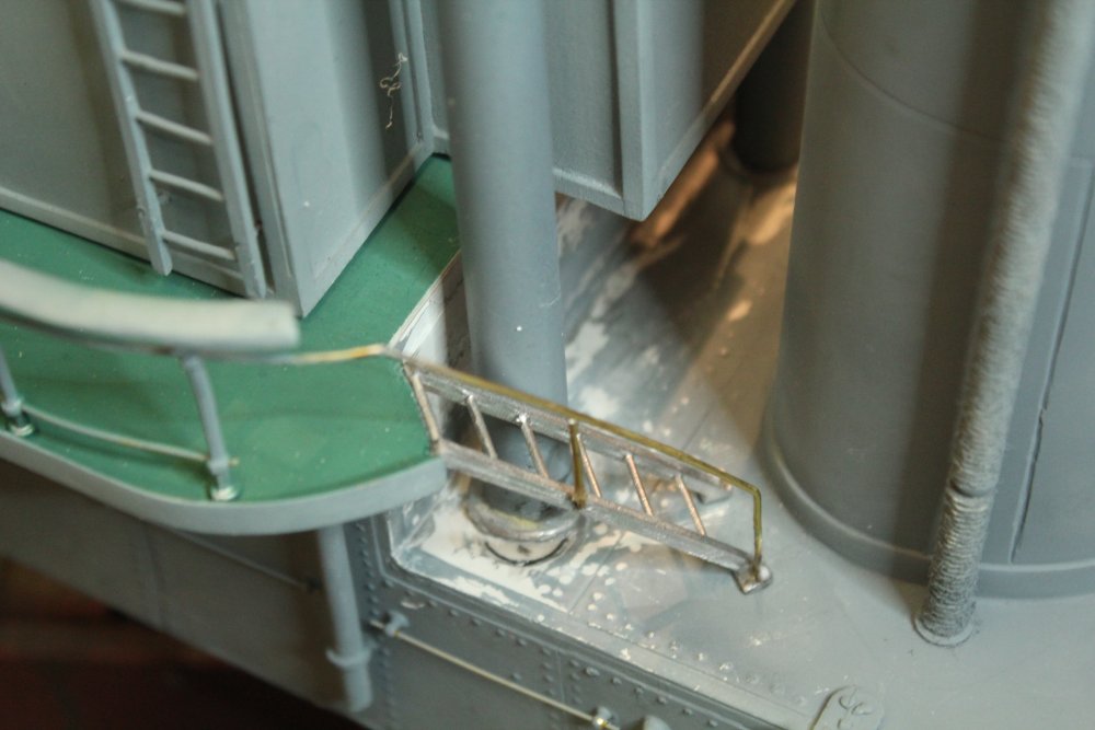

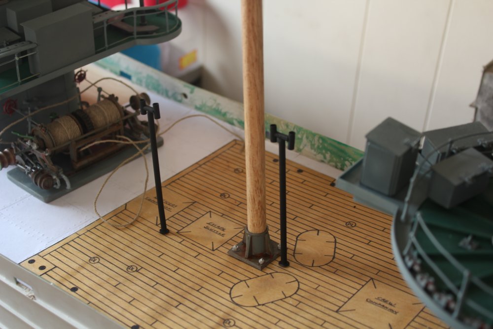

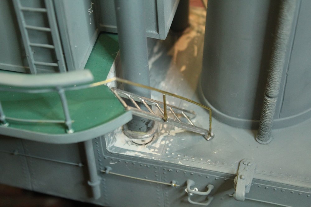

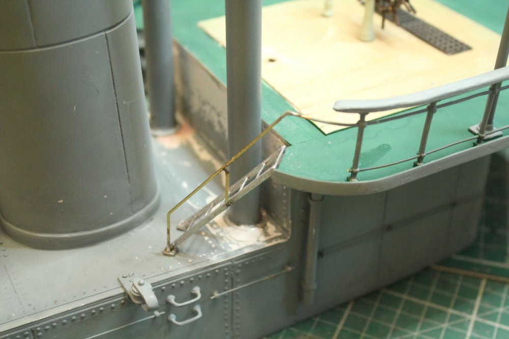

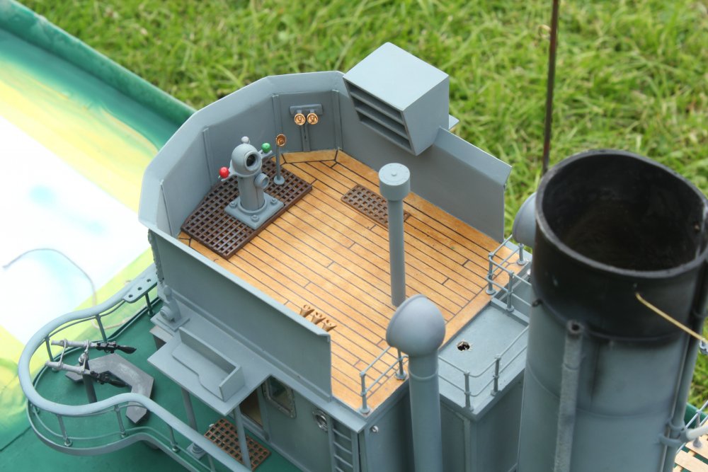

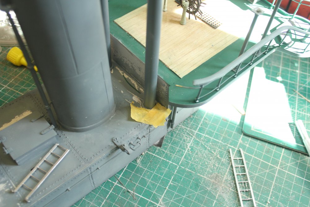

A few more hours spent today in joyful solitude in the shed with some CD's. Major surgery with a repositioning of the engine room vent pipes, Despite going off the plans the location measured was not correct and they had to be move up and over a tad. you can see the original position in the photos. Wheel house deck is now in place too. Hours spent with little to show!
The Ladders were also attached and the handrails soldered up to the main rails. All good fun!

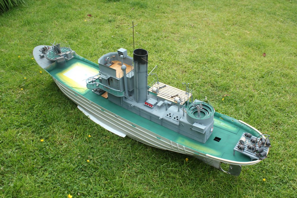

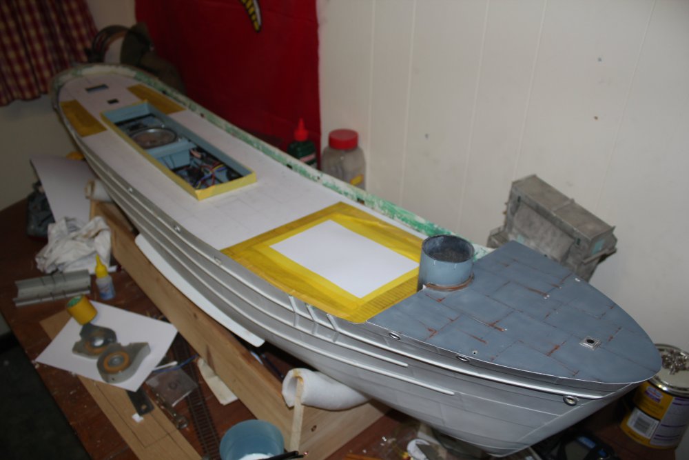

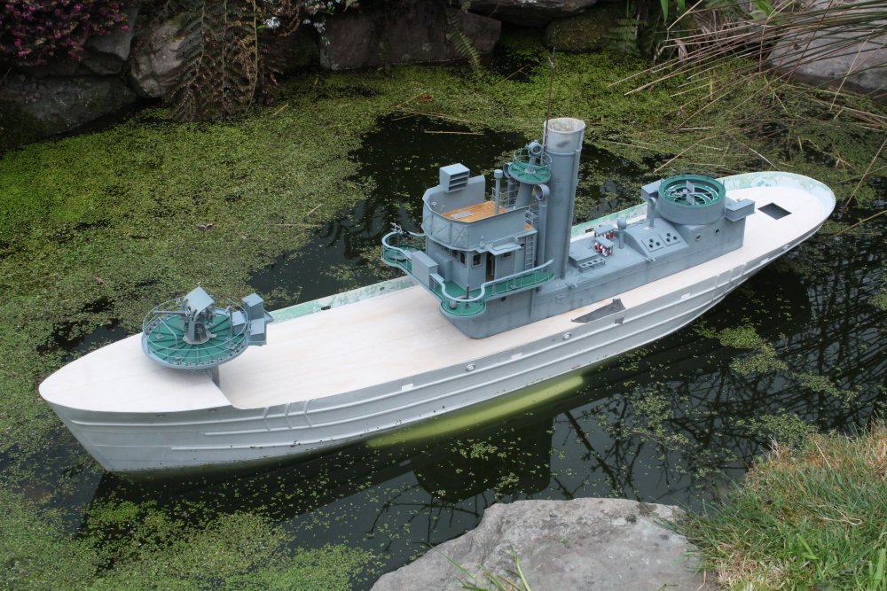

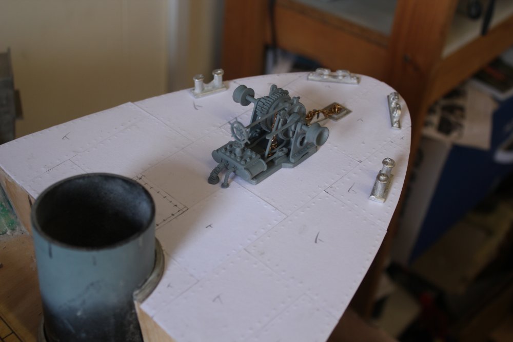

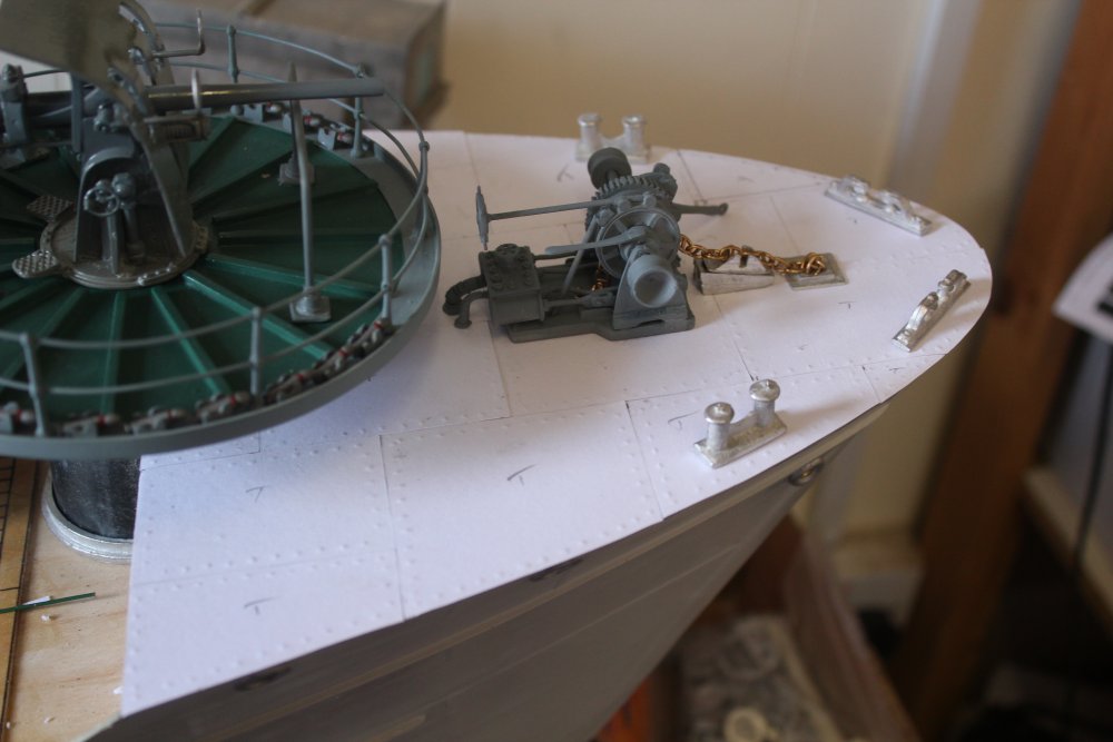

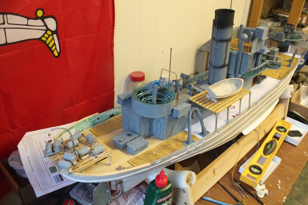

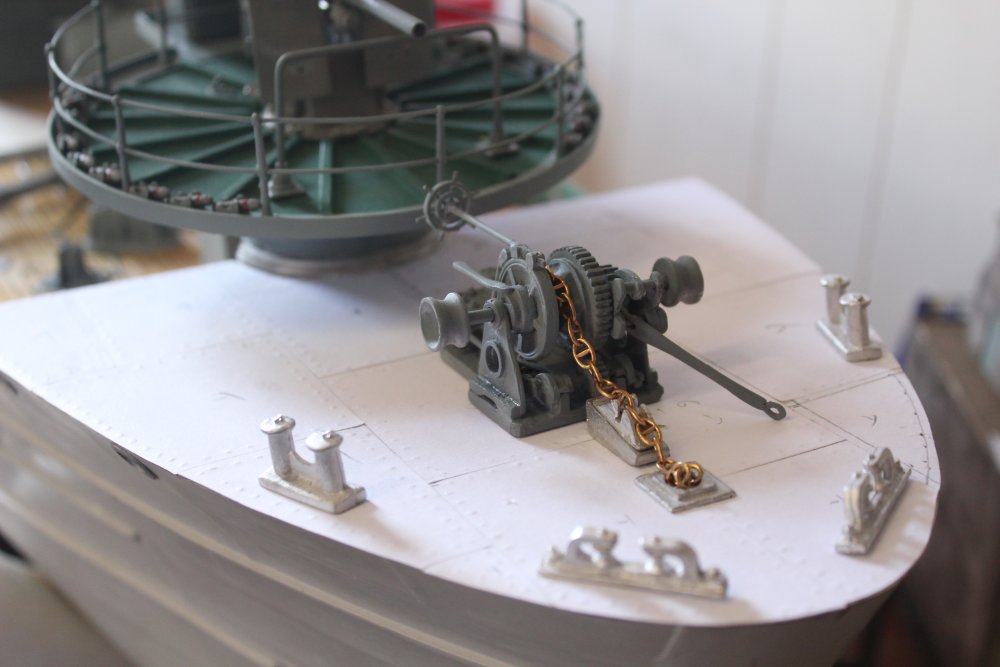

Moving Along nicely and one of the most eagerly awaited jobs, The Armour Deck Plating.

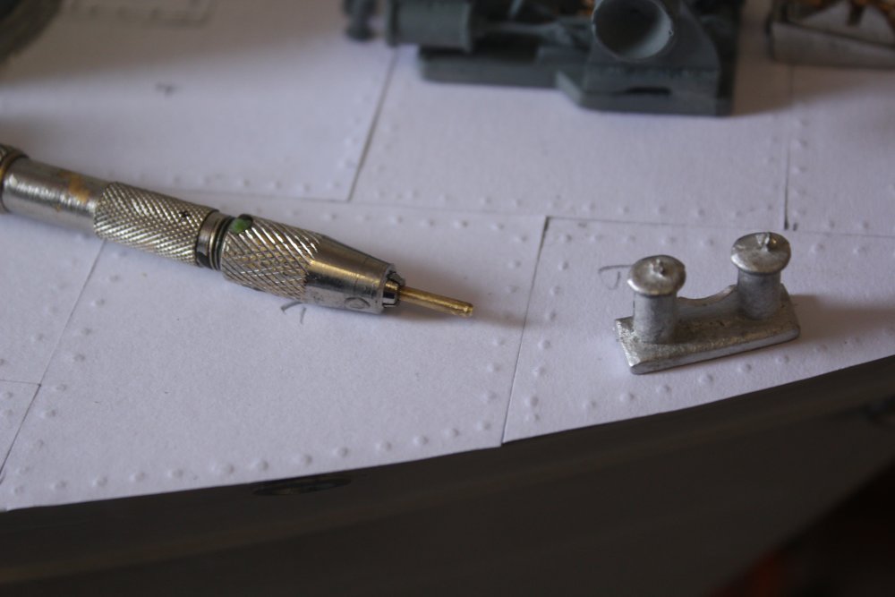

2 Sheets of paper were provided in the kit, Yeah right that will cover the hole thing plus on top of it I made a balls of two attempts do lay the Plates so had to order a pack of 50 sheet. Just trying to get a suitable Rivet head was problematic, Tried a Dart, Drill bit, Grinding bit, some other bits in bobs but nothing great, In the end I round off a 2mm brass rod and put into a pin vice and pressed each one in to each plate, marking out 5mm per rivet and 2mm in from the edge. A long process.
Plate are glued with PVA watered down, What ya think?

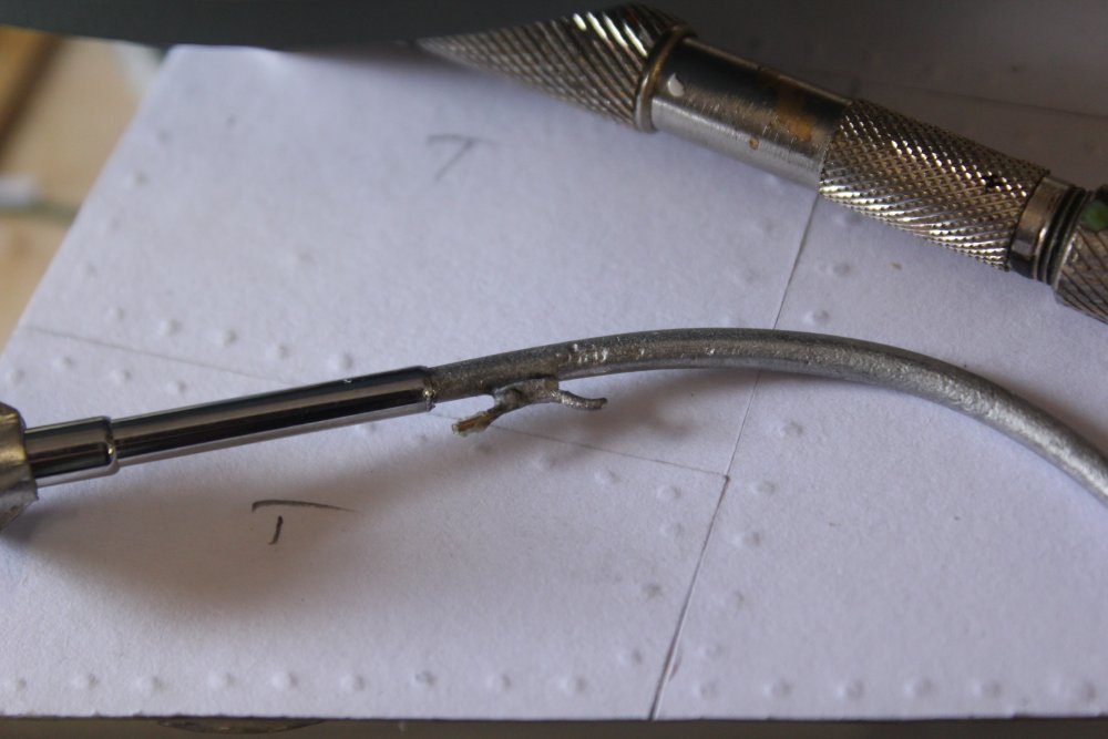

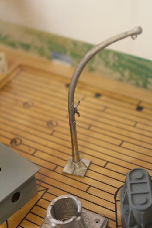

Also had to solder up a short shot cleat with some smaller brass rod onto this davit., The Shiney bit are Telescopic Aerial cut up, looks quite nice!

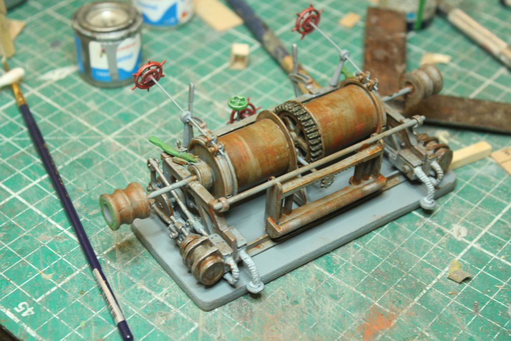

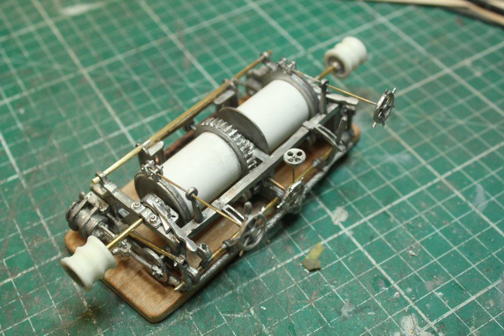

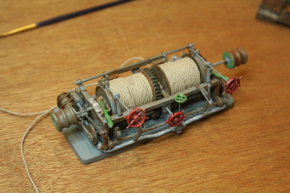

Would be nice if it did with some steam pouring out and sound!

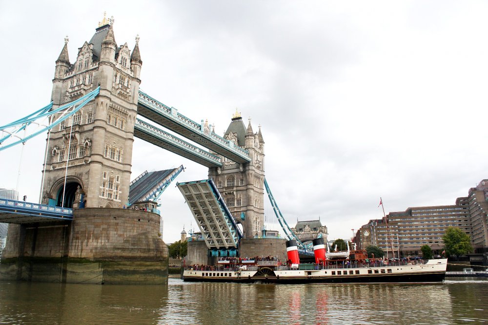

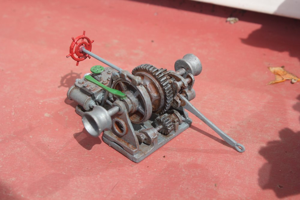

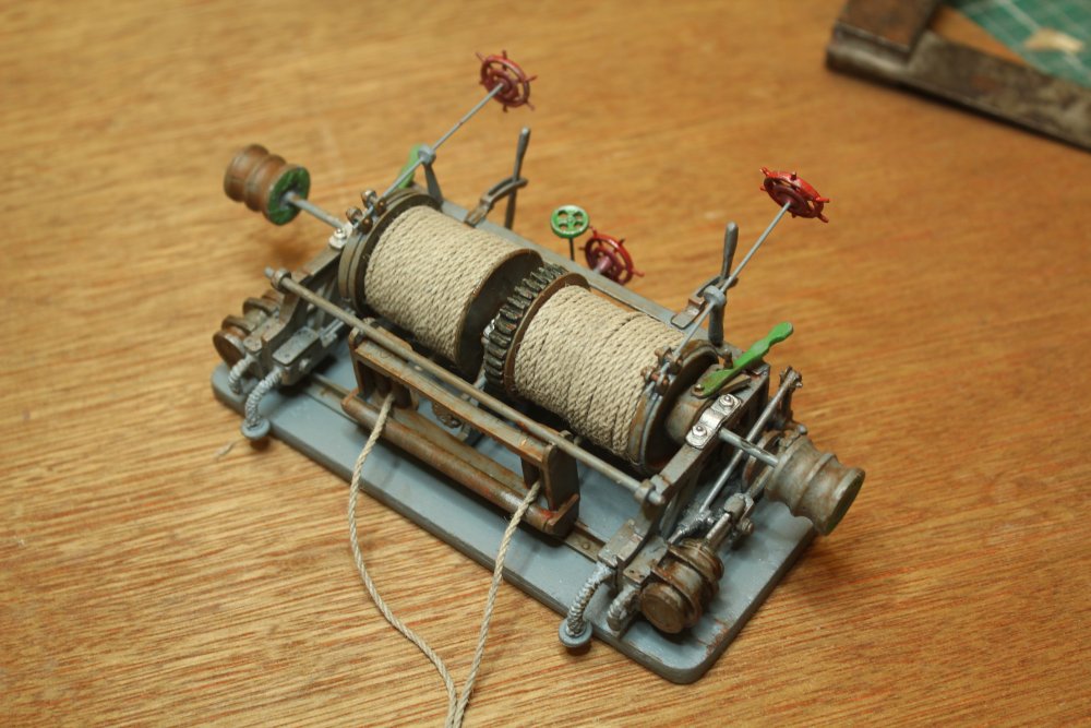

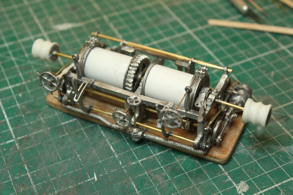

here's Anchor Windlass in action on the Waverly on a trip to the Thames Forts which seems ages ago, Well worth the money which is pretty reasonable. Got up early to see her leaving the Sunday morning after out trip. Check here out. A Great day out https://waverleyexcursions.co.uk/

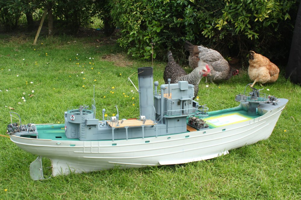

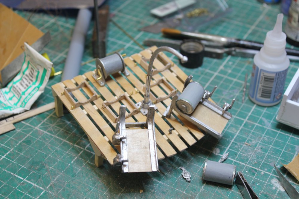

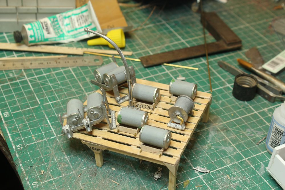

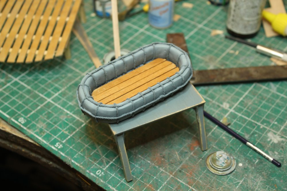

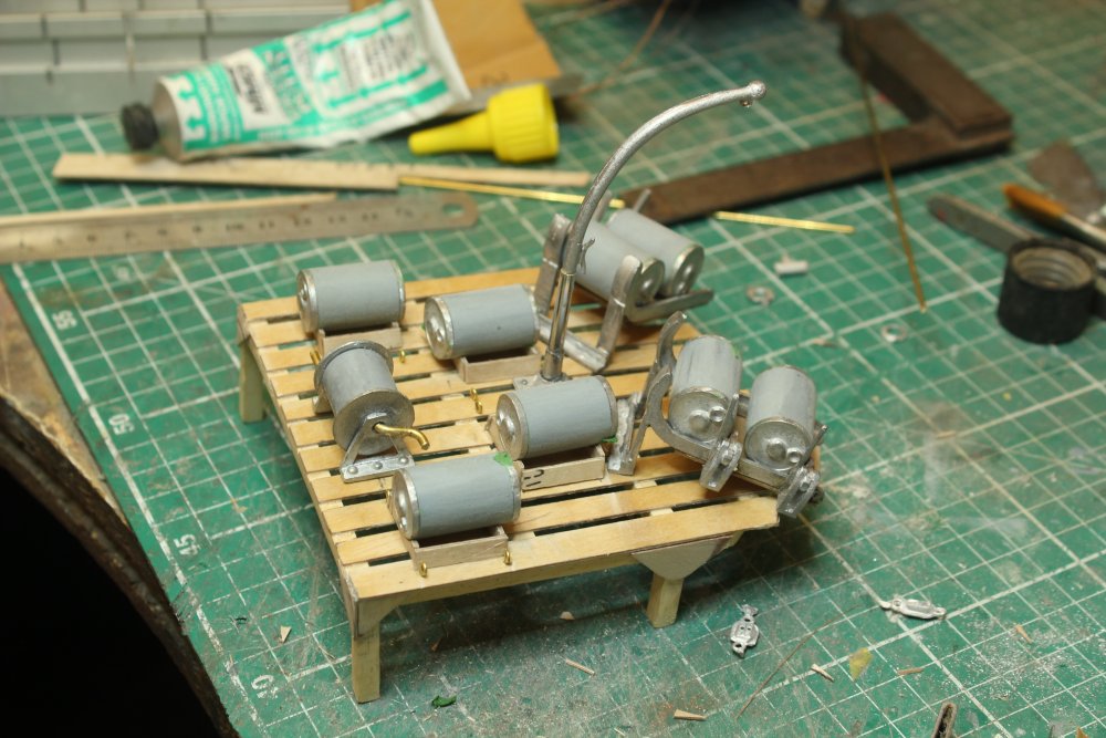

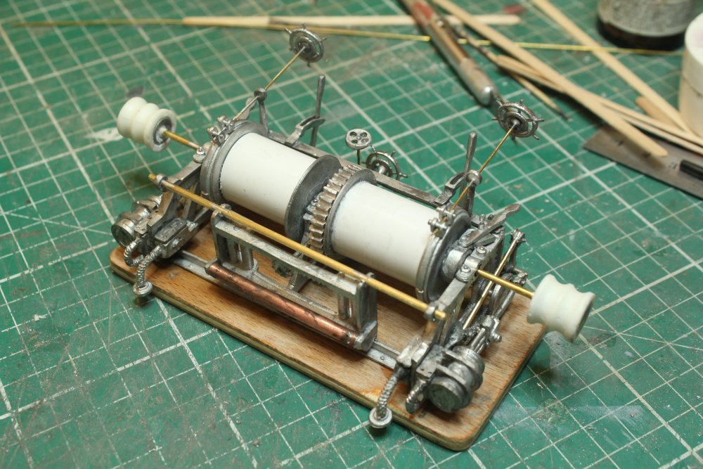

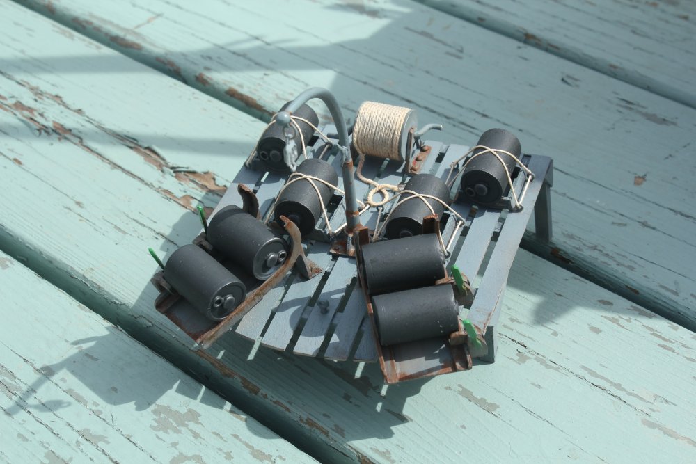

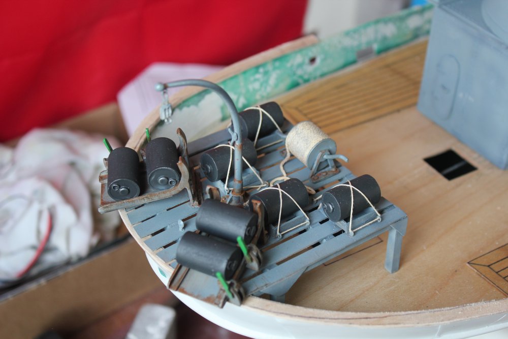

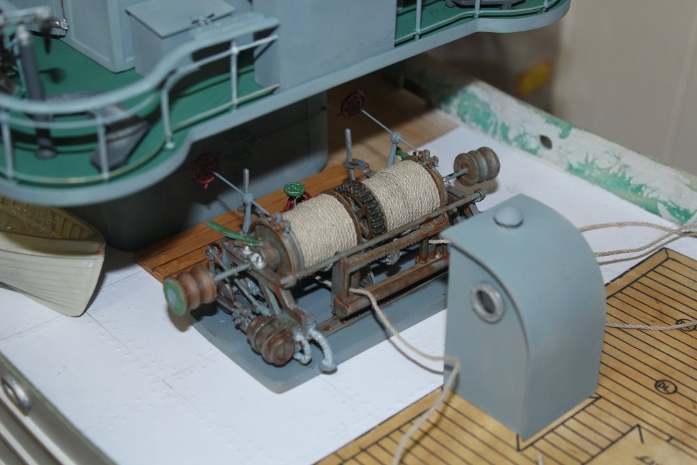

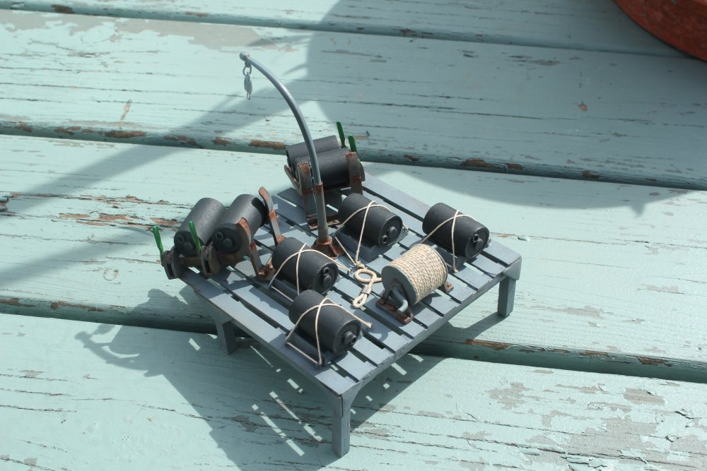

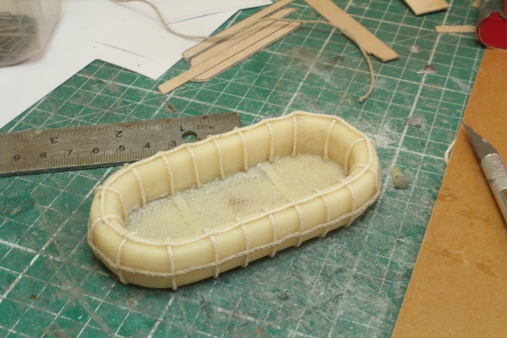

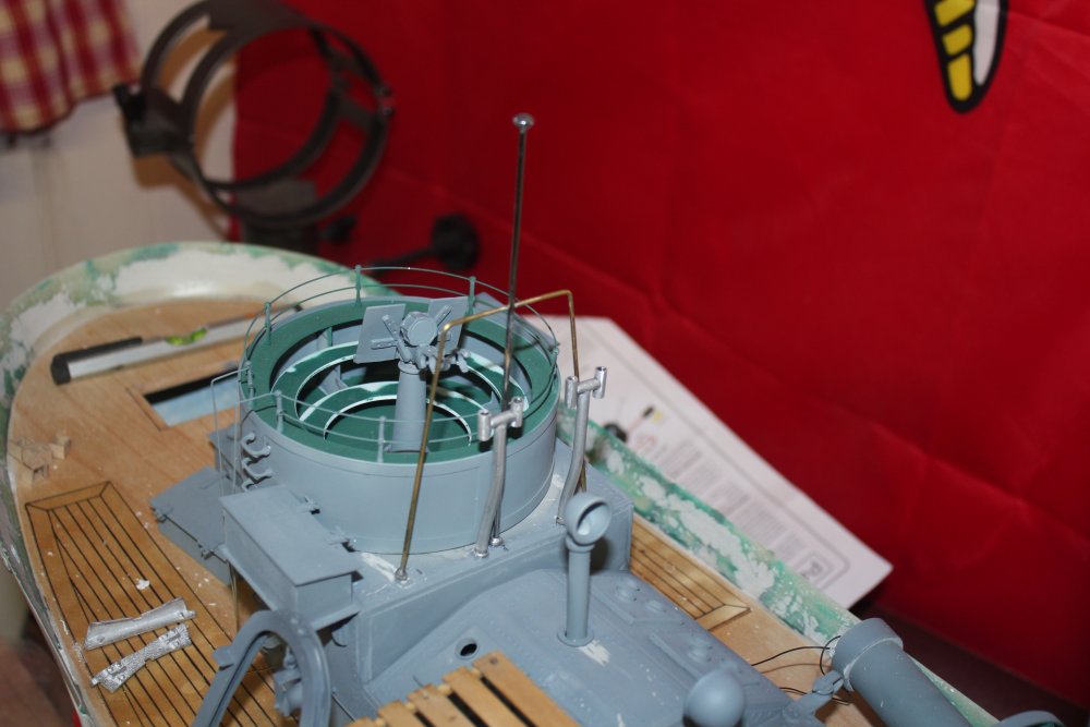

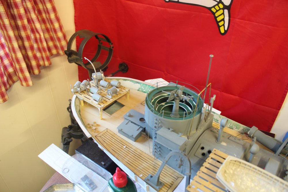

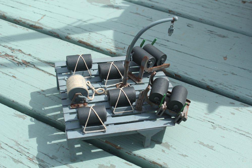

The Latest bit done were the, bow cable drums,  Rear Stove Pipes and the Rear Mast with brass rod and a Top of an old aerial for the middle bit and gun deflectors to the sides. Also the depth charge rack was made, about 2 days work on and off along with the depth charges.
Coming together nicely now.

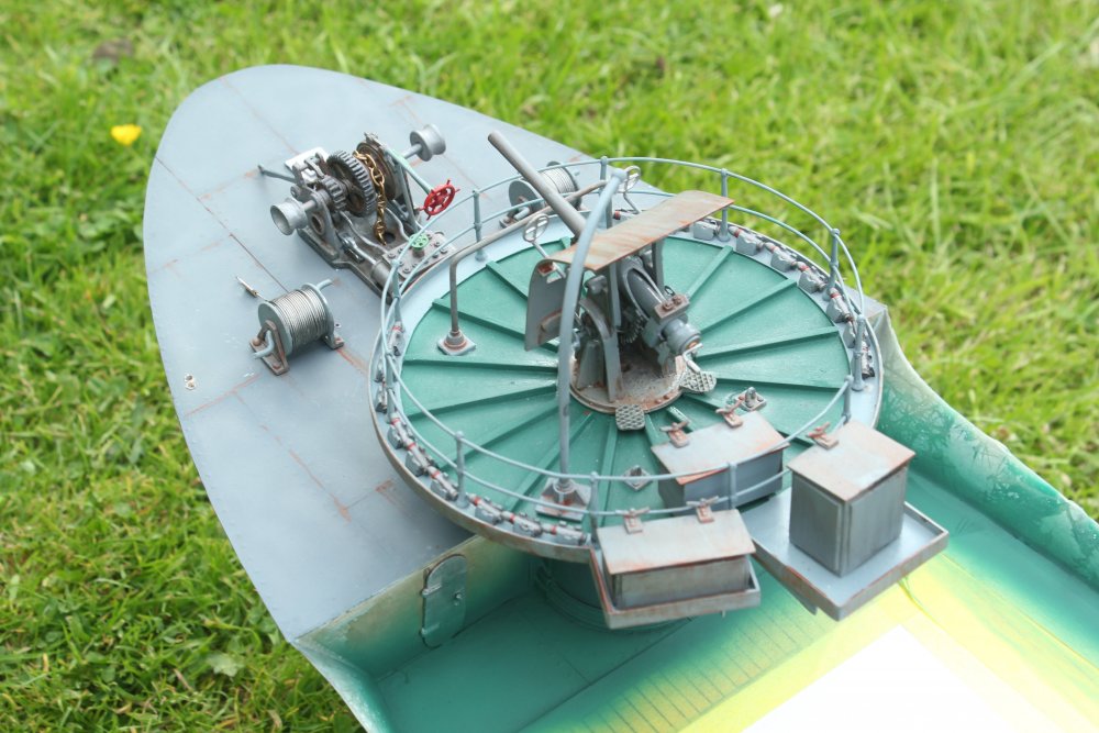

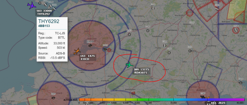

Should of been in SNN right now watching an ultra rare  IL-62 to take off which is happening in the next few mins but instead listening and watching on Flight Radar, Bit Lazy this weather :/

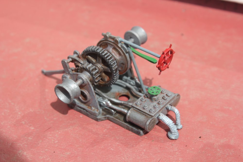

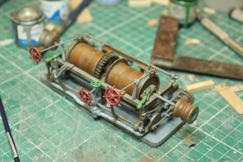

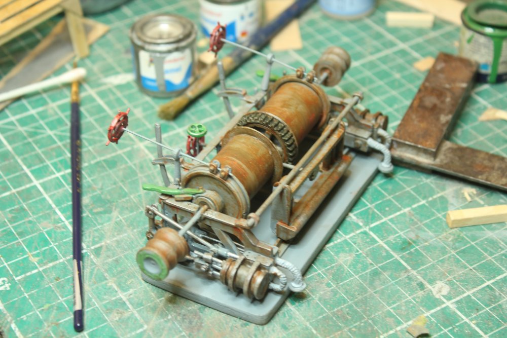

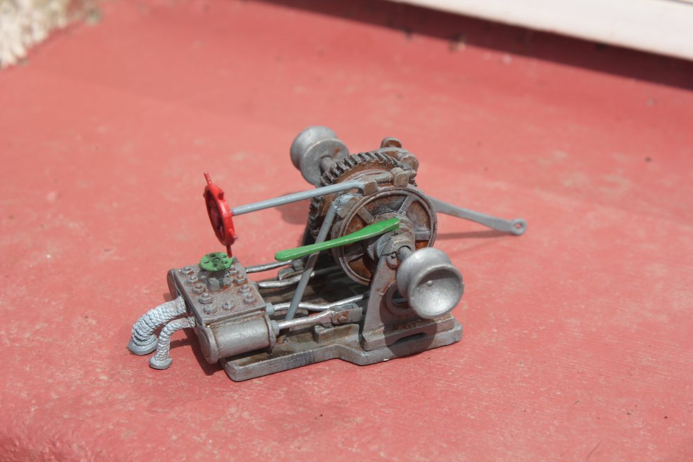

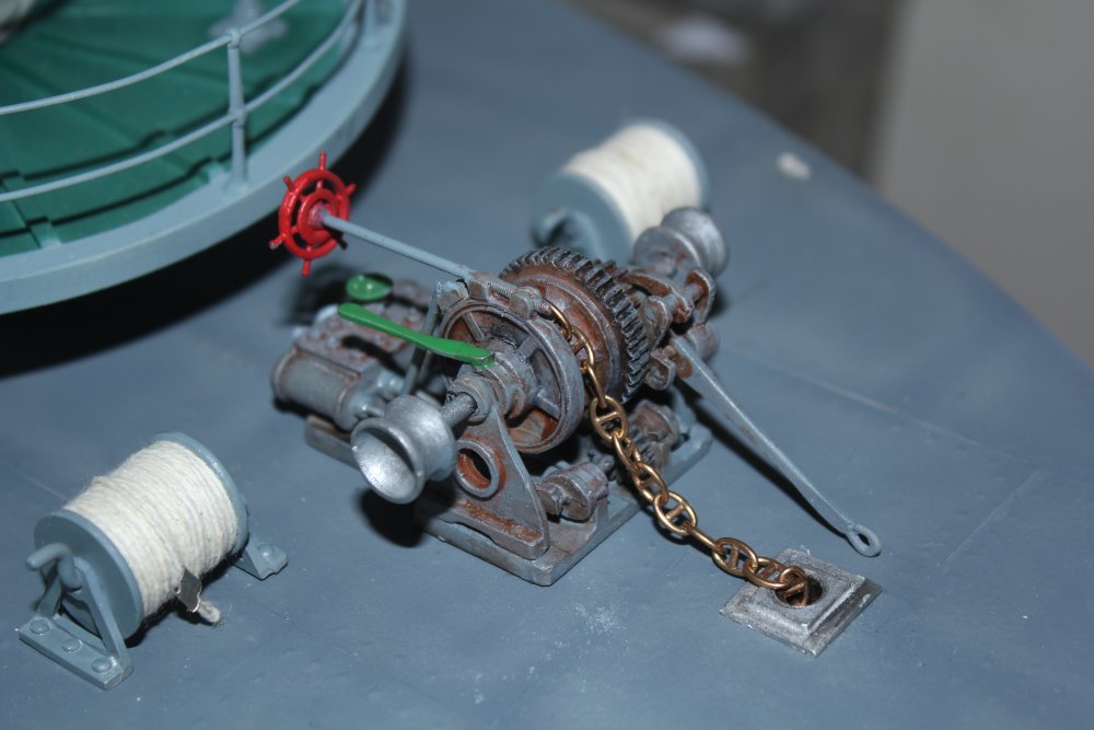

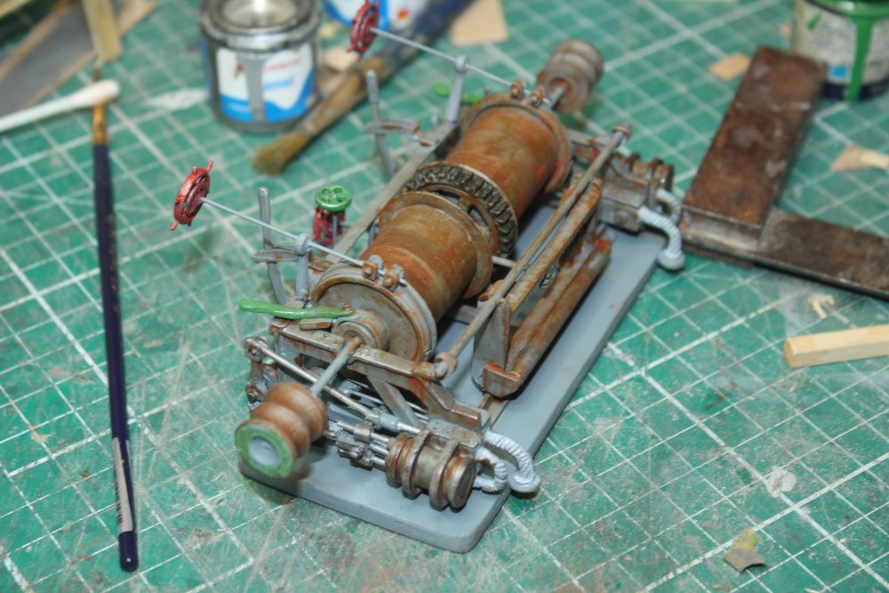

Some update again with the Depth Charge Rack near nearly done and a bit of weather on the anchor Winch.

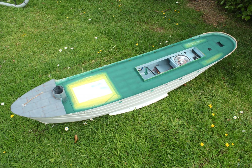

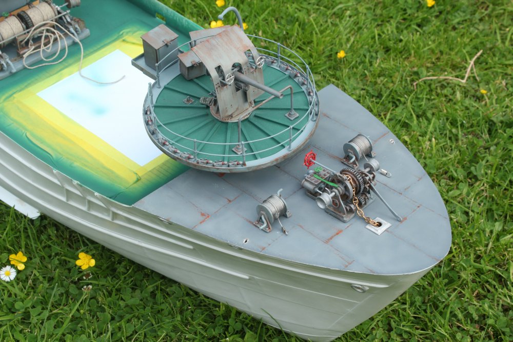

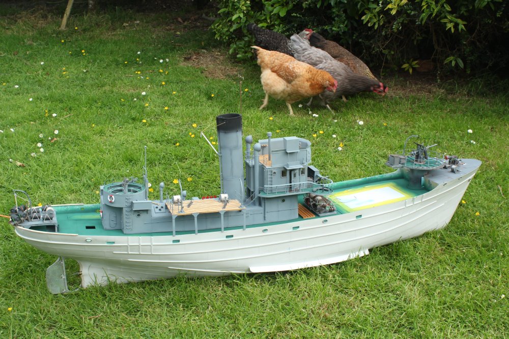

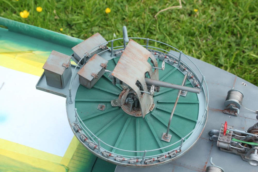

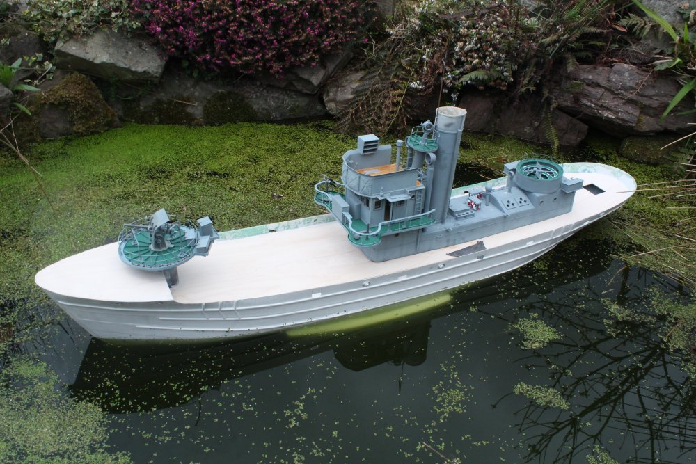

Thanks for the Comments, Been Beavering away here and have managed to get a few small items done over the past while but the most tedious one has been done and that is the Armoured Deck Plating and punching the Rivets but I have that done Saturday all day and I have now pre shaded with white and Black and then laid the green on the top. I am quite pleased with this as a Flat green Deck would of looked a bit toy like. Took it out in he ambient light to see though what it looked like. Weathering also has been started on the Box, Front Gun and ammo Boxes by the Main cabin.
Sunday took the the Knockmealdown mountains for a 13K hike to calm me nerves after slicing the top of my Left hand thumb off with the Scalpel! Parents were not available or supervision for Help at the time

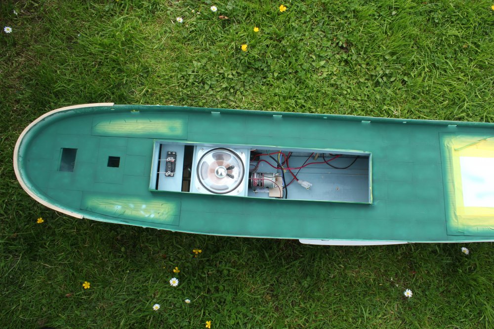

the shaft has no gland neeed Noel,  its an apparently a Sealed Shaft but this will be packed with Silicon RC Grease to stop any leaks as the shaft is below waterline. That worked on the ol fellas puffer that leaked through the shaft, Squeezed some Grease into it and sorted! No leak.

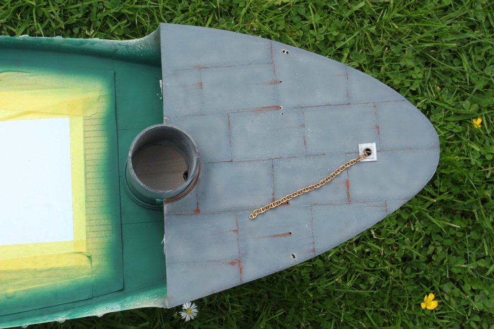

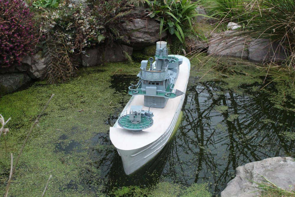

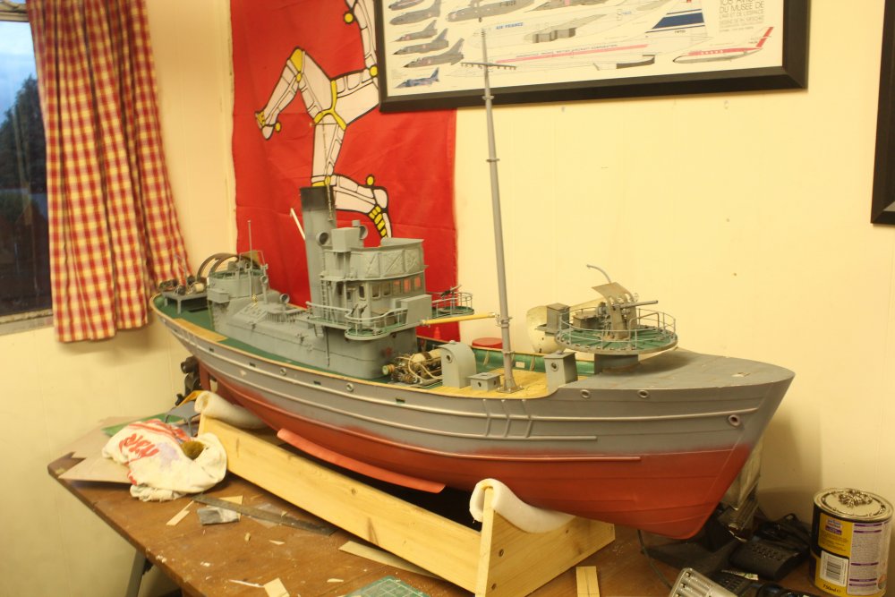

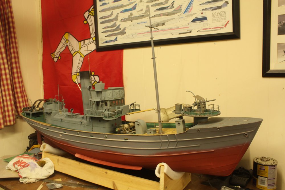

A Call into Halfords on the way to Carrauntoohil to pick up some rattle can primers saw the hull painting begin yesterday, Pre shading now next. Red for the bottom as this hopefully will be hard wearing and grey on the top part! Done outside yesterday before the rain came back again.
Hand Rail cappings done also and you can see the Bulwark supports are in on the Port side.
Not the greatest of photos as I am using high ISO.
