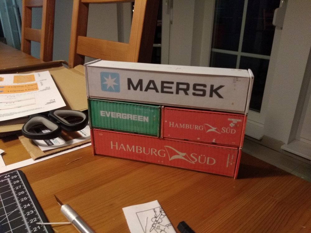

murphaph Posted October 13, 2020 Posted October 13, 2020 So I've posted a bit about my forays into the electronic side of the hobby but in the past couple of days I've picked up the scalpel and attacked my first ever scalescenes kit. A few containers. Baby steps. 8 Quote

murphaph Posted October 13, 2020 Author Posted October 13, 2020 Cheers Rob. It's certainly good practice for the future. I'll experiment a bit with different card thicknesses and see how I can improve upon what I've done so far. I'm trying to look at each one and see how I could have made it better. One thing I realise I really need is an assortment of square blocks of steel or aluminium or something to help hold parts at right angles during glue curing. I'm away next week but I've found offcuts on eBay for small money and I'll order those for when I'm back at home. 2 Quote

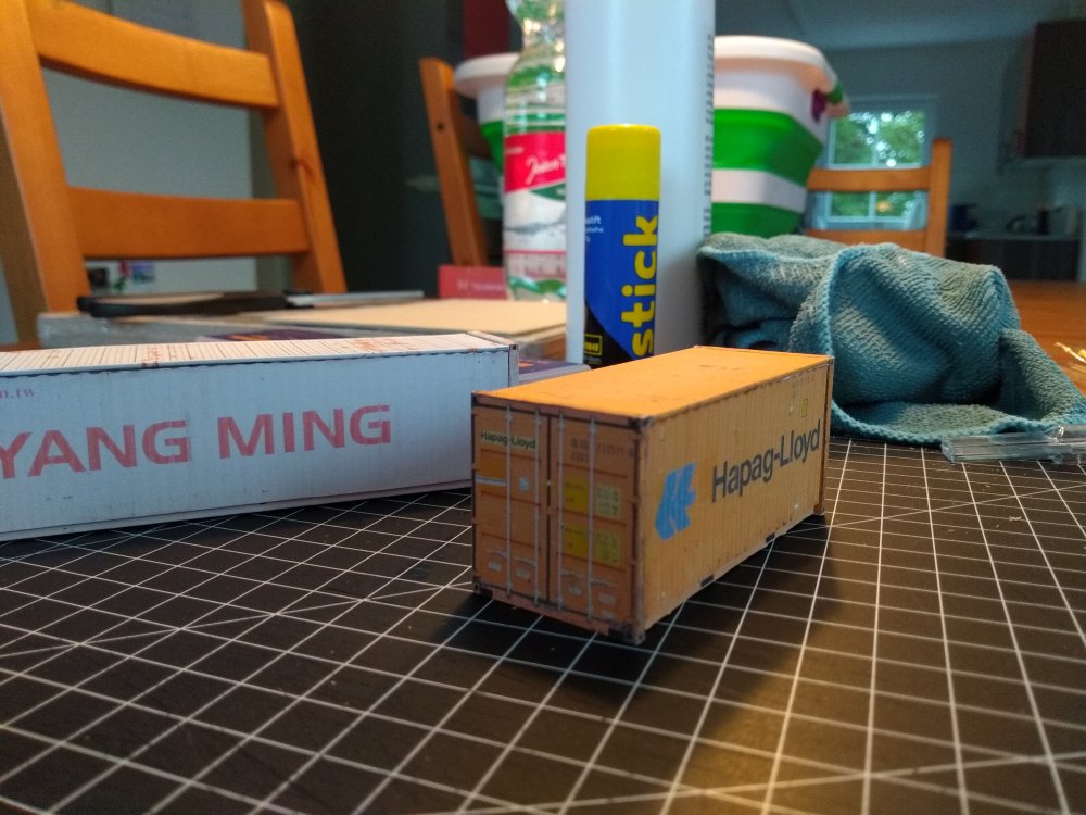

murphaph Posted October 14, 2020 Author Posted October 14, 2020 The Yang Ming in the picture is the first I've constructed using 2mm solid card rather than corrugated cardboard. It's more difficult to cut but probably fairly unsurprisingly retains it's shape better as it doesn't compress at the ends/sides where a corrugation is missing. 5 Quote

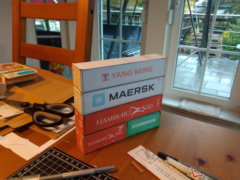

murphaph Posted October 14, 2020 Author Posted October 14, 2020 (edited) Getting better with each iteration. The trick seems to be to add all the required fold lines before cutting out the end panels. The instructions only advise making the main folds before cutting. Also I feel the internal bracing is a tiny bit too narrow so I'm cutting those out on the waste side of the line and adding a bit of "uhu padding" when assembling, otherwise the side walls seem to sit too recessed and not flush enough with the end walls. Edited October 14, 2020 by murphaph 6 Quote

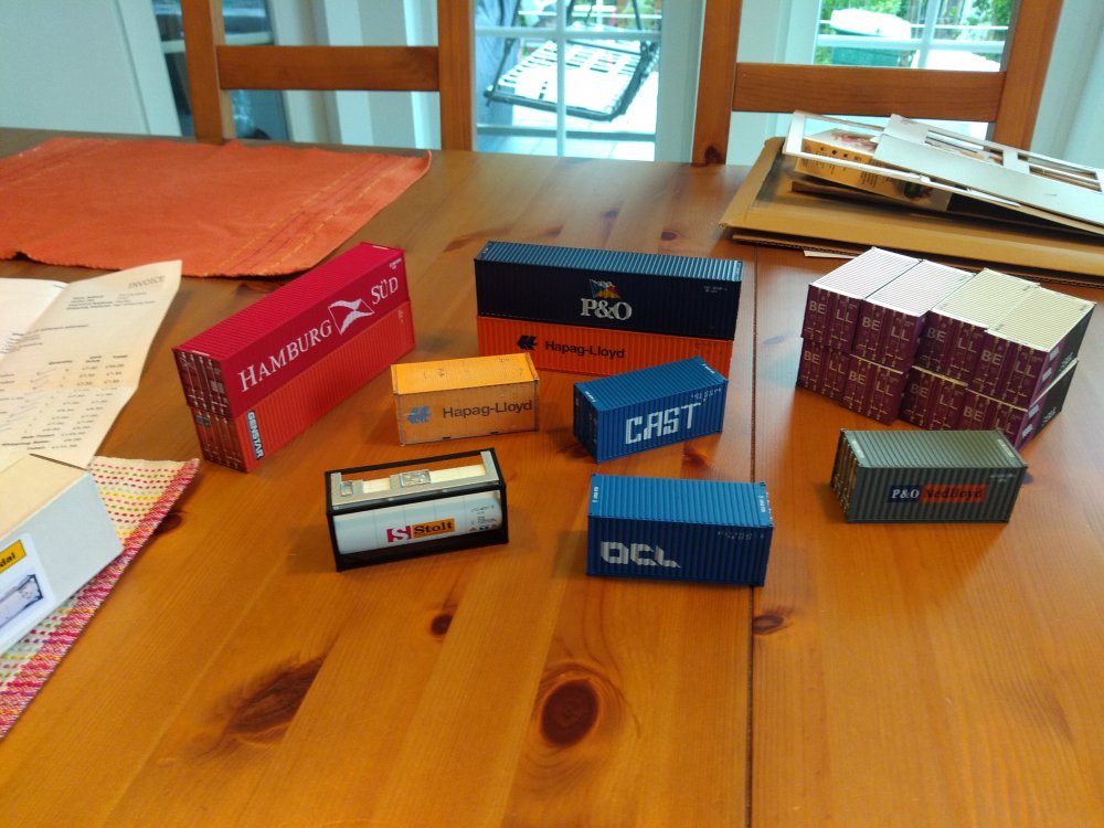

murphaph Posted October 14, 2020 Author Posted October 14, 2020 Lol. I don't Dave! Speak of the devil... (A lovely c-rail delivery came today) I think I need to work on my printer settings. 3 Quote

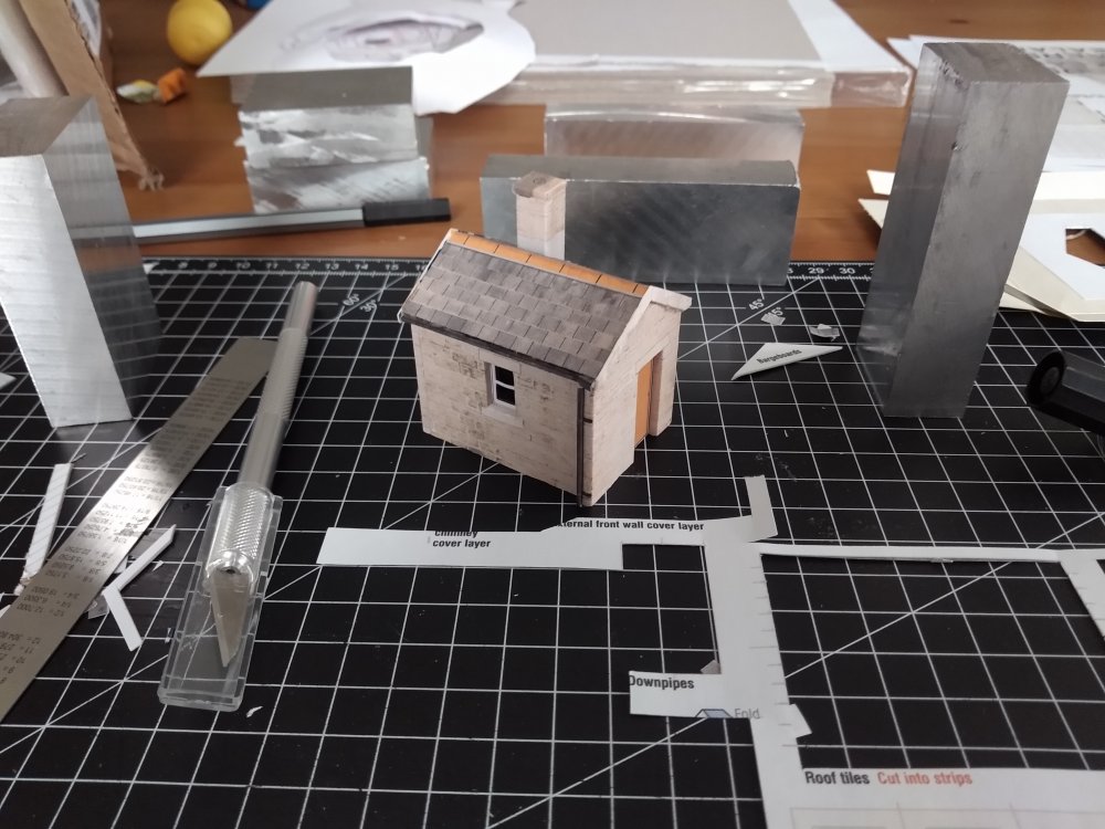

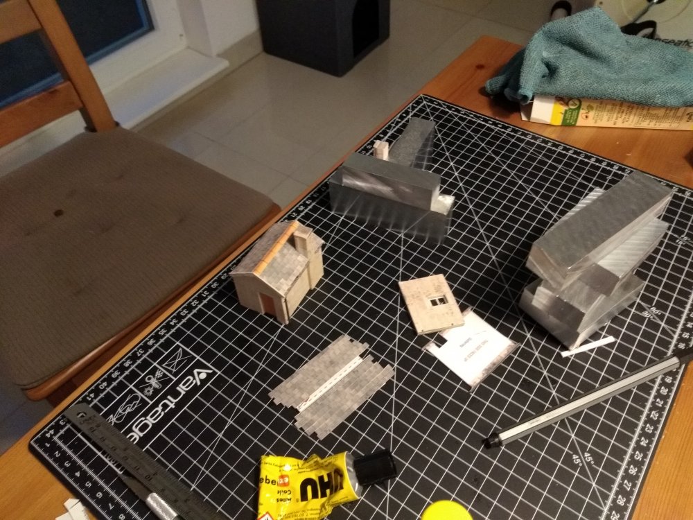

murphaph Posted October 30, 2020 Author Posted October 30, 2020 First attempts at a building, the tiny and free coal merchant one. My first attempt was not a success. I made errors in the assembly through carelessness and poor lighting (just working at the kitchen table). The second attempt in progress... 12 Quote
