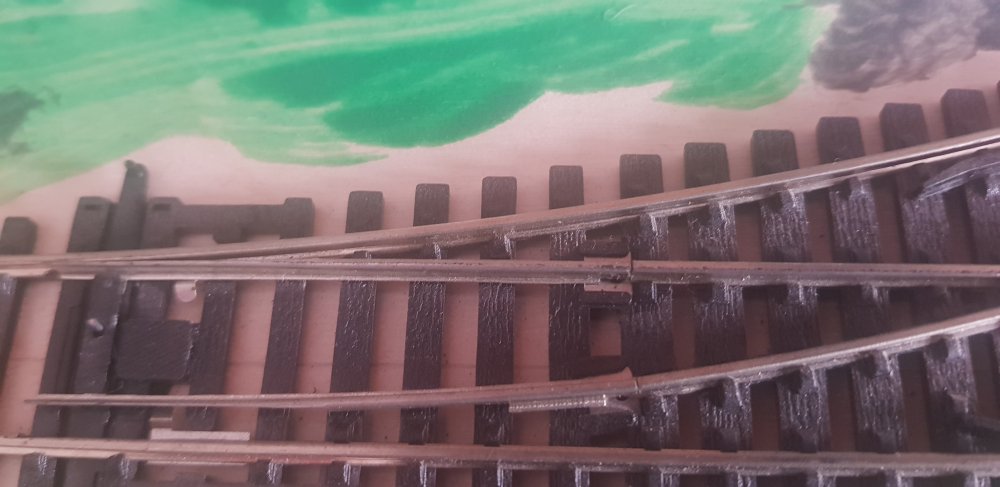

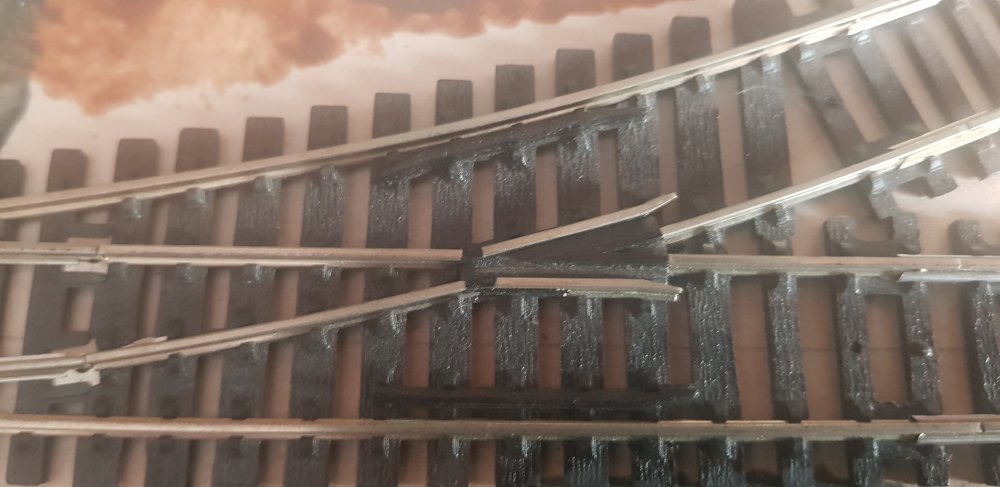

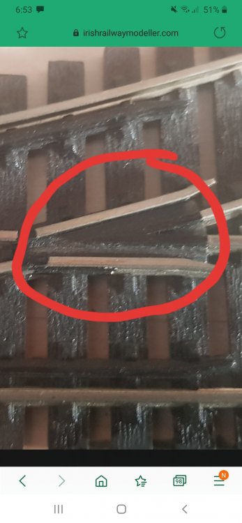

irishthump Posted November 11, 2020 Posted November 11, 2020 2 hours ago, brassnut said: Ahh on straight. On curves On cross overs. I'm useless at trying to explain. In detail.. Hopefully ye can understand my difficulties As I'm having trouble trying to figure out Thanks for all help brassnut The frog on that point seems to be worn down to nothing! Pull out the whole point and replace it with a PECO one and all should be fine.
Rob Posted November 11, 2020 Posted November 11, 2020 (edited) That point looks like it has seen better days as Irishthump said. Put simply, If all your rolling stock derail at the same spot, then it is most likely the track. If they derail all around the place, more likely to be connected to the rolling stock. PECO points are generally thought to be best around so that is great advice above to replace the points with one of them. Have a trial of that and see does that help as there are few things in life as annoying as a derailing layout! Best of luck. Edited November 11, 2020 by Rob
brassnut Posted November 11, 2020 Author Posted November 11, 2020 All track only two year old strange. But looking at the photos I can see the wear certainly Will try get better pictures tomorrow thanks Tony 1
murrayec Posted November 11, 2020 Posted November 11, 2020 @brassnut Is that not dirt in the frog? I would try and clean it up with track cleaner and a toothbrush, also take a look at your wheels on stock and locos to see if they need a clean... Eoin
David Holman Posted November 14, 2020 Posted November 14, 2020 Eoin may well be right and it is even possible that the crossing vee (frog) is out of alignment. My own track is soldered/handmade and test runs quickly show where crud has been left behind. As for wheel cleaning, locos certainly need this doing on a regular basis. At exhibitions (remember those), at the start of each day, but depending on the atmosphere, two or three times during the day in some places. Therefore, the same applies to home layouts. Rolling stock often gets ignored, because there is a lot more of it, but would suggest that a couple of times a year, assuming regular use, all wheels are cleaned. Not only will running improve, but any dirt on the wheels will not be spread back to the locos. And while I'm here, abrasive cleaners should be avoided like the plague, unless there is hardened paint to remove. They put micro scratches on the rail surface, which encourages sparking which equals dirt. Better to use a solvent like isopropyl alcohol, meths, lighter fluid, potchine(!) etc. 2 1
