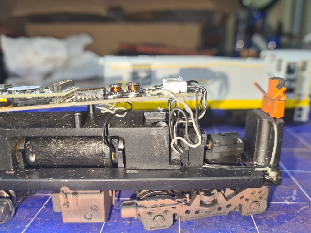

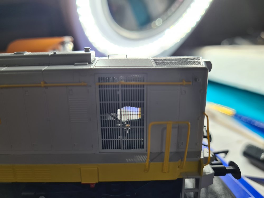

Zeb1 Posted December 27, 2020 Posted December 27, 2020 If you remove the body..and remove the 2 screws on the fan end of the pcb it will just slide underneath.its the 40mm long i phone speaker by roads and rails i use...the sugar cube speaker just pops out and solder speaker wires to the 2 contacts...you can see the speaker thru the side grills but that's OK in my opinion... 2 1 Quote

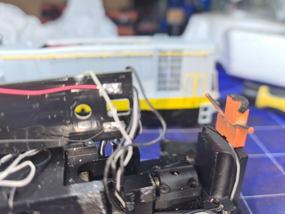

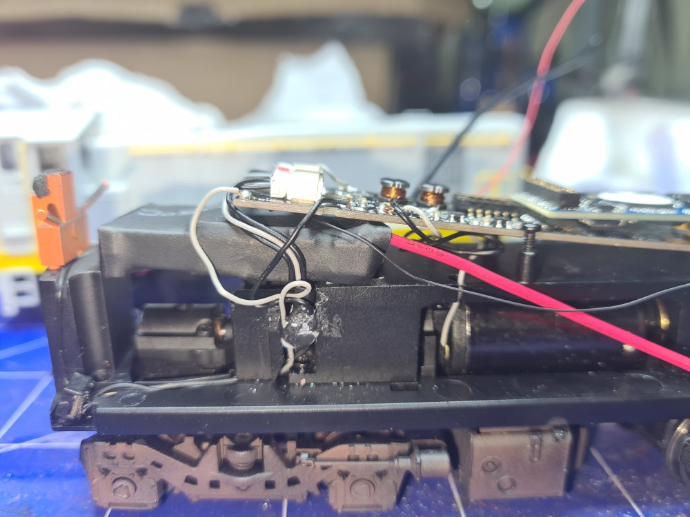

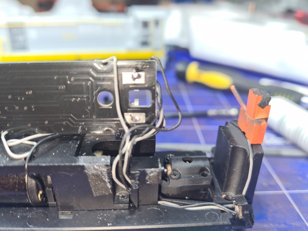

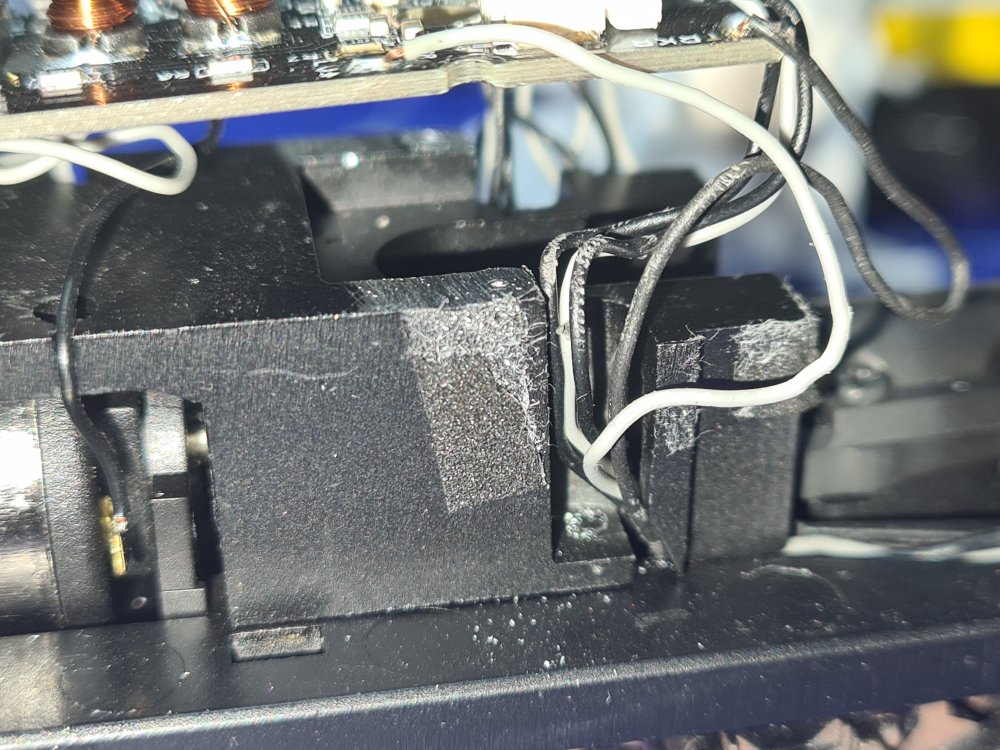

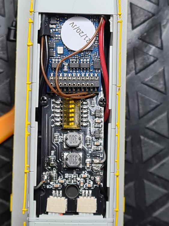

Zeb1 Posted January 5, 2021 Posted January 5, 2021 Here is the install of a double I phone speaker in a 121...Remove 4 body screws and remove loco body...remove 4 screws securing pcb board.take out sugarcube speaker...cut away front 2 lugs for securing pcb and file flat the ones nearest the grill..tin the 2 pads that were the spring connection for the sugarcube speaker..attach thin wire to the tinned pads...I phone speaker just fits snug under pcb..Replace the back 2 screws on pcb...GENTLY replace body feeding wires up each side of body as being replaced..Care needs to be taken on the grill end for the 2 coolant filler pipes while body being replaced....they can catch off the body and break...I gave mine a little pinch inwards before I started...also make sure led marker lights are in position before putting body on...Good luck... 3 Quote
