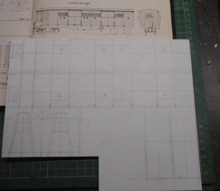

Kerr Stuart 4-6-2T Couldn't resist the thought of a new project any longer, so this morning sat down to evaluate what I need to do to get started. Having a set of parts is nice, but without any instructions, in effect you need to devise your own and as already mentioned in a previous post, work out what else you need. Found a scale drawing from the 7mm Narrow Gauge Society, though unfortunately not all the dimensions agree with the etchings. Nothing too drastic though, so guess I'll stick with what arrived. Those of you familiar with my Barclay Tank adventure will know the chassis caused me a LOT of grief, so decided I really needed a better plan of attack this time, starting with an oversized drawing to check clearances and so on: A good two hours was spent with ruler and vernier gauge checking parts and materials, from which I discovered, among other things that: The frame spacers at 29.2mm wide exactly match standard 0 gauge wheel back to backs. This is interesting, because the 0 gauge wagon axles I use with the Gibson driving wheels have nice extensions on them that will take square section brass tube to fit in the Slater's outside cranks, which helps with quartering the wheels. It is also a bit of a shame, because I discovered some Slater's 1/8" 0 gauge axles which fit nicely in the cranks and would have given perfect quartering with zero effort. Unfortunately, they are shorter than the wagon axles and would have made clearances far too tight. I really can't go through the hassle of trying to fit the Gibson drivers inside the frames as per the Barclay. Hence have sent off to High Level Kits for a set of horn blocks, so wheels and axles can be dropped out of the frames for painting etc. This does mean though that I need to find a way to make those dratted underslung dummy springs removable. A further point here is that talking to Dart Castings at the Tonbridge Show yesterday, it seems High Level could be the only supplier left for 4mm scale horn blocks. Dart can't get the square brass bearings, while Markits future is very much in doubt following the recent death of the proprietor... I fear the cylinder etching is too narrow. As the photo shows, it comes out as about 45mm, whereas the footplate is 54mm wide and the cylinders go right to the edge. They need to as well, to give space for the slide bars and con rods as can be seen from my drawing above. Without doing all this preparation, building the chassis would be fraught to say the least - been there and got the T shirts [plural] after all. However, it has helped me get my head round things and while I'm waiting for the horn blocks to arrive, I can get on with some of the bodywork, not least the footplate where it is important to find out where some of the spacers on the etch might fit and how they relate to where the motor/gearbox, body fixing points, bogie and pony wheels etc fit. As ever, life is complicated - which is why it is fun. Allegedly...

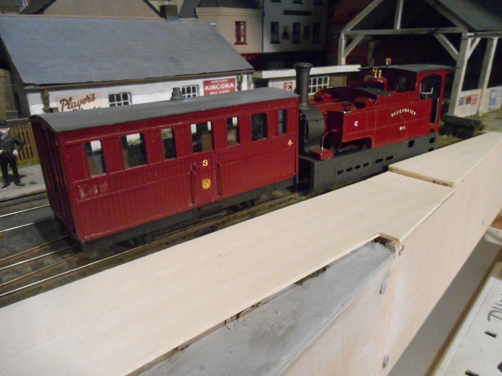

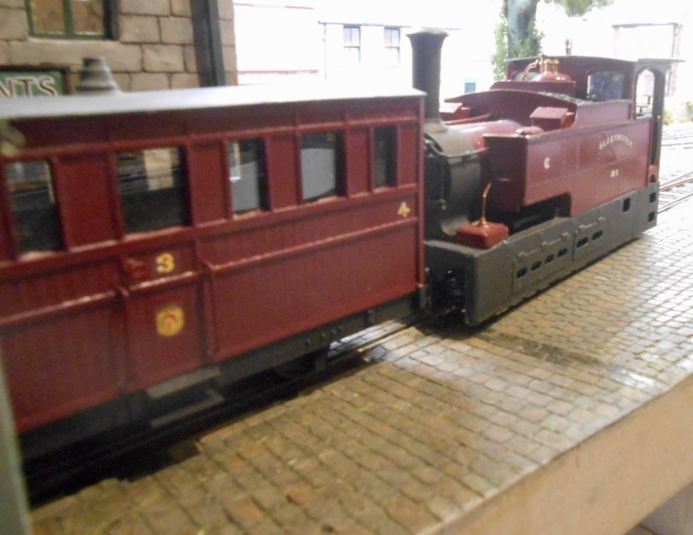

Still a bit more titivating needed, but the two Swilly bogies have made good progress. Hand lettering [white gel pen] and a few transfers, plus some weathering [enamels and powders], completes the scene, so have paired them up with the Barclay, below: Have also decided to have another go at trying to fabricate a cosmetic addition to the tension lock couplings to make them look a bit more like narrow gauge choppers. Just bits and pieces of plasticard, arranged to go on the inside of the buffing plate. A bit crude, but once stuck in place, with a bit of judicious filing and painted black, they are a reasonable upgrade. That said, in the latest Gauge 0 Guild Gazette, EDM Models have announced they are taking on production of the Zamzoodle Chopper couplings, which are much more accurate and can be made to work automatically too. If they are not too expensive, I could be tempted.

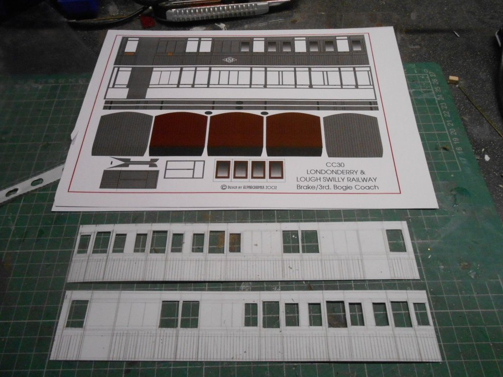

After a bit of a pause, while I had some louvres 3D printed, the Swilly bogie brake now nears completion. My first experience of such things, they look the part, though I soon found out they needed filing to shape, rather than cutting with a craft knife - far too brittle. While waiting for the prints to arrive, I made a start on another Swilly brake third, which will go with the bogie brake for the train for a Kerr Stuart 4-6-2T. Progress has been pretty good - enough to pose the two vehicles together, albeit with final details still needed. The brake third is pretty convention - a 40 thou plasticard shell, overlaid with micro strip for the outside strapping and frames. Bogies are from Alphagraphix, while took an idea from Tullygrainy for the roof vents, which are wooden dowel, shaped with files in an electric drill. As for that 4-6-2T, heard from Allen Doherty [Worsley Works], that the etches are done and should be with me next week, which is nice as I was wondering what I might do next!
