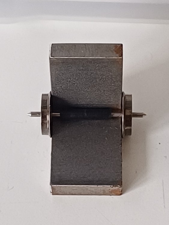

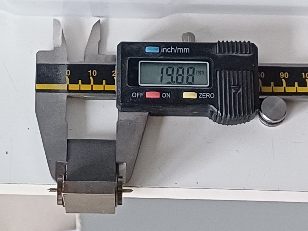

Ultrascale will make you correct length ⅛" axles (should be around 25.2mm long)....if you can wait 6 months. I had this done for the S-class and B1a, and will likely do the same for the J15. On the other hand, if you have suitable ⅛" steel rod (or even Sharman overlength axles that you trim yourself), and a back-to-back gauge, you could cut your own axles using nothing more than a piercing saw. I'd be interested to see what a modern J26 chassis kit via CAD would look like today. You'd certainly have the facility to design the forked coupling rods. -
