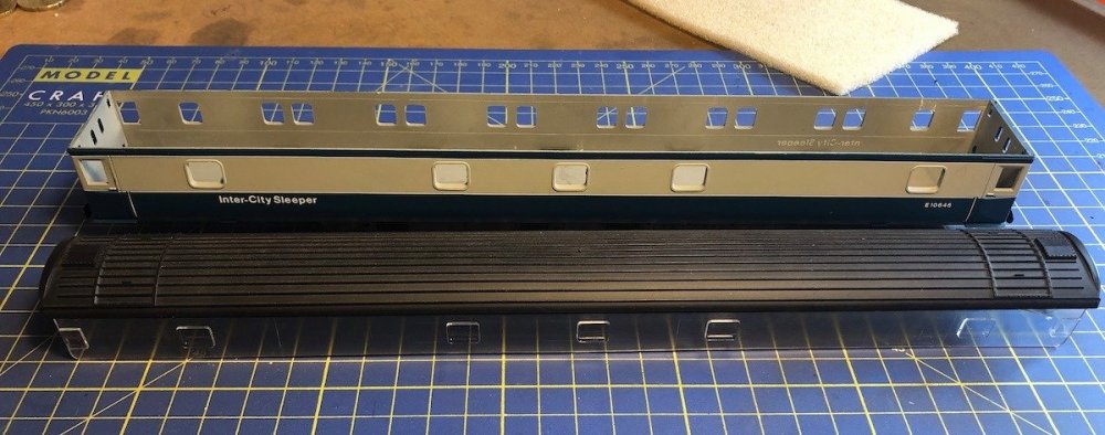

  3. Fun figuring out how to dismantle a Lima mk3 donor

  17. Another mk3 donor bites the dust. Could not get the window glazing out this time so had to resort to tedious masking. Avoided the hideous maskol route, dreadful stuff. Primed with Hycote plastic grey primer ready for reverse masking It kind of gets addictive after a while
