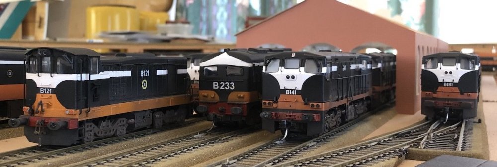

  23. Modifying the electro frog points this afternoon as per recommendations for frog switching, etc. Messy, I need thiner wire.
  24. Black'n'Tan Heaven. Kings bridge shed.
