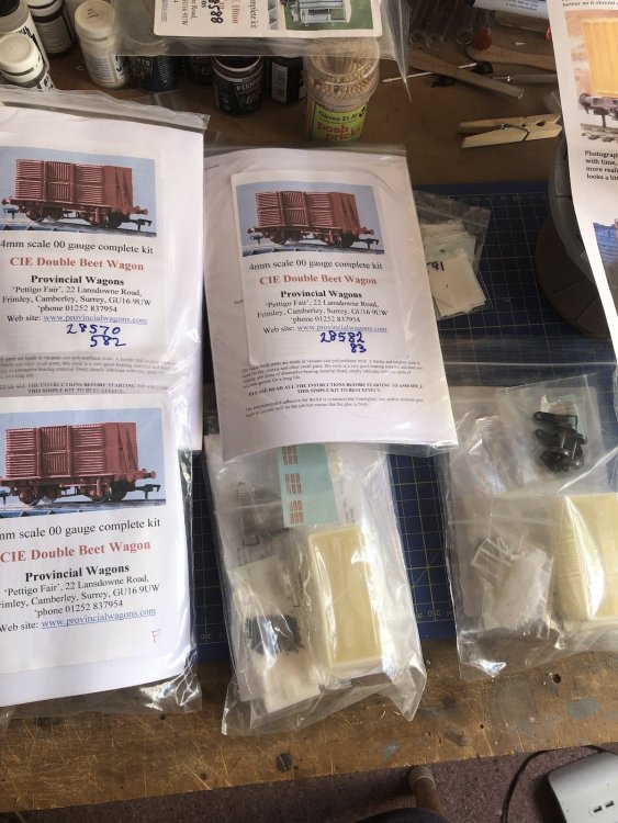

  7. The postman delivered a 5 pack of double beet wagon kits this morning. Happy days. These may keep me busy for the foreseeable future. Looking forward to getting stuck into these once the brake van is 100% finished.
