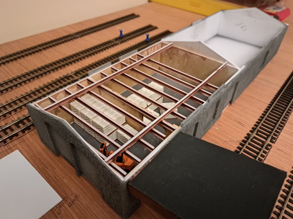

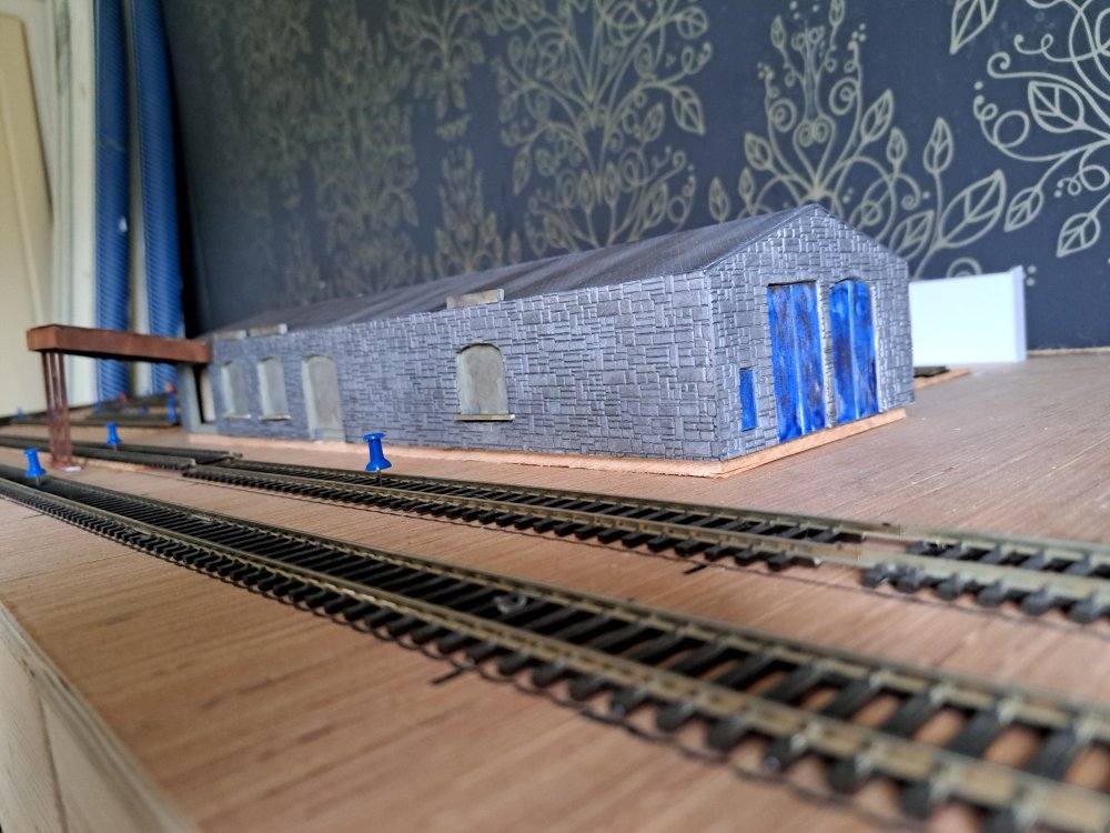

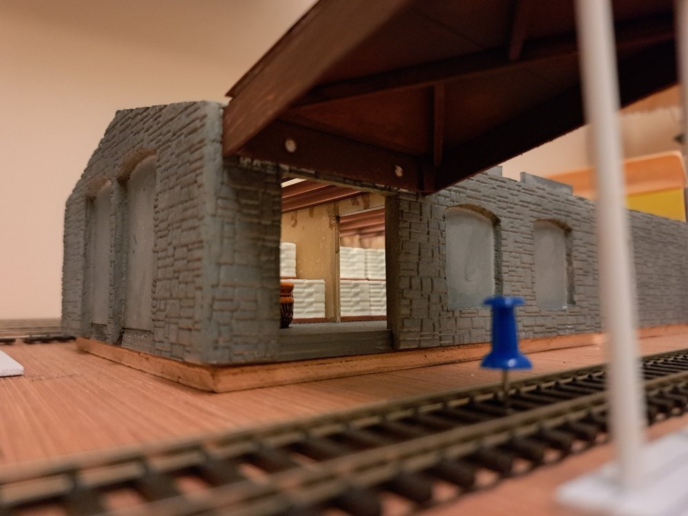

Dempsey Posted December 24, 2022 Author Posted December 24, 2022 Some small amount of progress on the internal details within the large goods shed. 13 5
DJ Dangerous Posted December 25, 2022 Posted December 25, 2022 (edited) It would be blasphemy to put anything other than a transparent roof on that shed! Clear corrugated plastic panel roof! Edited December 25, 2022 by DJ Dangerous 4

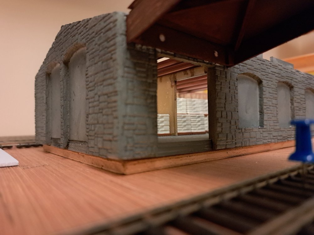

JasonB Posted December 26, 2022 Posted December 26, 2022 On 24/12/2022 at 1:04 PM, Dempsey said: Some small amount of progress on the internal details within the large goods shed Fantastic stuff. Really coming together now. Sometimes the interior of a building can be overlooked, but this just proves it's always worth the extra effort. Love this shot. The view captures the fertiliser bags but also the H beams. Great work. 6 1
Dempsey Posted December 27, 2022 Author Posted December 27, 2022 On 25/12/2022 at 11:33 AM, DJ Dangerous said: It would be blasphemy to put anything other than a transparent roof on that shed! Clear corrugated plastic panel roof! Unfortunately it will be covered over. The way the fert pallets are set up to the right is to give the impression of being full while covering the wiring which will come up through the base for the internal lighting. When I started building it, i did so with the intention that you would only be able to view in through the side door. A way to draw in the eye towards hidden details. On 26/12/2022 at 12:51 PM, JasonB said: Fantastic stuff. Really coming together now. Sometimes the interior of a building can be overlooked, but this just proves it's always worth the extra effort. Love this shot. The view captures the fertiliser bags but also the H beams. Great work. I can't help looking at "ground" level inside myself when working on the building. I usually come away with another bit of detail I'd like to add. 3

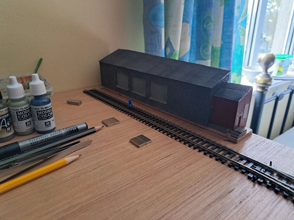

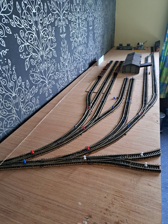

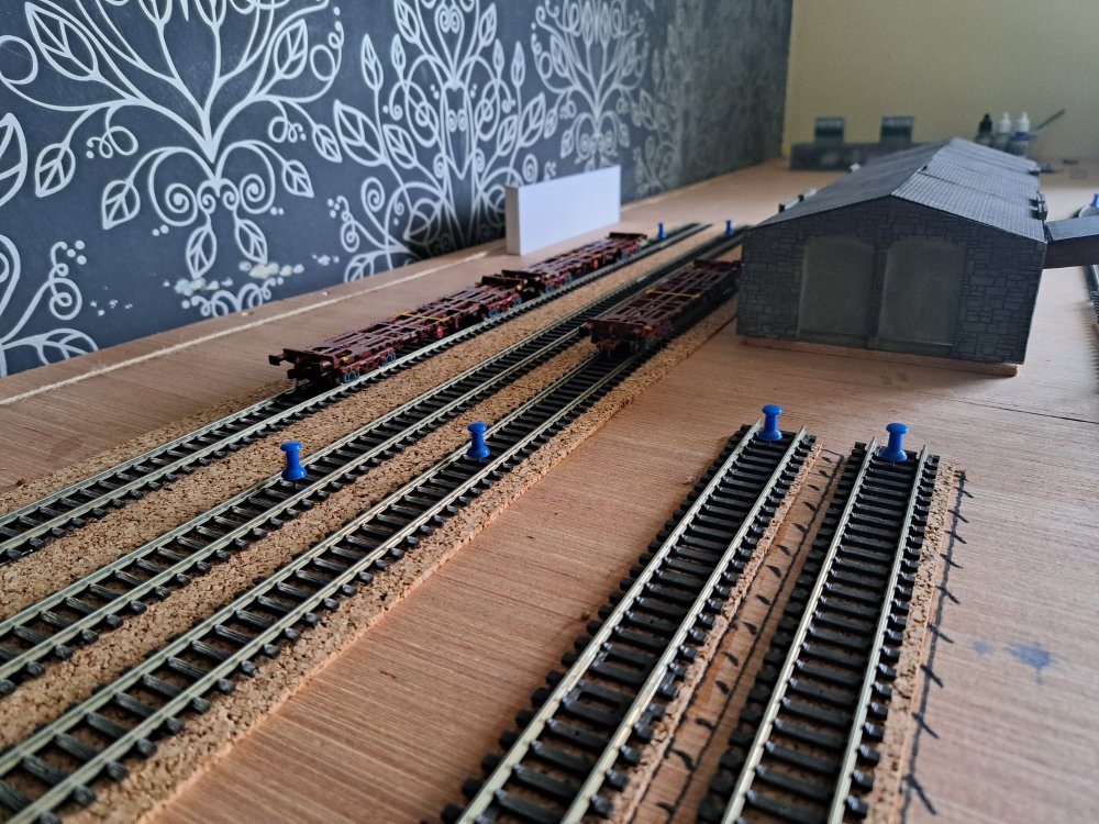

Popular Post Dempsey Posted March 16, 2023 Author Popular Post Posted March 16, 2023 (edited) Progress has been slow since my last post. The two building are complete in so far as the major work and painting has been done. All that remains is some of the roofing detail and drainpipes etc. Track wise I'm happy with the track plan and have begun laying down the cork roadbed with 60 percent done. As I will be using kadee couplers I've begun siting and testing magnets to try remove the hand of god for exhibitions when uncoupling. This as been a try and error approach between finding the right dimensions and strength. Once that is finalised I'll begin wiring and laying the track and points. Your thoughts as always are appreciated. Chris Edited March 16, 2023 by Dempsey 22 1
JasonB Posted March 17, 2023 Posted March 17, 2023 Brilliant stuff. That's a great job. This shot in particular I really like. 3 1
Dempsey Posted March 17, 2023 Author Posted March 17, 2023 On 16/3/2023 at 10:32 AM, Patrick Davey said: Really nice - love the buildings! On 16/3/2023 at 11:25 AM, Rob said: Looks great- buildings are fantastic 6 hours ago, JasonB said: Brilliant stuff. That's a great job. This shot in particular I really like. Thank you. As much as I'm looking forward to seeing some shunting going on in the yard, the building aspect is proving to be a great but enjoyable challenge of the layout 4

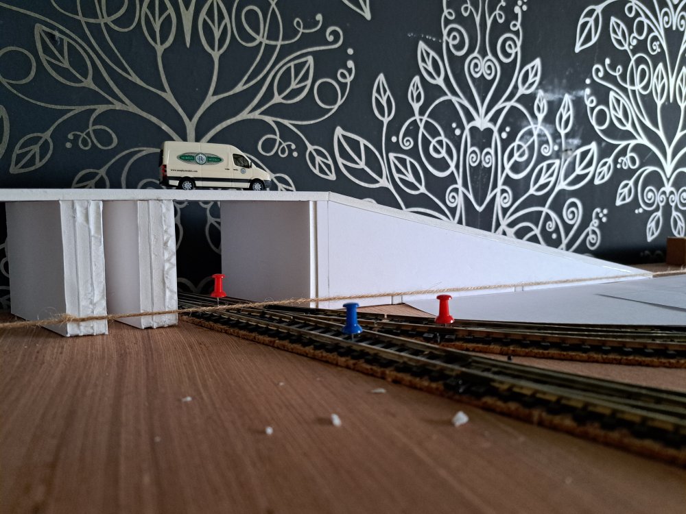

Dempsey Posted March 19, 2023 Author Posted March 19, 2023 The sub structure for the bridge is complete and tested for clearance. This well form the scenic break between the rear staging area and the layout itself. 7

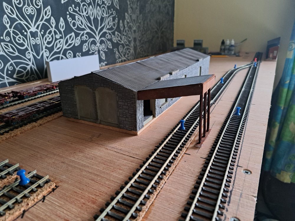

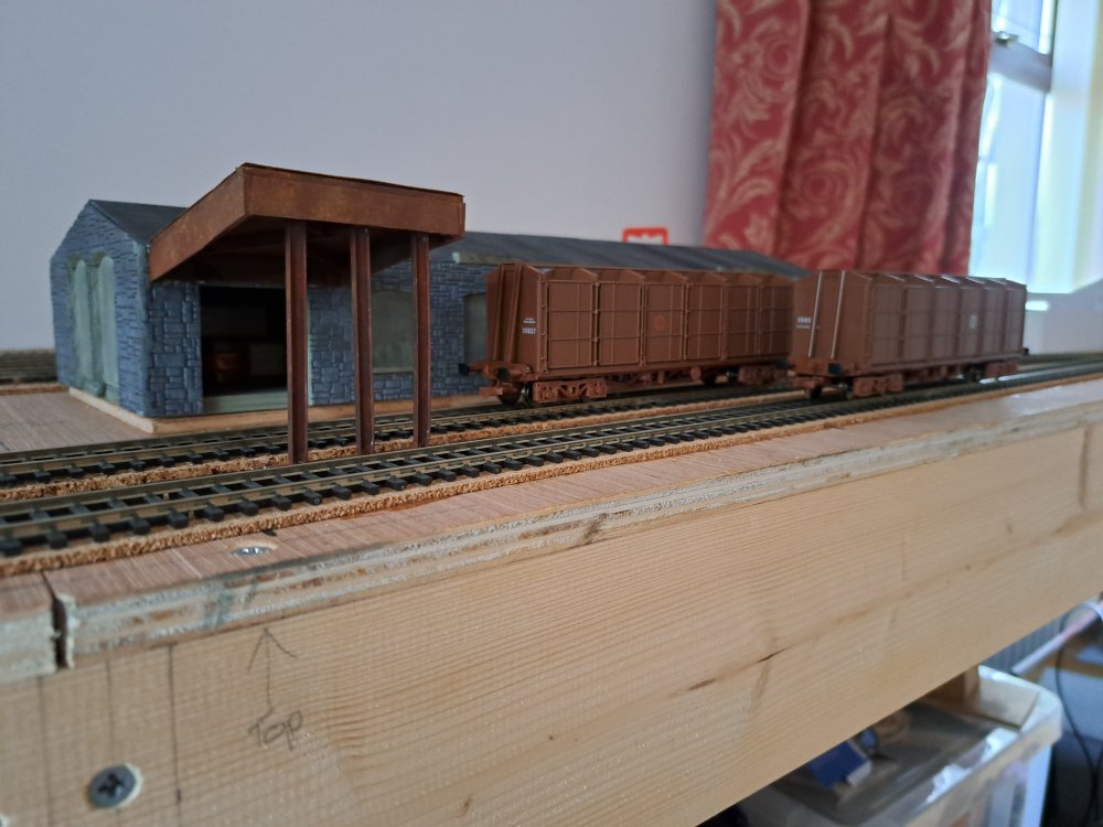

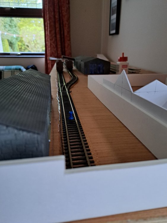

Dempsey Posted May 4, 2023 Author Posted May 4, 2023 Some more building work at the far end of the yard. The sub structure is taking space. Using some poetic license here as from the video I'm using for reference I can't tell exactly what they were as they no longer exist. This is however becoming my favourite angle. Also got my hands on a pair of ferts for the yard. 13
Sean Posted May 4, 2023 Posted May 4, 2023 https://webapps.geohive.ie/mapviewer/index.html if you havent seen this already, all the old satellite imagery and OS maps can be overlaid onto this map. might help fill in the gaps. 3 1
Dempsey Posted May 4, 2023 Author Posted May 4, 2023 That's brilliant. Never knew about this. I can see I have one or two track alterations to do. Thank you, this will be invaluable 1 1
JasonB Posted May 5, 2023 Posted May 5, 2023 (edited) 19 hours ago, Dempsey said: Also got my hands on a pair of ferts for the yard. The Ferts look right at home. They fit into that scene perfectly. Edited May 5, 2023 by JasonB 5 1

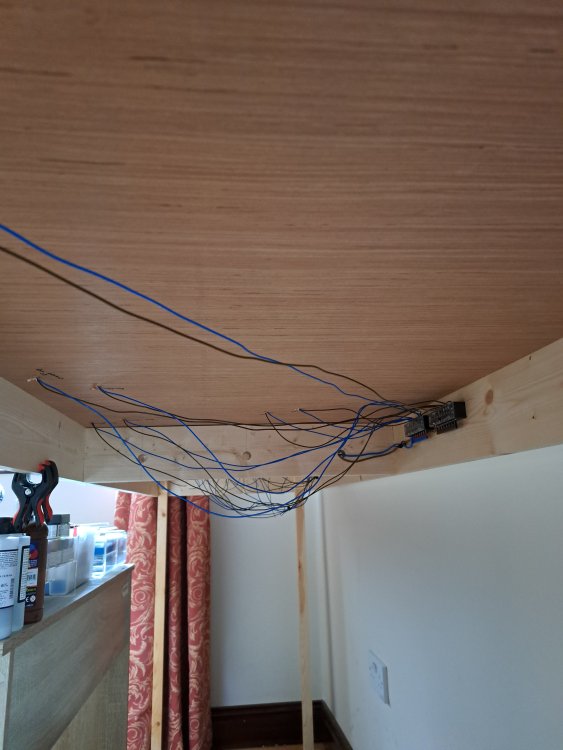

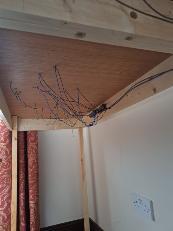

Dempsey Posted May 14, 2023 Author Posted May 14, 2023 The first phase of wiring is complete. All track feeds bar the power for the points has been wired in with droppers awaiting the installation of the point motors and finally some tiding up of the wires. 8

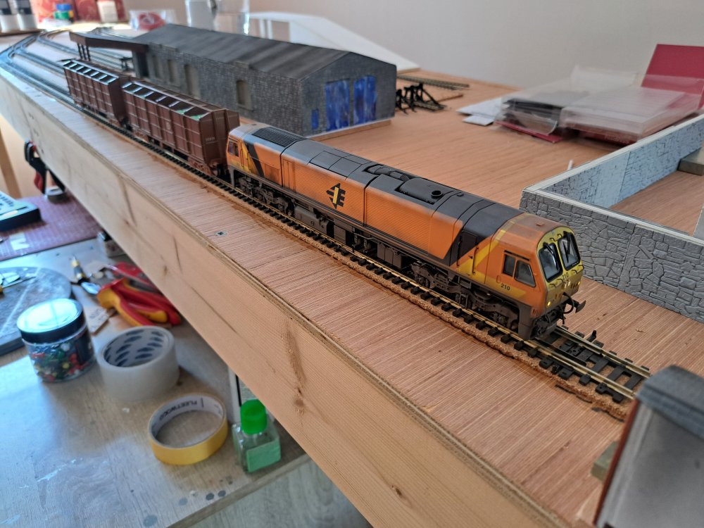

Dempsey Posted August 16, 2023 Author Posted August 16, 2023 While 210 never ran here in real life, at least to my knowledge 210 became the first train to run here on Barrack Street. While unfortunately not running a sound chip that dos not take away from this milestone or the sense of achievement. Over the next week 210 will be tasked with testing the operation and track of the yard before the track itself is finally secured in place. 20230816_204714.mp4 20230816_205140.mp4 10 1
Dempsey Posted August 17, 2023 Author Posted August 17, 2023 While I'm sure unrealistic I had to see how they looked in the scene. 20230817_151600.mp4 15

JasonB Posted August 18, 2023 Posted August 18, 2023 That's a very smooth run by 210 and the ferts. Great job. 1 1
Dempsey Posted August 19, 2023 Author Posted August 19, 2023 3 hours ago, JasonB said: That's a very smooth run by 210 and the ferts. Great job. The NCE powercab works very well with the MM chip 2
JasonB Posted August 19, 2023 Posted August 19, 2023 8 hours ago, Dempsey said: The NCE powercab works very well with the MM chip It was the work on your track that I was complimenting. No kinks or bumps at all, which you can sometimes see on layouts. 1

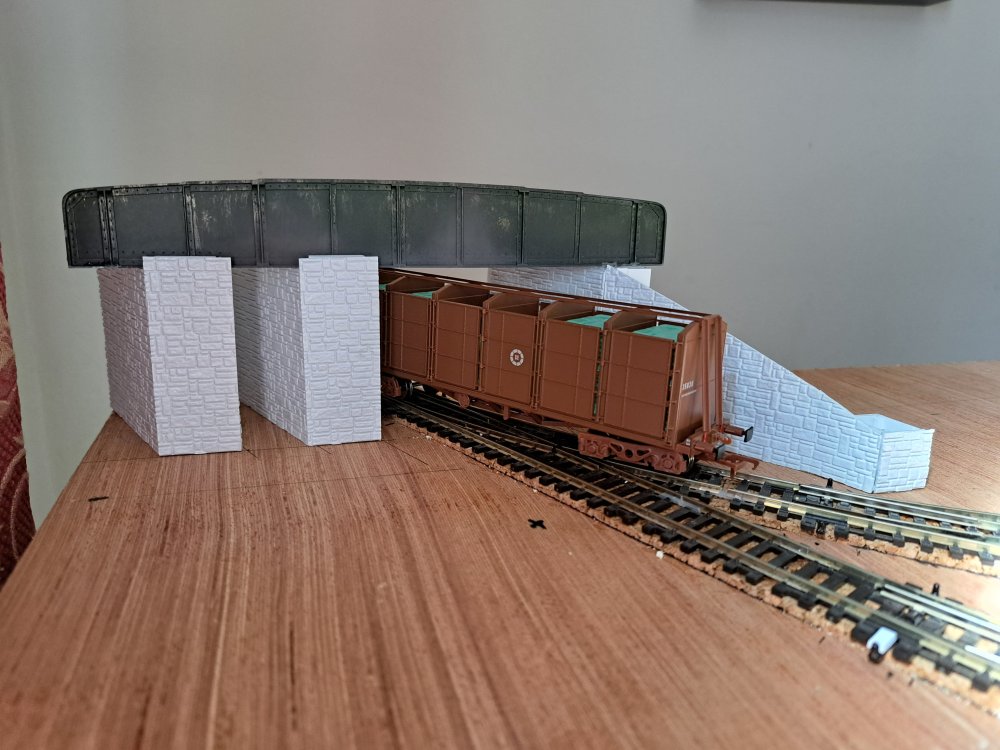

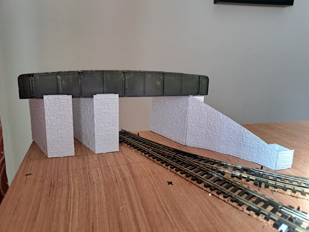

Dempsey Posted August 20, 2023 Author Posted August 20, 2023 The bridge that forms part of the scenic break for the layout is taking shape. Very happy with the progress so far on this stretch build. 12
Dempsey Posted August 20, 2023 Author Posted August 20, 2023 1 hour ago, DJ Dangerous said: Love the bridge side! I'm grateful there is only one. It was a torture to curve. 1
DJ Dangerous Posted August 20, 2023 Posted August 20, 2023 2 hours ago, Dempsey said: I'm grateful there is only one. It was a torture to curve. How did you curve it? Hairdryer?
Dempsey Posted August 20, 2023 Author Posted August 20, 2023 Actually didn't think of that. No I scored down the back of it every couple of CM and just gently started bending it around.
